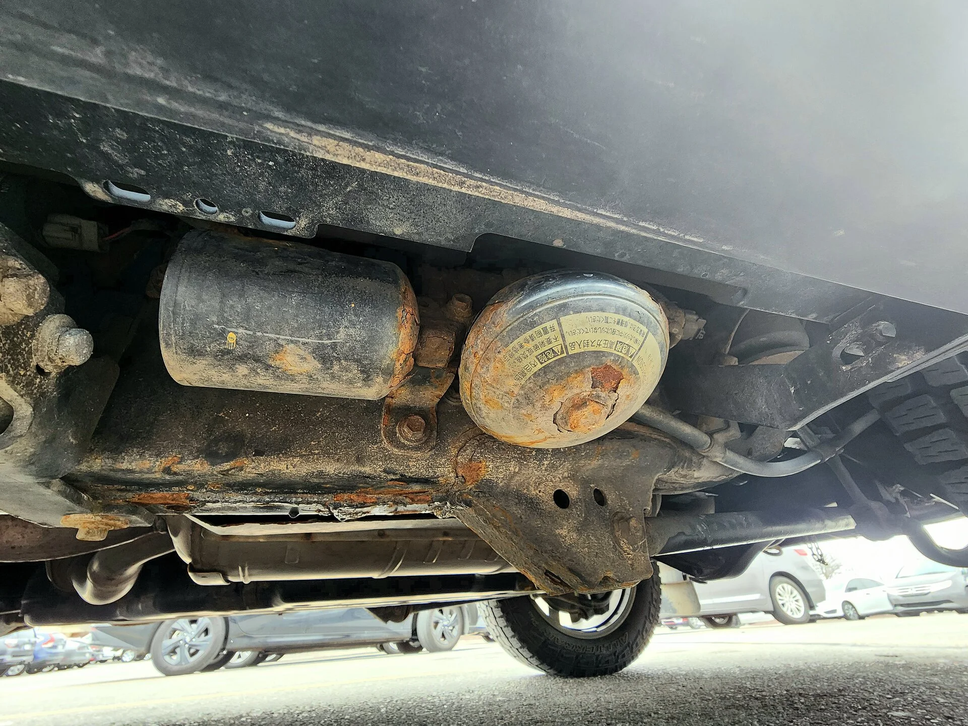

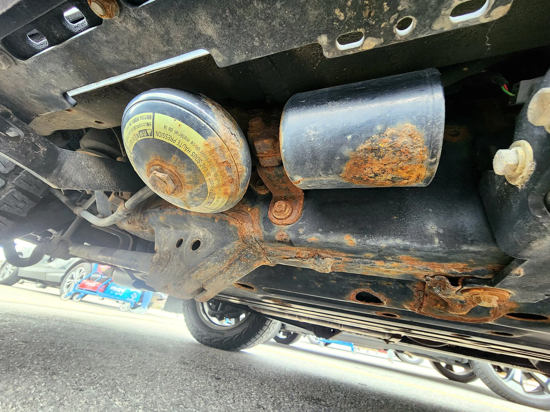

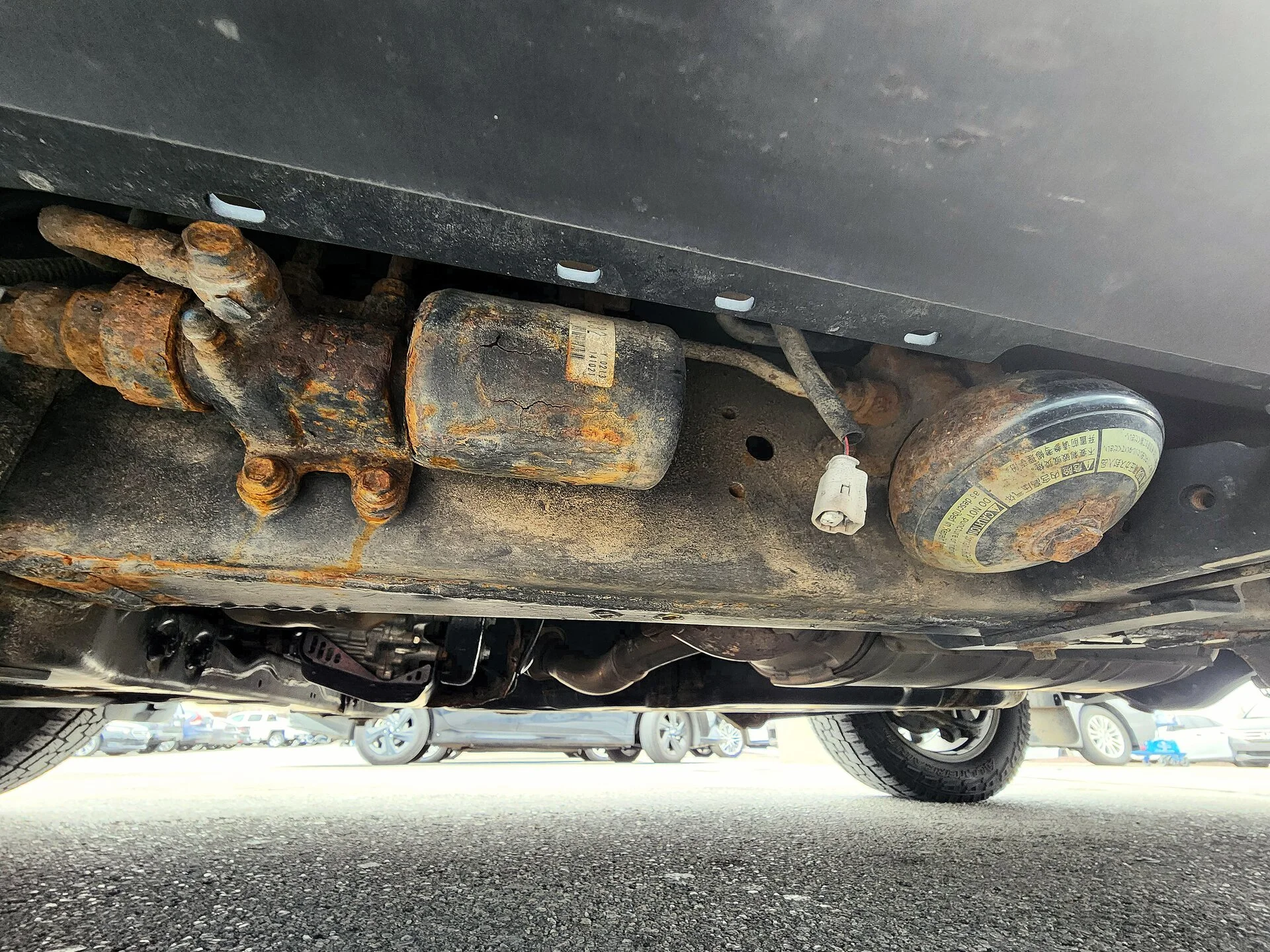

After removing the plates from the Slee rock sliders, and actually being able inspect the accumulators, and bleeding valves, and being able to climb under the rear to work on the busted line, it's blanantly obvious that $6k-$7,500 was not spent replacing anything on this suspension system. Everything suspension wise is rusted! The rear passenger side shock, has a hole in the top of the shock...smh
I've pretty much accepted that I'm going to have to convert my LX570 to traditional suspension. This isn't how I wanted things to play out, but it is what it is.
Plus, the local Lexus dealership quoted me 8.5hrs of labor for replacing the line, and 4hrs to fill and bleed the system. I was told to be prepared to spend at a minimum around $2k to replace the line, and around another $400 for them to bleed the system. They also told me, that if my bleeder valves and accumulators look bad, or are rusty, then they will pass on the work. Here's a few pics of my accumulators, I'll post more once I get back under the rear.
