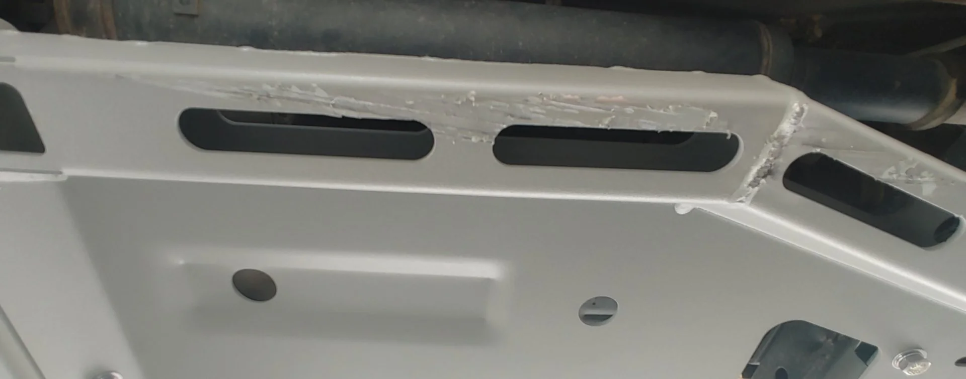

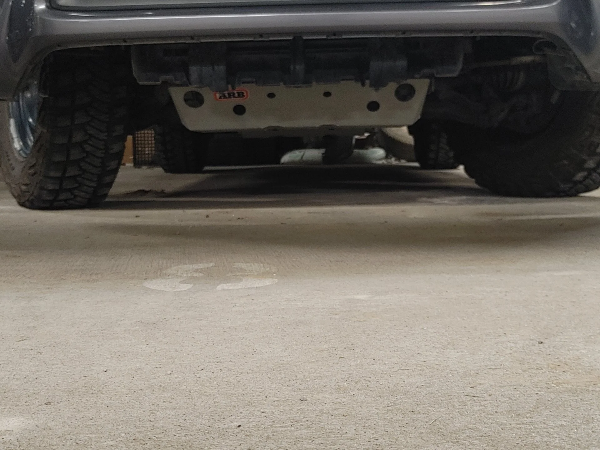

Skids have been tested.

There is this black deflecter piece above the skid plate that acts as an air deflector and radiator saver. I just put it back on, but that's going to be in my list next and potentially ARB tow points, as I am thinking I may travel to Denver to have Slee do an ARB bumper.
