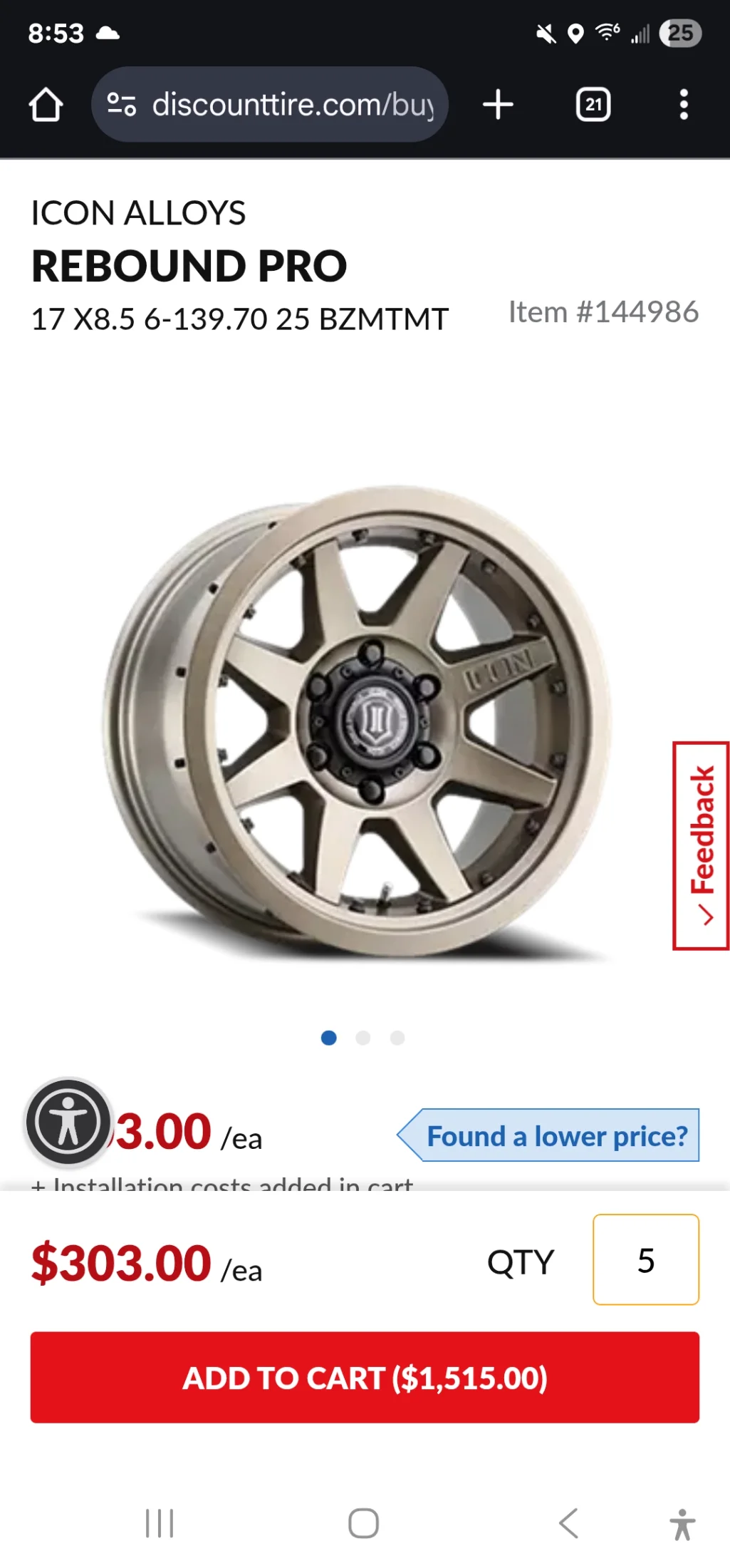

Icon wheels with bead retainers

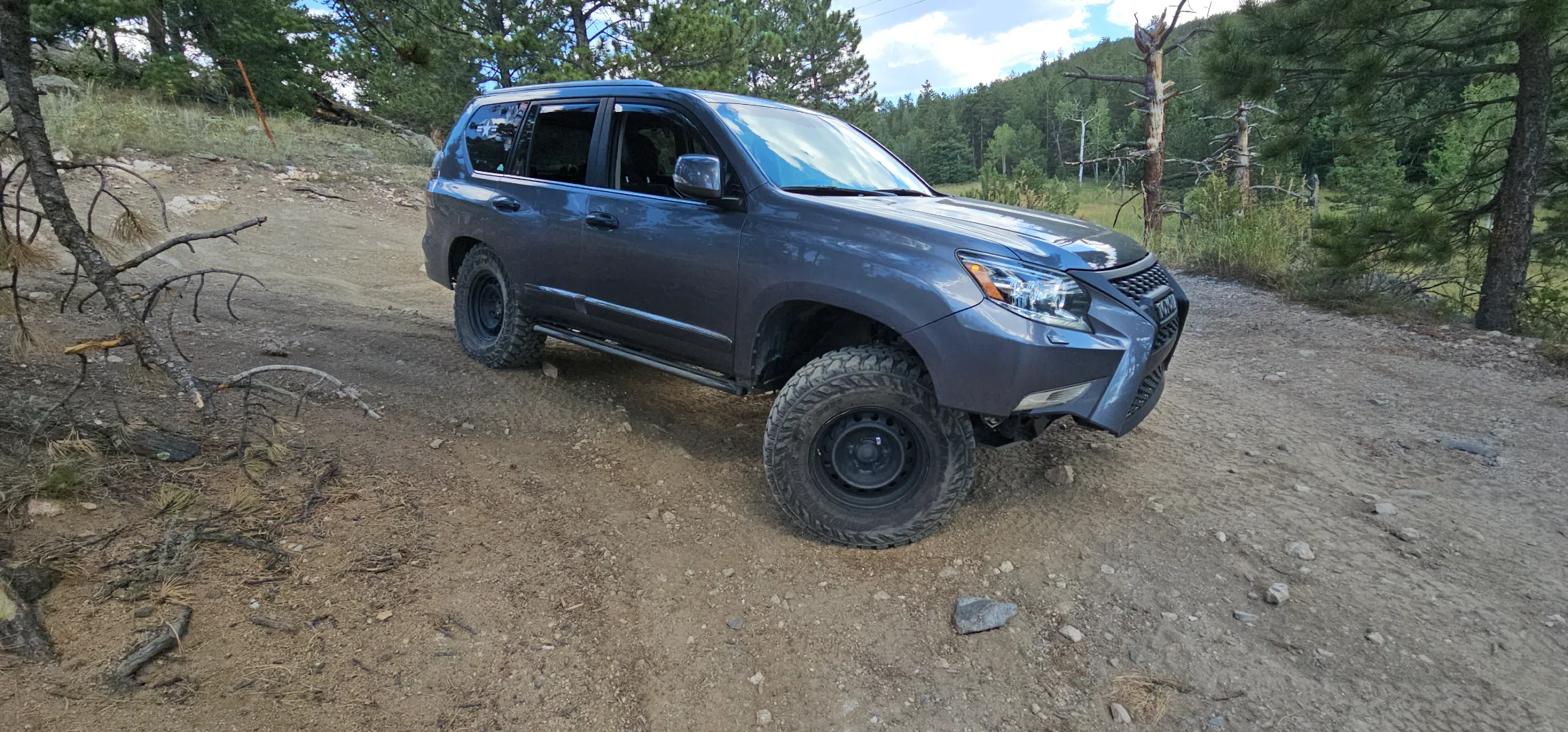

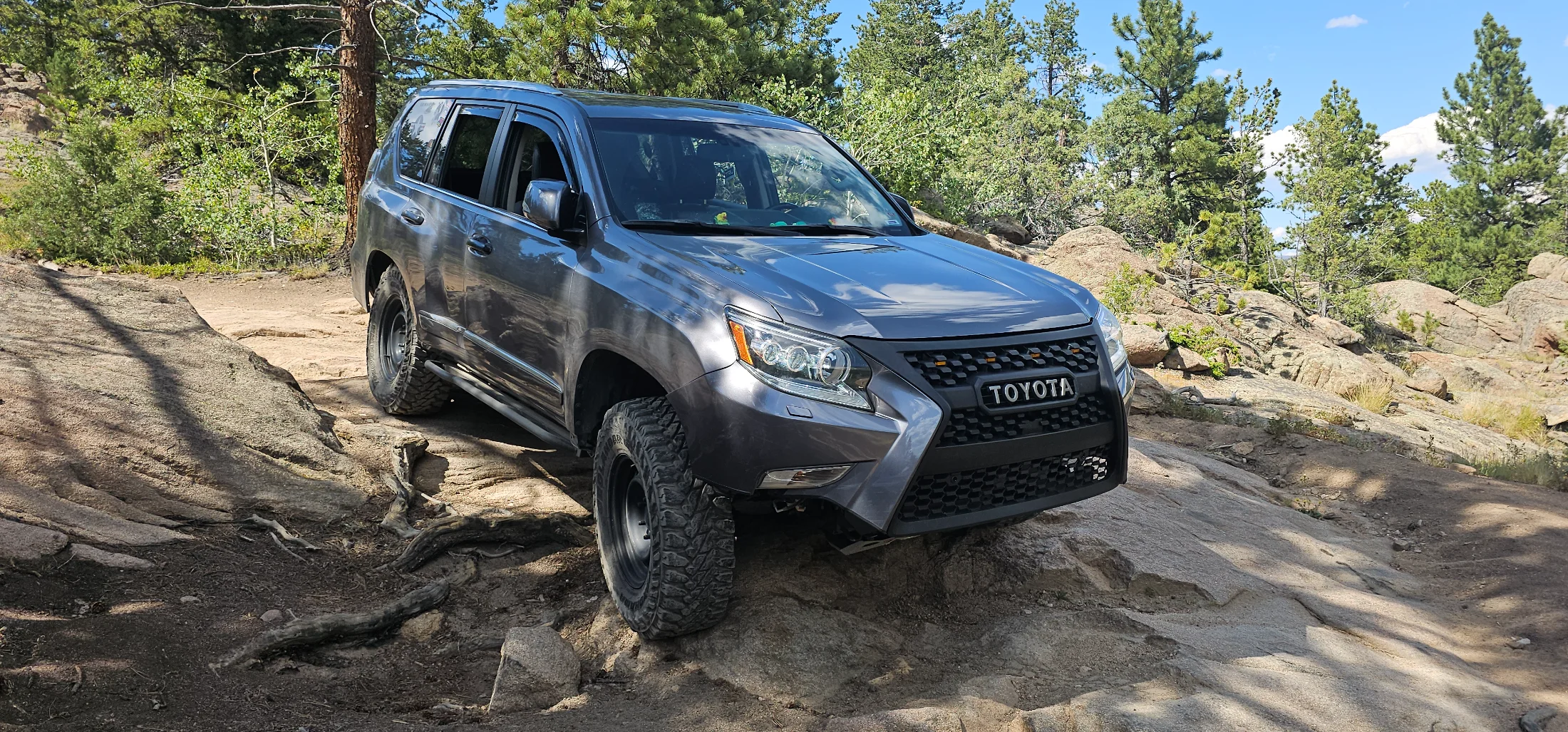

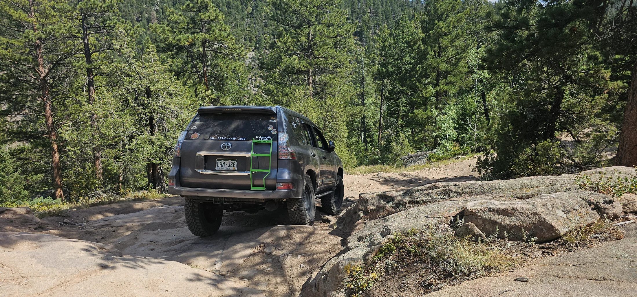

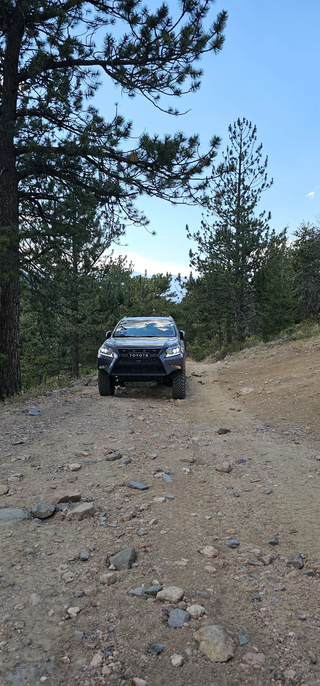

Pics please!

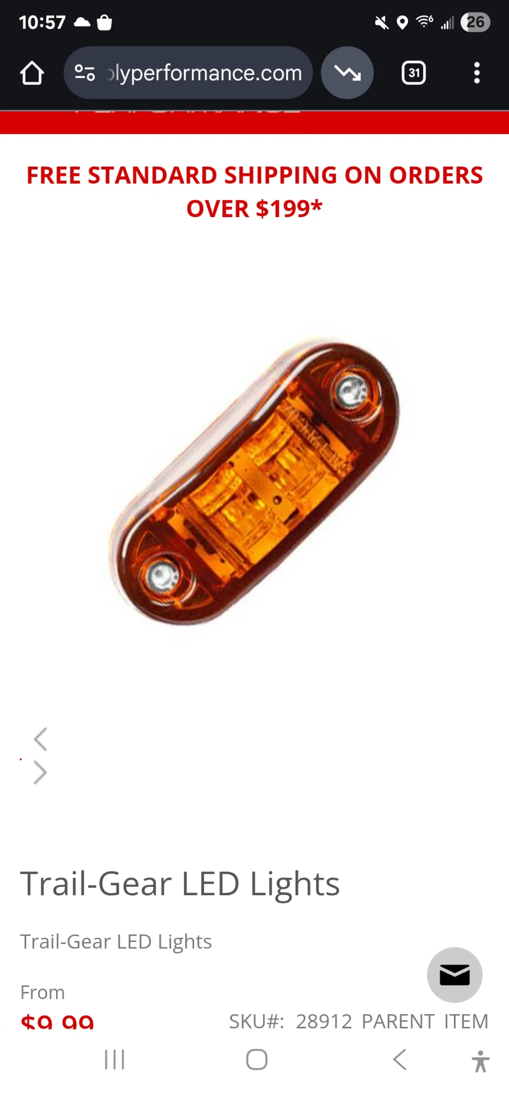

Also included pics of the turn signal lights i am testing out to replace the oem front. I dont know how many I will need to get the resistance so it doesn't fast flash without cheating and using a resistor.
The wheels are the "novel" DOT legal wheels with bead retention set screws.
Wow! Someone's been a busy little beaver! 😆
Yup, took some time off. I have a pretty massive backlog of projects.
Ditto.

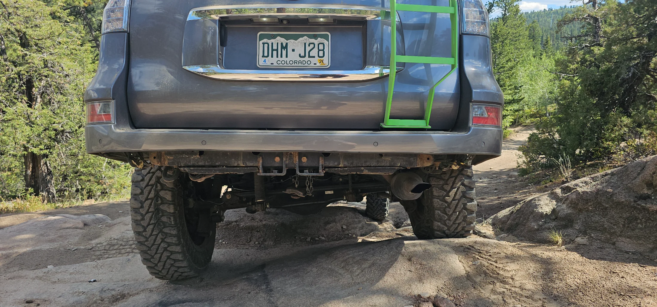

Rig looks good. Did you take any pictures or can you tell me where you trimmed the rear bumper because I desperately need to trim mine. Or maybe I can give you a call and we can talk about how you did it and give me some details.
