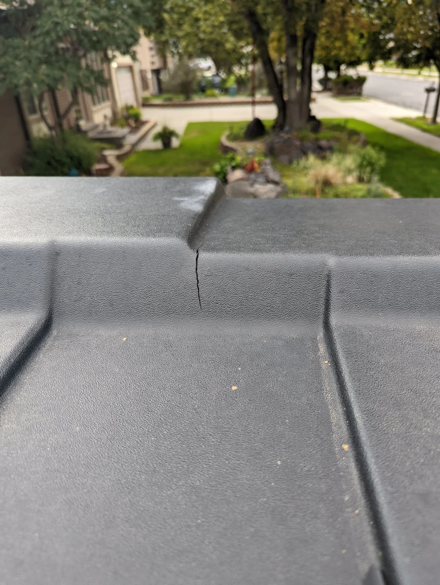

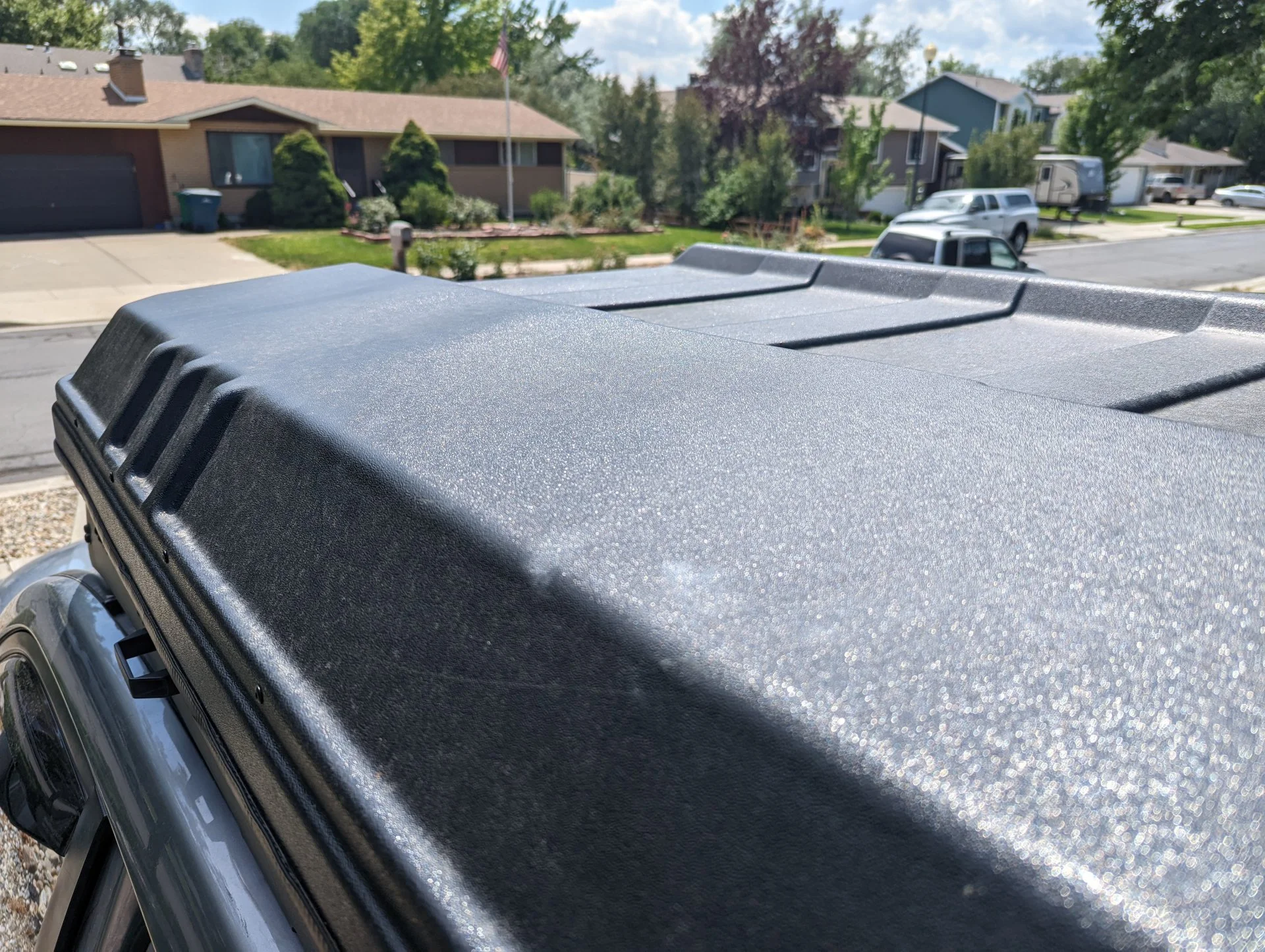

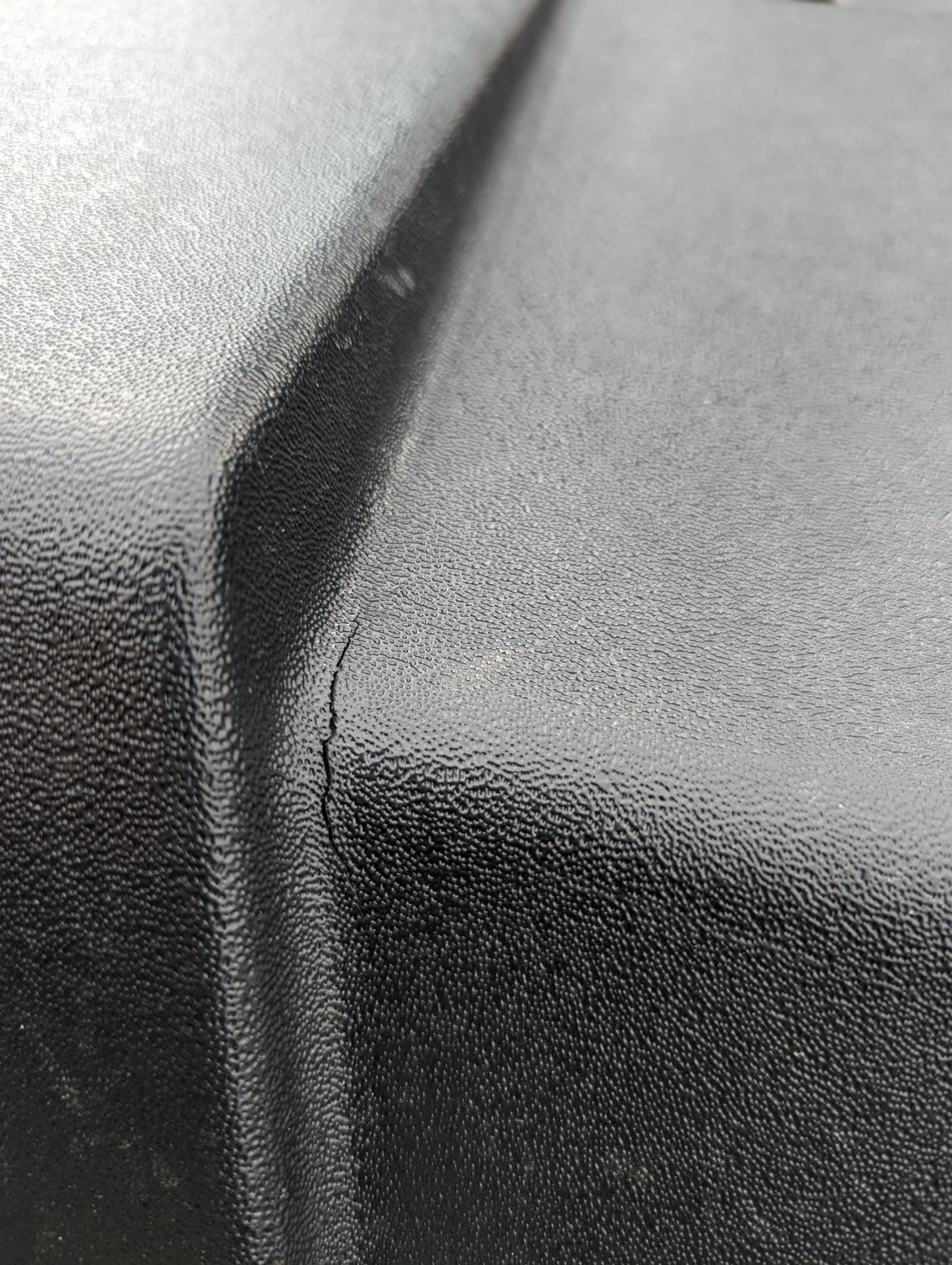

The issue was warping and cracking in the top shell. Two significant cracks formed towards the rear of the tent, and the flat surfaces along the left and right edges became warped and "wavy". This resulted in a shell that did not sit flat like it should.
Driver Side Crack

Passenger Side Crack
"Waves" on the Driver Side.
My suspicion is that there was an issue during manufacturing (Roam has them made in China as far as I know). If I had to guess something went wrong with the curing process, resulting in the Fiber Glass & ABS layers failing to bond to each other.

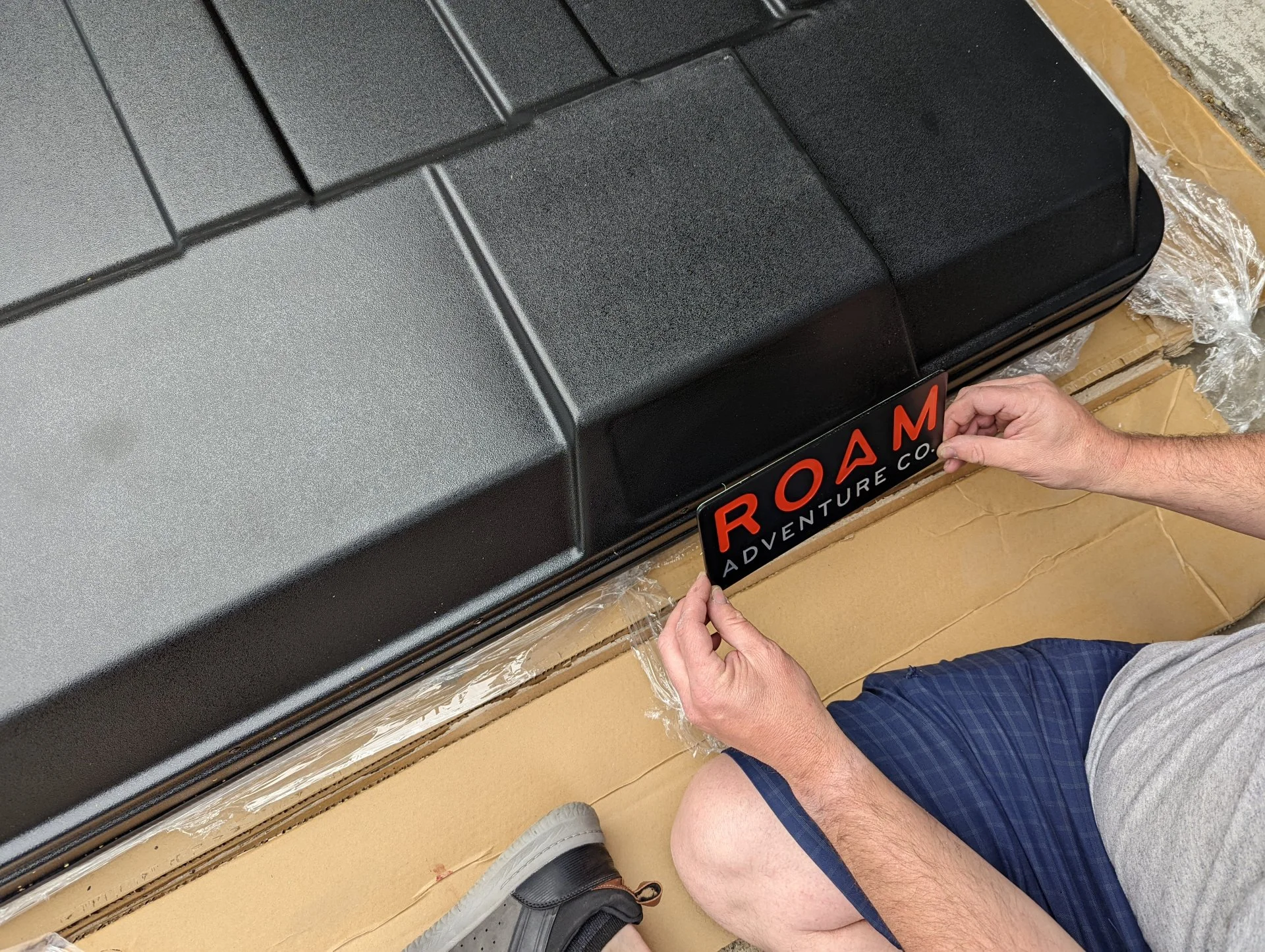

But there were QC issues right from the start. The Roam Adventure Company name plates were falling off right out of the box. The included cargo net was broken (luckily I had purchased their upgraded cargo net, so I had a replacement on hand.) They also failed to include mounting hardware and took almost a week to get it to me. And lastly, the ladder was junk. Not close to tall enough for my rig...so we had to fab a removable mount that slips into the slots on my Prinsu rack.

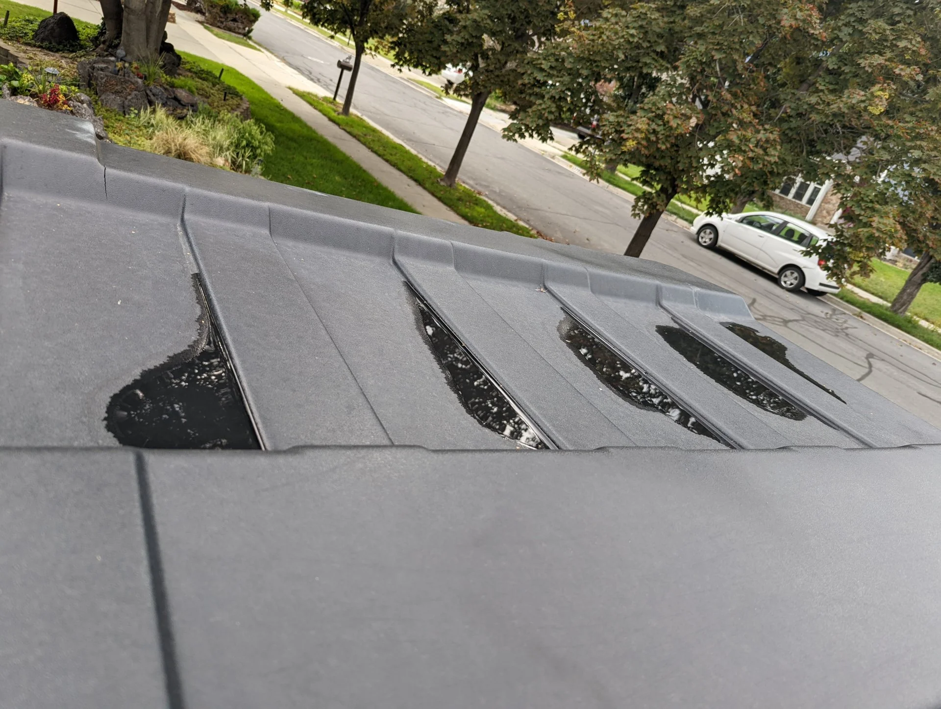

Another issue is the overall design of the top shell. As you can see below, rain water just sits up there. I had to be careful when closing the tent to keep it from dumping all over me.
Driver Side Crack
