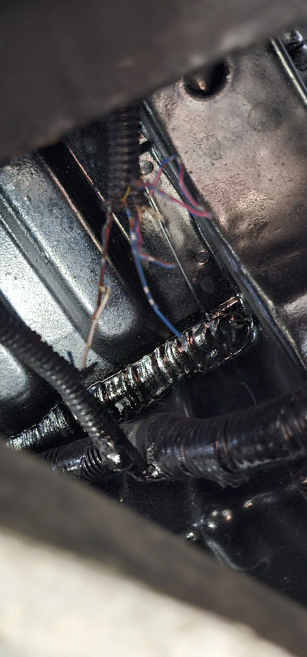

Hi all,
I believe something got to my knock sensor wiring...
Do they sell just the wiring harnesses or one that is universal from another vehicle?

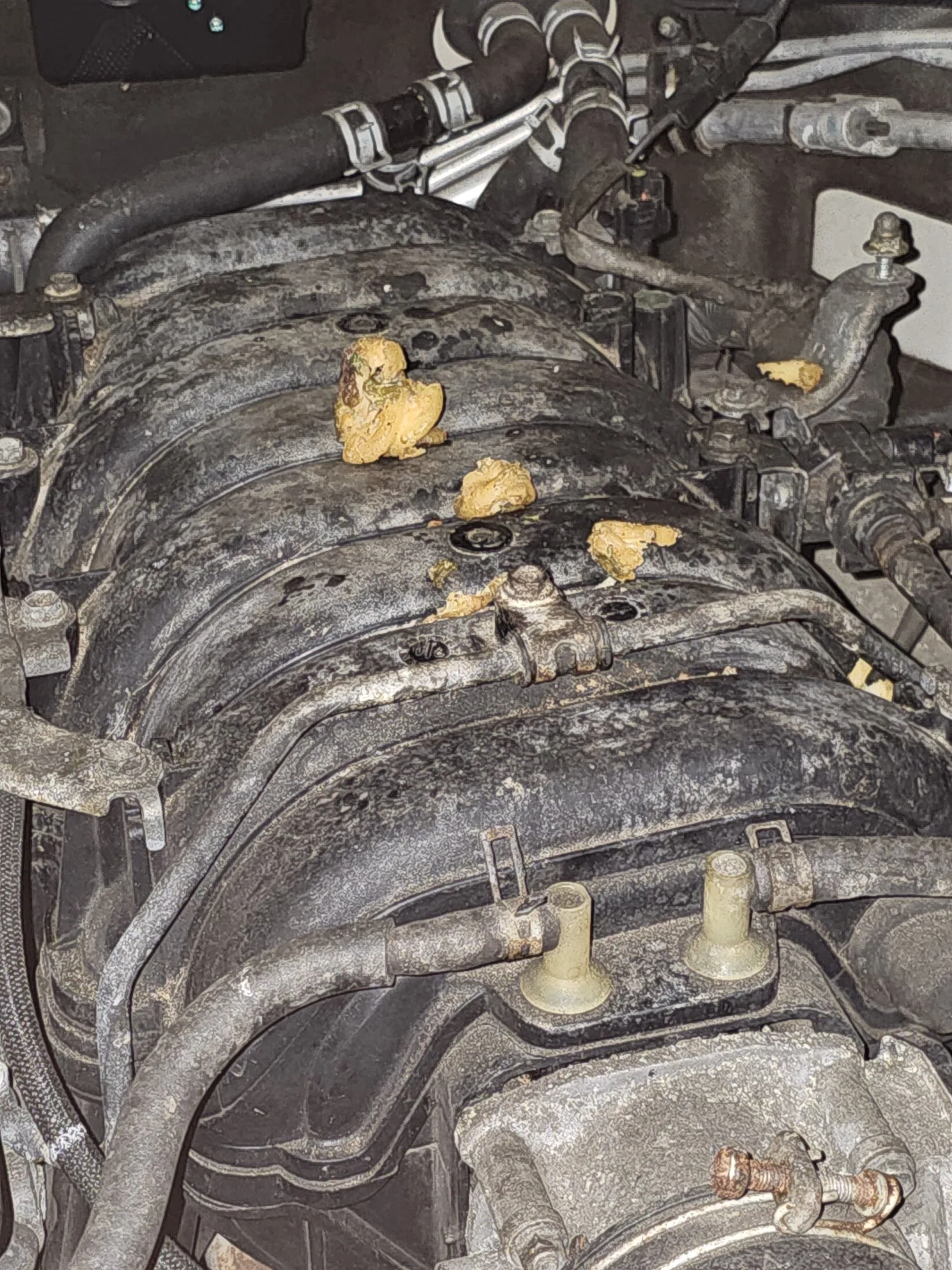

Yes.... this is their left over dinner on my engine... mac and cheese...

I re-did the knock sensor wiring on my old Supra. The trick was that it's shielded wire so that needs to be properly handled. Not quite just a wire replacement. I'd assume the 100 is still the same arrangement with shielded wire.
That dealer quote seems small actually. I'd expect them to replace the entire engine harness which probably retails for $1500+ itself, not counting any of the labor or other consumables needed.
If your mechanic friend is familiar with electrical then it should be a breeze for them, but I'd count on more than 6 hours.
I don't think there's any kind of universal harness, nor do they separate the knock sensor from the main engine harness. That's typically a part of the entire engine harness and there's no segmented point where you can simply replace the harness. It's one continuous shielded wire from sensor to ECU.... at least that's what I bet it is.
One correction - at least on my 2005 LX, the knock sensor wiring starts as part of the starter harness, not the main ECU harness. There's then a connector right on the back of the driver side of engine where it plugs into the main ECU harness.

It was indeed a chewed wire; knock sensor wasn't even connected!
Picked some denso knock sensors up 2 for $20ish on eBay (shipped from japan); cheap! But they work as they should! New/refurb denso start was $189... also picked up two Toyota wires and two knock sensor clips as well as the intake gaskets.
