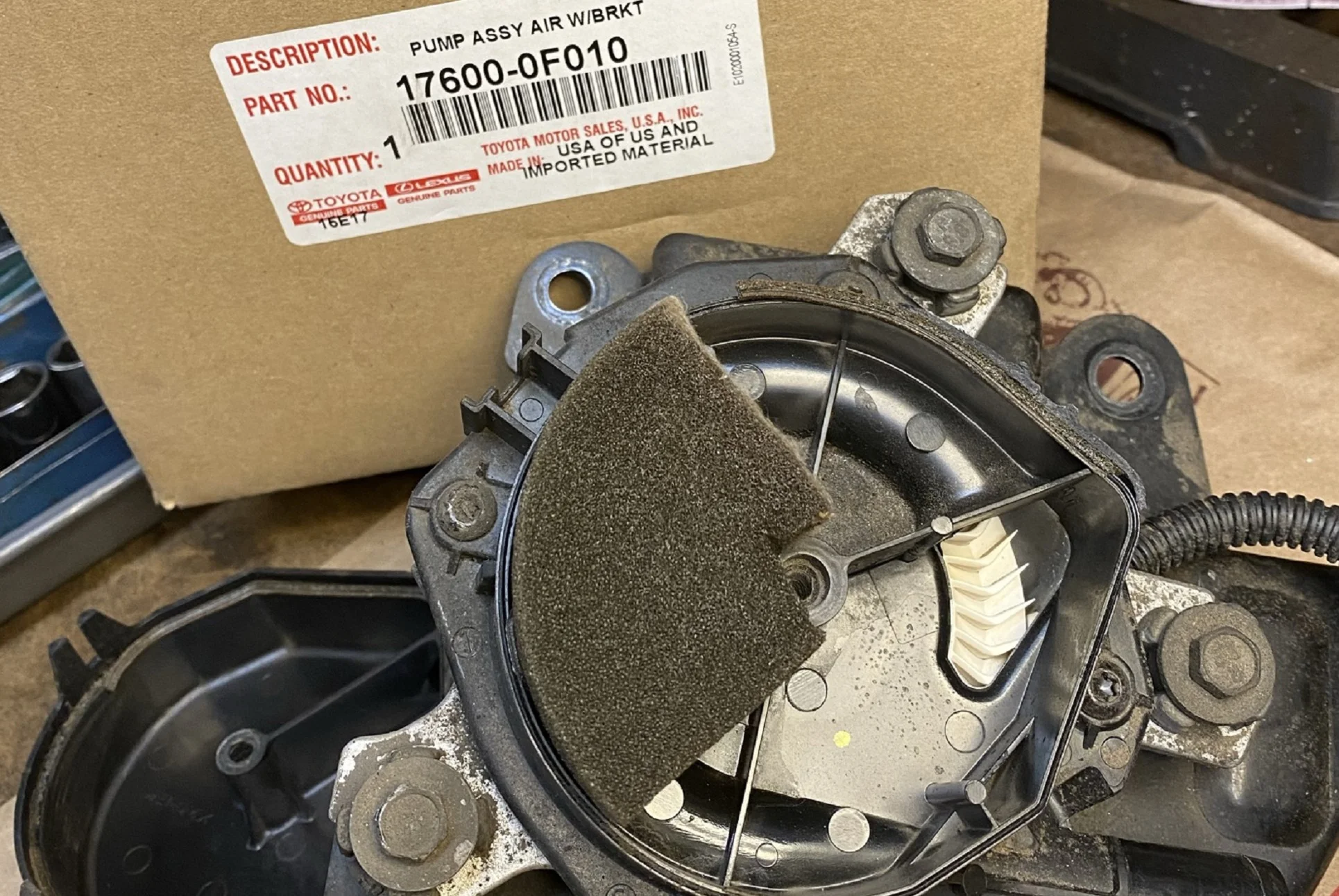

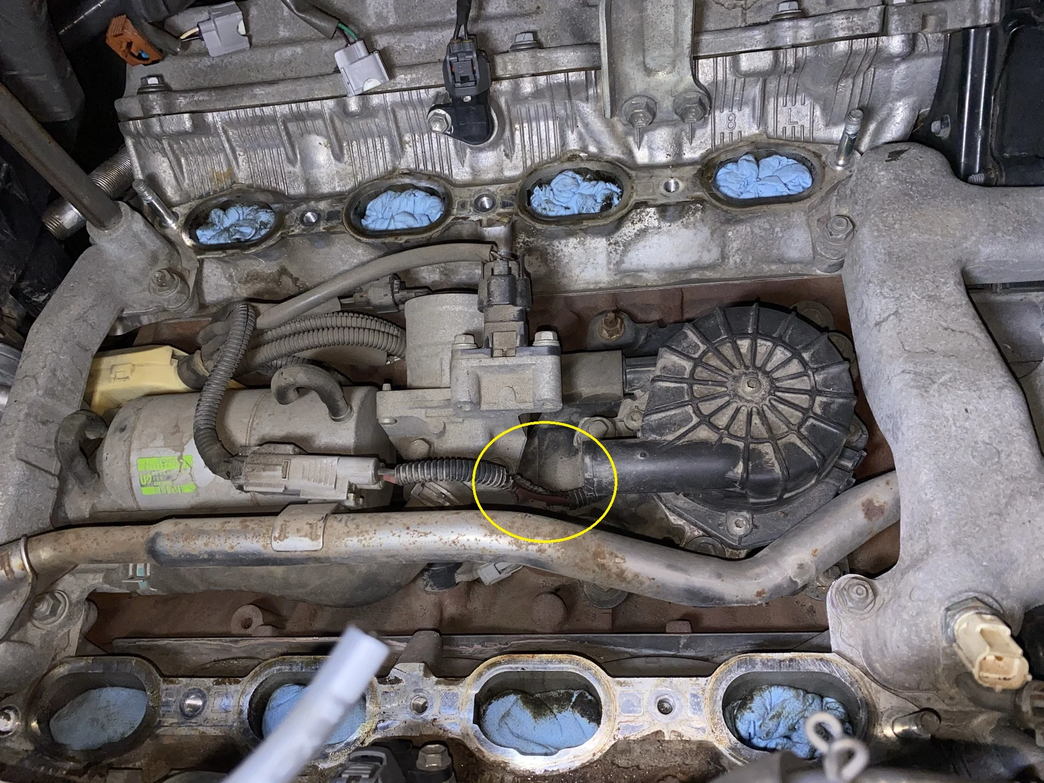

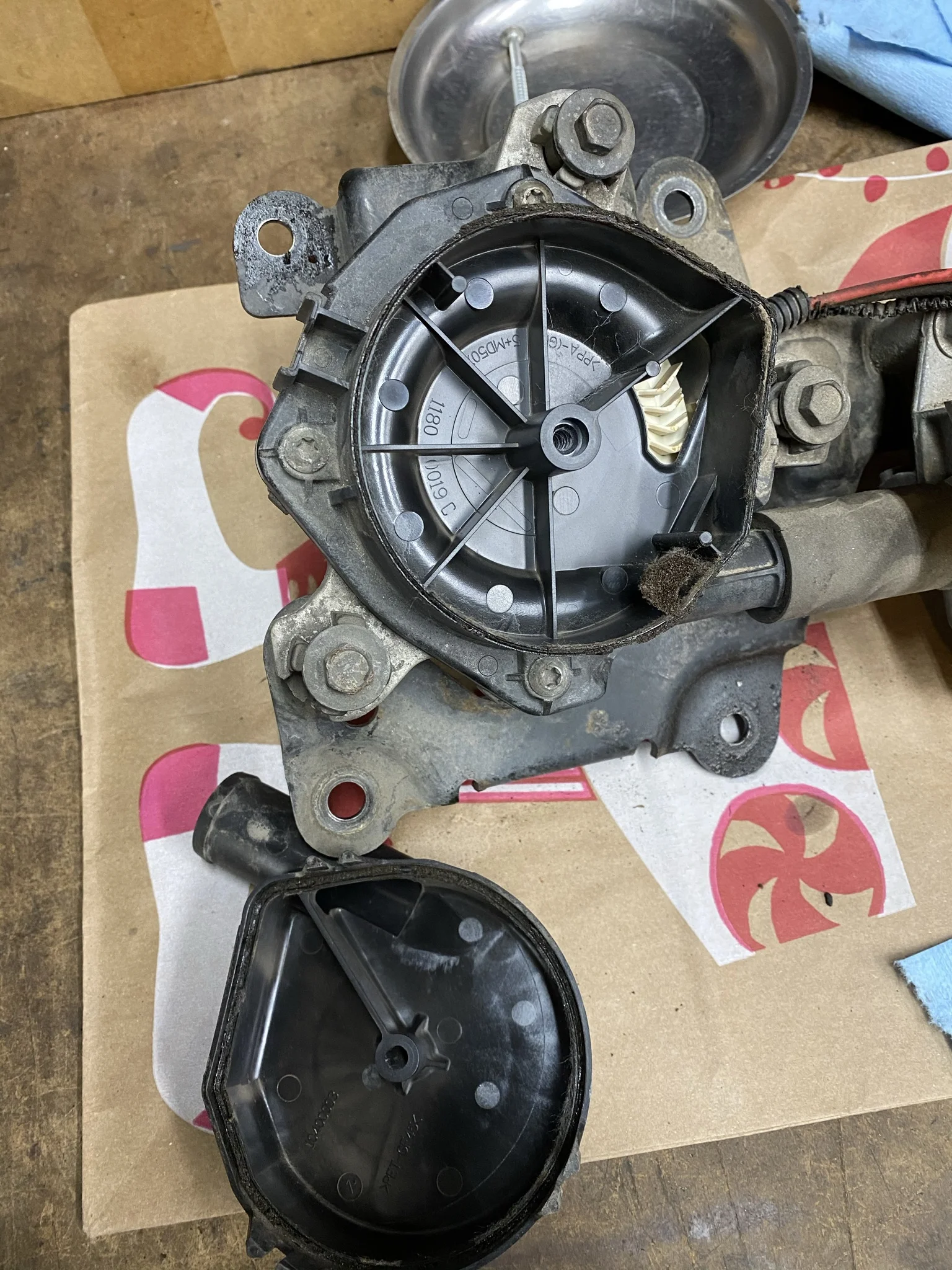

Strange. The filter sit in cap on pump, which inlet tube is molded in cap. You'd need to drop on floor to crack. Even if crack, won't have much effect. Unless debris from busted cap, was stuck into impeller.
Inlet is molded with cap. Air inlet tube, is at/in left edge of yellow circle.
Intel tube of pump cap. In right edge of yellow circle in this view.

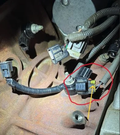

And here is what i assume is the 3.5 hour soldering job

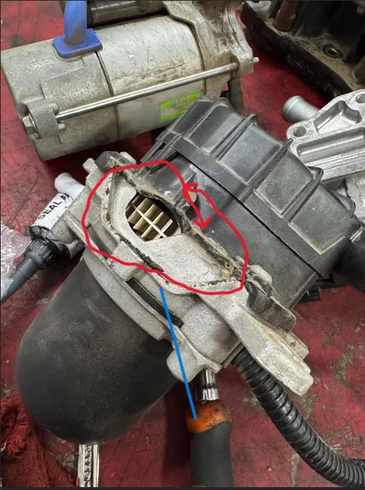

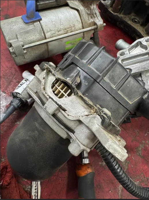

That, air SAI pumps, is toast.
Interesting. Looks like fresh break, of plastic air pump outlet, has busted off. Likely hose between pump & main SW valve stuck on plastic. Forced used to pull main switch valve off pump. I pull the assemblee (pump W/ main switching valve) so that hose not touched.
First I've seen busted.
Plastic in valley gets, very hot. As such, become brittle.
Like this busted wire housing block, which I'd replace.
