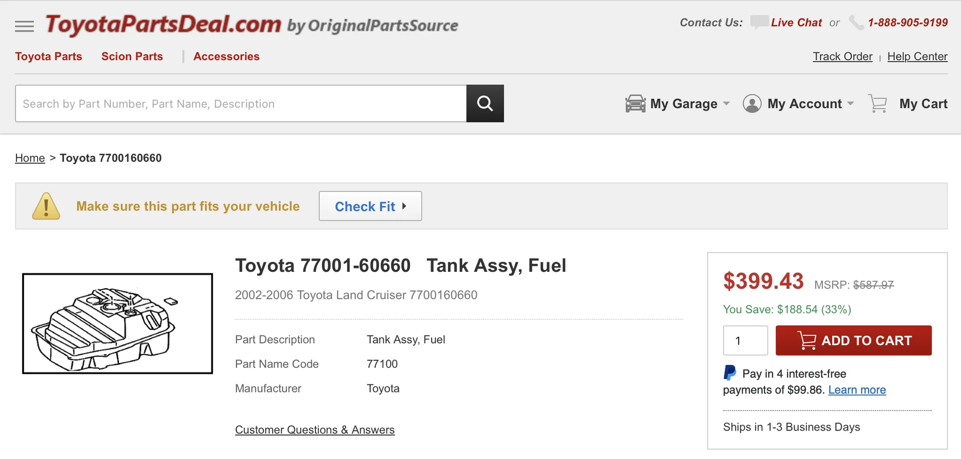

Looks like the tank I ordered supercedes the tank posted above? Even if one could still purchase the 60660 tank above, with tax and shipping it's close to $800.
