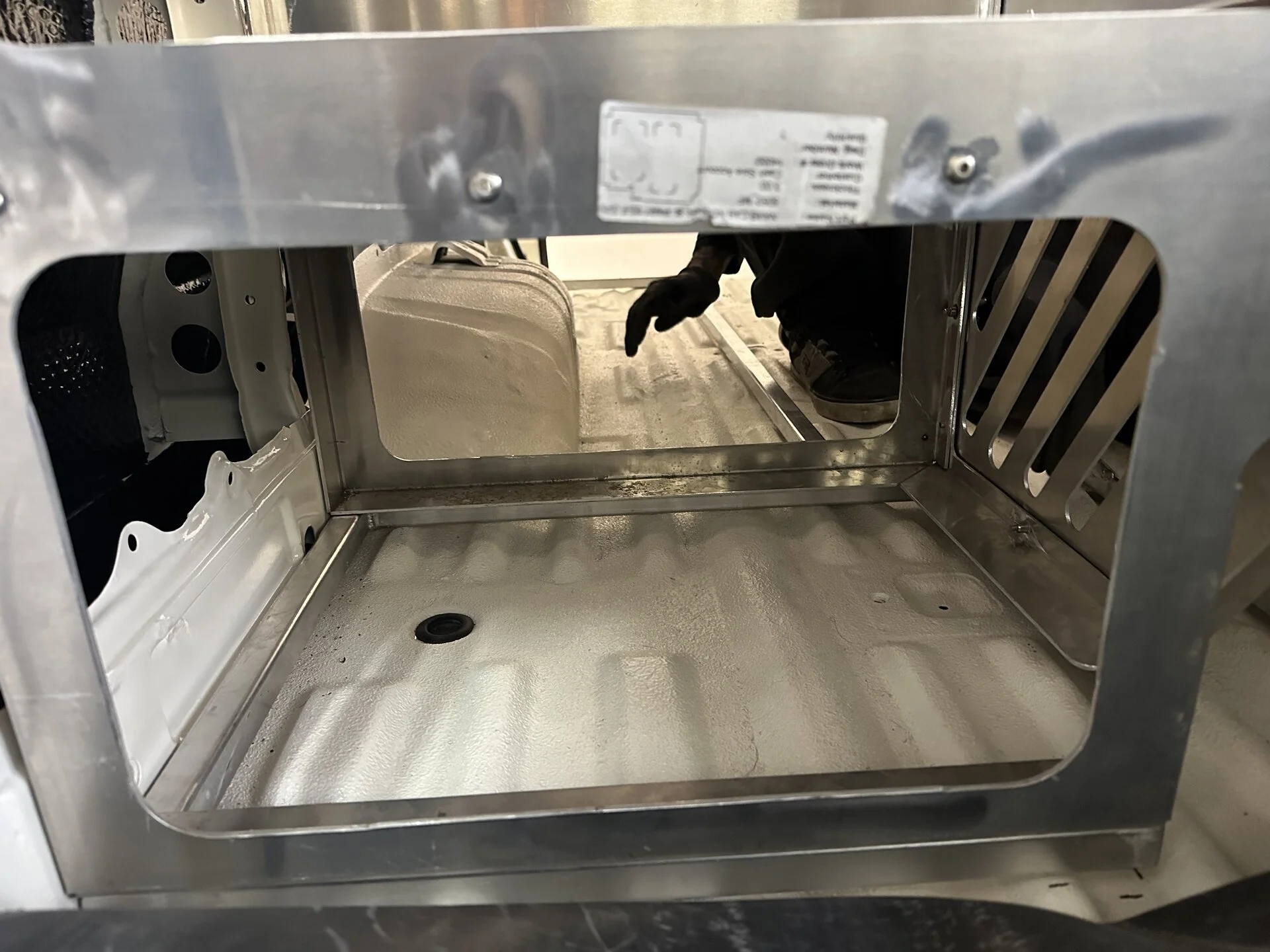

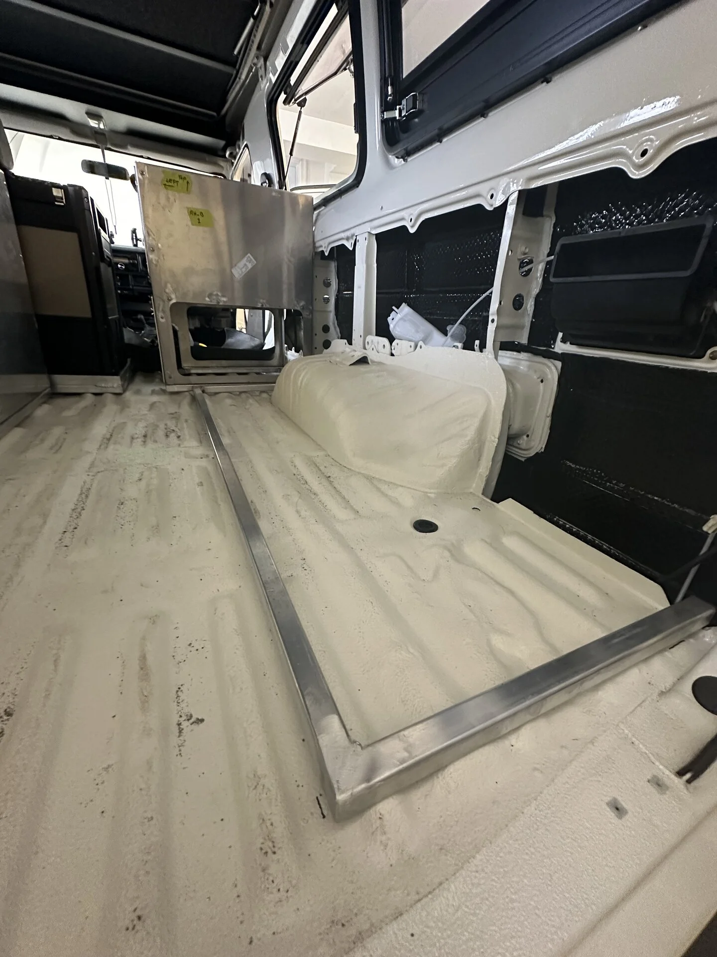

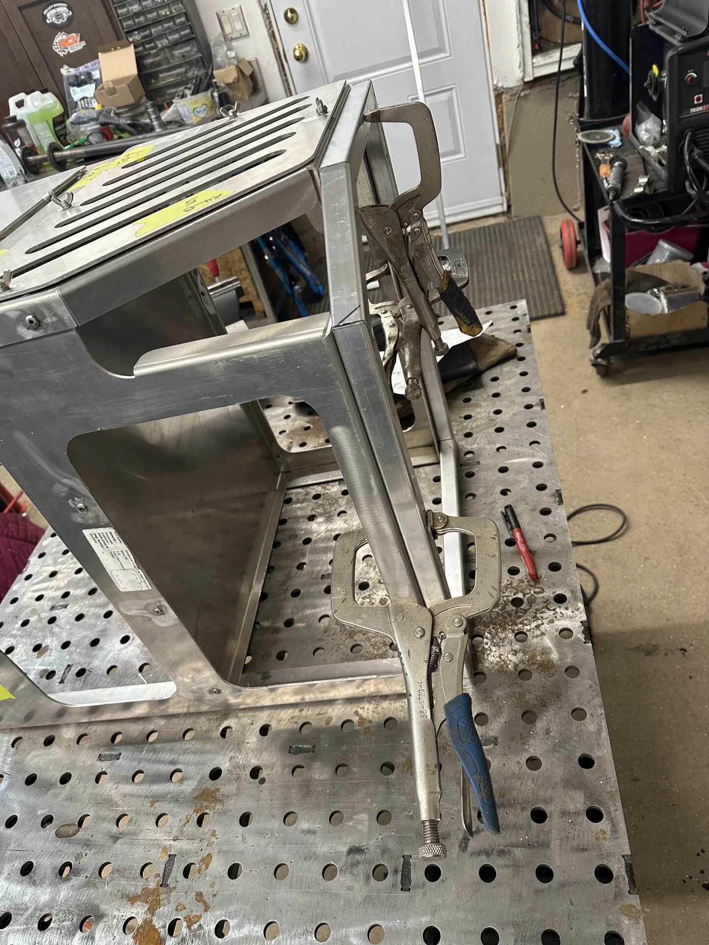

Been working yesterday on second section of the cabinet frame almost completed juste need to make bracket to bolt then will need to make some more custom bracket for the real estate to bolt inside

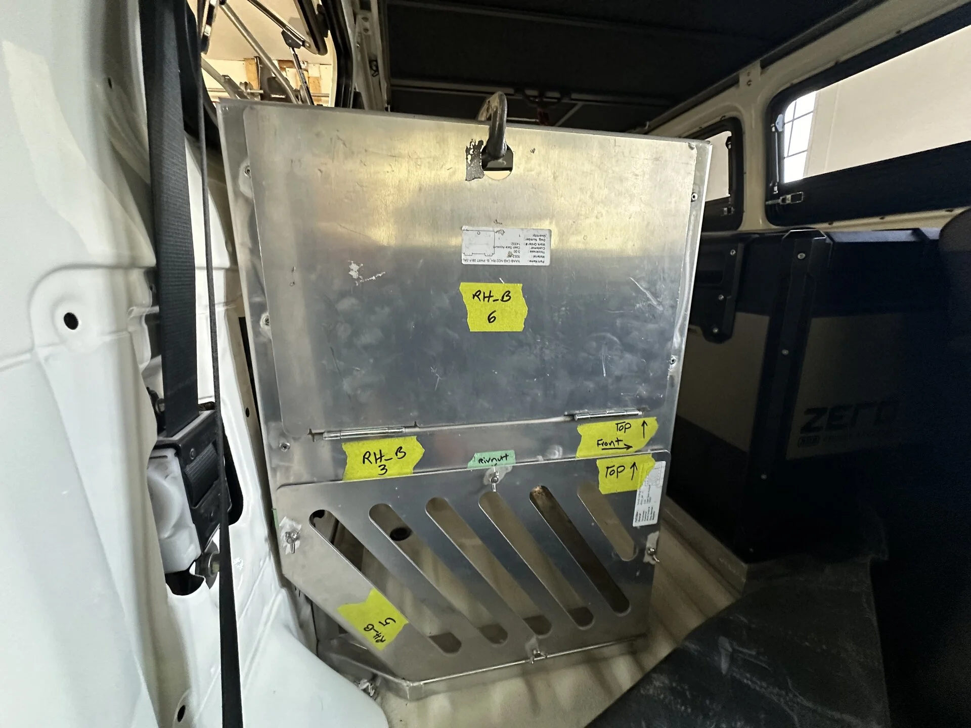

Another question, unless I'm mistakin' (likely the case) you changed the location of the vented piece of the cabinet where he mounted his batteries. Just wondering why and if its something i should consider. Thank you.

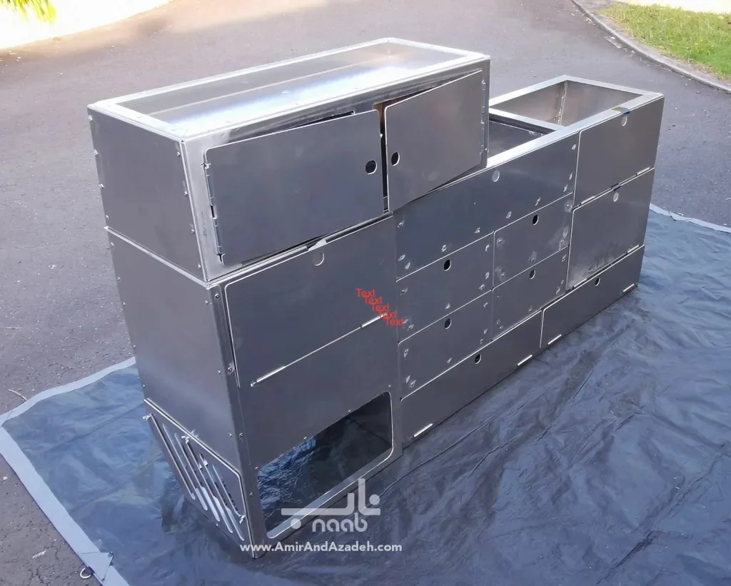

May i ask why you are doing a frame instead of how Amir did his? I am asking because I have his cabinets coming so all information is helpful.
Hey Mate! Building a frame to fit the cabinets on the floor holes and wall hole (frame will be welded after to the cabinets) the reason is for removing and installing the real estate behind… pump , coolant tank etc it’s easier to build a frame and work with it for bracket
See photo
I have not changed the battery cabinet as per our design ?
That makes sense, sorry maybe you just have the cabinet set in differently for the picture (battery vent panel with wingnuts) because the vent cover was facing the fridge how you had it set in your troopy. Also, just based on the picture for that same cabinet on its side welding the frame to it, it looks as if there is a door that would open above the vent panel and not a solid sheet (no openings) above the removable vented panel. Again i was just basing it on the pictures that was why i was asking. Jealous of the progress, still waiting for mine from NZ.
Thanks
for pointing this out mate I appreciate we have maybe a mistake then
So you added a door above the vent panel? I like it assuming so you can access electrical easier?
Absolutely no worries I am here to help and share 🙏🏻
Yes added this little door on the passenger side to store essential items since the space between seat and cabinets are very tight I took this initiative to store cameras are coat anything you need to grad on regular basis
