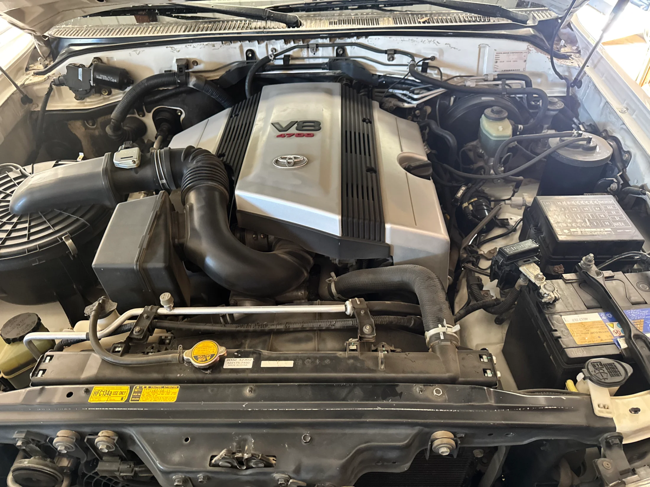

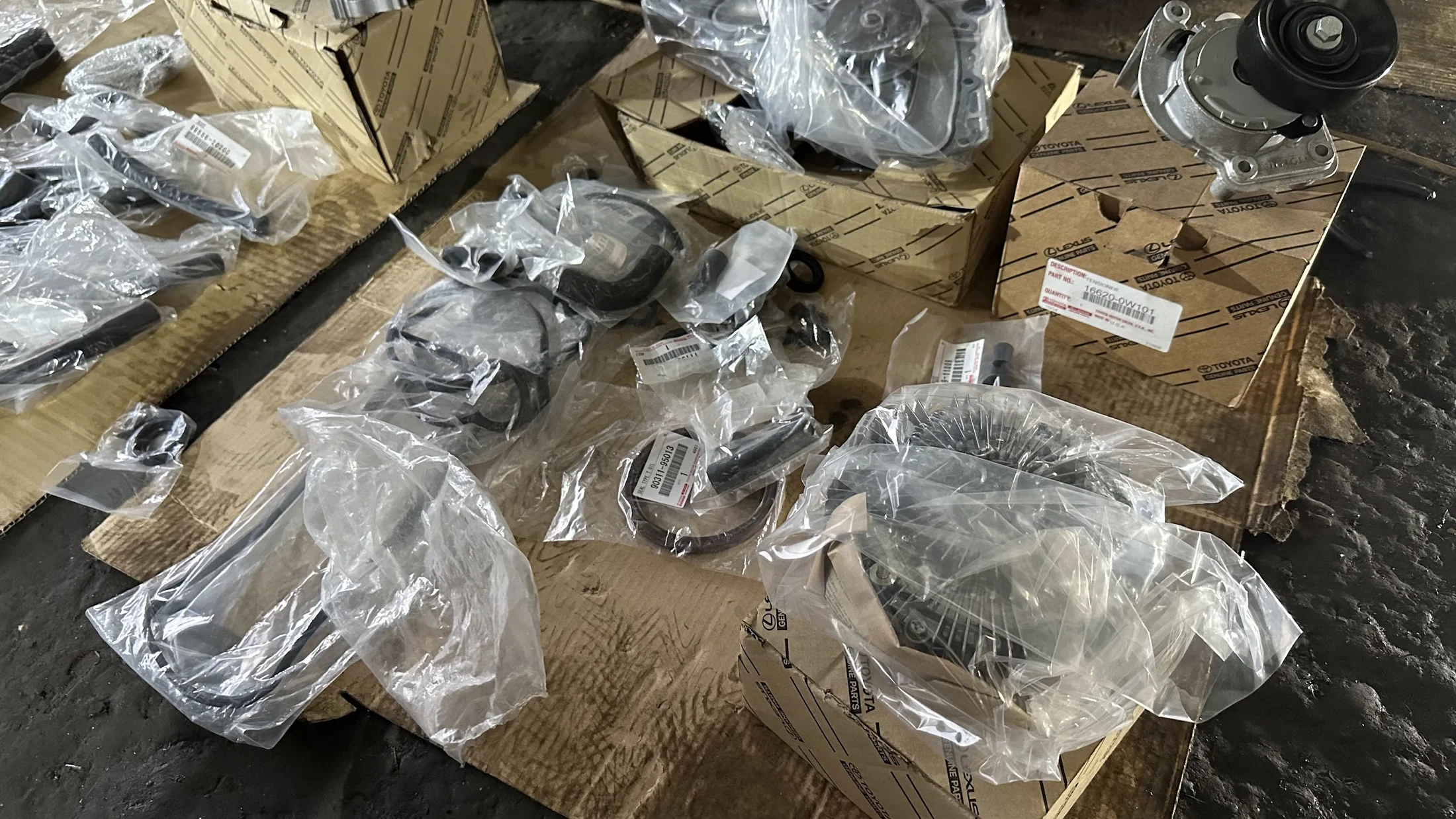

Some samples from my 100 project:
Engine service and all new stripes

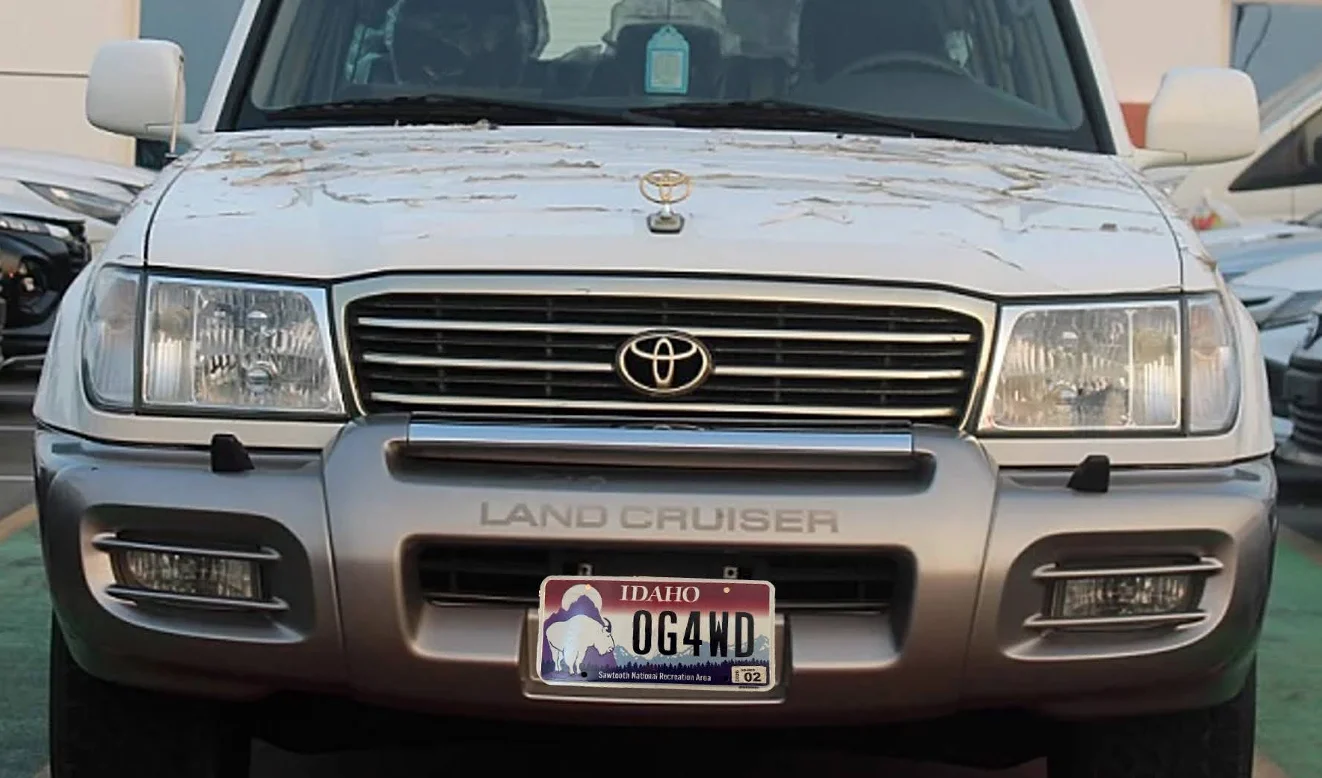

Will “Banana Split” fit on an Idaho license plate? 😁
