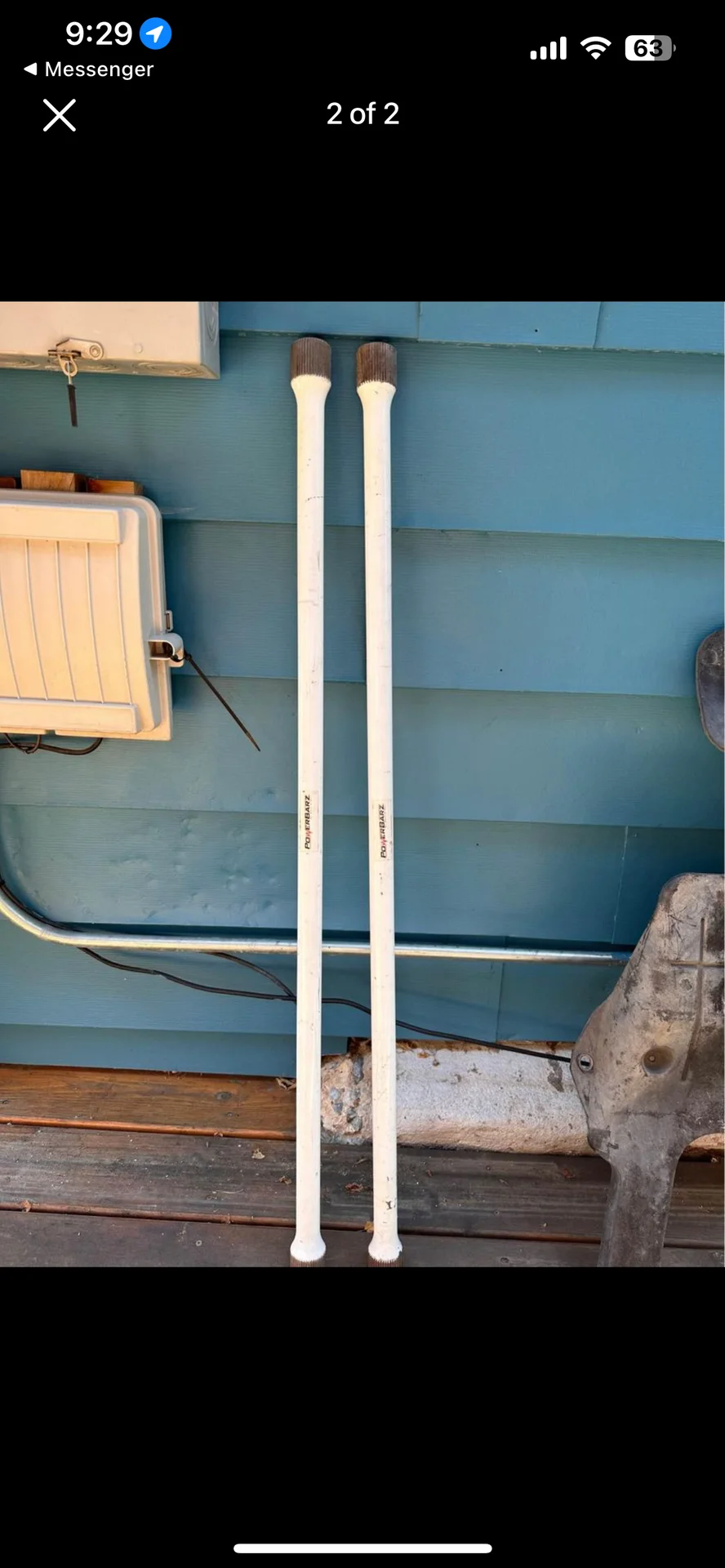

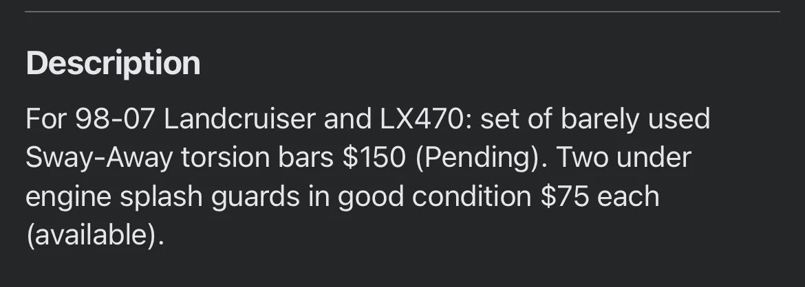

If I can get a set of Ironman torsion bars for $100 (slightly used) should I buy them or still do the re index? See photos

The iron mans, at least the ones I bought, are heavier duty, made for carrying increased loads. The bars are much thicker than the stock ones and result in a stiffer ride. Stock ones would be more compliant and ride better if you arnt adding weight.

If I remember correctly, the Ironman torsion bars are about the thickest that you can get, at 32mm. I would not put any of the 32mm torsion bars on a mostly stock 100 series. My first choice would be to re-index the OE (non-AHC) torsion bars, with a distant second being the OME aftermarket torsion bars.

I have 3 100 series in the driveway, that are on the “lighter side”. One factory front bumper. One factory front bumper, hidden winch mount, and 10k winch. One ARB front bumper, and 10k winch. I have two sets of 32mm torsion bars sitting on a shelf, that I can’t find any reason to (re-)install, regardless of adding aftermarket weight. The OE bumper, no winch, runs OE. The two others run OME, and I’d probably move them to OE, if I could find them at a reasonable price.
Preloading the torsion bars for “lift” reduces droop (or down travel). Increasing spring rate reduces uptravel. Both affect ride quality.
(You’re not missing anything but poor ride quality)
Reindex. It’s less work and it’s free. You’ll gain nothing worthwhile with those.
After I added a new bumper and winch, I just cranked up the stock bars and got my 1.75" lift. I have a set of OME (Old Man EMU) bars on my LX that I thought about moving. Nah. I'll just reindex OEM bars. Nothing more painful than being oversprung. You can reindex for free.
