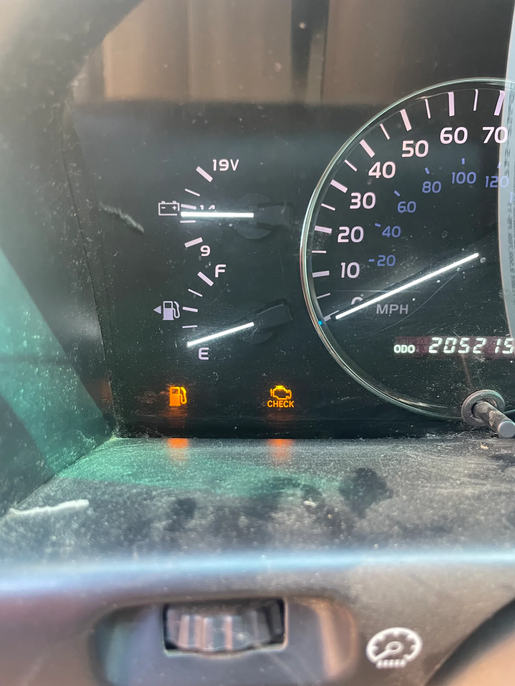

Ok Team # Just start the damn thing and stop overthinking it won the day. I was shaking with excitement/filming when it started and went for an uncomfortable hug with the PO.
Now listening to it with headphones, sounds like a tensioner or something is squeaking a tad?
+ Also had some initial smoke come out of the car, area seemed behind the air intake side, between that and passenger side interior wall of engine bay.I forgot to blow out the engine bay / check for rats nest. I just checked the air filter the other day and it was bone white, so I imagine some sort of oil leak or something touched off. I blew out the bay with a leaf blower. Started back up, let it run, the smoke went away. it was fine, white, mist almost. The Coolant/engine level stayed in the middle after all that time.

Note to self, Was it having a rough time going above 2k because i needed to let it warm up? its about 80degrees out here today.
Probably a good idea to disconnect battery. That noise sounds kind of like a pulley bearing going out. Is the check engine light on? If so, do you have a code reader to check the code? If yes, please share the code.
no that was before it cut on, i was just excited it was alive, ill check again before d/c`ing battery. Yeah good call, us. No code reader or nothing, ill add it to the list. And will also need proper tools. I just have a socket wrench set and a random screwdriver at the moment...

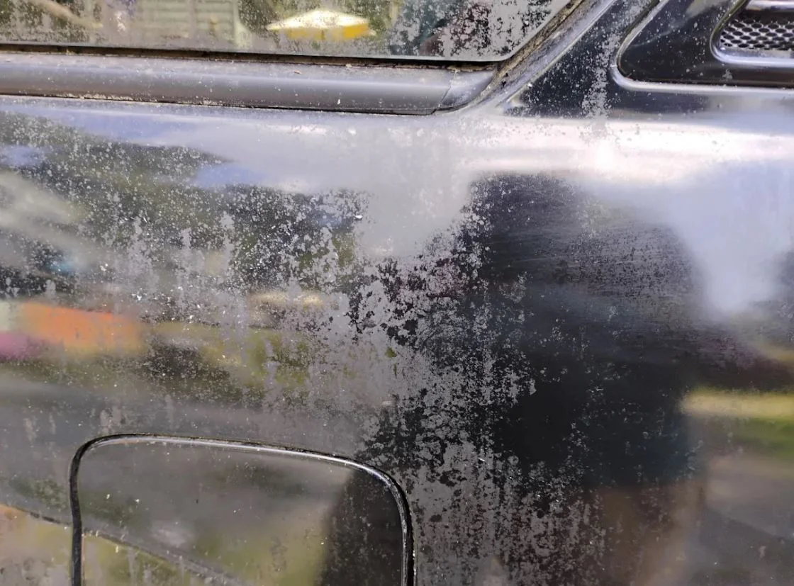

Have some weird debris or something on the paint. Moss, something organic. It will scrape off with my nail. I did make a clean spot with some car soap / lemon *lemons also came in handy cleaning off mildew/mold in car(well car was a cleaner + vinegar + lemon* but, looking into whats the best way of doing it. I can see her shining underneath, but its small potato's compared to making sure theres no nests/anything behind the panels. air filters were dirty but just seemed like neglect not chewed up or anything, both of them. So far soo good. Medkit was still in there, no rats in there, the spare, that all looks clear, cargo carpet underneath looked ok. No glove compartment critters, under seats, no feces anywhere.

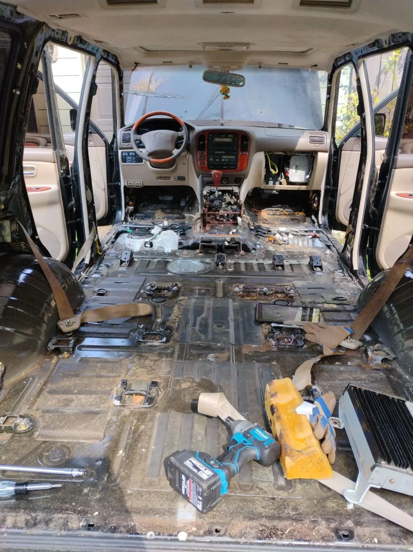

View attachment 3982717View attachment 3982718View attachment 3982719View attachment 3982720View attachment 3982721
Glad you got it home uneventfully. Congrats!
Oh it was eventful, if you look closely you can see me leaning out of the window Ace-Ventura style. It was absolutely pouring down and the sap/moss -- i couldn't get off the windshield for anything. But I was only a few blocks away. So, sent it. Wearing a respirator mask and bio gear, lol. what a day. --but thank you.
Removing car interior is like climbing a tall ladder, as long as you don't look down its ok. Then,, well, you look down. Anyone know what part # that yellow foam part is? it feels sort of dry/crunchy. Not sure if thats how its supposed to be, or its importance.
Center console metal was super rusty, surface mostly, any tips on cleaning that up? Just since, well, im here now. lol.
Likely buying new carpet, and some of the mold really stained the interior pillars and parts. Shoutout to that fellow Cruiser Patch. I only broke 1 part, and slashed my hand once! Blood sweat and tears for sure. Anyone know a good foam pad underlayment to use? I'm thinking of grabbing some Manichi floor mats and just running black underlayment. I've seen foam people cut but no idea where to buy?
No one mentioned that one should disconnect the battery befor eremoving car seats. Well I'm past that point. Any fun going to be there when i reconnect seats / attach battery? I've just been starting it occasionally, but when i removed the seats, it was a few days since last start up. Battery is now disconnected.
I'm seeing ABS nightmares if you don't disconnect battery and remove seats, or codes... So far I haven't exploded myself.
ALSO, for the algorithm. REMOVING CENTER CONSOLE LX470, REMOVE MAT INSIDE OF CENTER CONSOLE TO REVEAL BOLTS TO REMOVE. That took me 20 minutes too long to realize. Its a little felt or something that covers them up.
