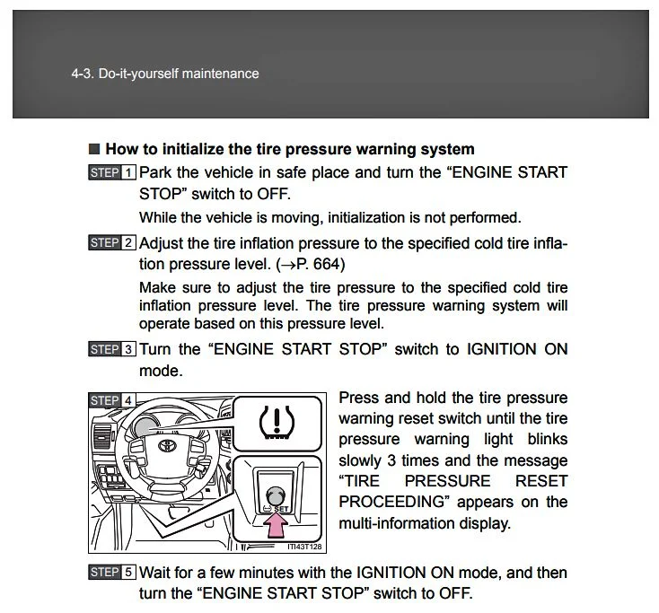

Don't forget to initialize your tire pressure warning system to the new pressure:

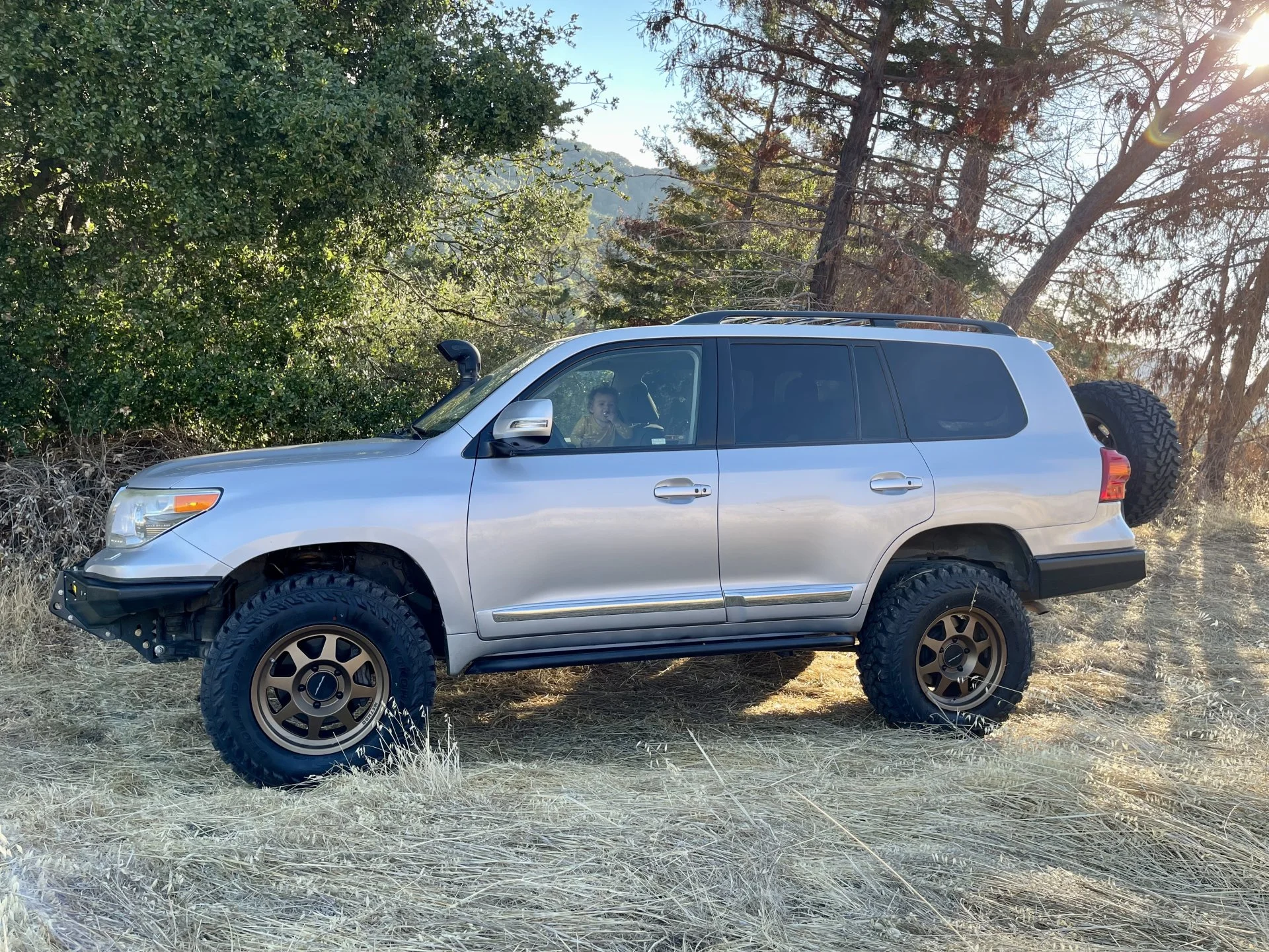

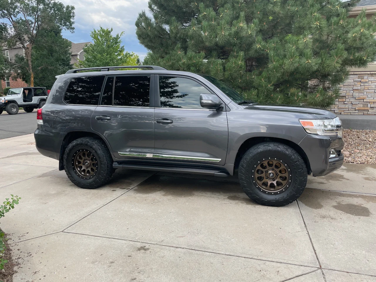

1st time LC owner and just picked this up about 2 weeks ago. 2017 Metallic grey with terra interior. Got the tires mounted today, just waiting on some free time to install a lift on it. Got the Stealth Custom Series Ray 10's in Matte Dark Bronze, 18x9 +25mm, wrapped in 305/65/18 Toyo Open Country A/T III's.View attachment 3019897View attachment 3019900View attachment 3019898

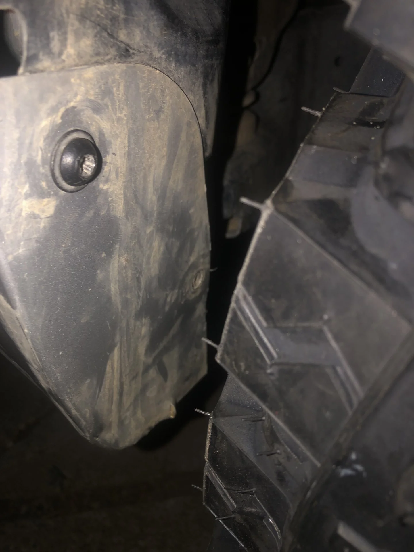

Here they are mounted. 305/65/18. Front fender liner mod and mud flaps delete. Still get some minor rubbing. Next up is a lift kit in a few weeks .
Here they are mounted. 305/65/18. Front fender liner mod and mud flaps delete. Still get some minor rubbing. Next up is a lift kit in a few weeks .View attachment 3076989
Nice full looking tire. Curious to hear how it rides though since it’s a heavy F2 load tire and wide. What made you go with this size over a 295/70r18?
I haven't noticed any significant difference over the previous stock tires. Seem just as soft and the noise is about the same. Slight hum that I notice if I'm super picky. I've always wanted the full look and wider stance so decided to go for it with the 305s. Just sticks out past the fender like I wanted it.

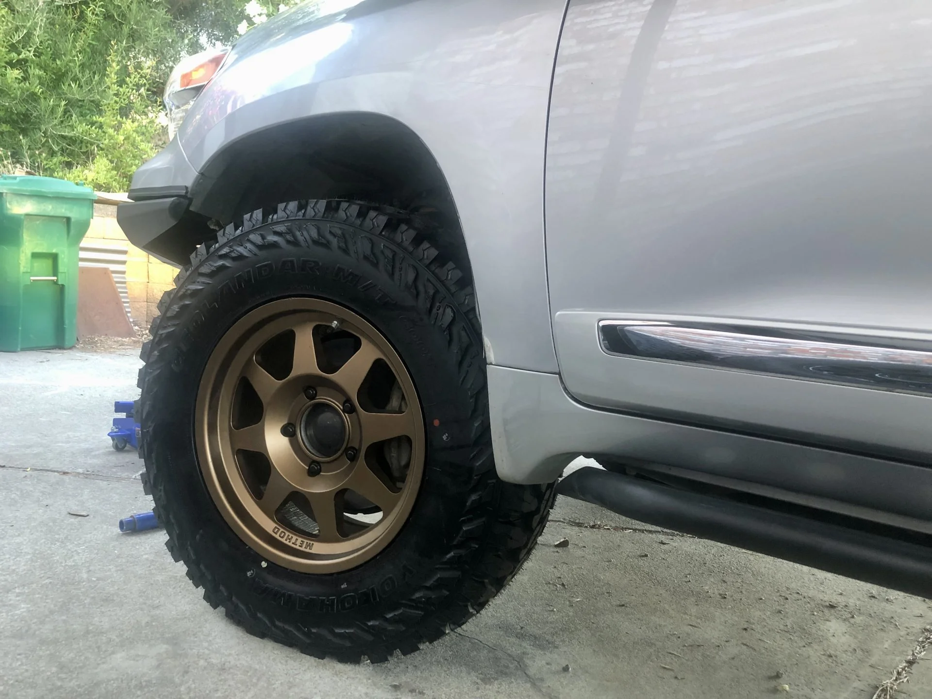

Long time in the works and finally made the jump to 34” tires. Installed LT285/70r18 Yokohama Geolander G003 MTs on Method 18x9 25mm offset wheels. Initial impressions are fantastic. Haven’t had the opportunity to get them on the highway yet but around town they have surpassed my expectations for a MT tire. This is my first set of MTs and I imagine they will get louder as they wear, so far they are ever so slightly louder then an aggressive AT or RT tire, mainly just a wooosh sound and handle Very similar through the twisties to the Kenda Klever RTs.
Clearance wise I have a good 1/3”-1/2” of room between the tire ( at full lock) and driver side KDSS sway bar. Passenger side has even more room.
I had to remove the mud flaps from the fender and trim a little bit off the plastic rocker panel cover to clear at the rear of the front wheel well. Looking forward to getting them in the dirt. @100kiwi and @1world1love for being the devil on my shoulder to get me over the hump and into the 34” club lol!

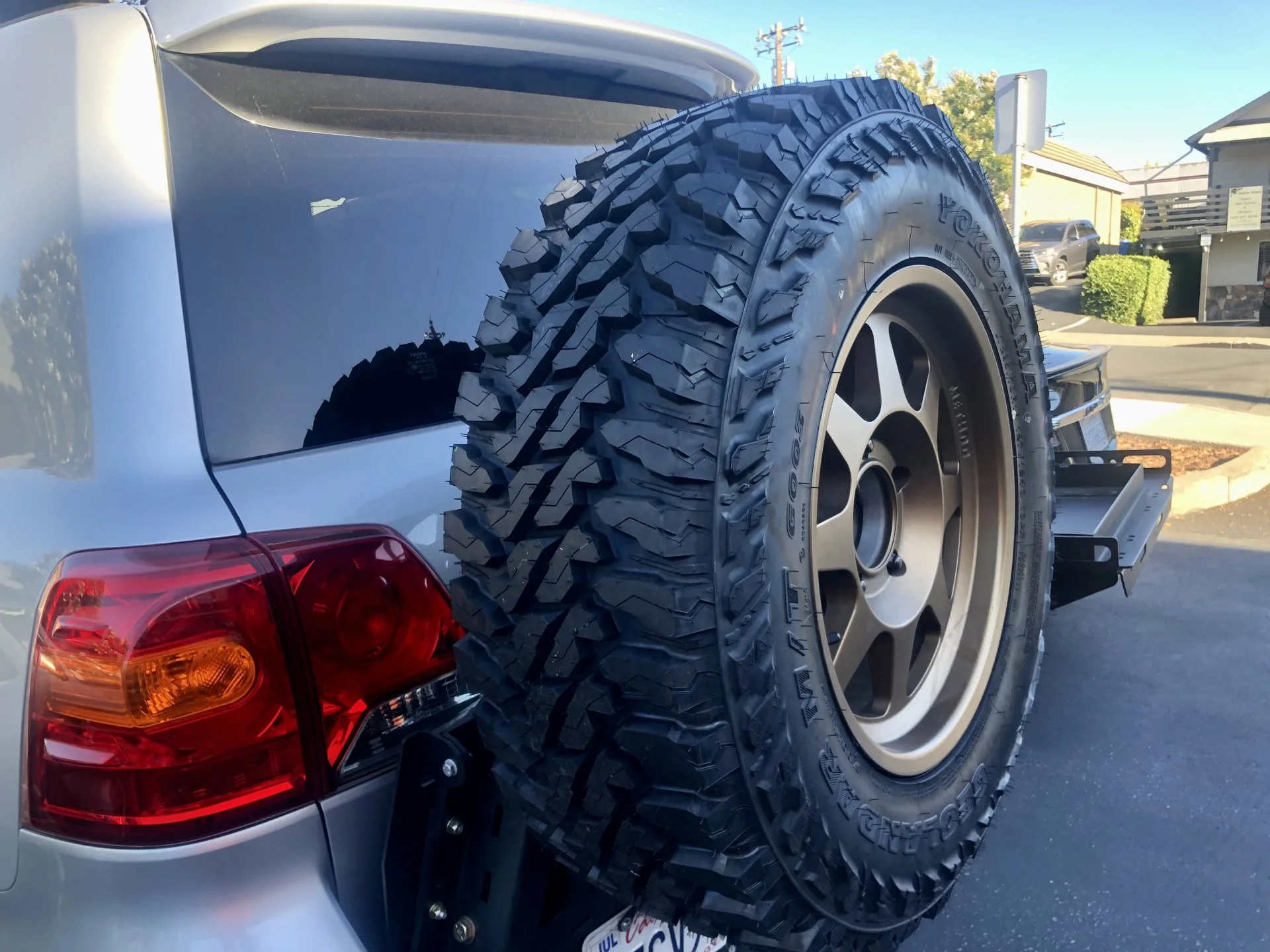

Let's see a wide shot!
Looks great! 👍
For sure! I mounted them up last night so it was too dark for a decent pic. Will get some this evening. @tbisaacs reading here on mud about 200 owners and their MT experiences, especially yours with the Cooper MTs I was honestly terrified and had nightmares about how bad my decision was to go from a RT tire to a MT lol.
So far so good, pleasently surprised by the Yokohama's mild road manners and soft ride.
I think I'll still keep the kenda klever RTs on a second set of wheels for winter use during the rainy season.
