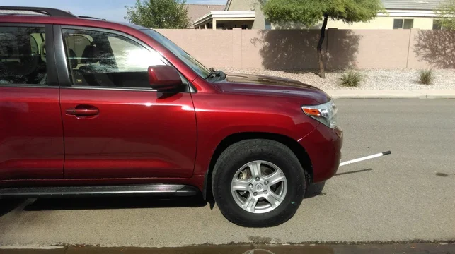

posted pics on another thread earlier today, just a mock up teasing me for the upcoming build...2007 tundra stock wheel with 305/65 Falken tire.
fit great, but maybe a little too wide for this rig....mock up 305 65 18 no lift.webp Please notice the jack handle sticking out the front...i had limited time and only put on one wheel. Not planning on running these tires so I didn't try turning to see what would hit...probably should have. (hindsight 20/20)
