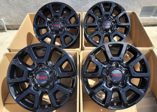

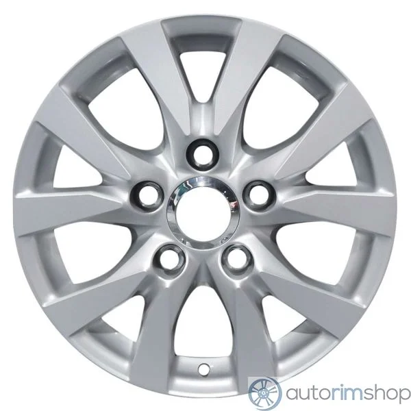

Is this the correct part # for the TRD rims for a 2019 LX?
Wheel TRD Forged Aluminum Matte Black 18 Inch - Toyota (PT960-34200-02)​
It’s either these or stock 18” Landcruiser rims. Not sure which wouid look better on an atomic silver LX. Does anyone have the part # for these Landcruiser rims? Looks like these are refurbished. I assume these bolt right on to the 2019 LX?
Anything OEM for a Tundra, Land Cruiser or LX from 2008-2021 will fit your LX. There were 3-4 versions of the TRD PRO wheel including a matte black, shiny black, and bronze option. The listed wheel is the OEM wheel for a LC from 2016-on i believe. Definitely don't buy those at a dealership. There are plenty of takeoffs in the classifieds for next to nothing.
No that is the OEM Wheel for LC 2016+
TRD PRO Back look like this.

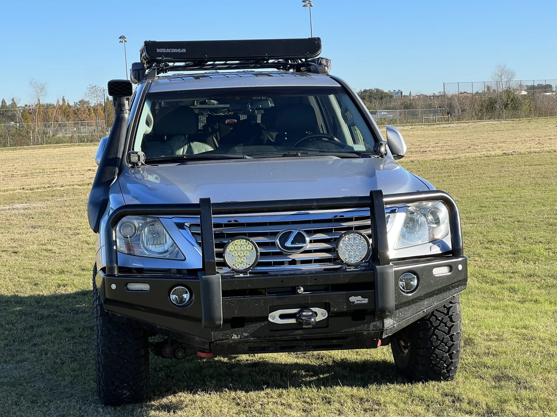

A pic of my SC’d 450….my eyes are going crossed from searching.
Yep, 285 70 r17 would fit with any offset between 0-50. 25-50 is the ideal spread.
25 is a good choice.
