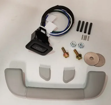

The clamp type splices are ok if you can keep them completely dry. The problem is with just a bit of moisture, the often "thin" connection between the metal blades inside and the wires gets corroded and the resistance goes up, sometimes to the point of failure. In an automotive/trailer/boat/orv/snowmobile/etc environment I always vote for crimp-type connections and heat-sealed wherever exposed.
If you're splicing why wouldn't you just use a marine grade straight crimp w/ heat shrink (w/ the glue). Maybe I'm not processing this correctly but it's water tight and can't come undone if you crimp correctly.

That is what comes in the kit :D

To be completely transparent, I had no idea how those supplied splices would work, and the instructions weren't specific on how to use them. I scratched my head for a while and just used what I already had in my toolbox and knew would work especially considering this area is protected from the elements. I'm sure most people with a lot of (electrical) experience could have figured out how to use what appeared to be pin splices, but I wasn't comfortable guessing how they would work and didn't find any info in the instructions. I was able to get it working using my chosen method which is all that matters to me though.
Hmm, we certainly neglected to cover that in the instructions. They are simply a non-insulated crimp connector and the heat shrink is to be used to insulate/protect after you splice with the butt connectors. We can update the instructions in the future.
