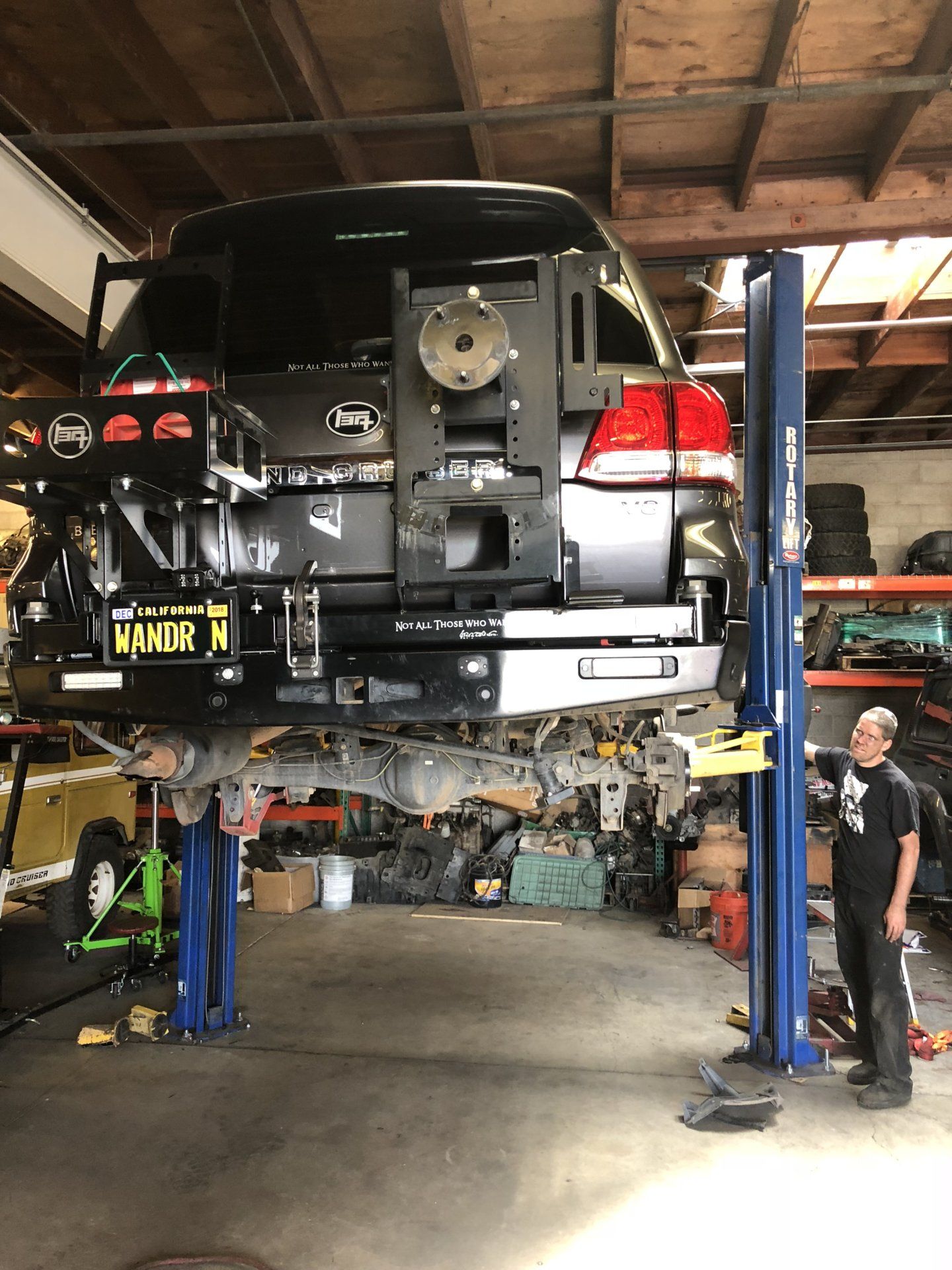

Wonder what's going in there?!? Almost looks like there's room for an auxiliary gas tank there... Going to delete the resonator while the patient is open?
You be red hot!
CHOP IT OFF, CHOP IT OFF, CHOP IT OFF
Going half-cow mode (2 stomachs)...
this is awesome, congrats Markuson, where are you having the work done. I am in Orange County and may need to visit the Dr soon. Can you ask them if the half cow is possible if you are still running a full size tire (33.5) in the stock spare tire location. View attachment 1742690
You can do a 3/8th cow with spare, but not 1/2 or 3/4 cow with spare.
can you Kindly pass along the info on the company you used to purchase and installation. My email is milaadf at iCloud dot com

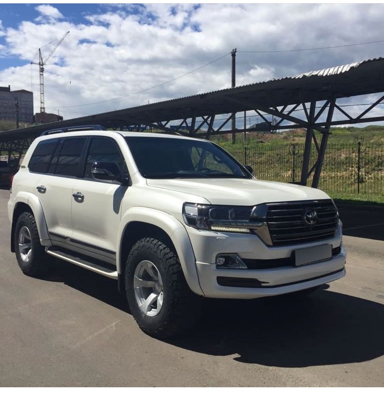

This just in regarding big tires:
I am now officially RUB FREE with my 35x12.5x17 Ridge grapplers. Wooo!
:bounce::clap::santa::clap::bounce2::steer:
How:
- @sleeoffroad relo bracket...
- Bora .75” spacers (shout out to @Willy beamin )
-Forward adjust during alignment
-Addition cutting of skirt and heat gun reshape of a couple engine bay splash guards
No cosmetic issues whatsoever on the trimming btw.
Do you know how much positive caster you add with your UCAs? I know SPC defaults to +1. The alignment guy set mine to +2 and went from there. I don't rub the KDSS but I do rub the PS sway bar. I'm already at >4 deg caster on the PS so I don't really want to go higher since I'm already above factory spec. I would've expected to easily clear the sway bar since your +50 RWs with 3/4" spacers should be around +31.25mm, and I'm already at +25mm offset with my Icon wheels, and we have the same tire but mine is 1" smaller so I would totally expect to have *less* rubbing than you do, not more.
