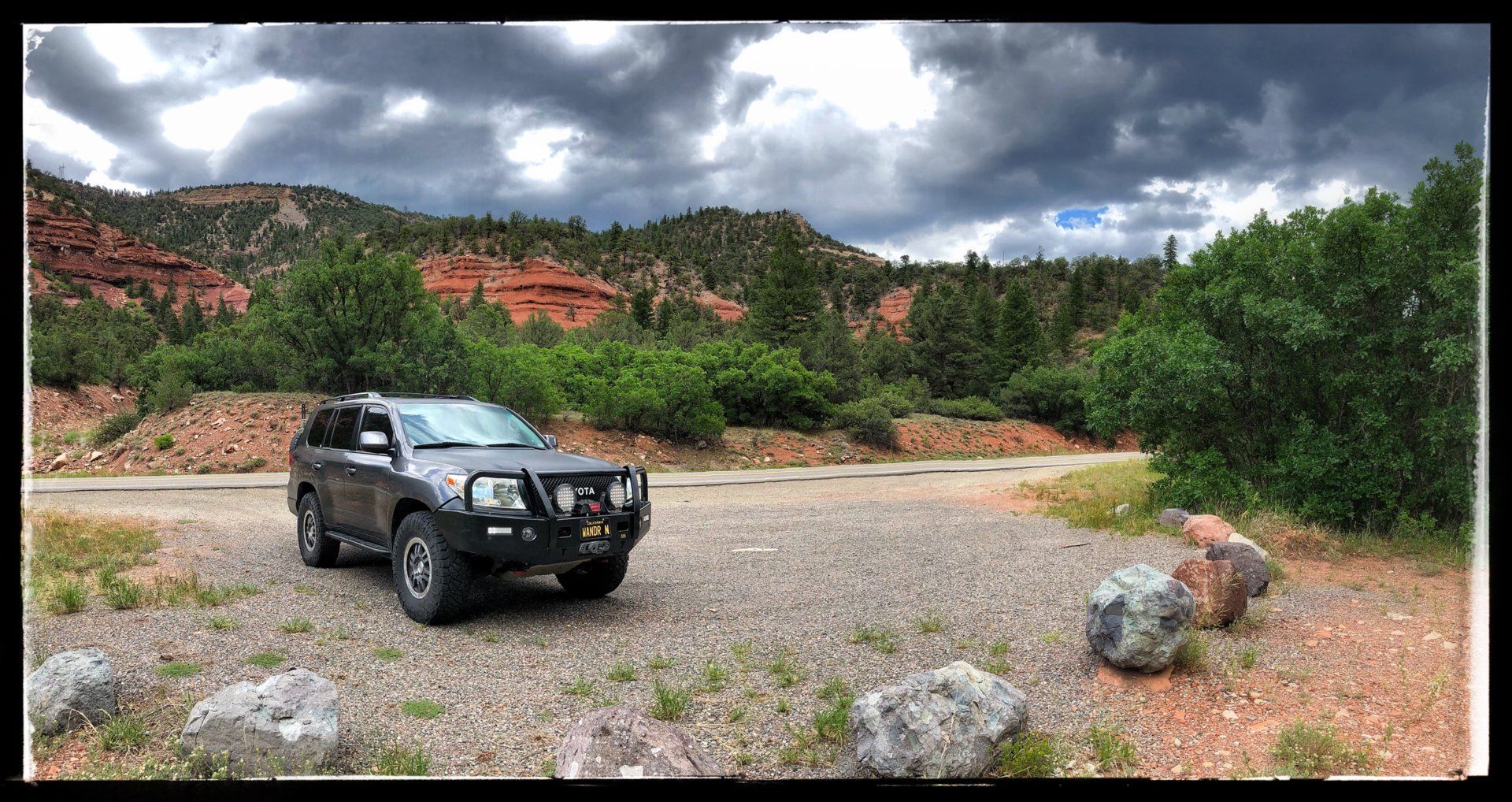

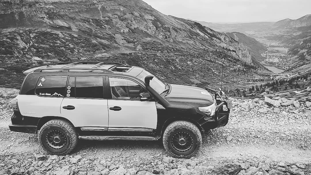

Just outside of Placerville this afternoon... About to hit Telluride...
Hell’s Gate...
