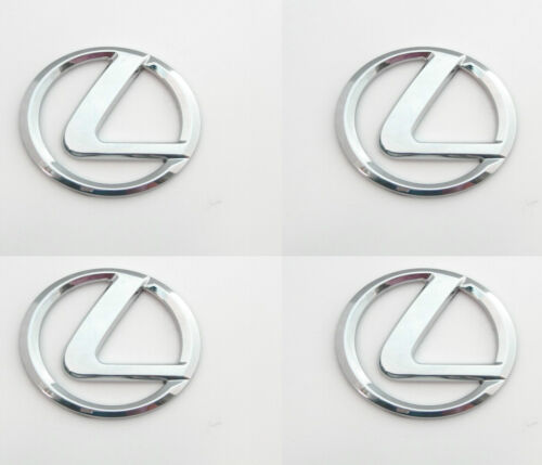

@DJCloz - Can't seem to find if you posted a link to the Lexus Emblems you used - do you mind posting the link up?
Anyone else have a link for the Lexus Center Cap emblems/logos?
I have used these also. I preffer the more oval sized emblems, but have not been able to find them in recent applications
Yea, saw those but didn't feel they had an OEM look due to the lack of "ovalness". Was also worried if they would cover up the two holes left over from the original Toyota emblem. Thanks for the reply!
Yea, saw those but didn't feel they had an OEM feel due to the lack of "ovalness". Was also worried if they would cover up the two holes left over from the original Toyota emblem. Thanks for the reply!
They don't cover the 2 "holes/ slots" but the logo sits just in the inside edge if
Both slots. Unless you are within 3'. It's pretty hard to see. I wasn't happy about the round logos either, but ones on, they do the job.
