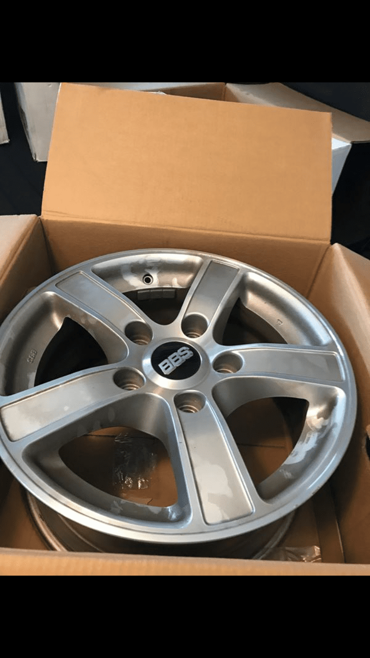

Here are my BBS 20" on 33" tires:
Does this set up require any mods? A friend told me I would likely need spacers to run those wheels; but if not that'd be awesome.

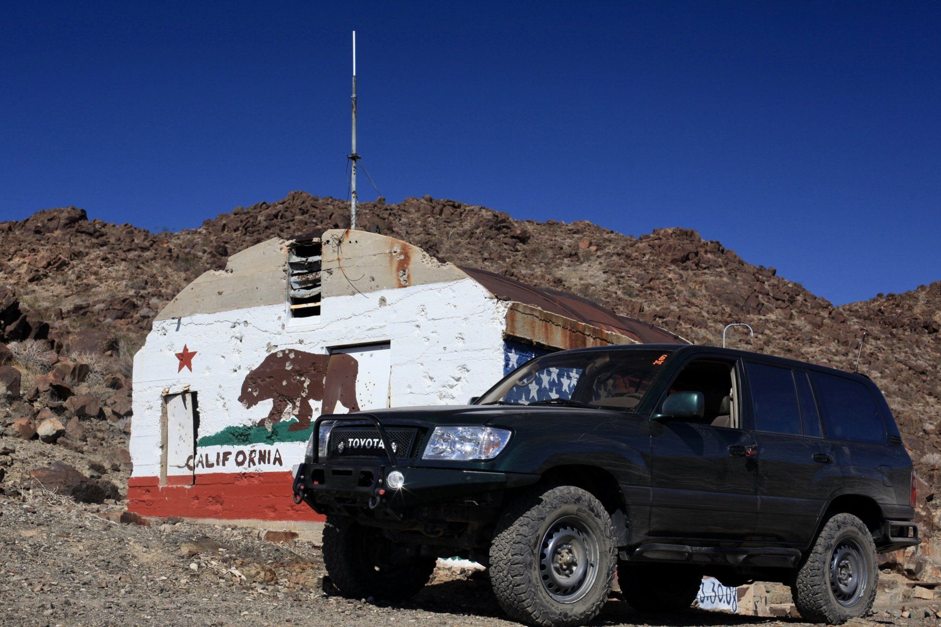

275/70/18 KO2 on SR5 wheels with 1.25" BORA spacers

Are the front bora spacers different than the ones in rear?
The spidertrax are cut in front to fit where the hub nuts are.
Yup. The BORA's look identical to the Spidertraxxx......but, black. The rears can be oriented any way you want. The fronts, just like Spidertraxx) can only be oriented in 1 way (you have to rotate them until they seat against the hub). Quality product. I bought mine second hand so they aren't all shiny new :)
