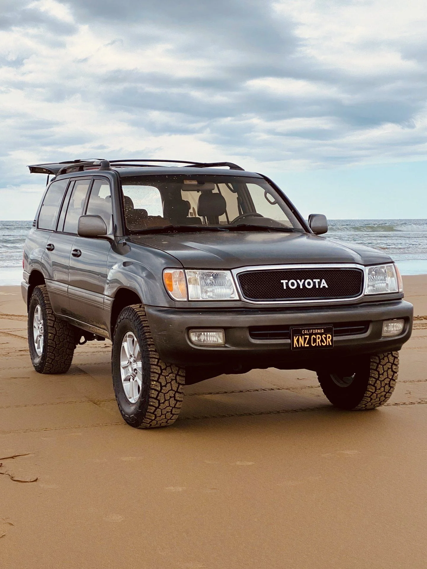

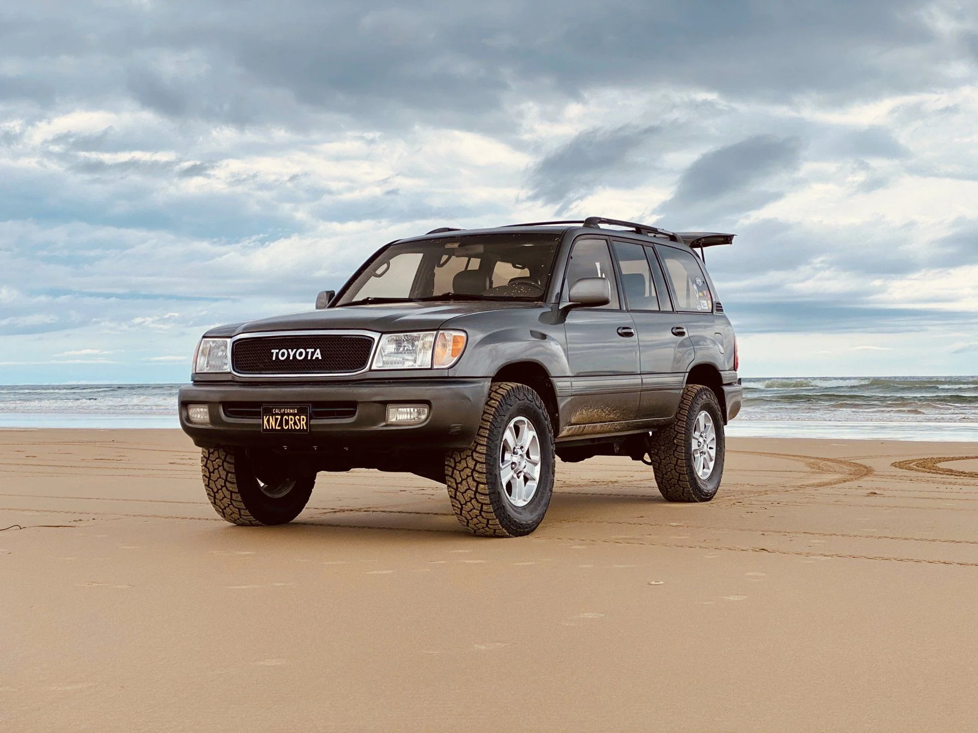

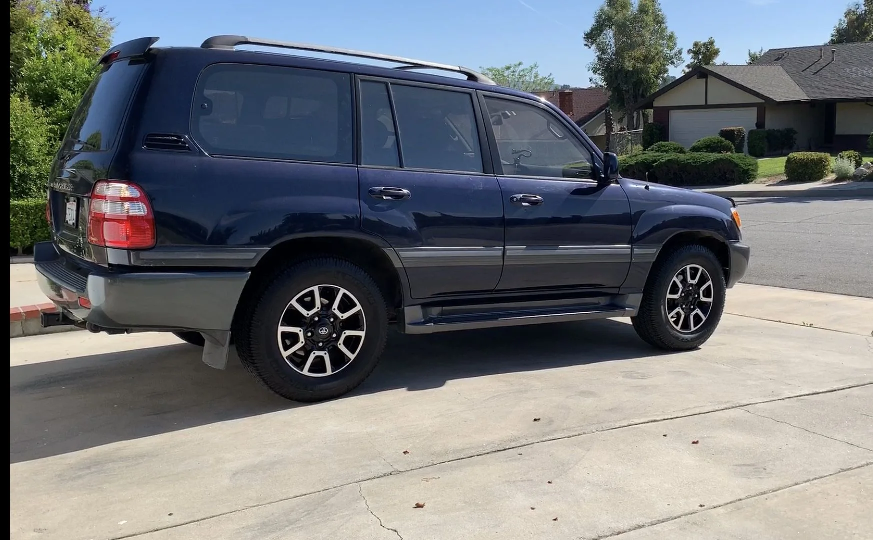

Here are my 18" Tundra alloys. I love them and would recommend them to anyone!
Sporting them on Pismo Beach, CA
Instagram: @knz_crsr

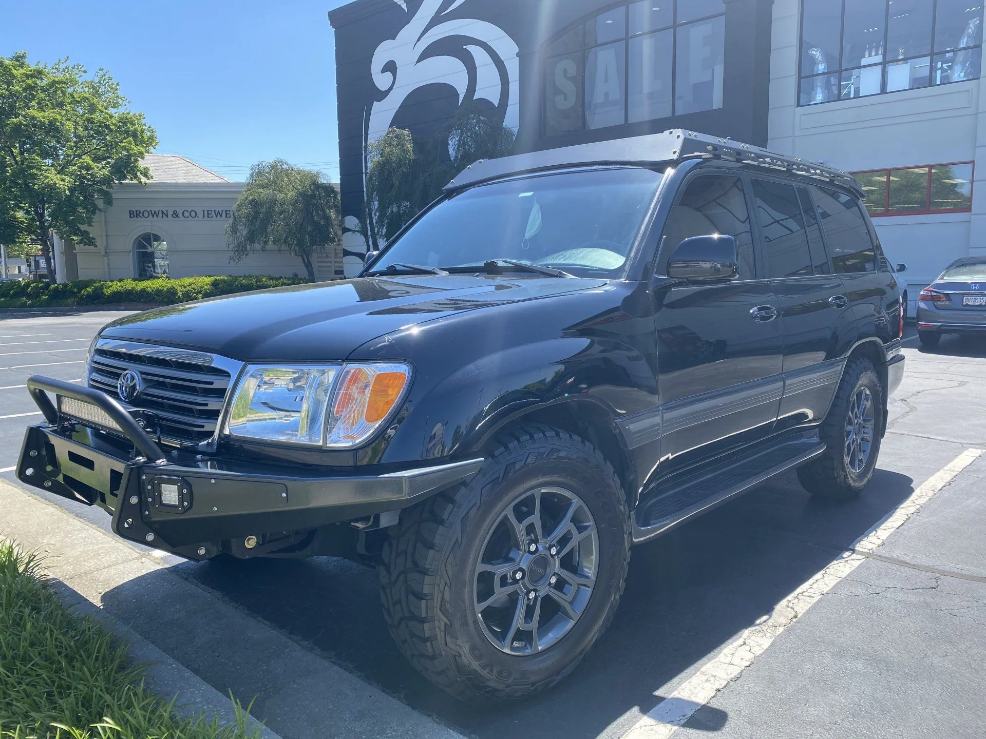

Just picked her up this morning from RPM Garage in Monrovia, CA. Tundra take offs on spidertrax spacers that I got from @sleeoffroad. They mounted Yokohama Geolander AT-X in LT275/70R18 (33.4”). Yokohama is doing a 80 dollar rebate on these and 100 if I recall on the MT-X.

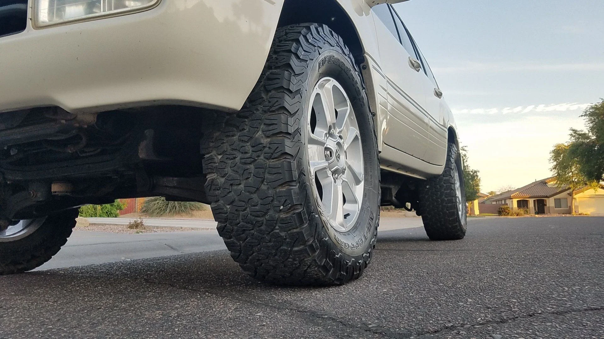

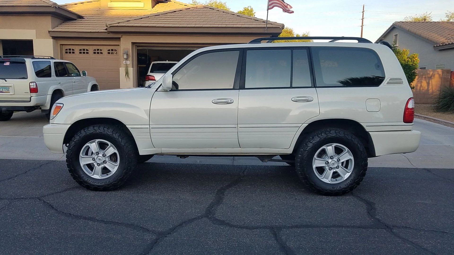

305/65 with 1.25" Bora spacers
