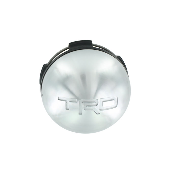

in case any one want to run Rock Warrior wheels with only a 10mm spacer, you can use the older TRD center caps part number PTR20-34071 and they fit over the hub dust cover.

Really late the game here but wanted to know what center caps did you use?
Also are these the wheels?
With these wheels, I took the 2006 / 2007 LC hubcaps and slightly modified them with a dremel to make them fit. I really like how they turned out.
EDIT: This was my 200... on this set, I used the 2010 Tundra hubcaps and replaced the Toyota emblem with a Lexus, as you can tell. On my 100, I used the LC caps, which were very slightly modified to work with these rims. (Yes, I have 2 sets... anyone want a set? :) )

Tried color matching the tundra center caps. This is Anthracite plasti dip. Looks pretty close in natural light, slightly darker under the artificial light in my garage.
Added some Lexus logos for the extra bling factor. :grinpimp:
