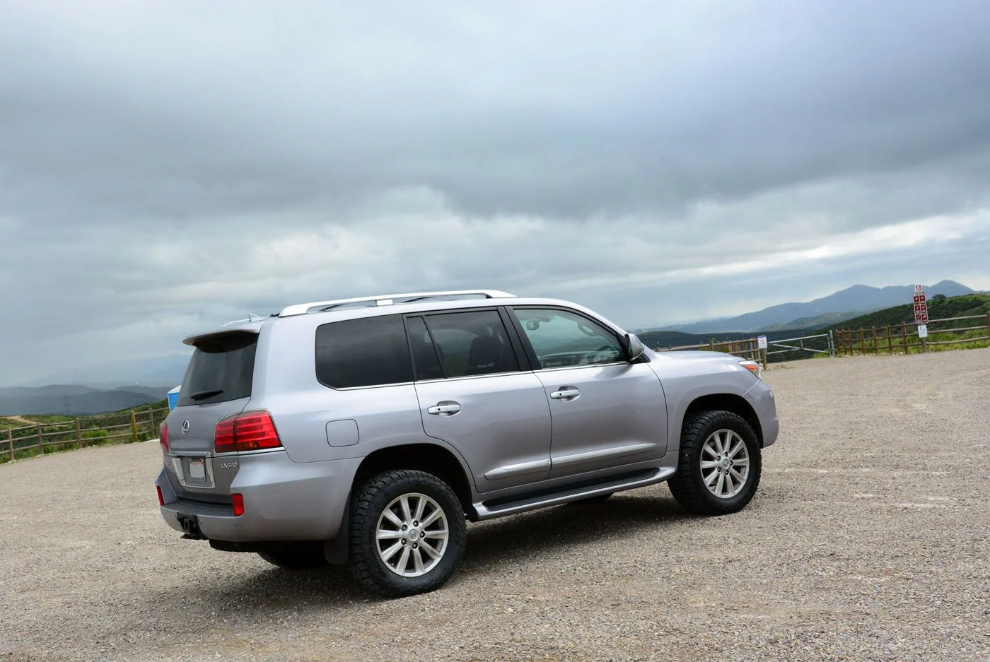

This is on the more subtle end. I disliked the stock LX570 rack as it was on the shorter end of useful length. The LC rack by comparison extends about another 12". Which is useful for ski and roof box mounts for example.

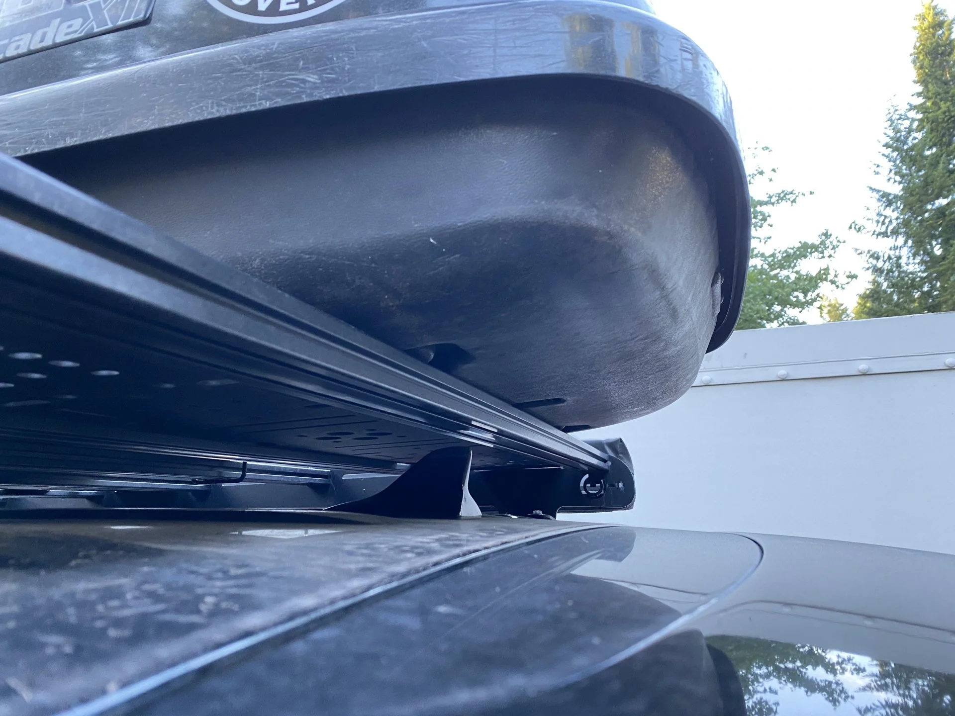

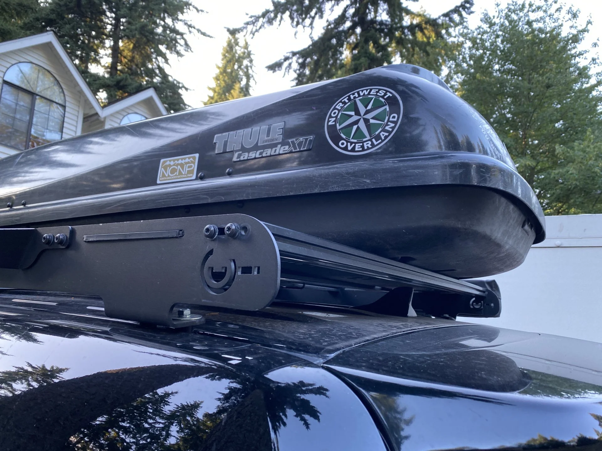

Mine clears the shark fin!
Did you have to use that extra hole in the back or normal slots?
There's a poor guy around here (i'll spare him) that had a reputable shop install a prinsu on a LC, and they forced it down over the fin - visibly bowed down over it :oops:
There is about 1/2” clearance

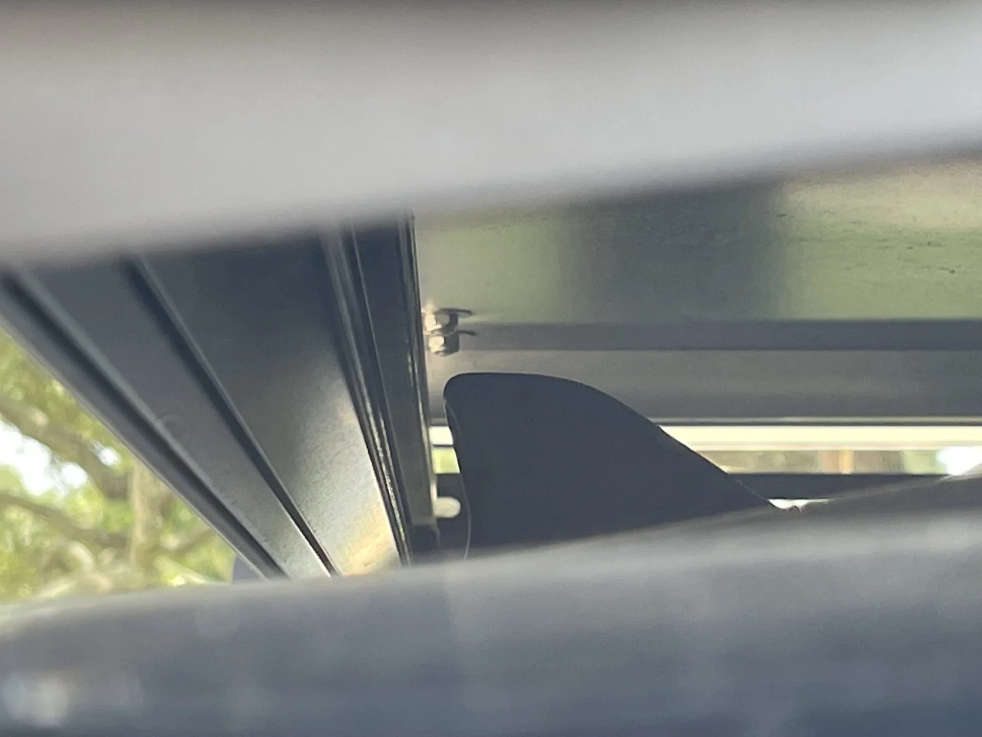

Interesting. Mine would touch if it wasn’t in this last hole:

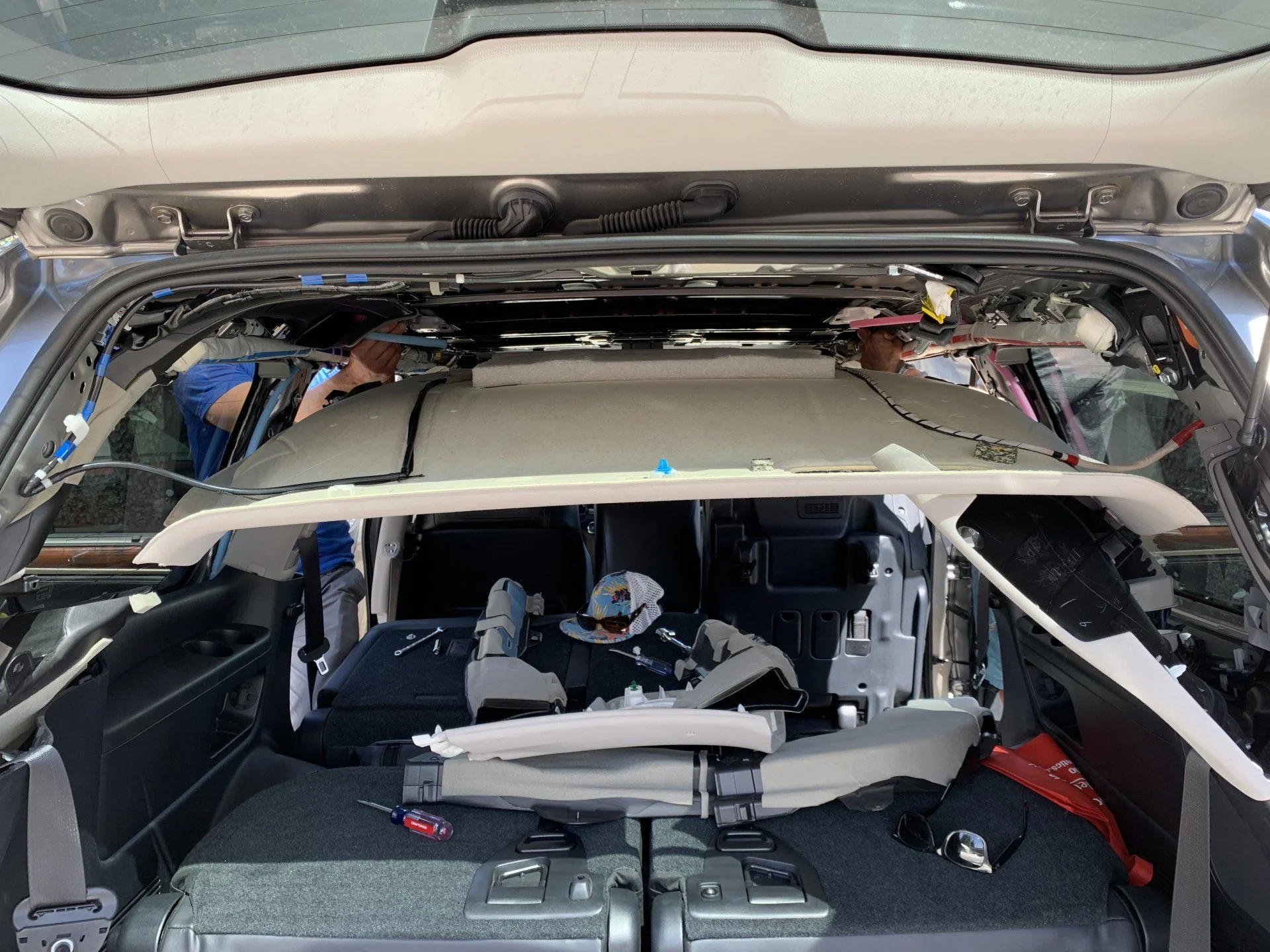

Heads up, if I remember correctly, 2016+ LX doesn’t have the captive nut plates so you’ll have to drop the headliner and put in your own 😬
Holy crap, that looks like a nightmare! I would need to do this to install an aftermarket rack? I had thought it could use whatever to current rails use (assuming rails is the right term for the silver things that run front to back near the sides)
