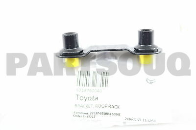

Thanks for this thread with pictures, eel32. I am planning to install an OEM rack off of a new LC on my ‘18 LX and maybe in the future installing an aftermarket one. I already have the LC rack and crossbars. But if it’s necessary to remove the headliner again to do yet another install (unlike what LC owners can do), that would be quite unattractive.
I’d been guessing that I could buy and use whatever devices holds the LC racks to the LC roofs. But is this lack of threads that you referred to (quote - “As mentioned in other threads, the holes in the newer model LX's are not threaded.”) going to require the headliner be removed for each install as mentioned above? Of course, I could buy once and instal once but I’ve already got the LC take offs. Just wanting to understand what I’m getting into.
This is what is in the older models, including my '15 LX. Assuming the diameter of the gutter holes is correct, I don't see a reason why you couldn't use them.
It's a tough call and I don't pretend to know enough about this stuff to hand out advice. I hate to say it, but I would have to assume you'll need to drop the headliner to add an OEM or aftermarket rack on a 16' or newer. However, that ebay link @radman attached might be your ticket. Others have also talked through using Nutserts. I didn't have the tool to install them. Some type of rivit tool to seat them in the hole from what I understand...? Sorry I can't be more help.
Thanks for your reply and especially the link, radman. If my understanding of what I’ve read about installing a 3rd party rack on an LC (and pre-16 LX’s) is correct, you remove the existing OEM rack from the top, being careful not to lose access to the “things” under the roof (and above the headliner) that the bolts attach to. With the flush mounted rails on the 16+ LX’s, I realized that removal from the top would not be possible. Now, I see a path where dropping the headliner would only have to be done once, since utilizing these brackets, switching out the LC rack with another stronger aftermarket one would be like what LC owners go through.
I am also going to assume that the holes in the LC roof an the LX are identical in size and location. I’ve seen pics of current model LC’s with the same flush rails that I have (non-US models). Apparently, Toyota will equip models as appropriate for the various markets, like LC’s with AHC. That makes sense.
No, you’ve been very helpful by posting those pics and comments earlier. Much appreciated. They illustrated for any of us 16+ LX owners what amount of work is required to remove the flush rails.
[/URL]
from memory only that product looks right. The concern will be making sure you get it “stuck” to the underside of the roof in a way that prevents it from falling into the headliner when you remove the rack next time.
To be clear...there is no non-destructive way to remove the factory rack without lowering the headliner. The eBay link part goes on from the underside.
