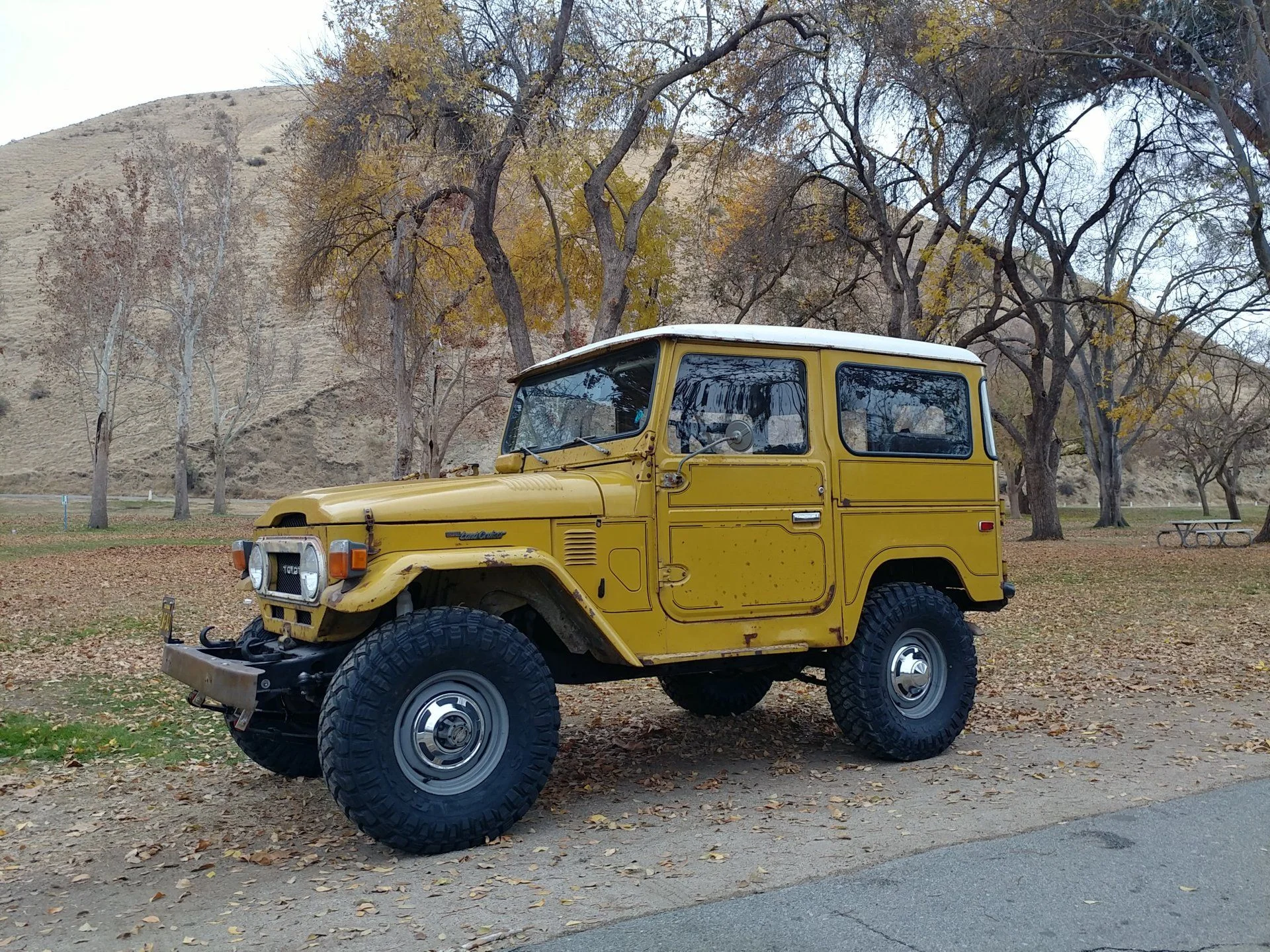

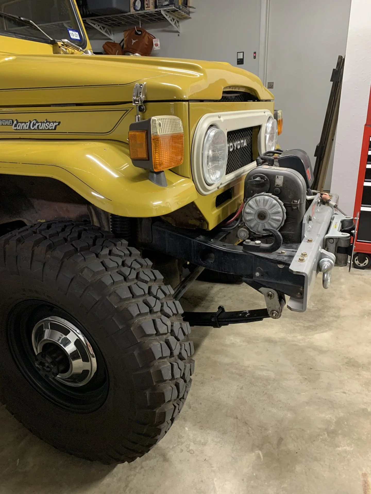

I’ve had the OME 2.5” kit for about 10 years and recently went to 4” Skyjackers up front. I like you had extended my front shackles to try to keep a somewhat level stance but was still nose down. FYI I have a warn 8274 up front with the top off.
I went back to the shorter shackles when I swapped the front springs, and swapped in longer Bilsteins 5125’s. I’m now sitting level and really like the new springs. They are slightly longer than the OME springs, my axle came forward about 3/4” to center the pins in the axle perch. I needed longer center pins in the springs (I have 4 degree shims). Shackle angle is much better than it was with the OME’s. My vote is Skyjacker.

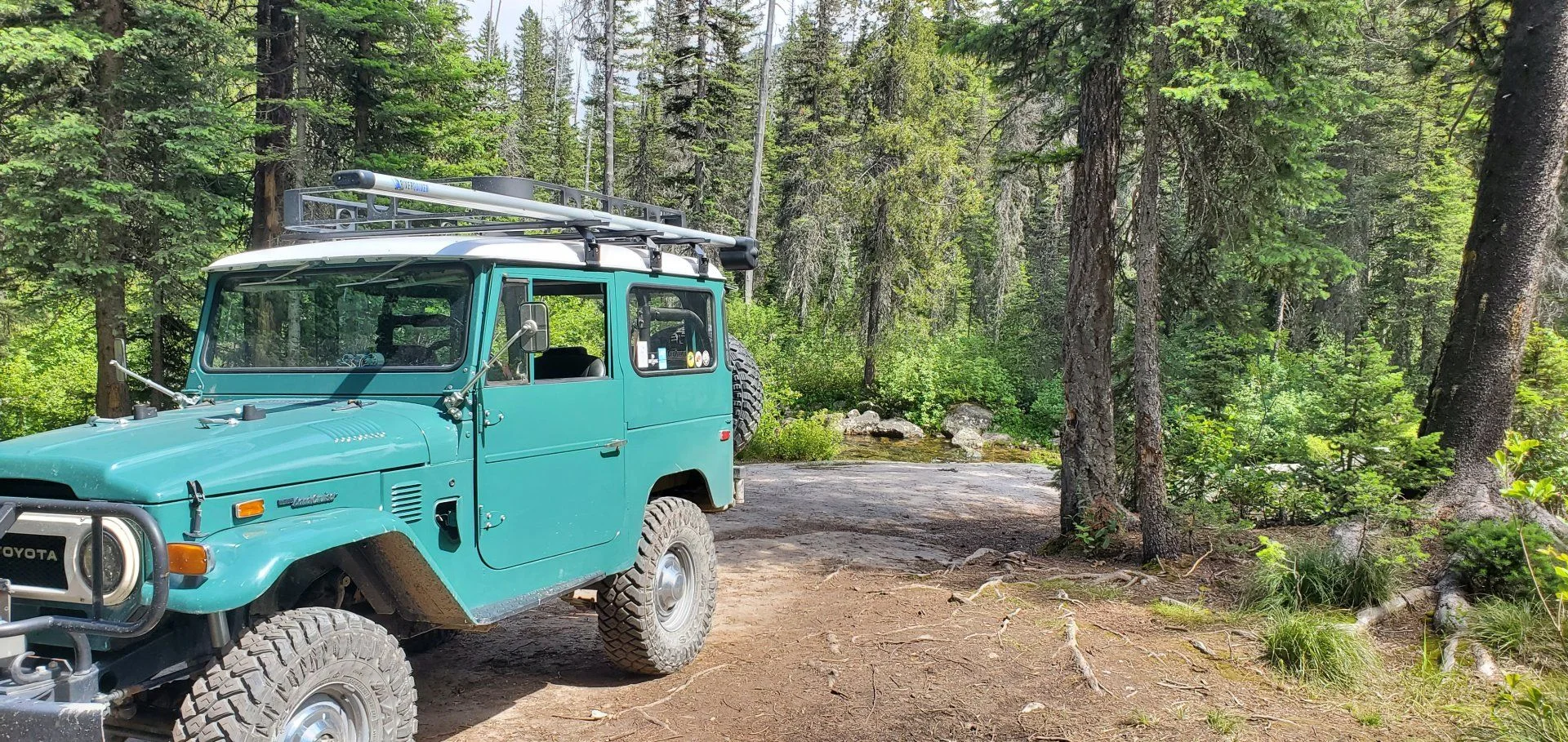

4" Skyjacker, 33x10.5 rubber, Bilstien shocks.
Rides better than my Tahoe on rough roads.
Are you still running OME 2.5" springs in the rear? By shorter shackles, do you mean stock length? It looks like your shackle geometry is about right. Did you shim both axels?
At this point, I am really leaning towards the Skyjacker 4" springs with Bilsteins. I would like to see a side picture of your FJ40 if you have one.
