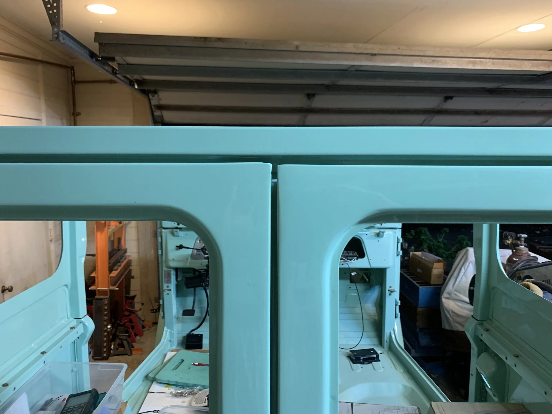

I'll imagine you have but, have you checked your corners for right angles? There's got to be a hidden reason why the doors are that lopsided.

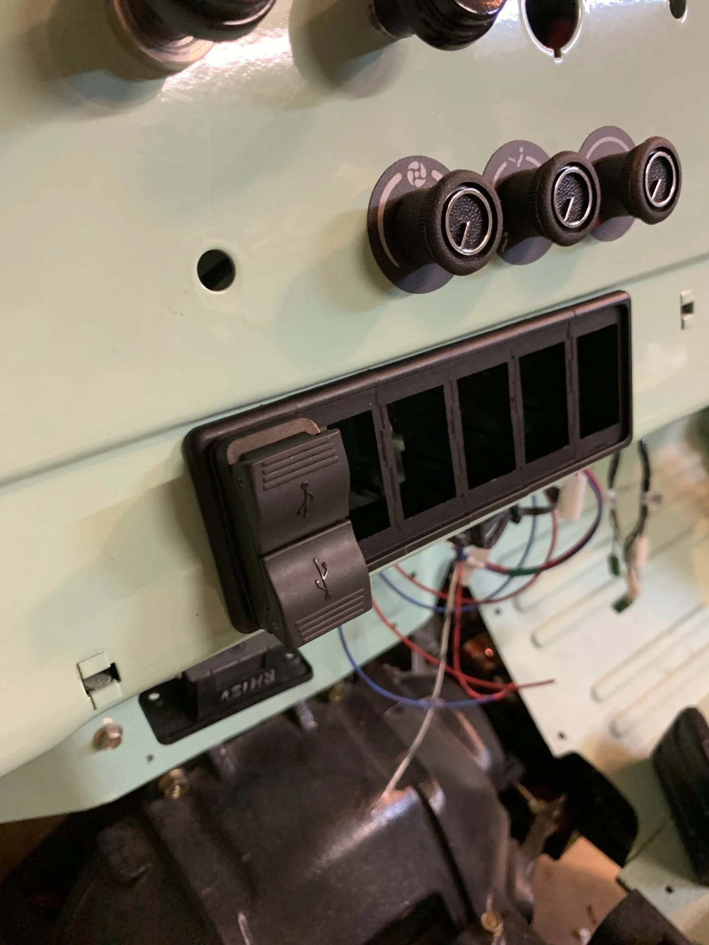

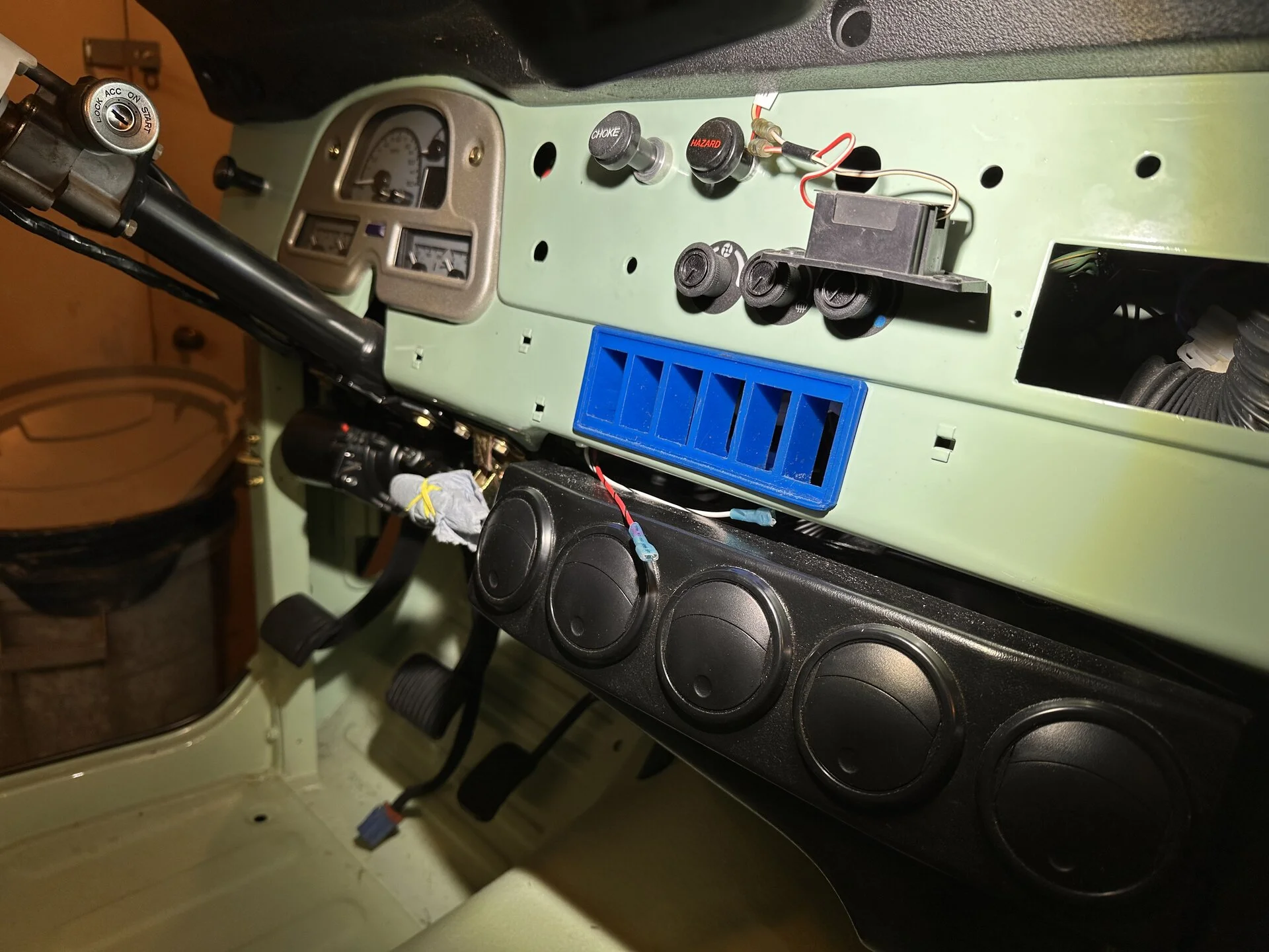

Quick update: I worked a bit on finding a proper switch panel housing for the radio hole in the dash. Documented my findings here:
Carline VM-6 Bracket with a Carline V-USB module test fit.

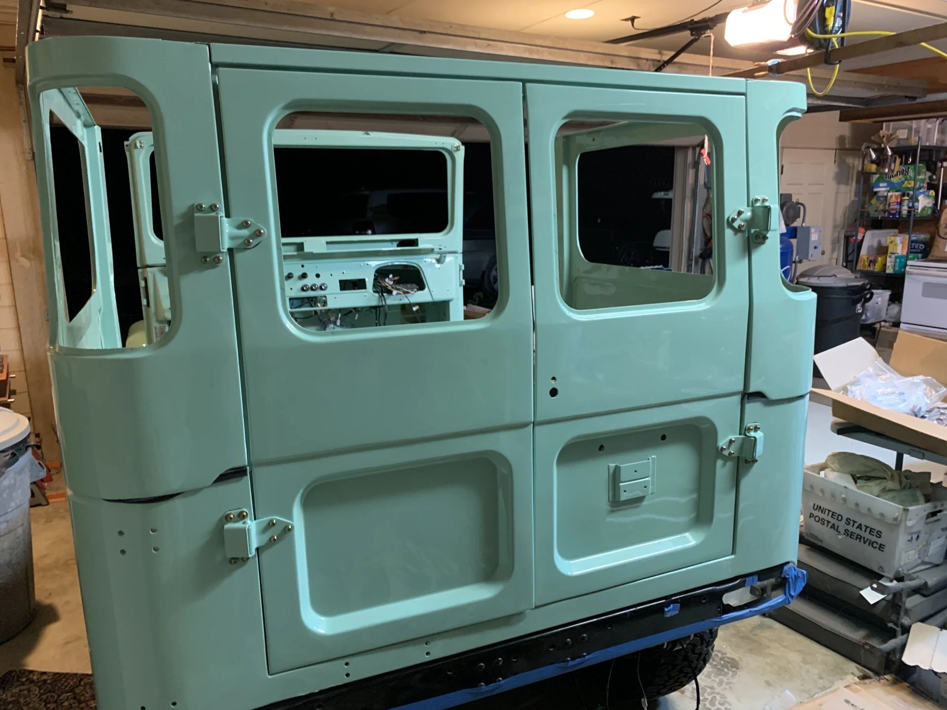

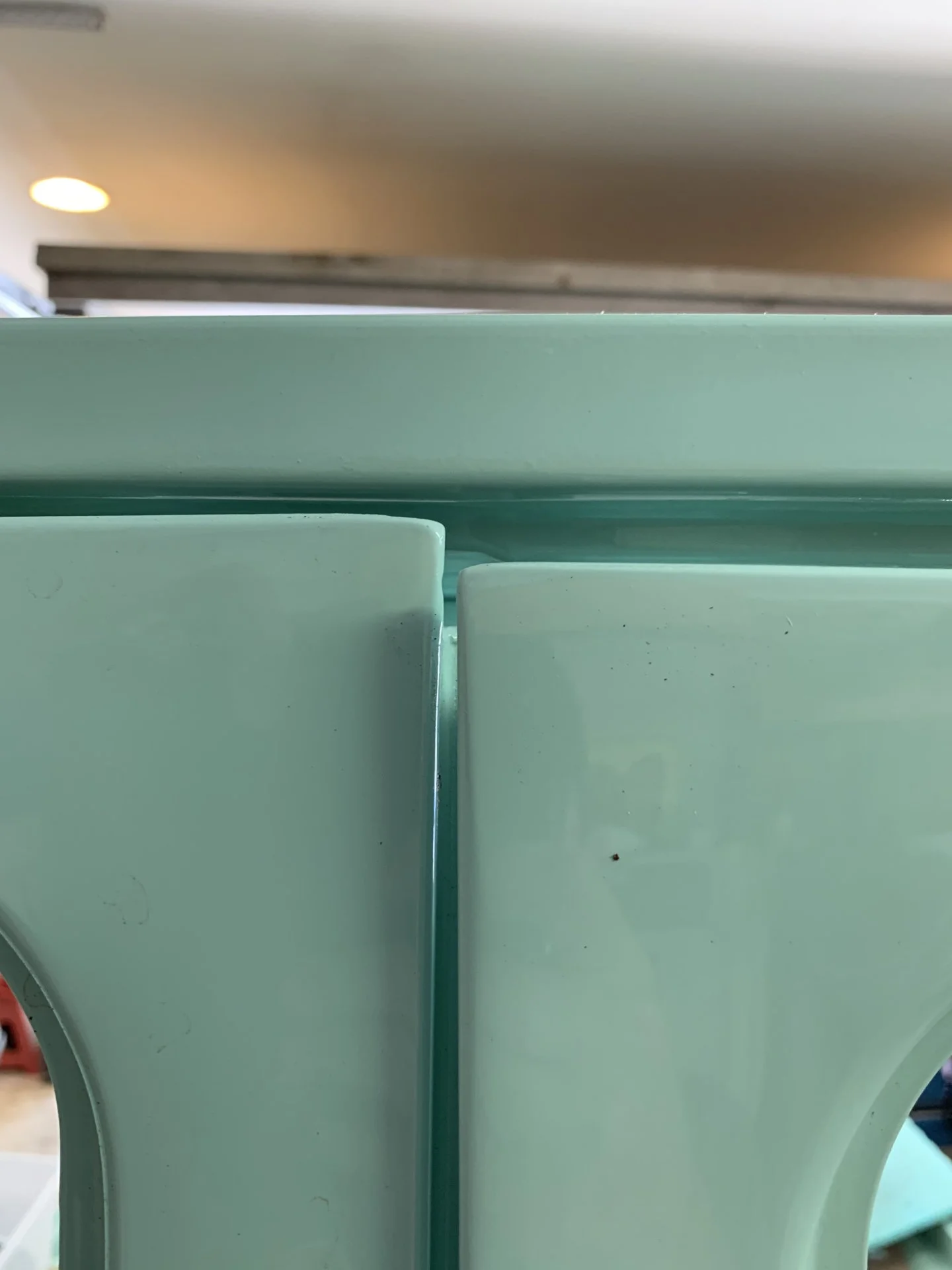

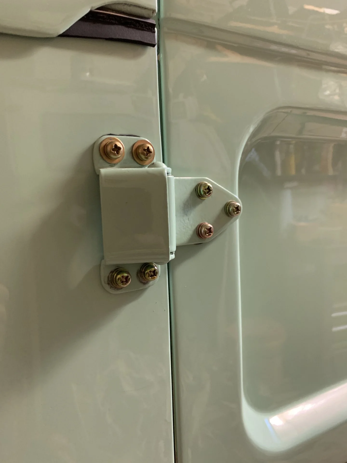

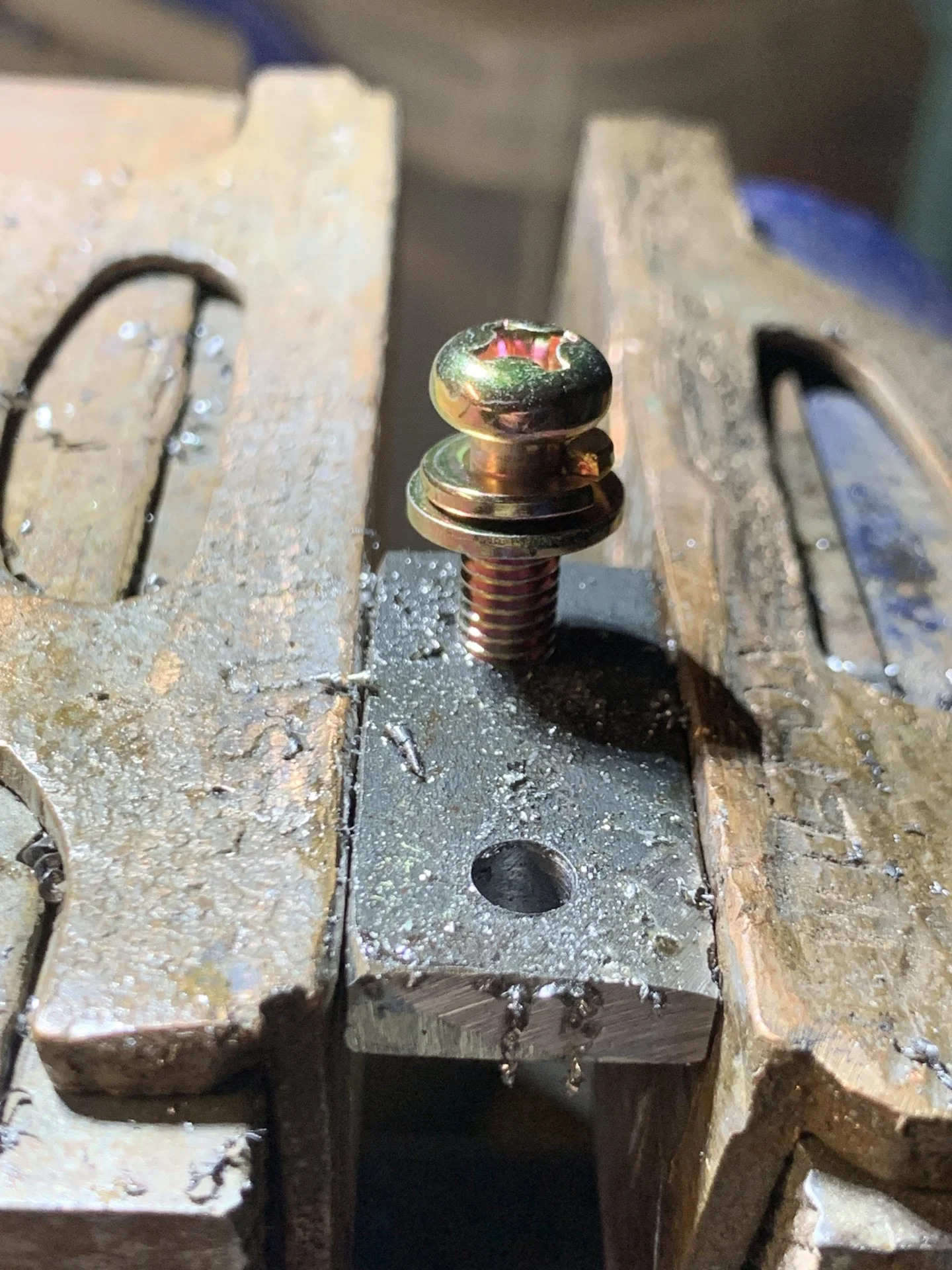

Doors are uneven. Ended up enlarging the bottom body-side bolts for the doors. That took away some of my ability to move the hinges somewhat in order to line the doors up so I’ll need to “wallow” out the holes a bit all around. That’s more than 1/2” out of alignment at the top of the doors.
Figured out the wonky doors: it was indeed due to me using 8mm bolts instead of 6mm screws when I remade the captive nuts for the lower part of the doors. I went back and remade them properly, and the doors had room to adjust a little on each side, making them line up pretty perfectly!

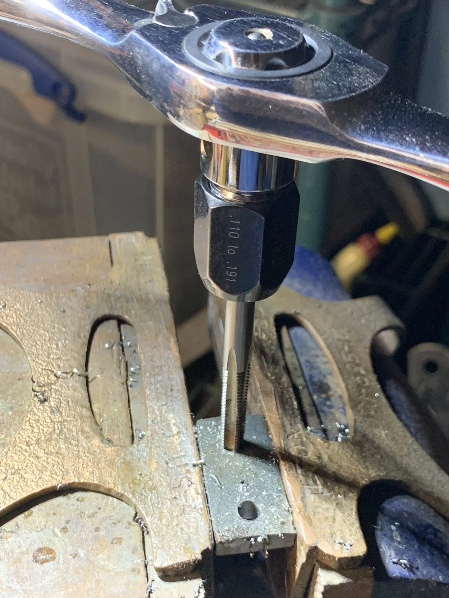

- tapped out a large bolt in the frame that I missed before it was powder coated to mount the left front fender. Helicoil required there.

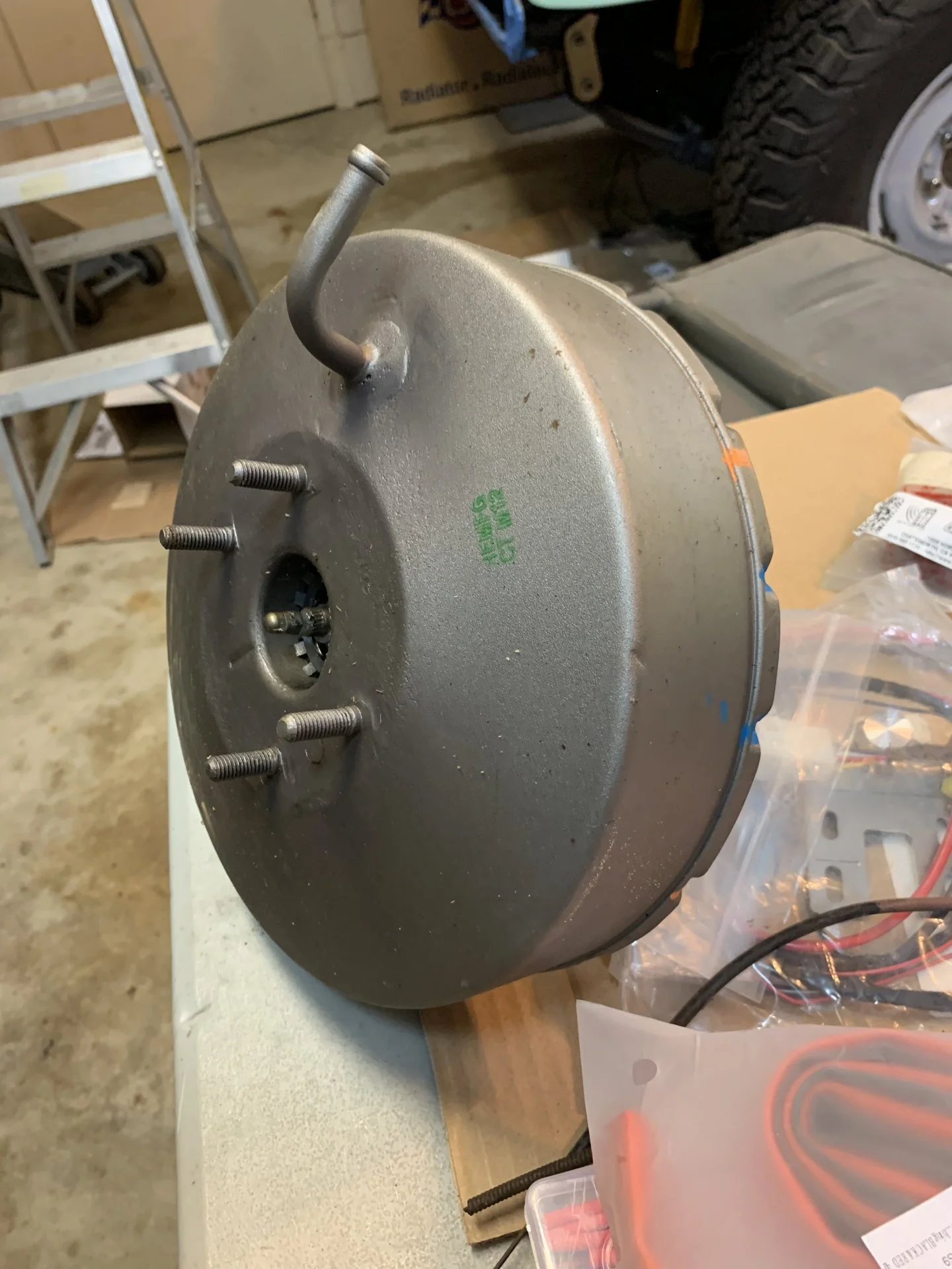

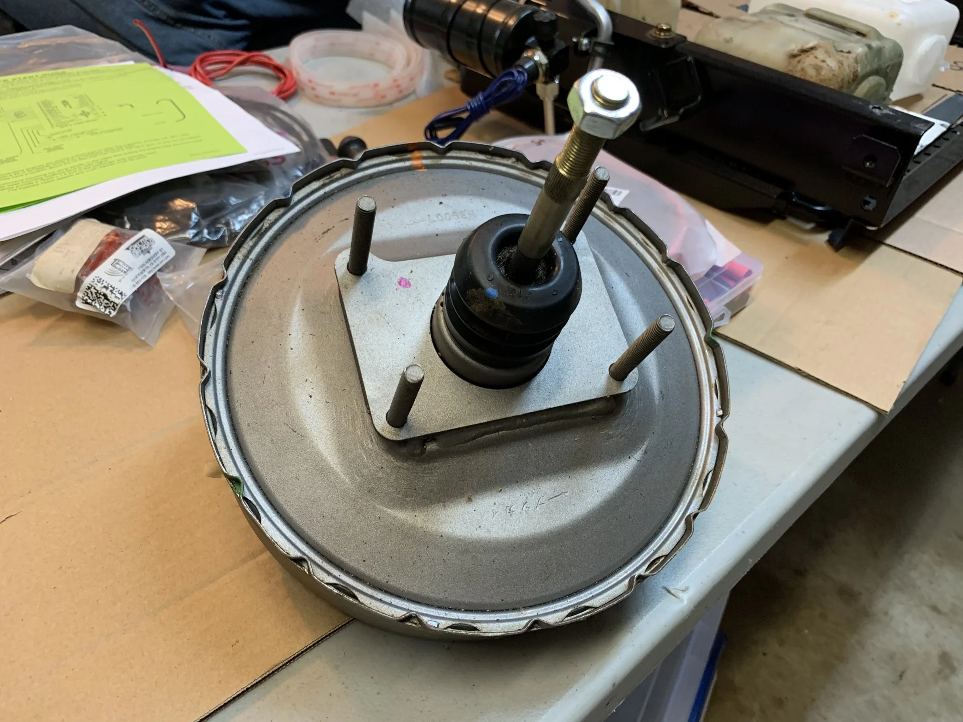

Someone remind me - will a slim brake booster work on the 40? I located this new slim one that I bought, but can't find the new, boxed double one that is OEM sized that I bought later. 1976.
Good question, I have a 3/76 that might be needing one in the future as well. On my ‘78 I did a narrower one that came with a small spacer.
Now I have to go back and 1) look outside at the truck and remember what I did, and 2) see if I answered my own question in the thread. LOL.

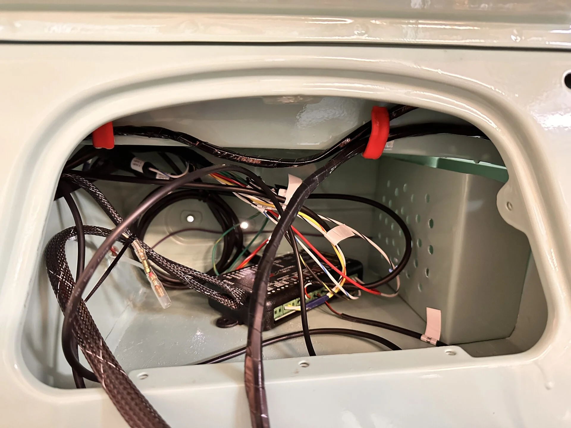

Here is a shot inside the glove box. I fought like hell to get the air filter piece back in there, as the painter could not save the old one and was nice enough to build me a new one that was actually pretty darn good. However, during the Vintage Air install, I realized that it had to come out so that I could screw in the AC unit in one of the holes that the filter uses to hold it in place.
I have the Dakota Digital wires and the Vintage Air wires and computers all terminating in the glove box. Common, I know. It is going to look nice once I get it all hooked up and can spend a few minutes/hours making all the wires run in a neat manner.

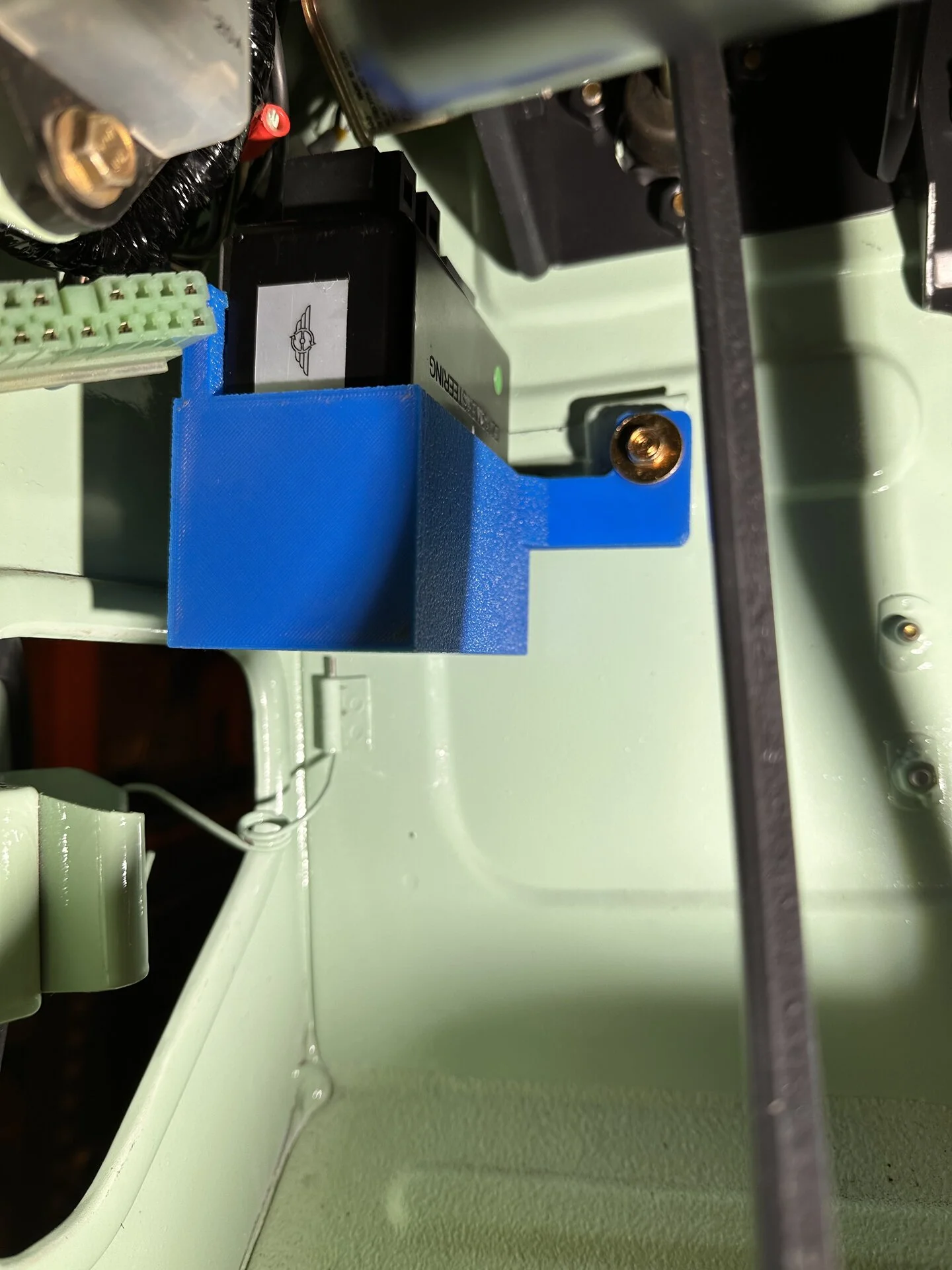

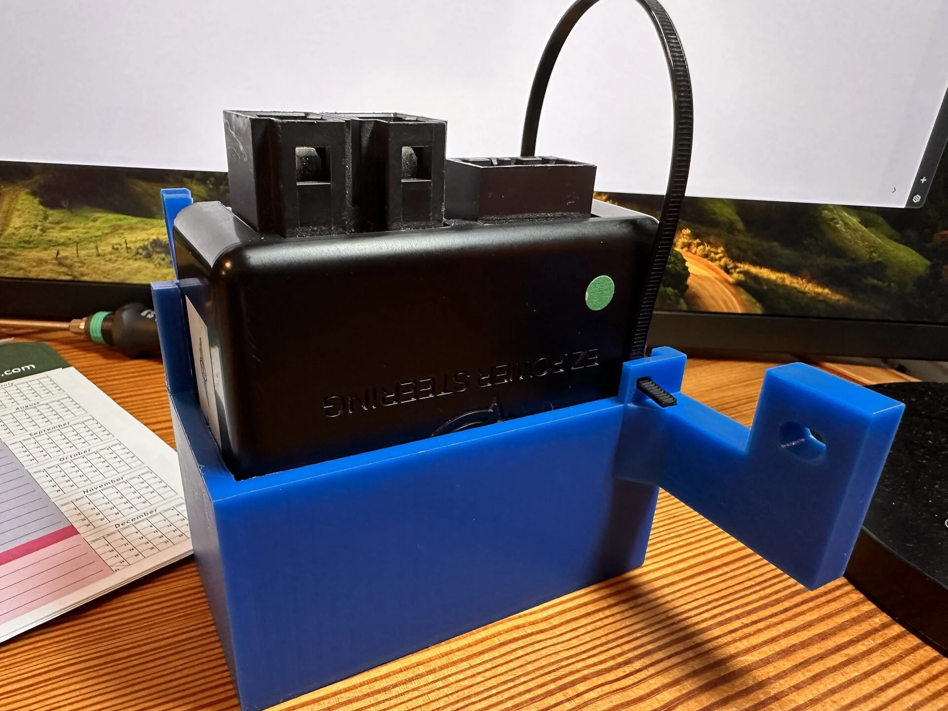

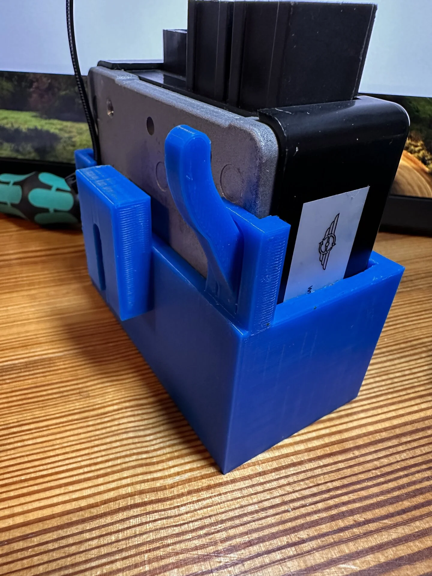

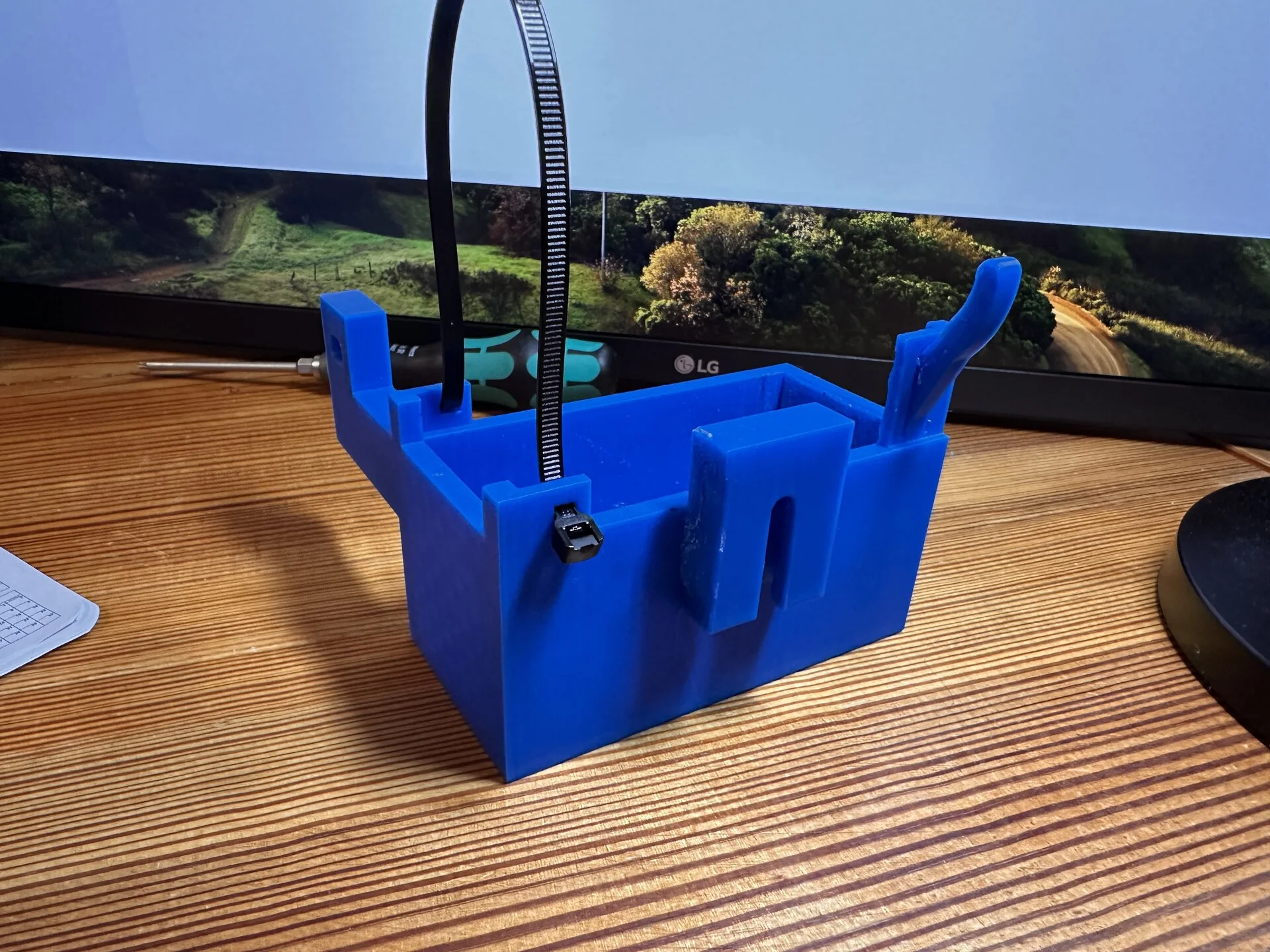

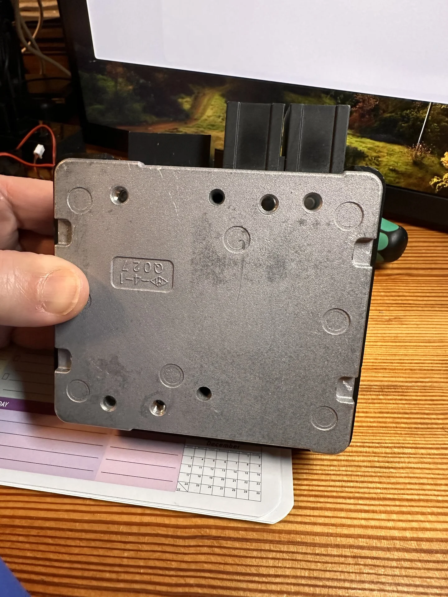

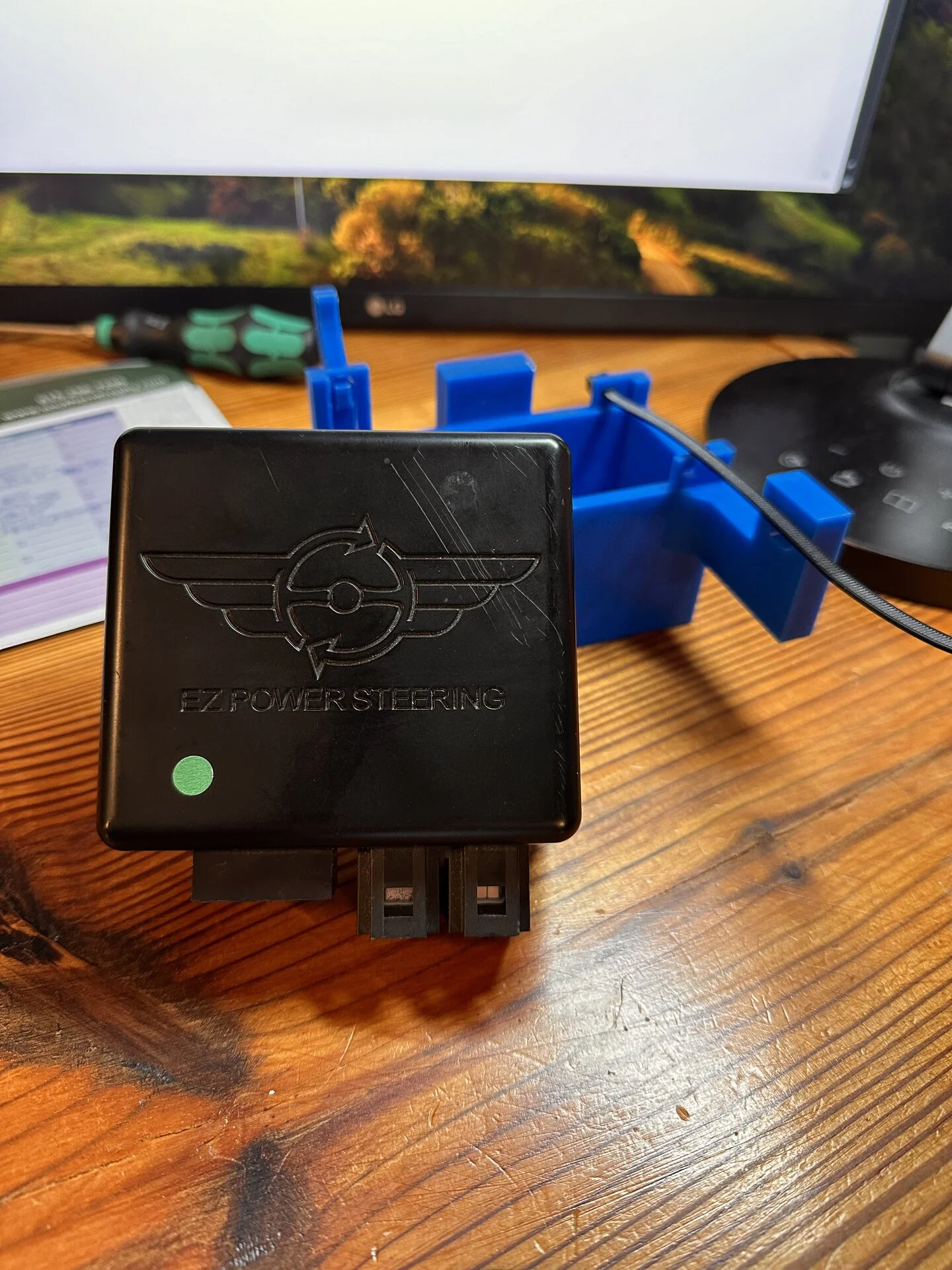

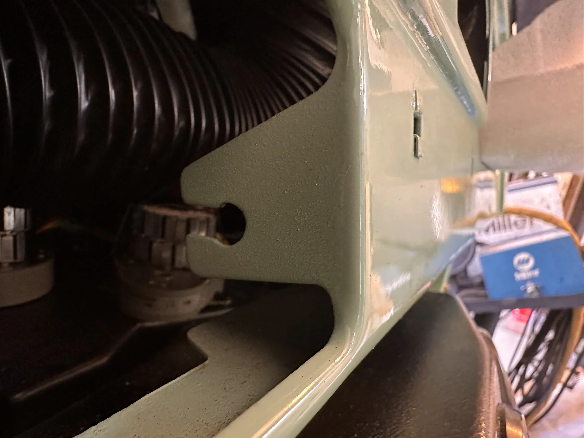

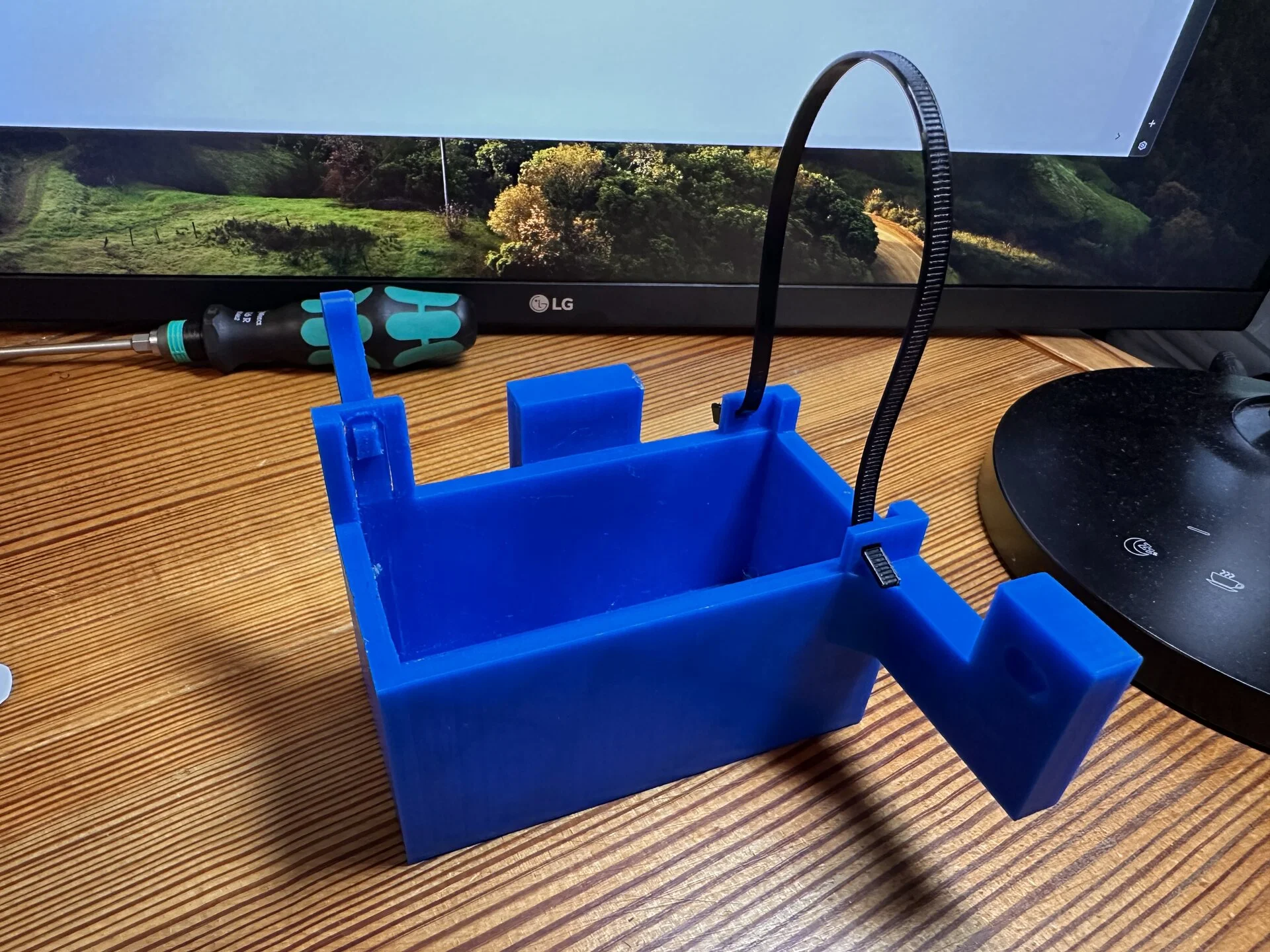

Been working on a way to mount the control box for the Ez Power Steering (electric assist) system. It is a 5x5x2.5" little brick that wants to mount nowhere in the footwell. I had an extra bracket down there so I made (after many head scratching attempts) a box to hold it and mount it to that bracket. It has a blind bracket on the rear and a foot on the right. Not quite done refining this yet (want to make the zip tie easier to put on for when my little plastic handle breaks off) and then need to print it in a different kind of plastic (ASA) that will stand up to getting hot in the TN summertime without deforming.
Bracket by the clutch pedal
The box to be mounted. Note the side notches.
Front and back of the solution.

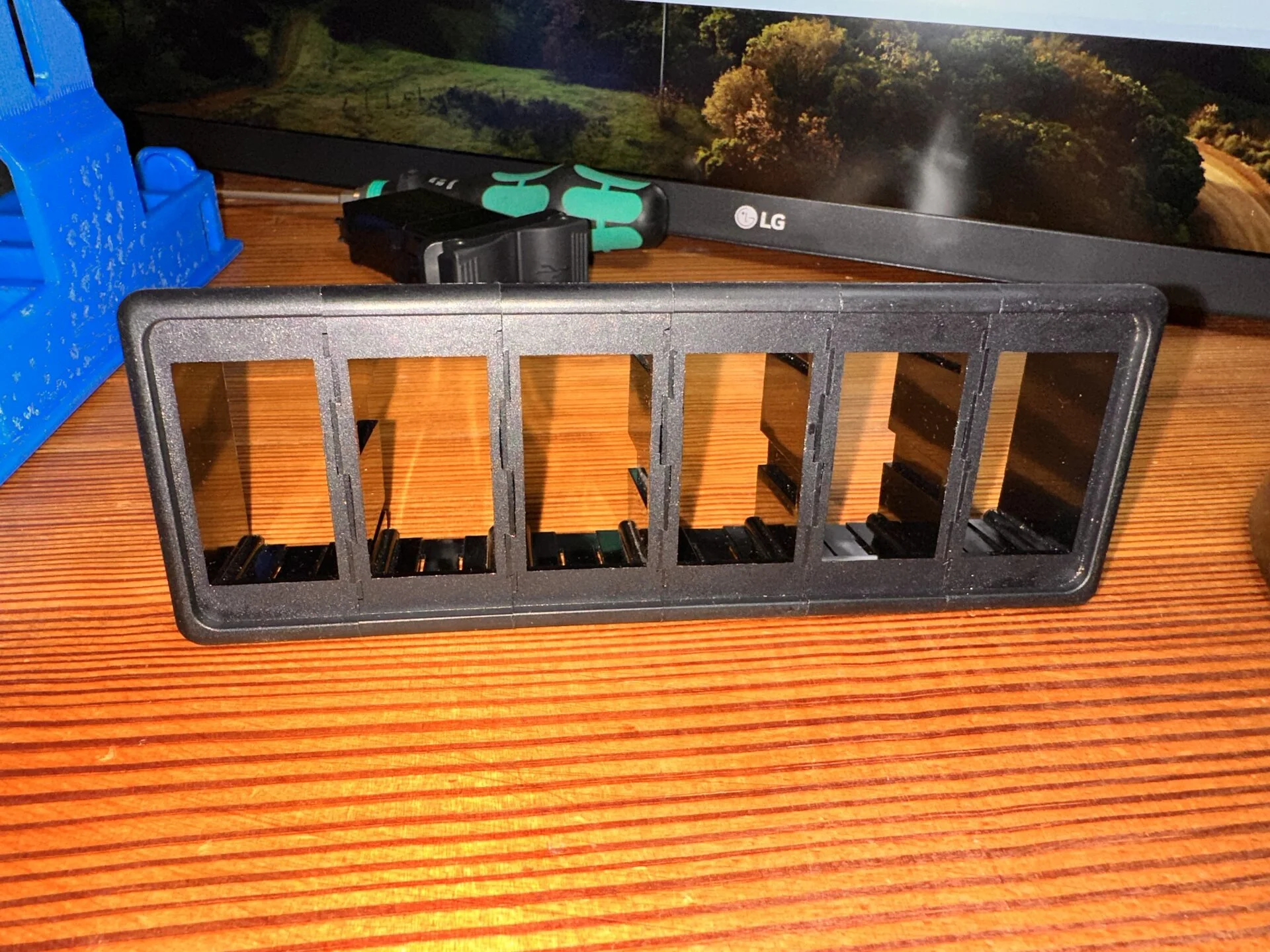

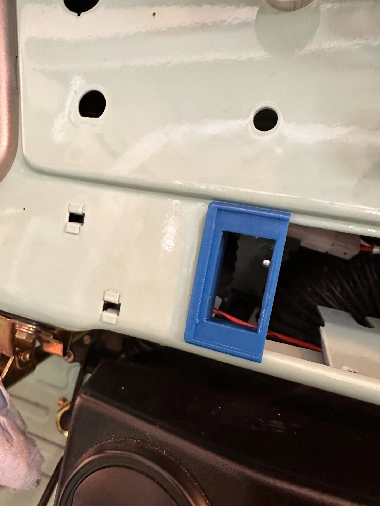

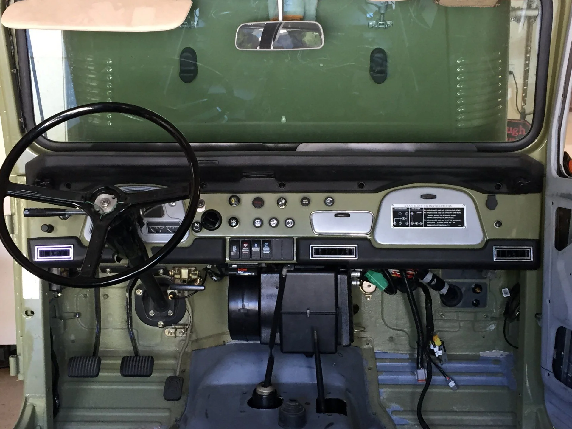

Around the same time, was working on how to mount some newer accessory switches in the truck. I decided for now to not put in a radio and to create a custom mounting plate for the 40 that actually is made for it. Found the Carling Technologies modular switch plate that ALMOST fits, but it is off about 3/8" on the width, and about 1/8" on the height. Just wouldn't do!
Here is my solution. Same blue prototype color (you should see the pink), but it shows the detail well.
I took advantage of the radio mounting detents in the truck on the sides and rear. The rear will hold a nut and bolt to fix it in place and the sides have a "nub" on a flap that will allow it to slide in and out (and holds it fairly tightly even without the nut and bolt).
Left and Right detent
Rear slot (seen on the extreme right of the above photo)
I guess that I could put in a radio at a later date and use the ash tray hole for a 3 switch mount. Same basic design would work but there's less to secure it in the hole than for the radio. I'd have to use some flexy tabs on the side that would grip the hole as you (ahem) slid it in. I tried that on the radio hole and they were really hard to disengage to remove (which you'd need to do probably 50 times while working on all the switches and wiring).
