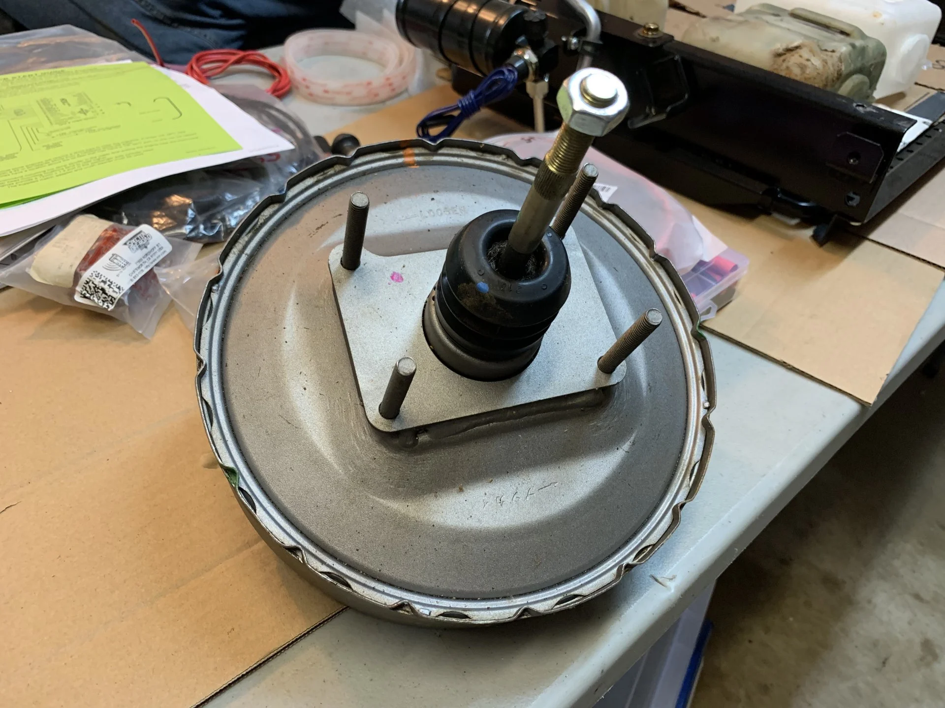

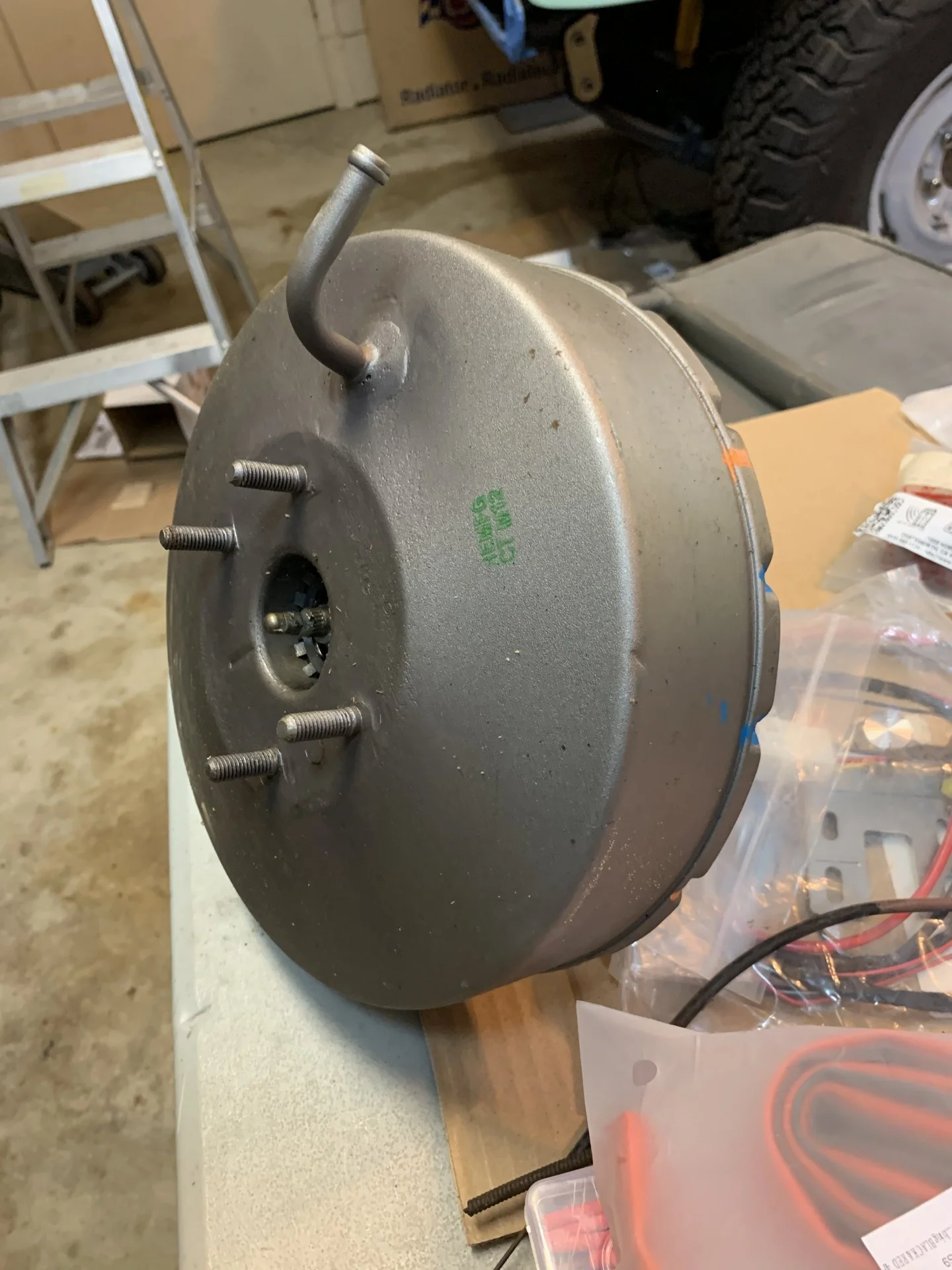

Someone remind me - will a slim brake booster work on the 40? I located this new slim one that I bought, but can't find the new, boxed double one that is OEM sized that I bought later. 1976.
As I recall most of the "slim" brake boosters form later toyotas will bolt up in a FJ40 - (4Runner, Mini Truck, etc.) but most are slightly wider than the stock FJ40 booster. As a result, they block access to the inboard bolt of the clutch slave cylinder which makes it tricky to access. I've been running a later slim booster in my truck since I bought it without issue - both on 4 wheel drum brakes, and 4 wheel disk brakes.
Thanks @RWBeringer4x4 - decided to feed Roger's kids again it CityRacer.com and just buy his replacement that comes with the spacer. 4th brake booster I've purchased In 8 years. None have been installed. LOL.

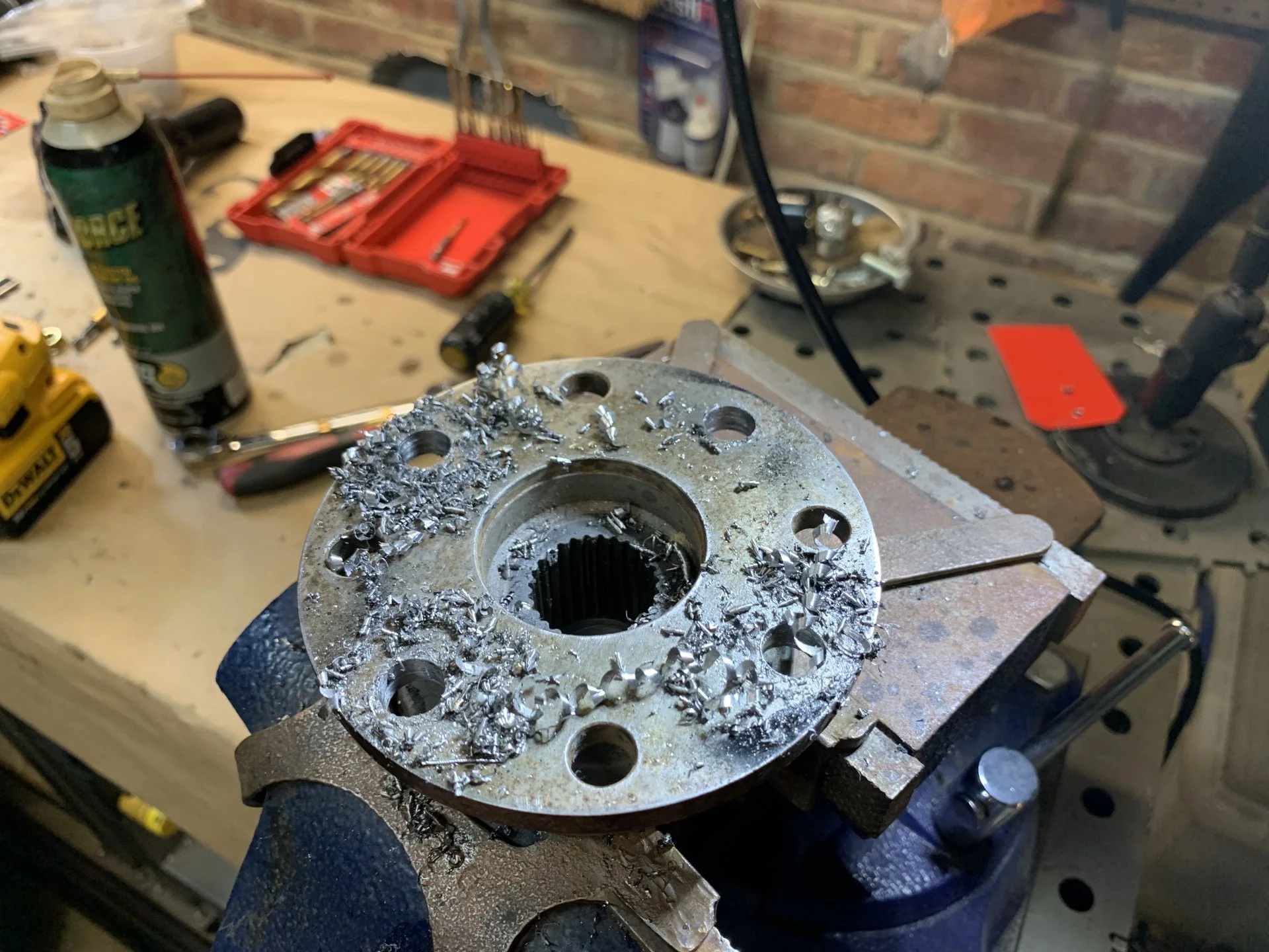

Yesterday I had a few minutes so I was going to throw on the drive shafts. Ha ha ha ha ha. No not gonna happen easily or quickly.

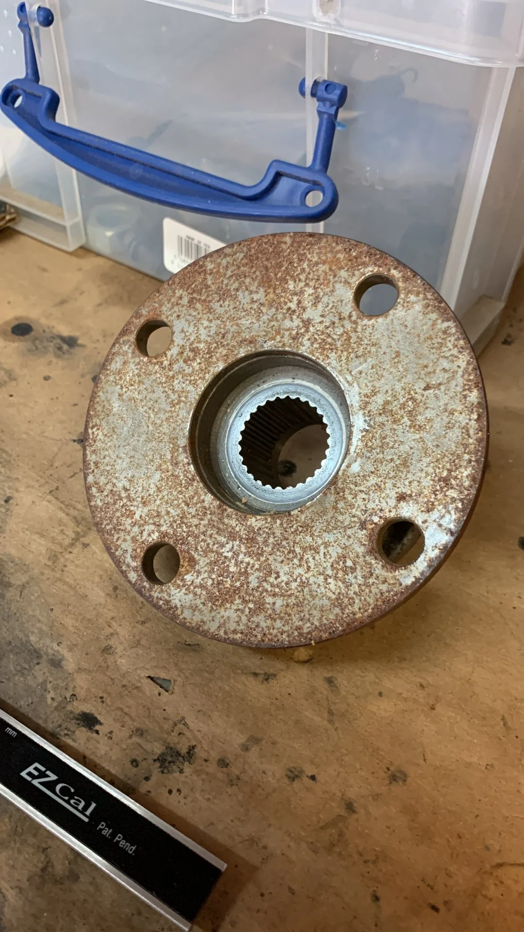

The rear diff flange that I got somewhere at some point when I swapped the gearing is a four hole flange that was a square pattern. As we all know the FJ40 has a rectangular pattern on the U joints. So I removed the flange and proceeded to drill 11 mm holes to fit the OEM oddball 11 mm bolts.
OK, not too hard. But then I went to hook up the front shaft on the front diff and discovered that the eight hole flange only had 10 mm holes in the correct Toyota pattern. So I also remove that flange and tapped the 10 mm holes to be 11 mm.
Then I discovered that I did not have enough of the 11 mm bolts or four of the nuts to fit on the studs on the emergency brake for the rear shaft. I went to Cruiser outfitters which is now Cruiser TEQ I think and I was going to buy four new bolt sets and 4 nuts. But you know, then they wouldn’t all match so I ended up paying $50 to buy 12 bolts and 4 nuts that all matched.
And that as you all can relate why it takes me eight years for me to get this done.

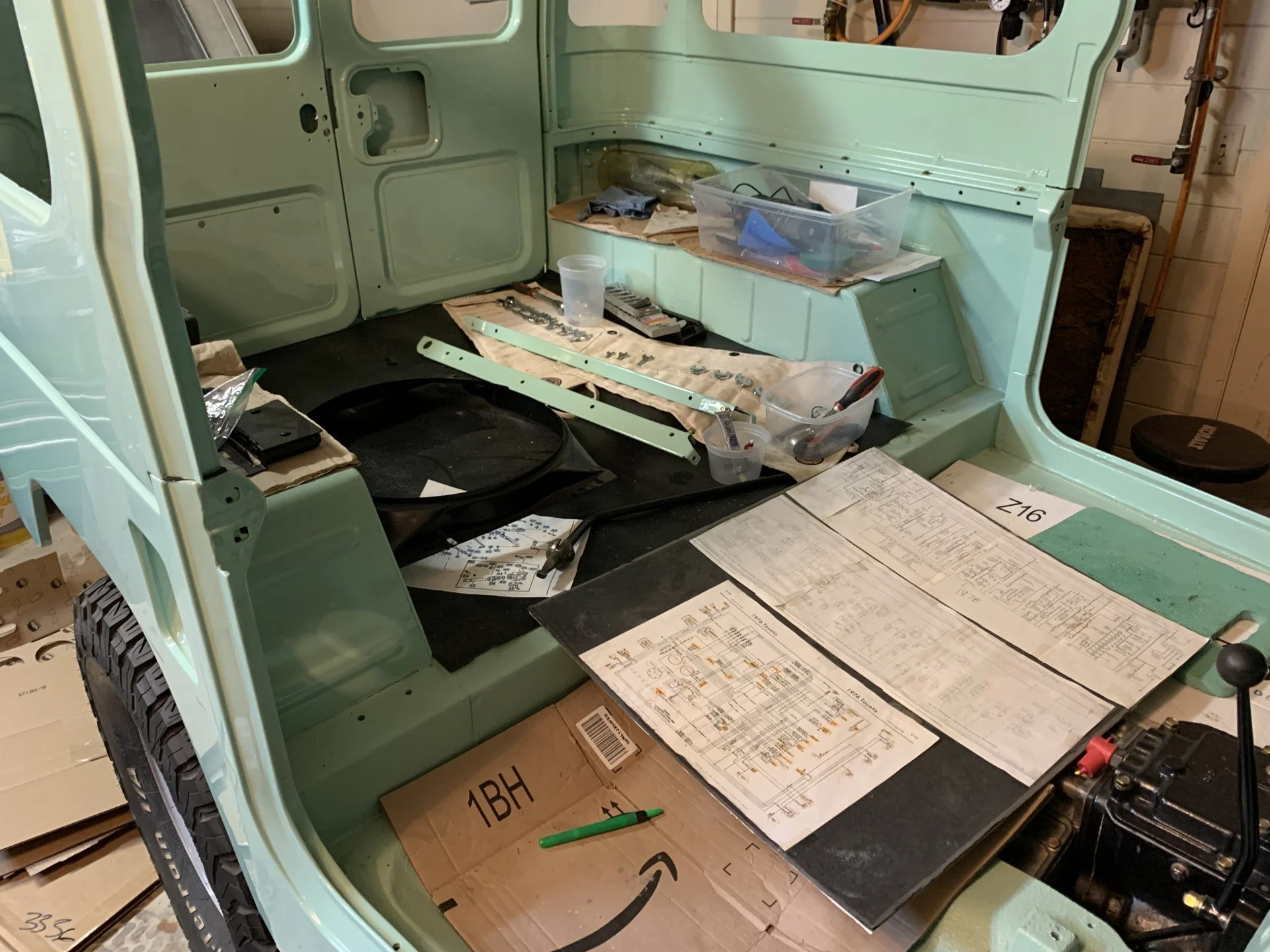

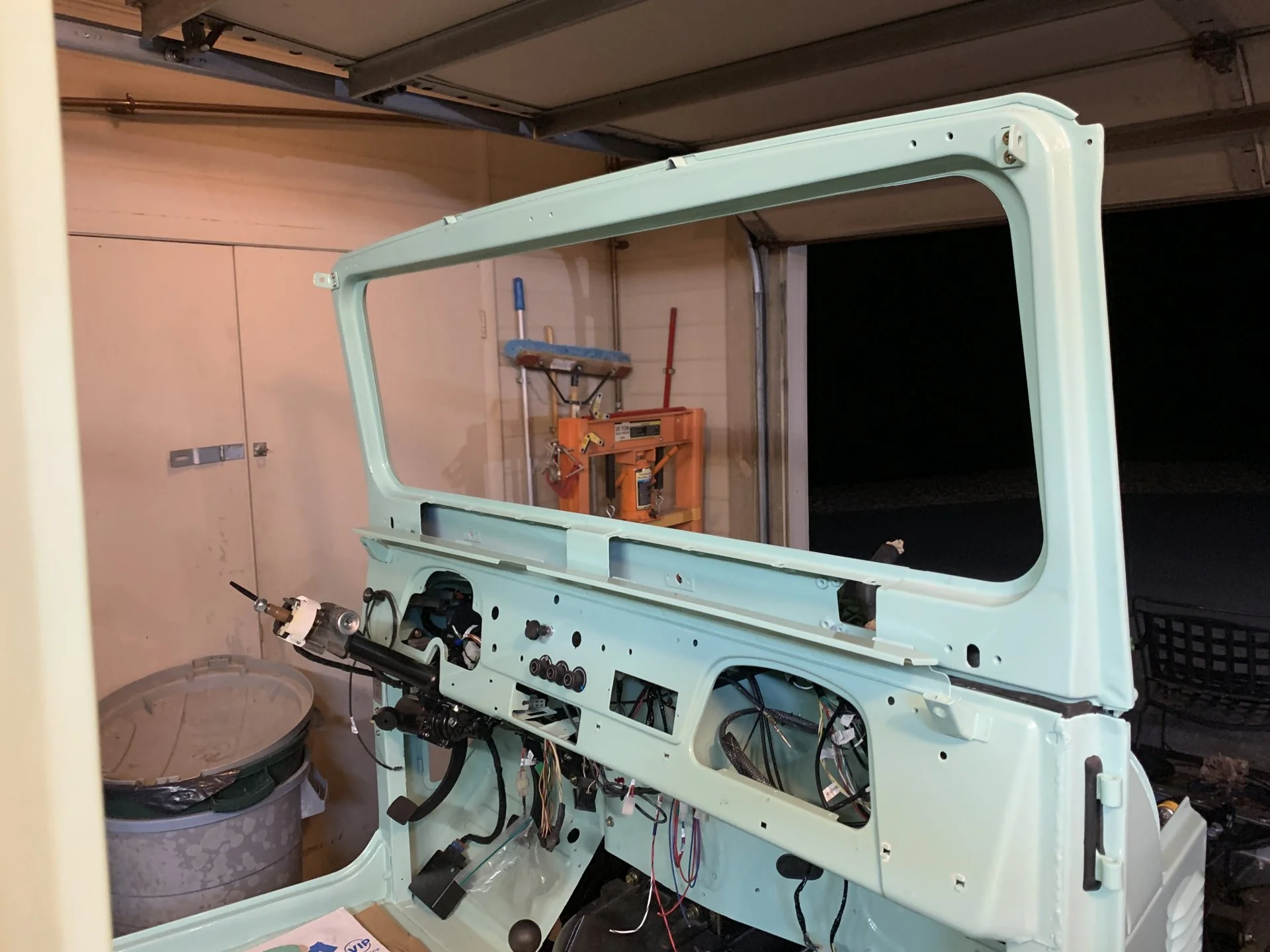

Quick update - still going. I'm a bit ADHD with this last few months – I'm kind of all over the place. Still working on the electric, still working on the AC, starting to put body panels on, I can't seem to go down one path! And I'm certainly not doing it consistently. I've hit another one of those lulls where I am not as motivated as I am at other times. I just keep trying to go out there and spend a few minutes on it every time I have a few minutes. That's what I've done for the past five years of the 8 1/2 years I've been working on it. Progress is progress.

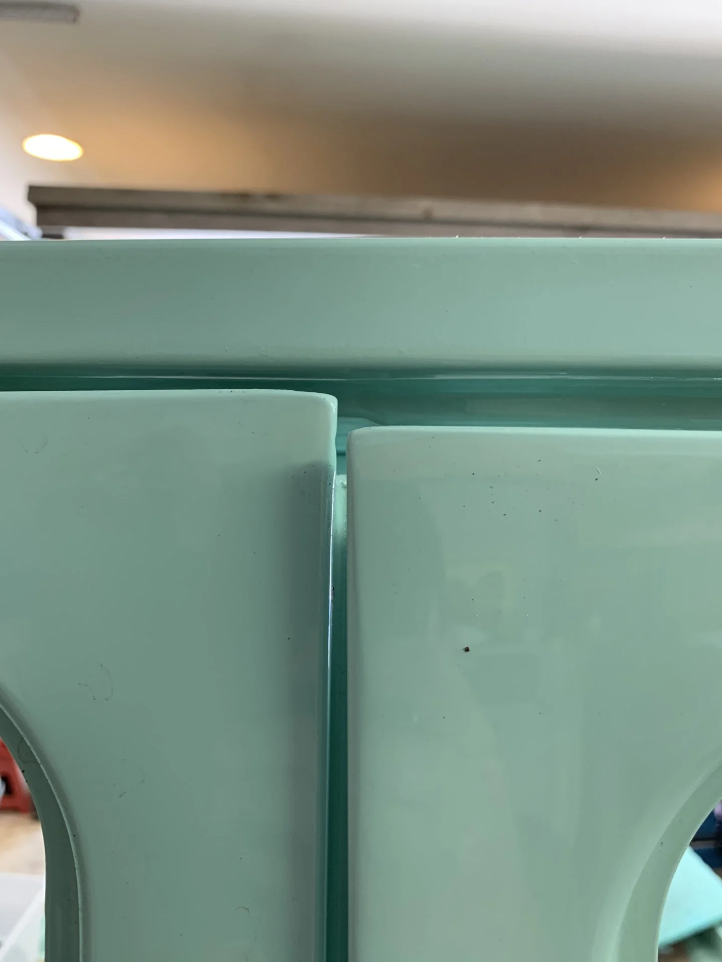

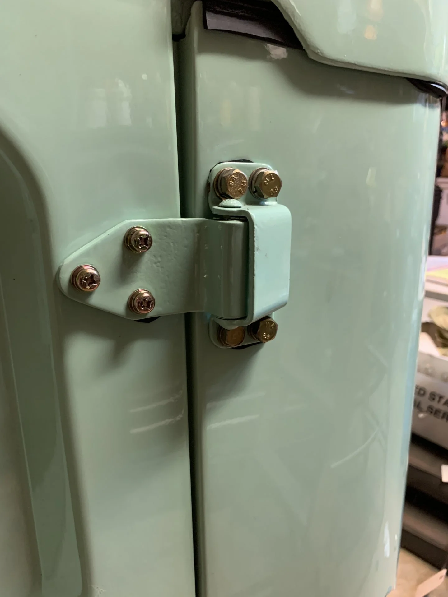

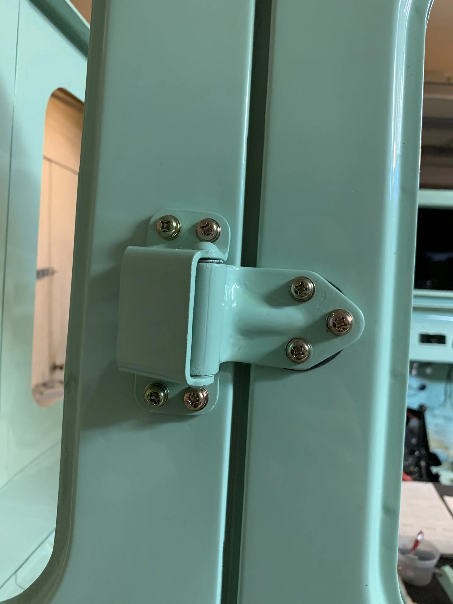

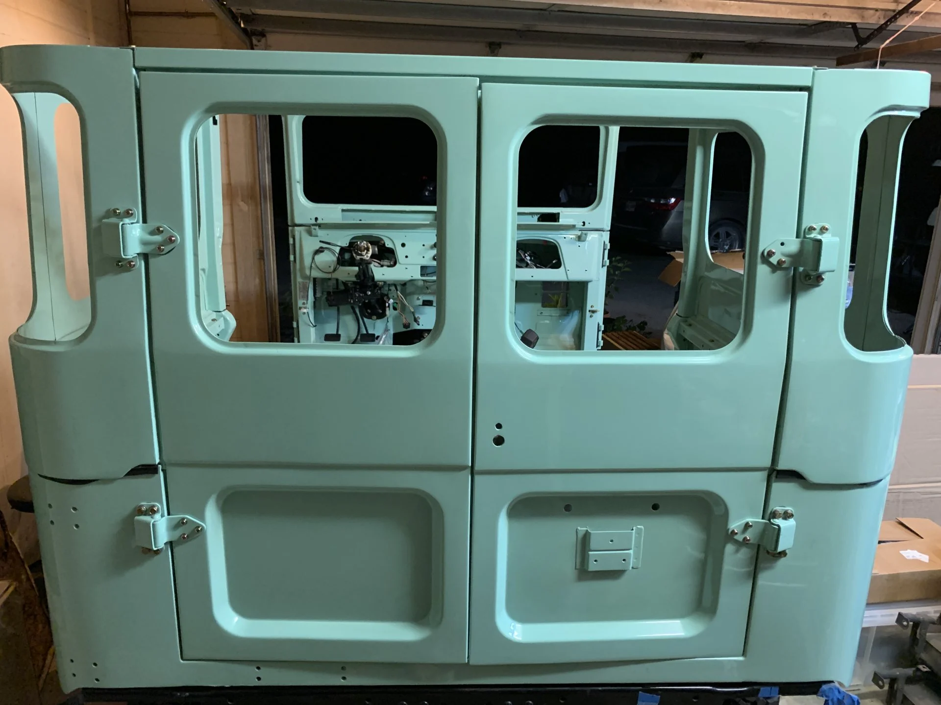

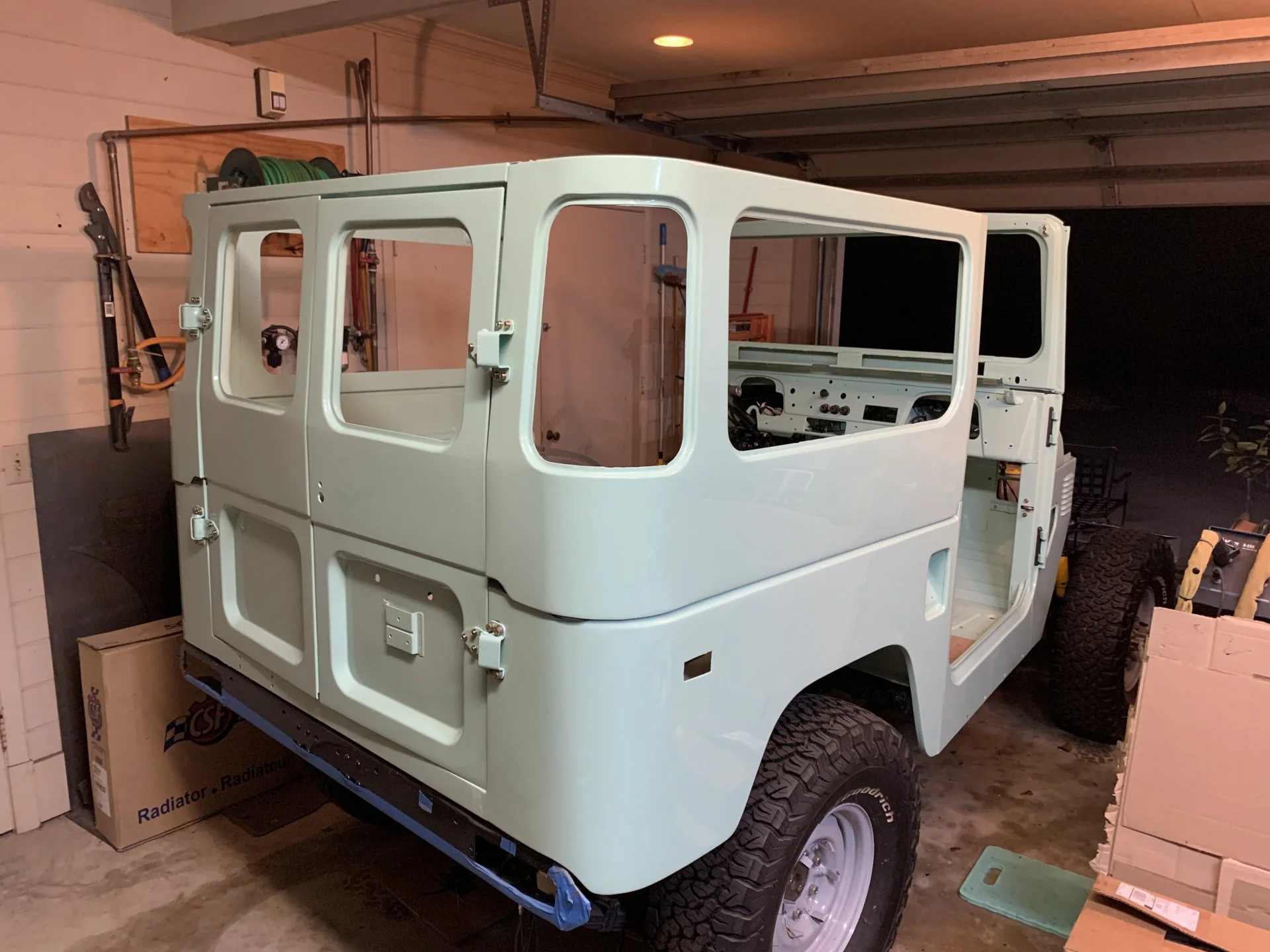

Doors are uneven. Ended up enlarging the bottom body-side bolts for the doors. That took away some of my ability to move the hinges somewhat in order to line the doors up so I’ll need to “wallow” out the holes a bit all around. That’s more than 1/2” out of alignment at the top of the doors.
