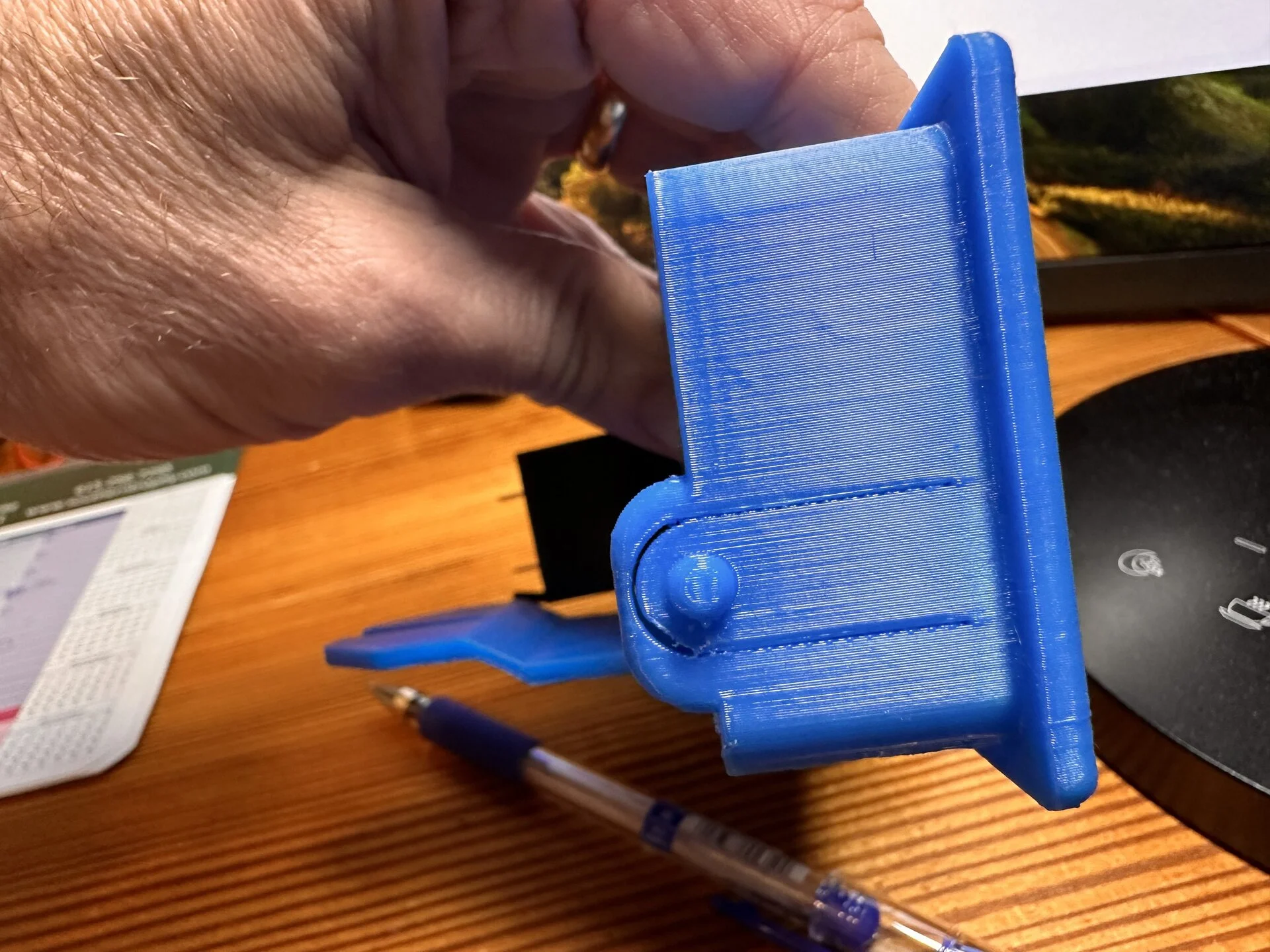

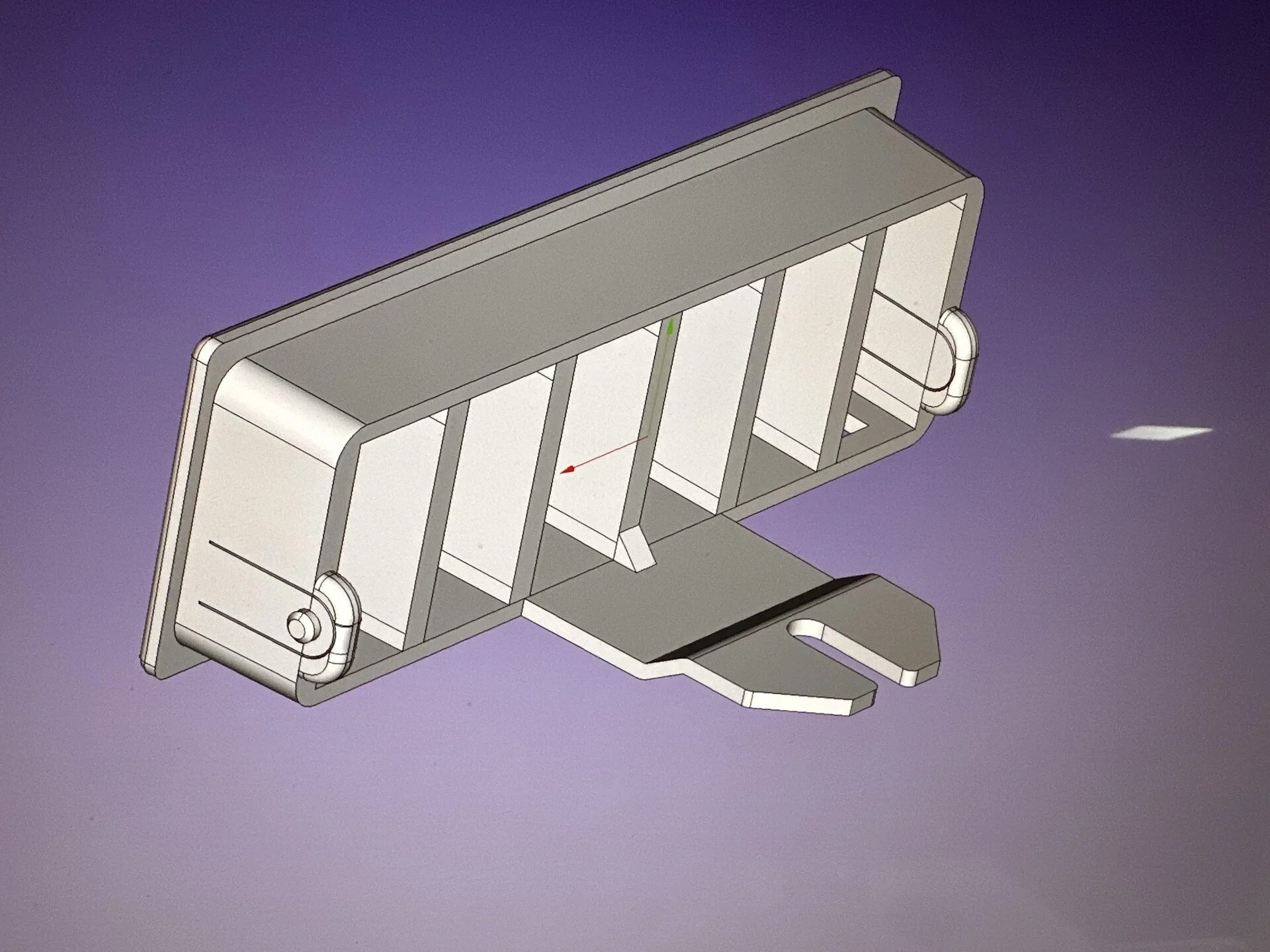

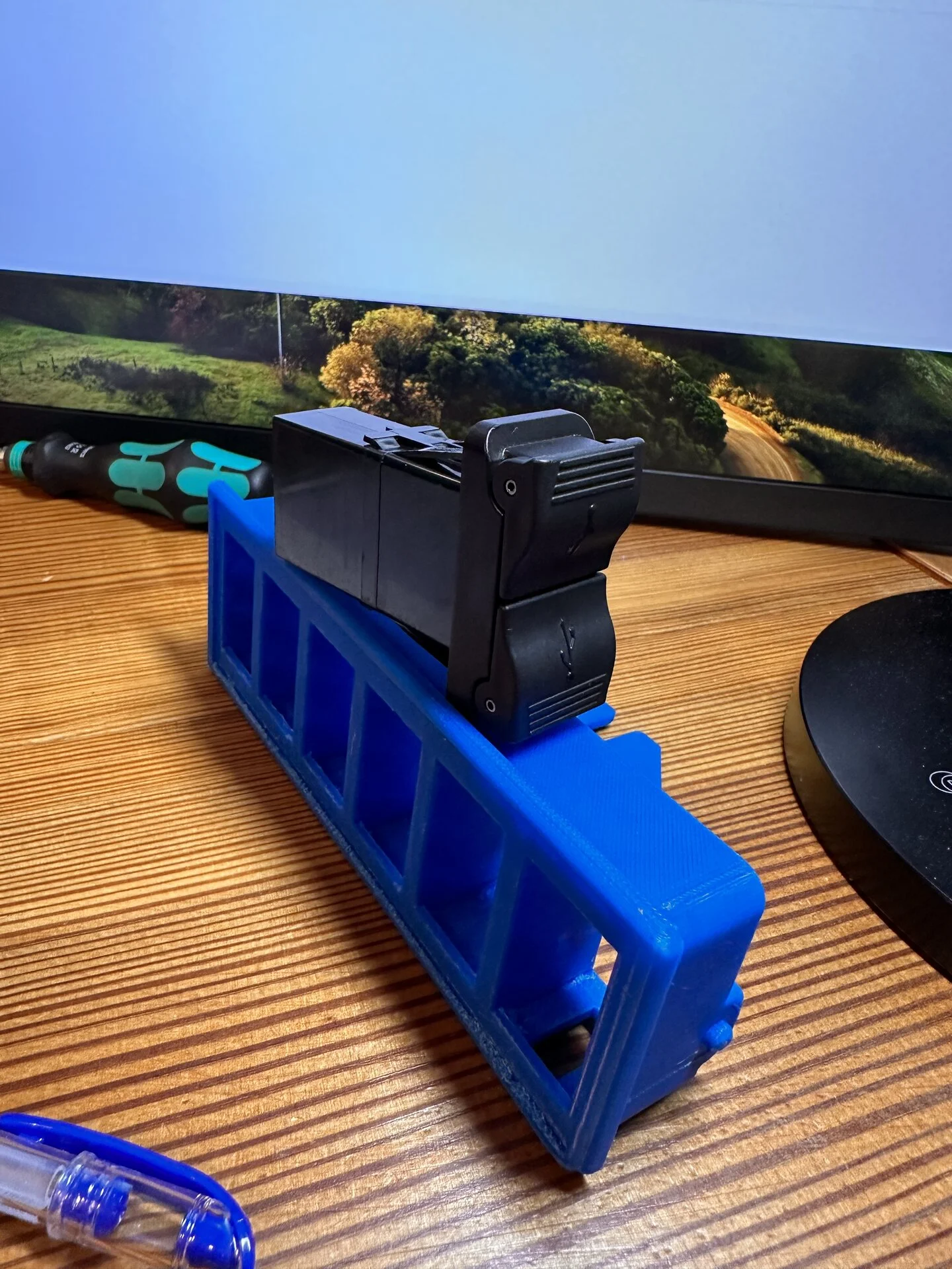

This is what it looks like out of the car:

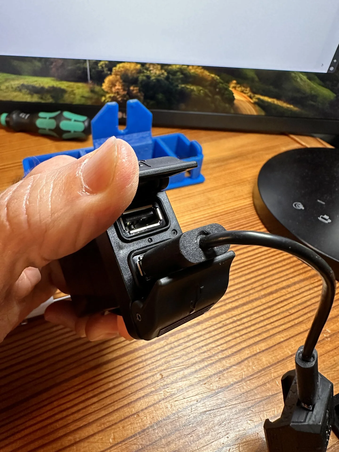

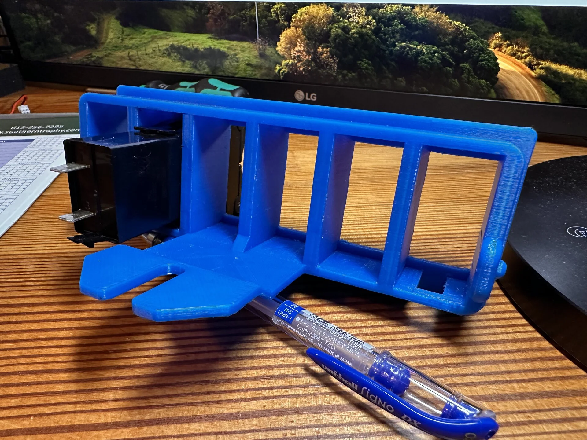

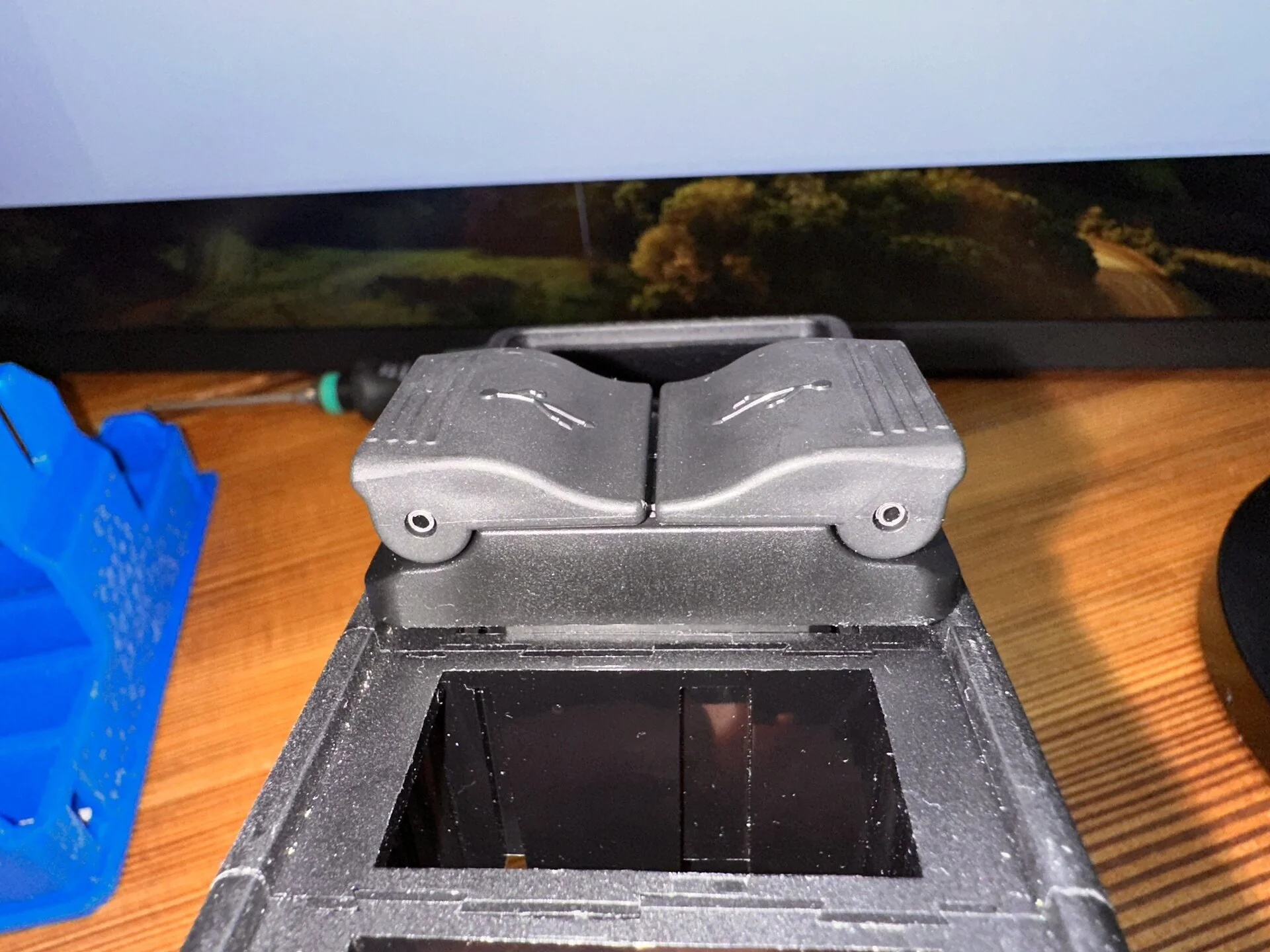

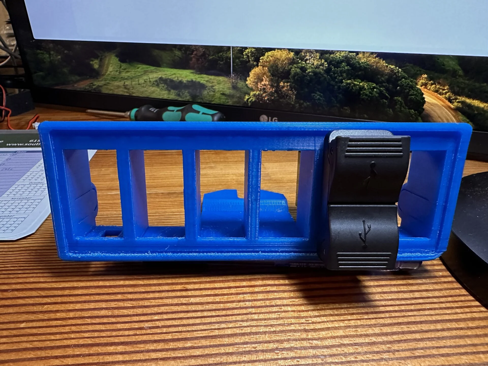

Showing a Carling dual USB charger in one of the slots (which was up to date when I bought it 3 years ago. USB-C is all the rage now!).
Here are the rear and side :
And the USB charger (for reference it is a Carling VUSB24G111BB1 12/24v)

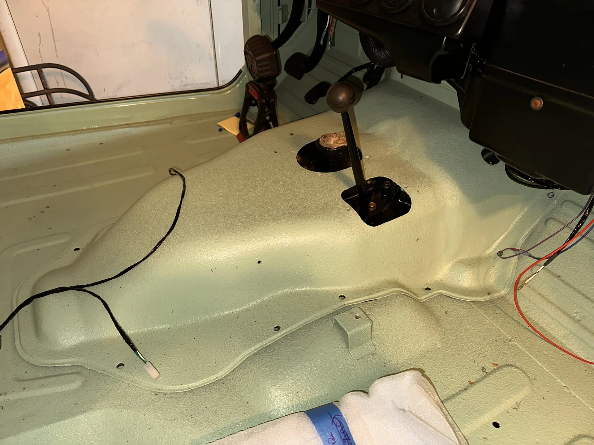

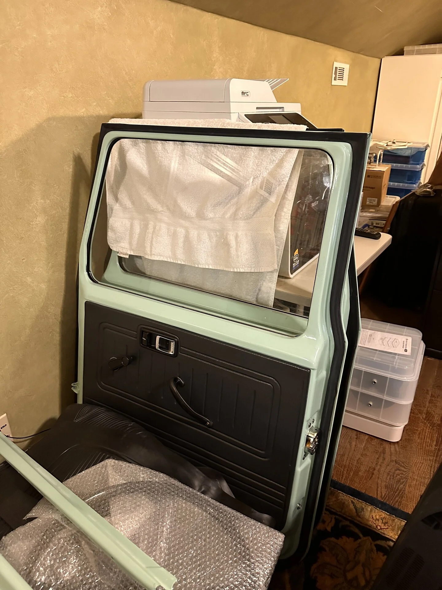

Finished the doors. Still not mounted, lest they get banged up. Put butyl-based sound deadener inside the big spaces in the doors. Completely changed the sound and heft of the doors - no more tinny sound. Plan to put that UNDER the tranny hump (hey, it can identify as whatever it likes) since I removed and did not replace the heat shield mat material on the original hump. May be a really bad idea if it gets wet behind it, but hey, that's why we get to work on these trucks.

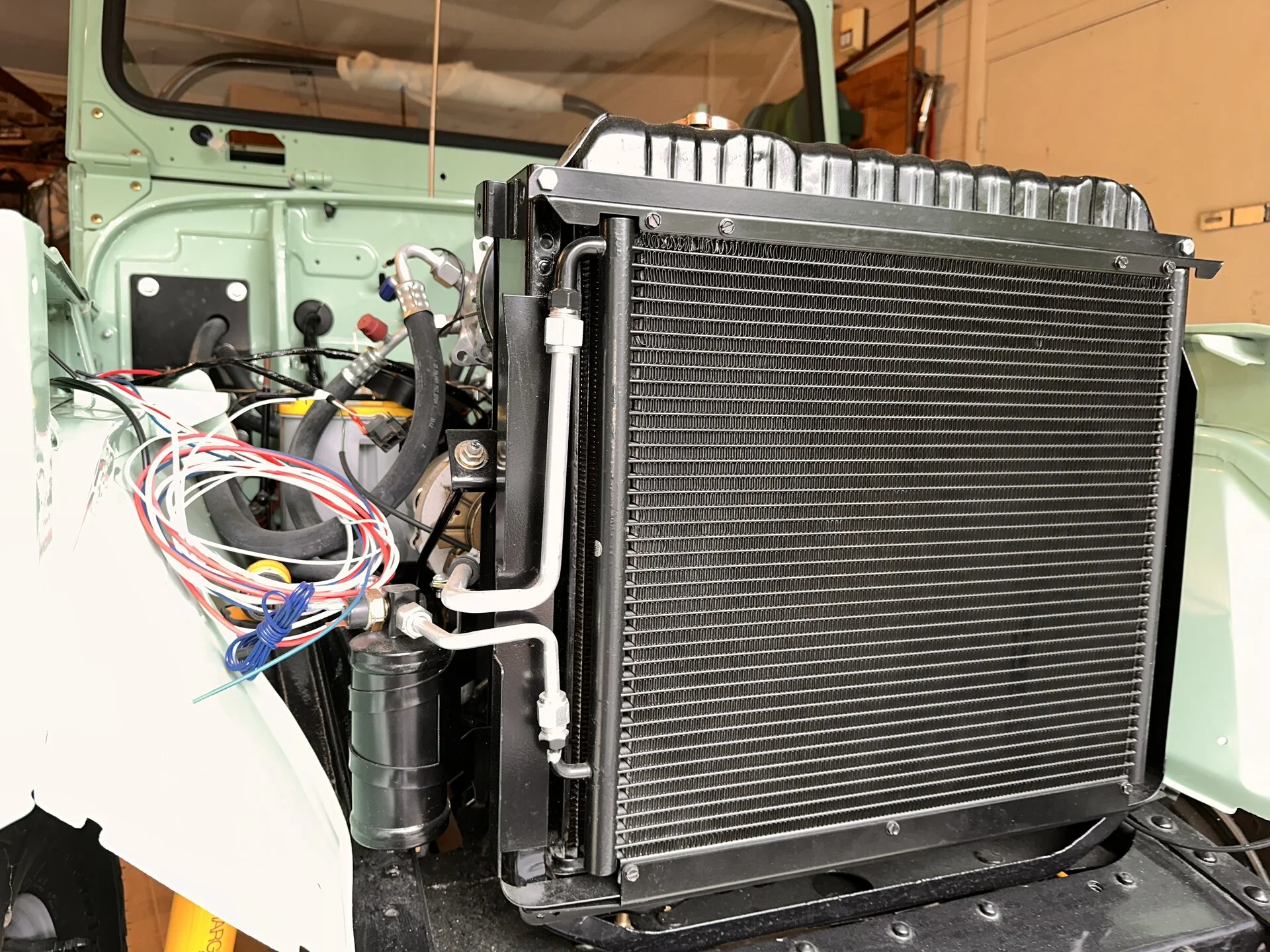

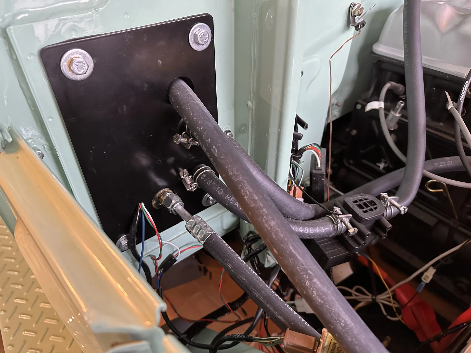

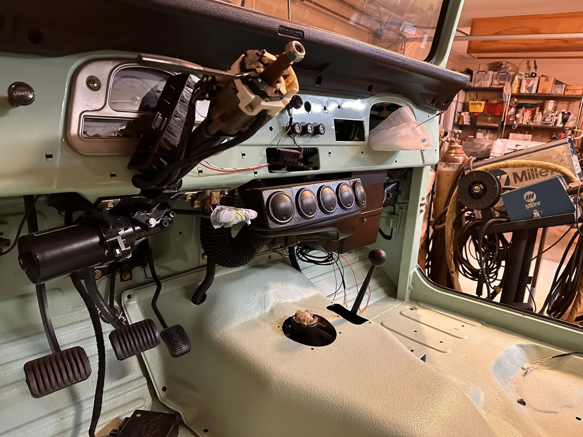

Did lots of Vintage Air installation. Nearly done - have to finish the wiring (putting it all out of the way), have to charge it, etc. Electric assist steering can be seen here as well, the cylinder to the right of the steering column if that's not obvious.

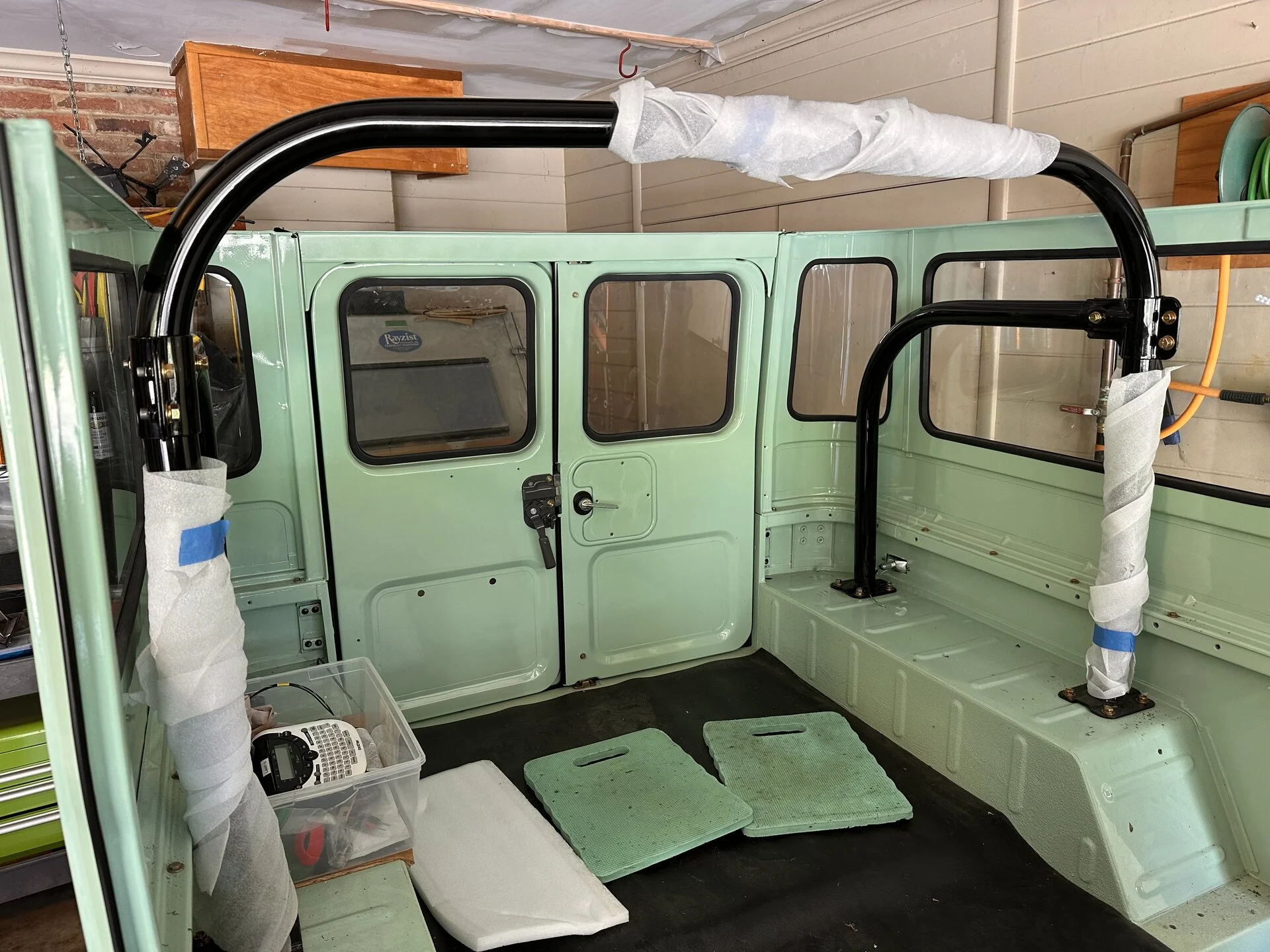

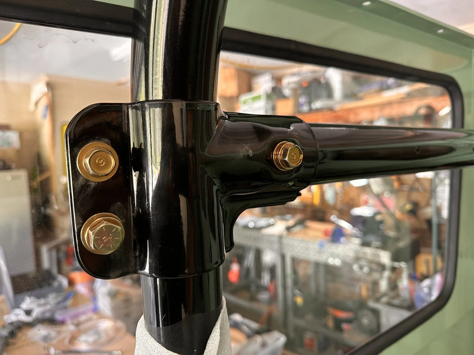

Got my pops in the truck to help me for a couple hours which was a real treat. He lives a couple hours away and we rarely get time to putter. We got the rest of the roll cage mounted. Looks good. Found all the hardware except the two SAE bolts some PO(S) put on the side bar mounts.
He is a lot of the reason that I've tried all my life to prove my ability to work with my hands. He's pretty handy but it was nice to have him learn a few things from me that I've learned in the past 11 years in doing this.

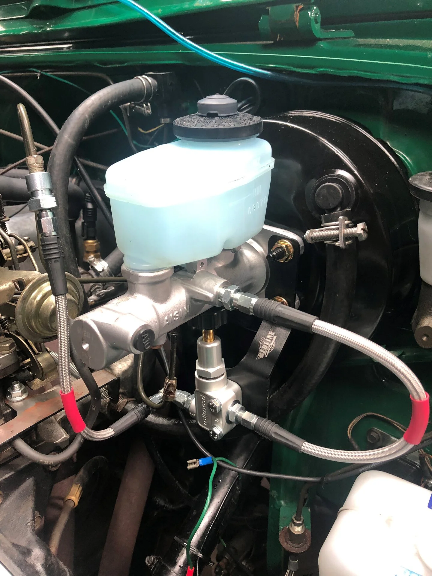

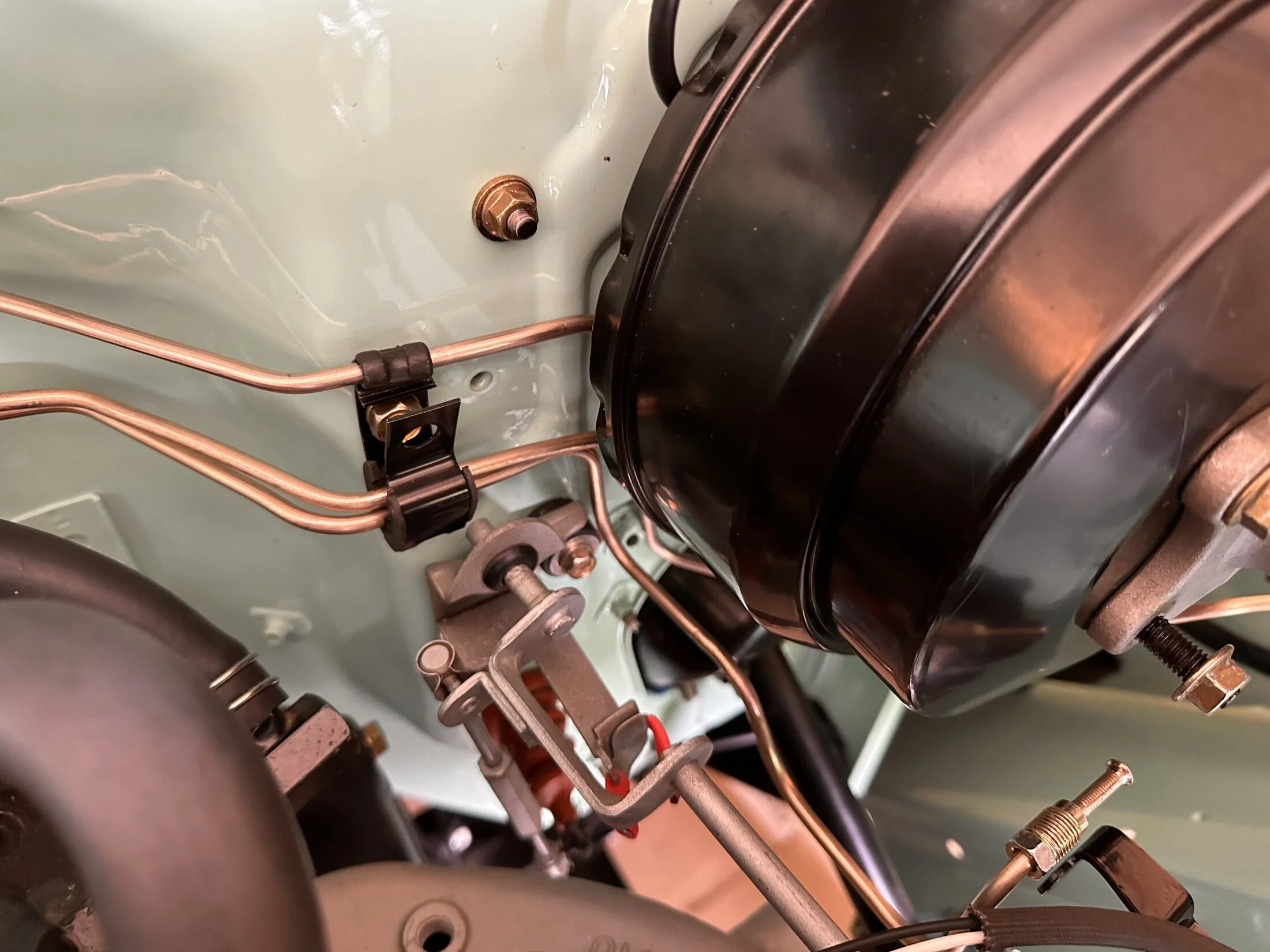

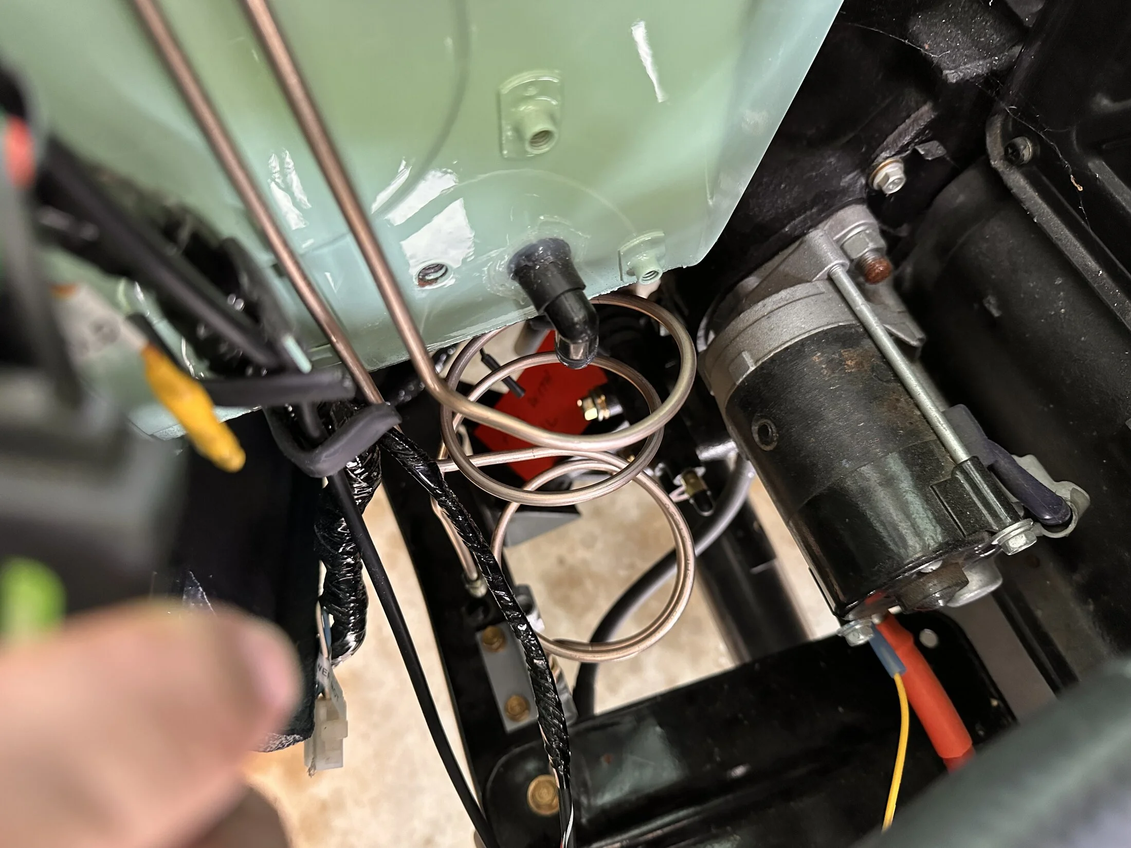

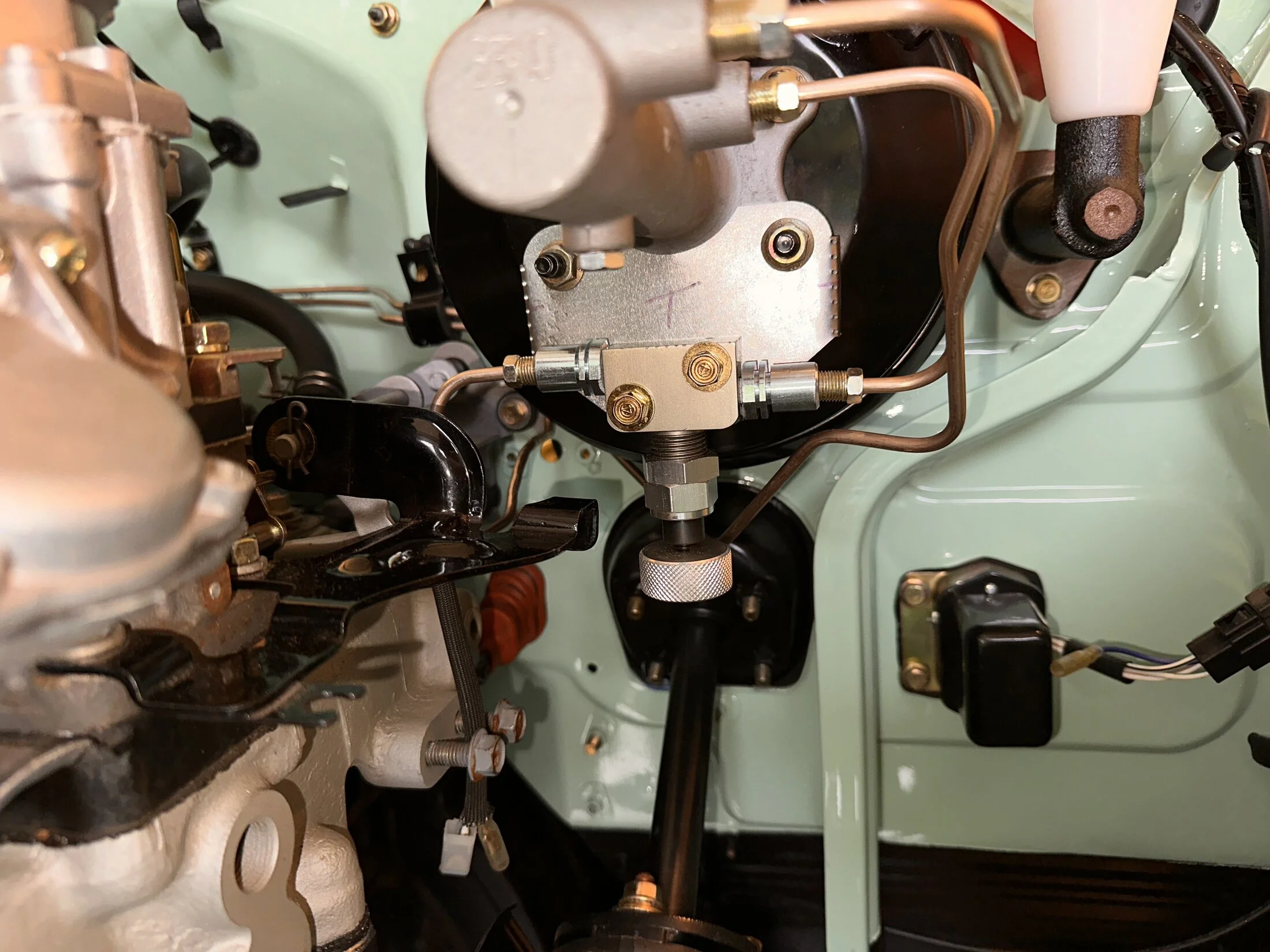

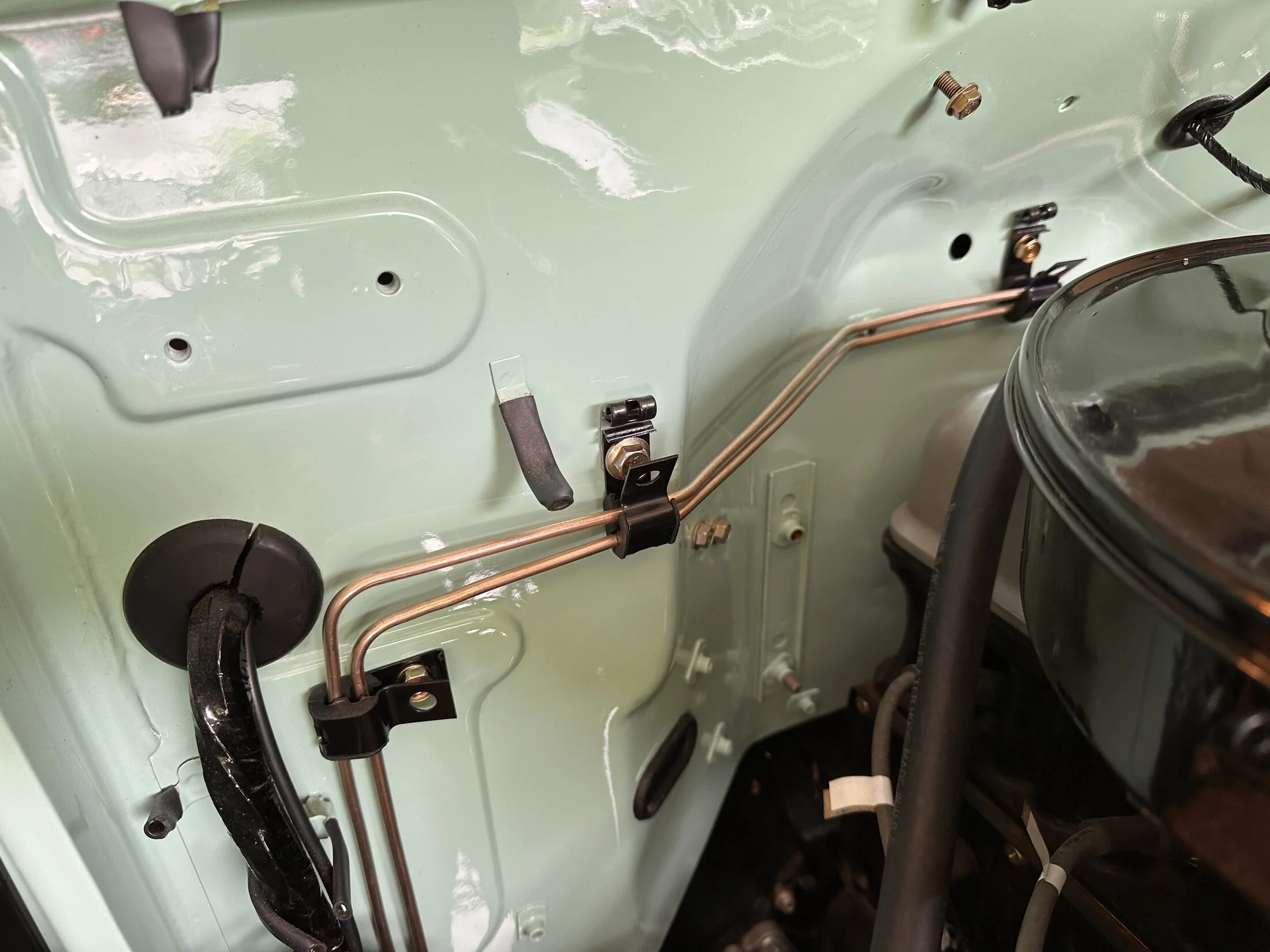

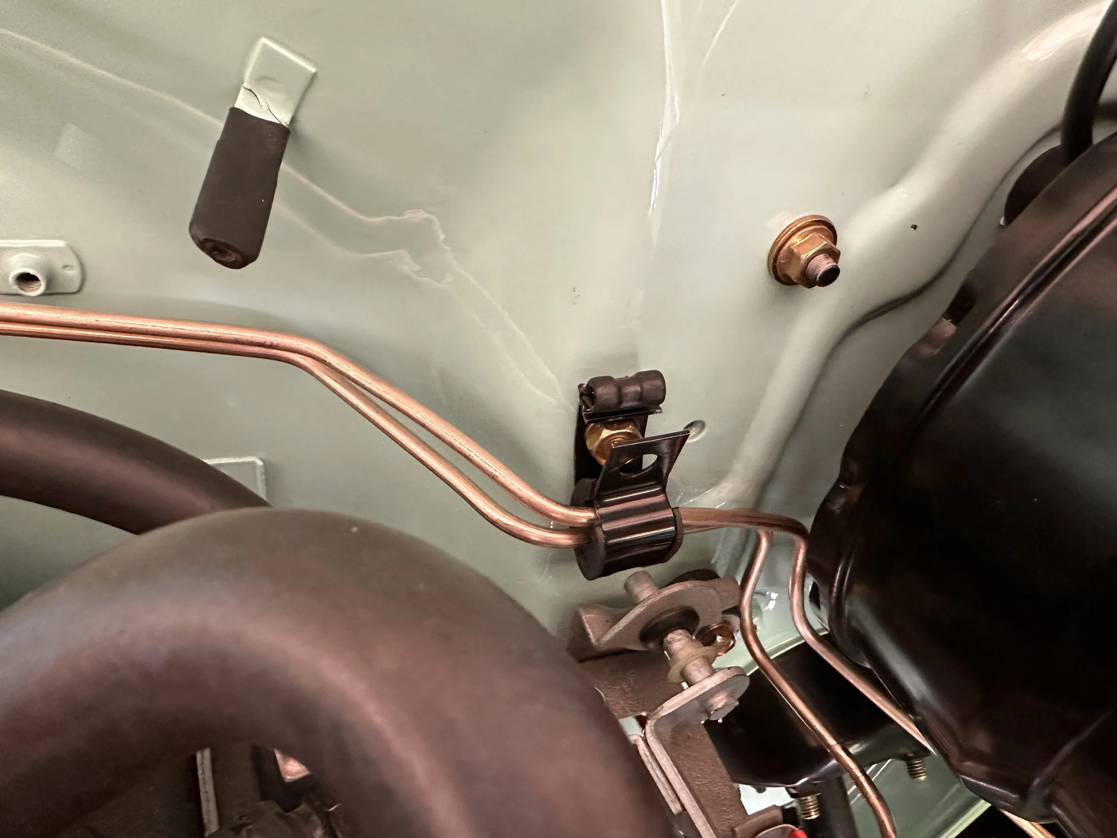

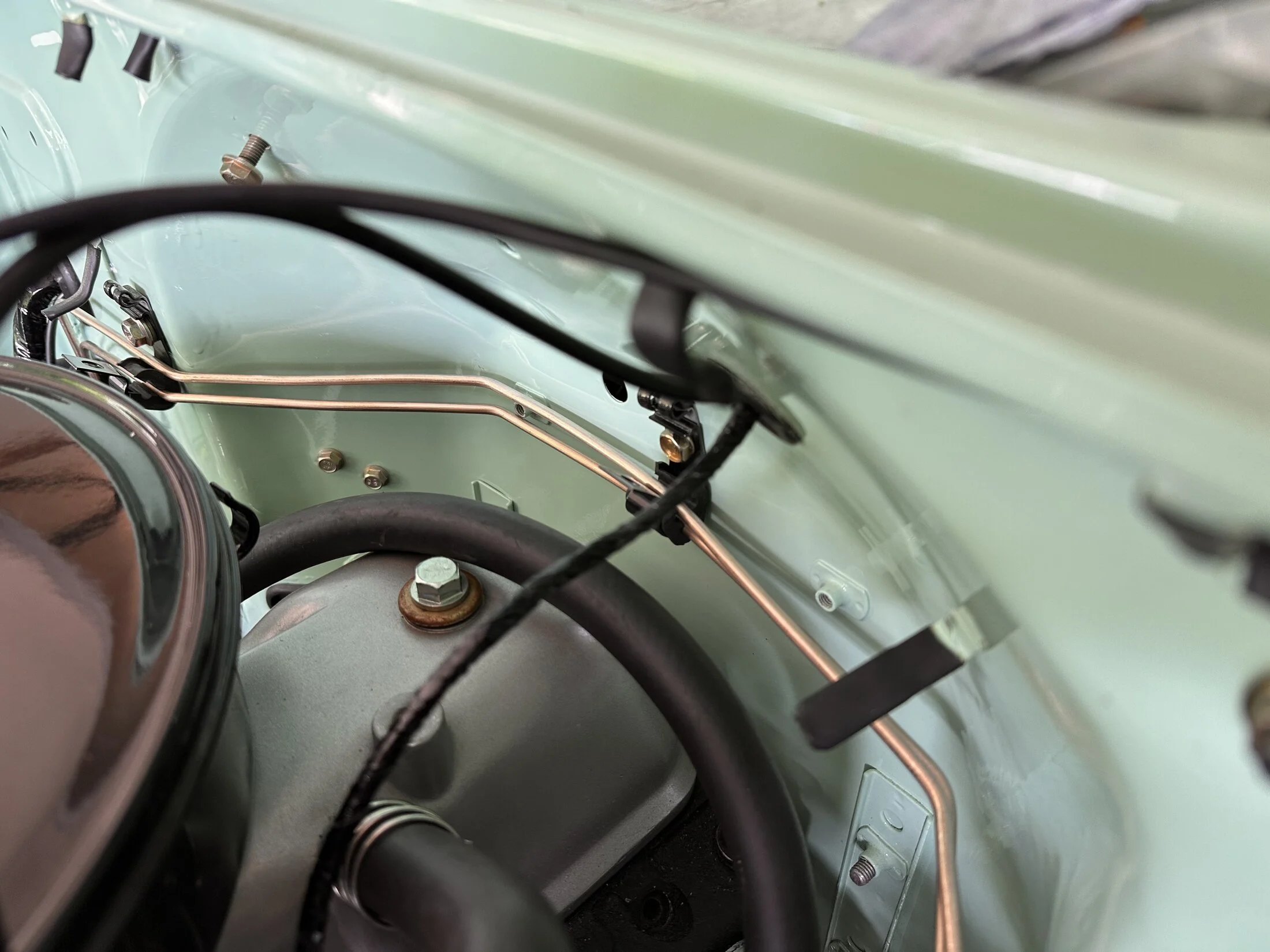

Working to finish the brake lines (been putting off those long curly lines that go from master to the frame 90 degree fitting with the little pig tail curl in them). Then I "found" that I lost that dual 90 degree fitting, so I'm in the process of finding one.
Also put the wstripping on the rear amby doors and closed them so they could sit and compress. Been closed for about 5 months. Tried today to open them and found that the rear hatch striker doesn't clear the rear plate when I turn the handle, so I get to adjust that and make it fit.

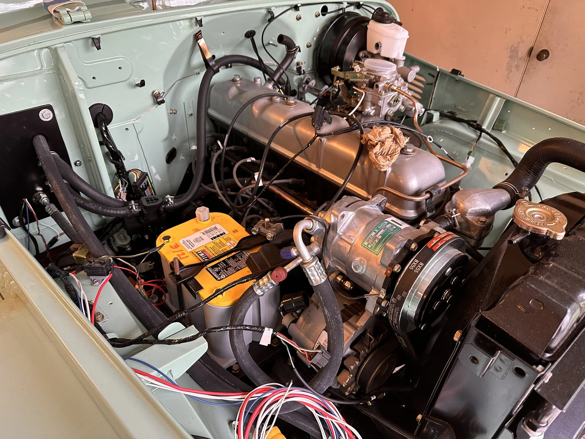

Vintage air and other engine views:

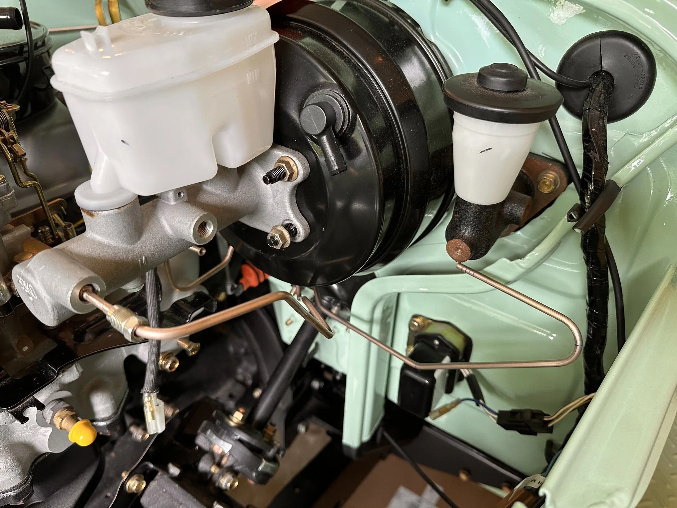

You can see the mockups of the brake lines coming from the master below:

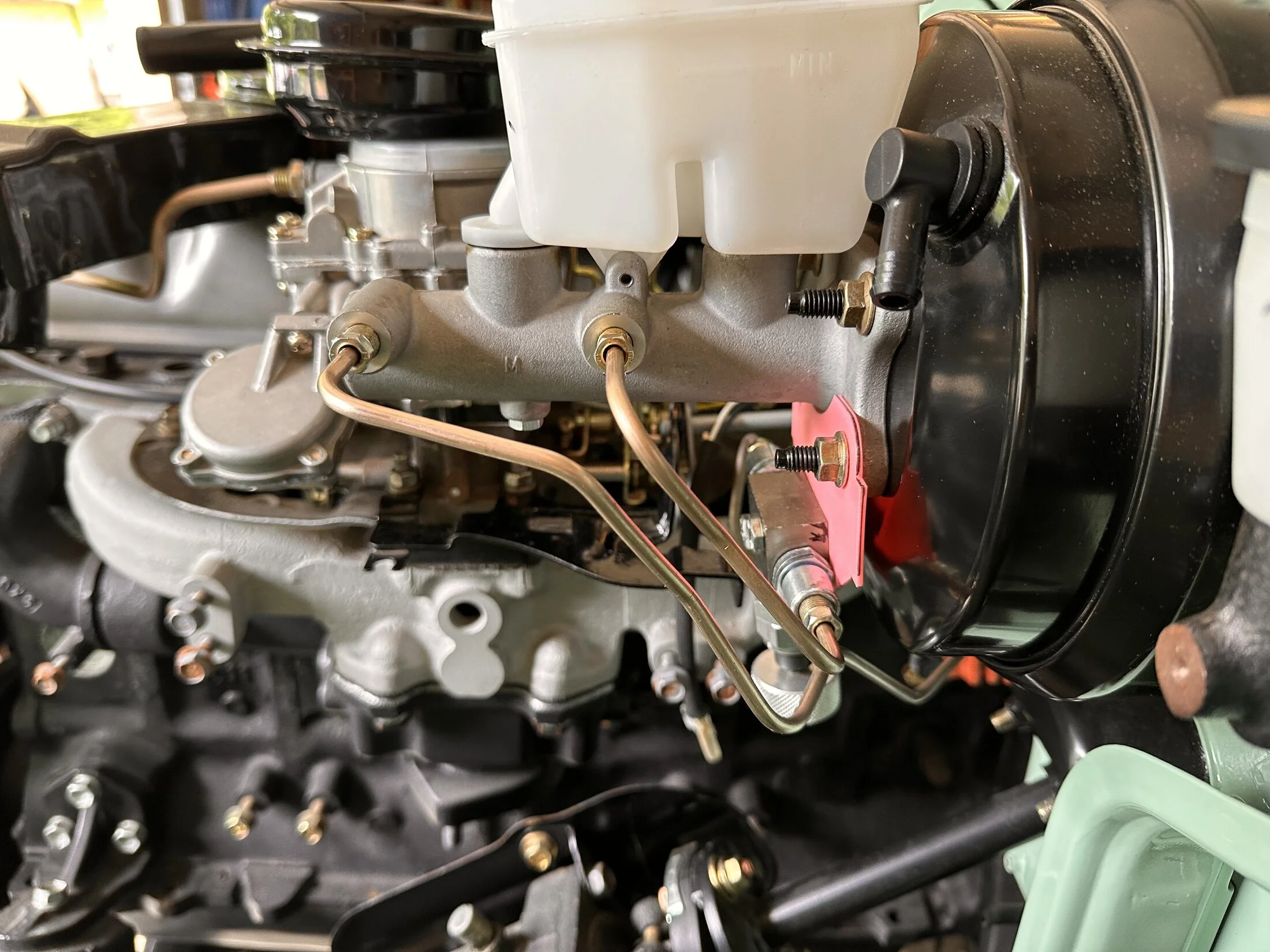

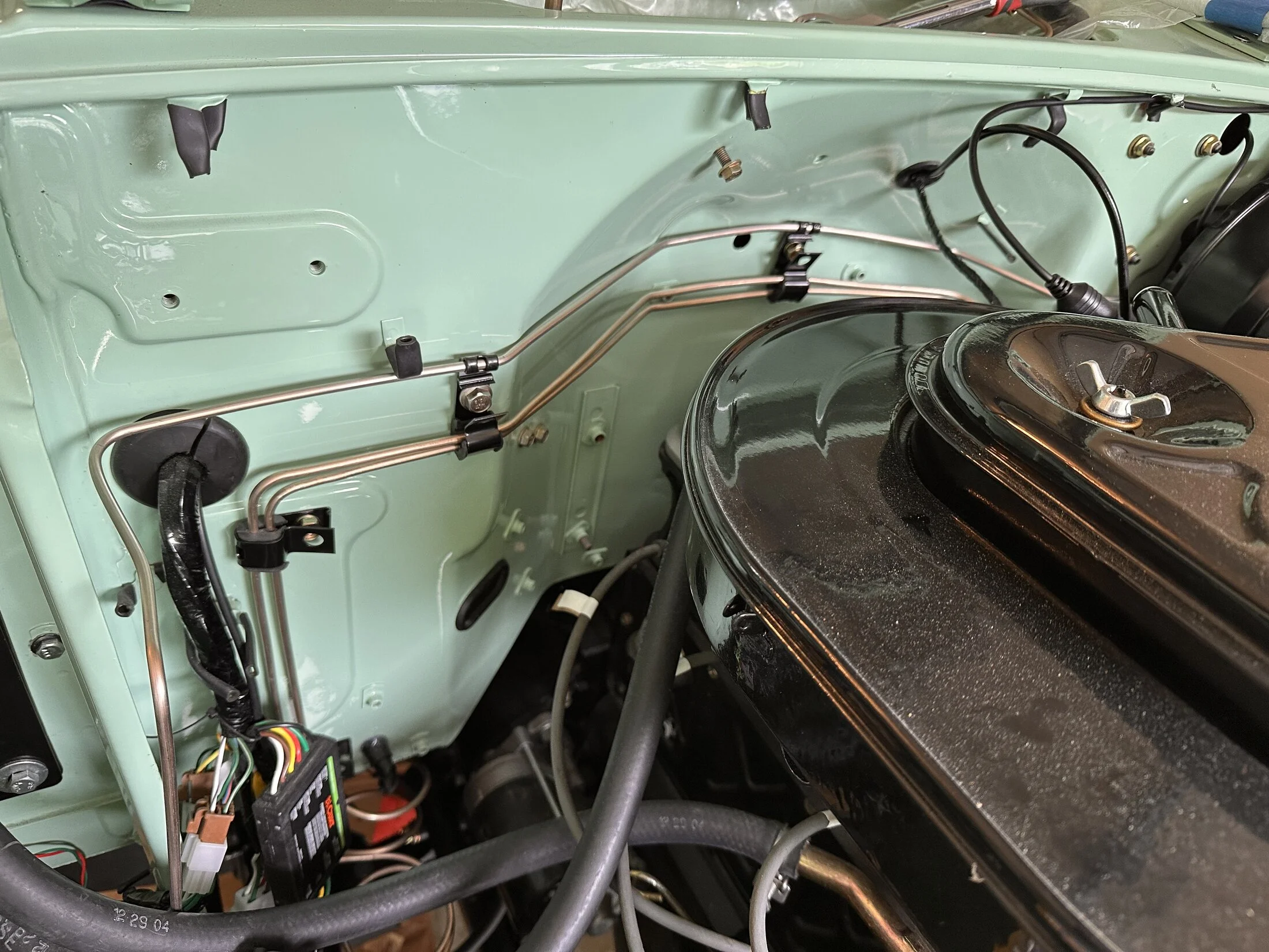

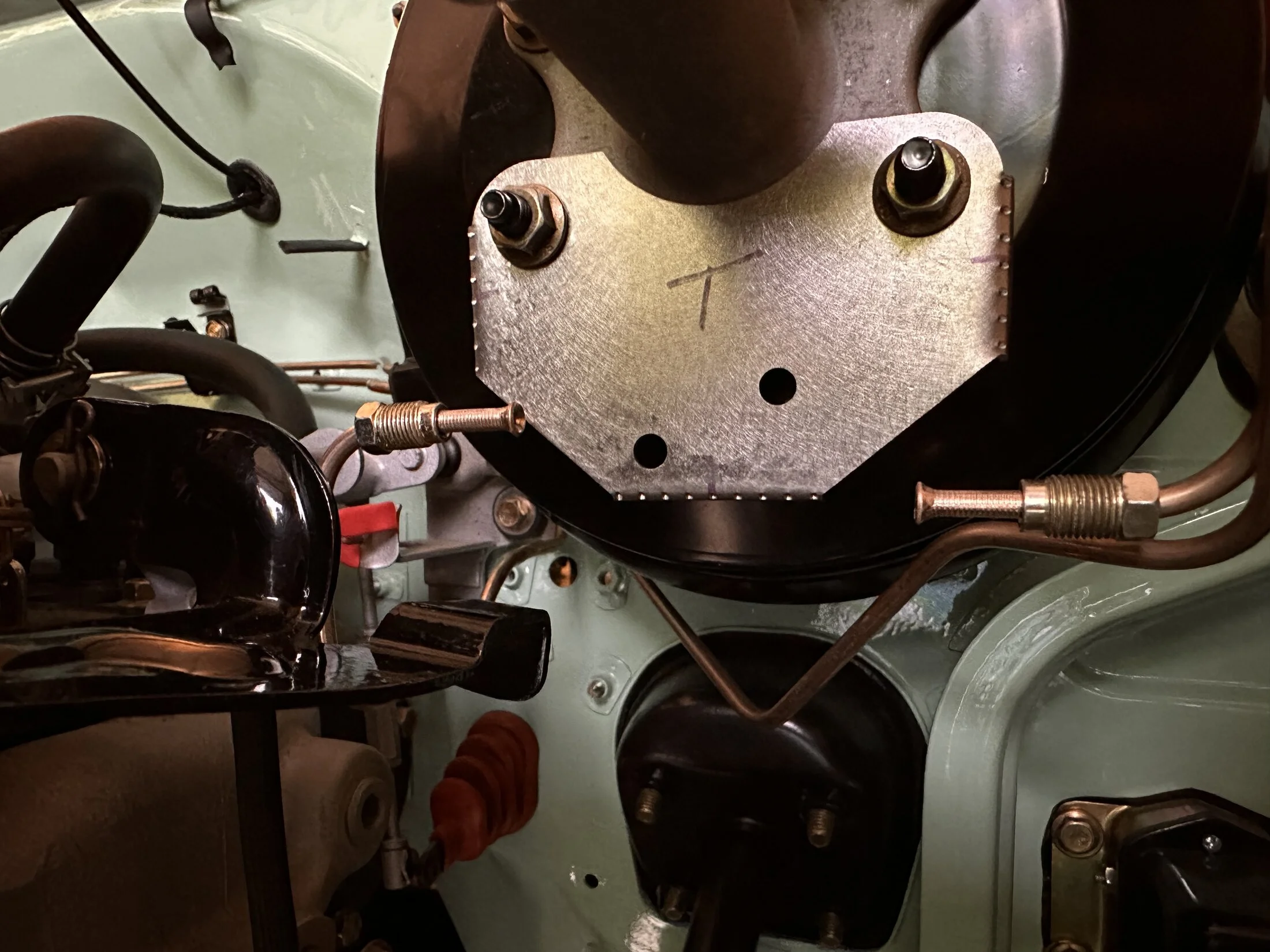

I don't know. Just a shot of the vac lines that are unfinished. Had space for one more photo.

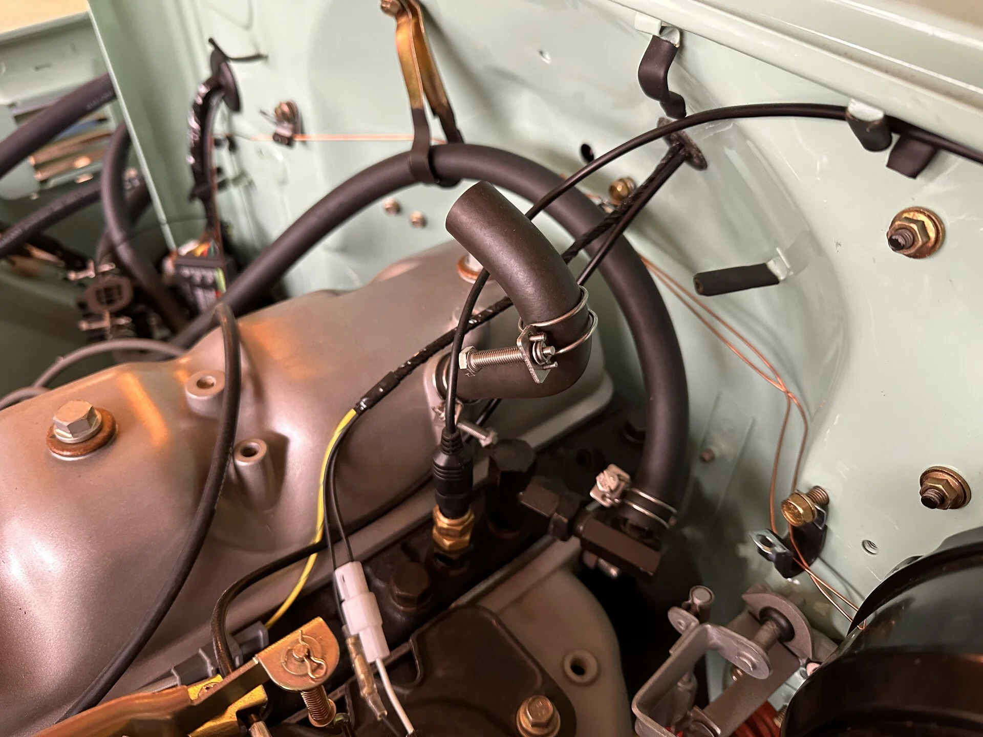

Does the line coming from the valve cover go to the brake booster?

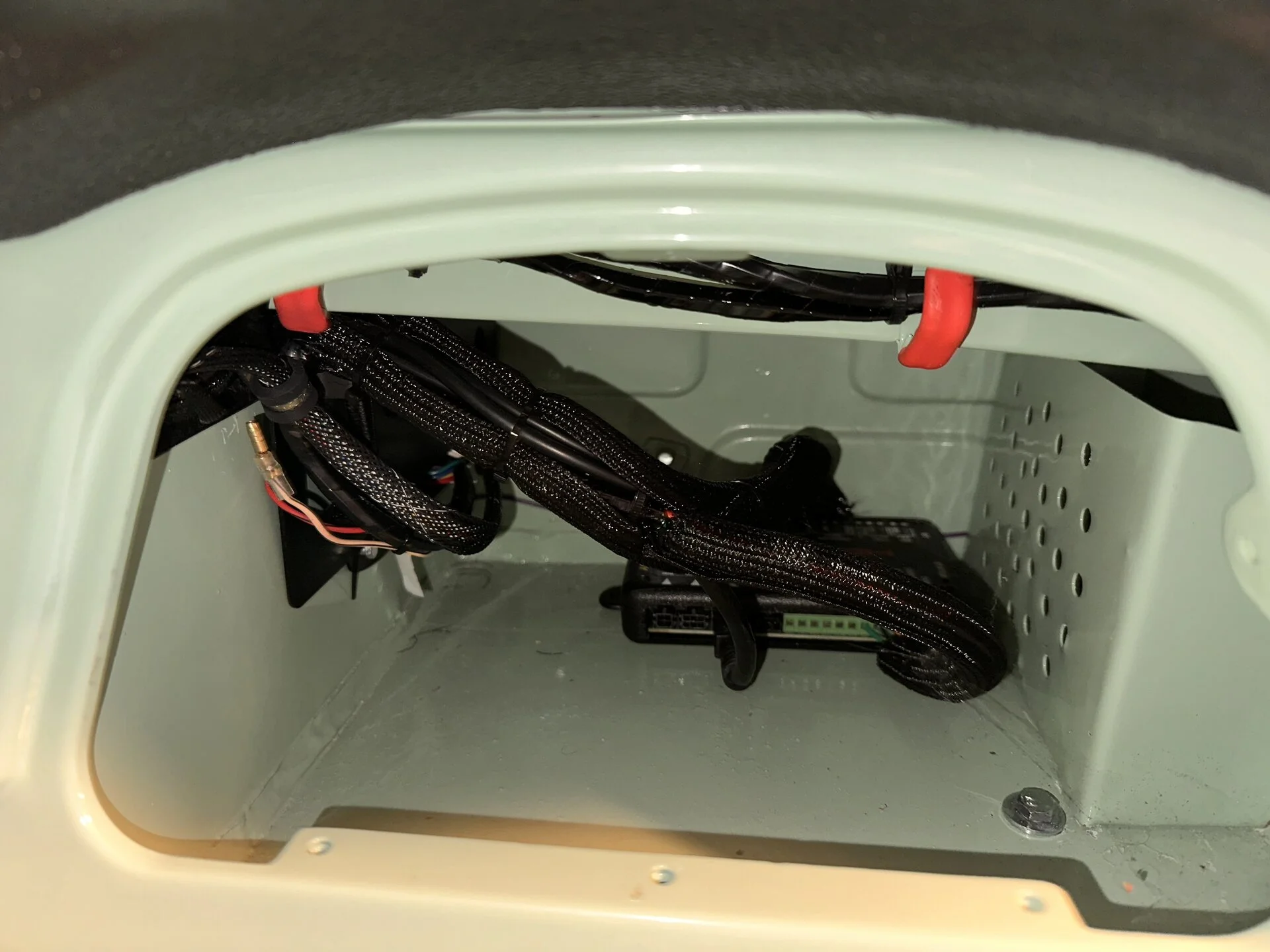

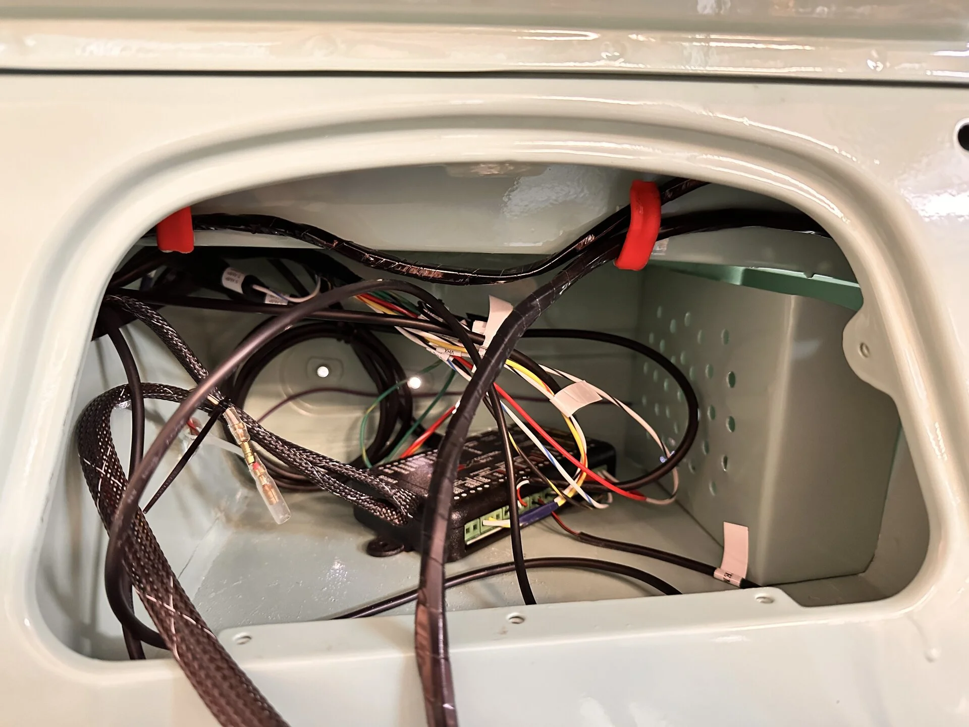

Goes without saying the wiring harness has been laid in place.

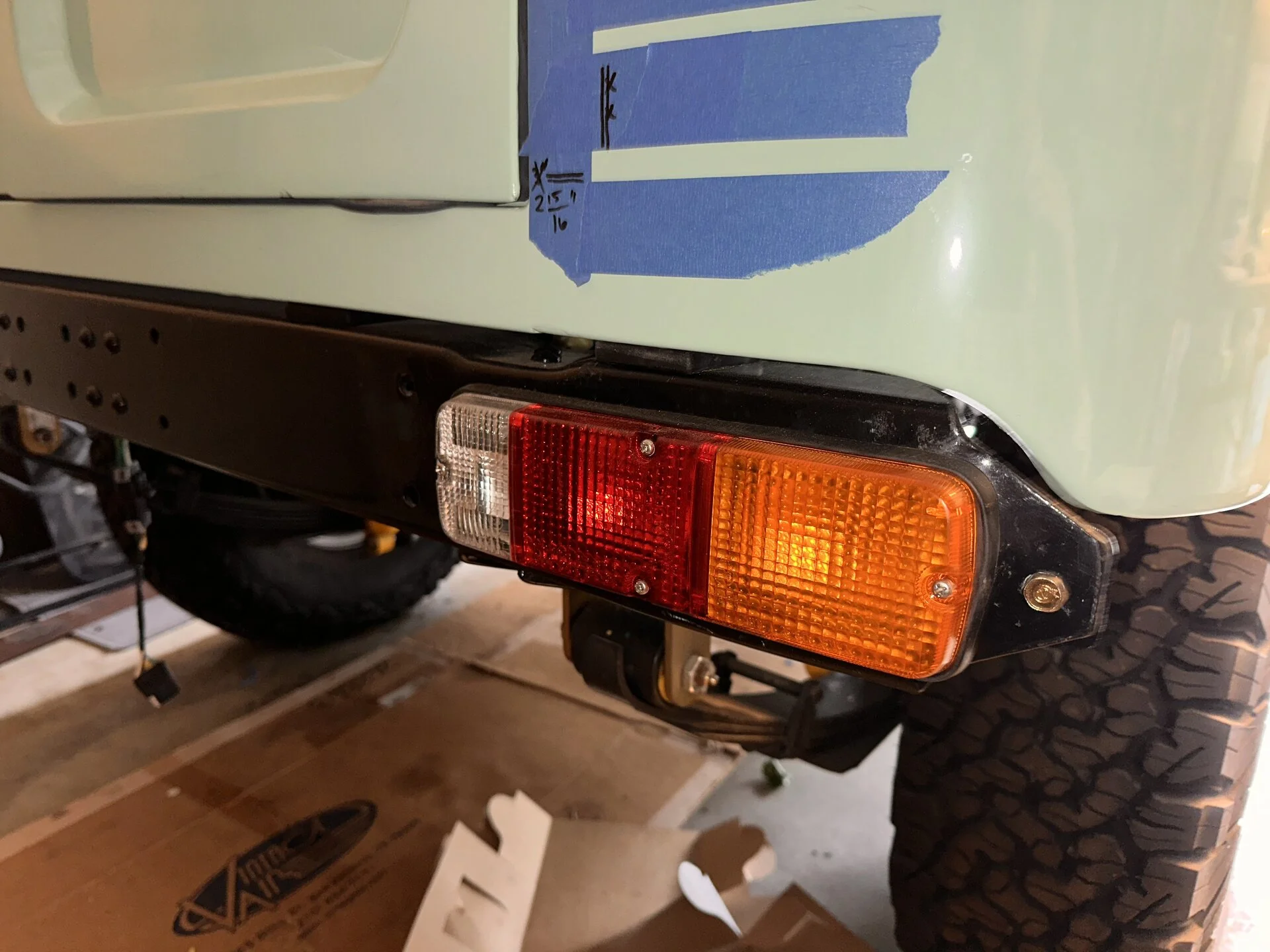

Rear tail lights. I even have the damn covers for them in the back.

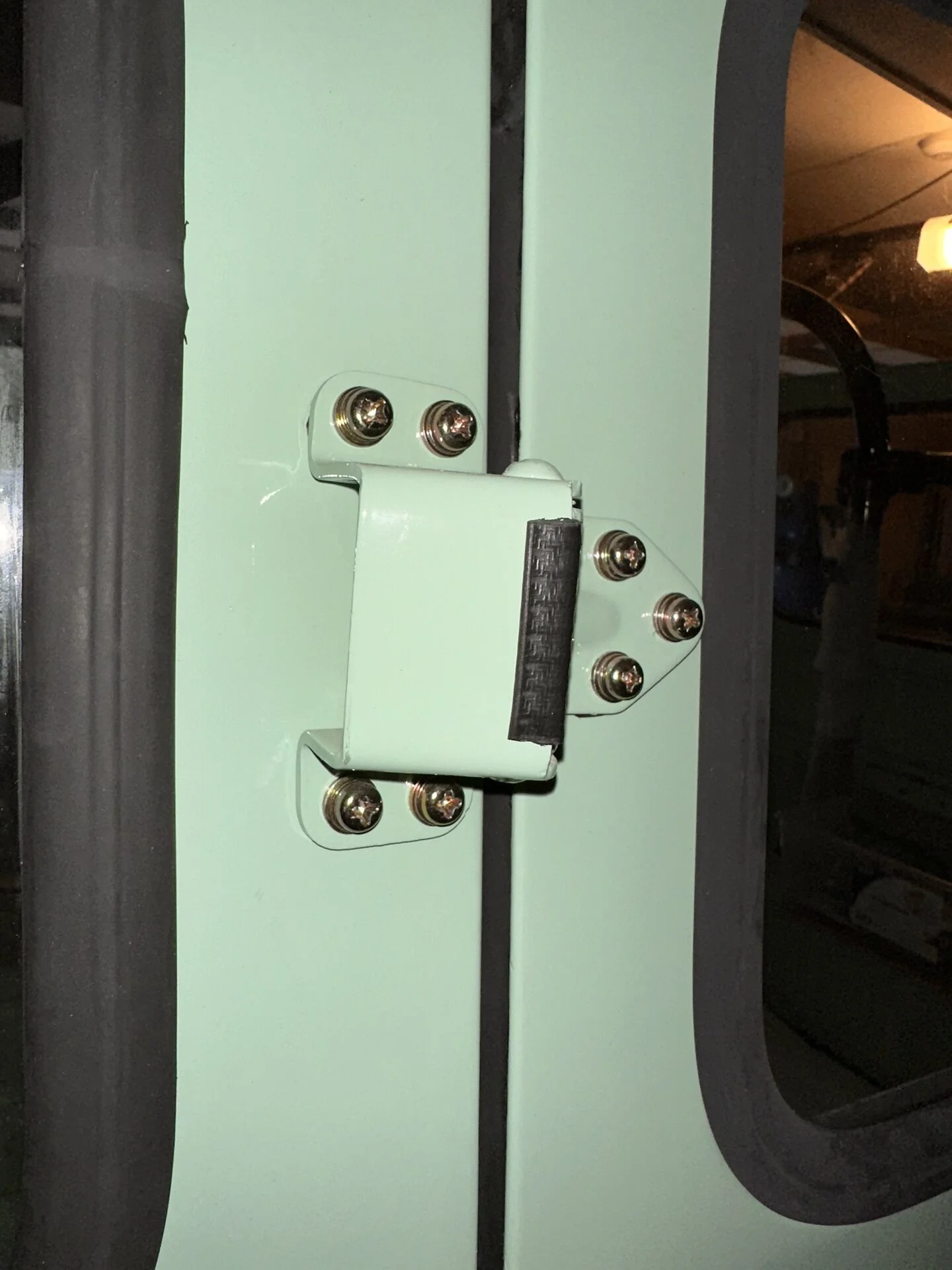

Rear hinge protectors for the door (a little edge trim). There is a factory piece still available for these (see the Unobtanium thread - its somewhere in there):

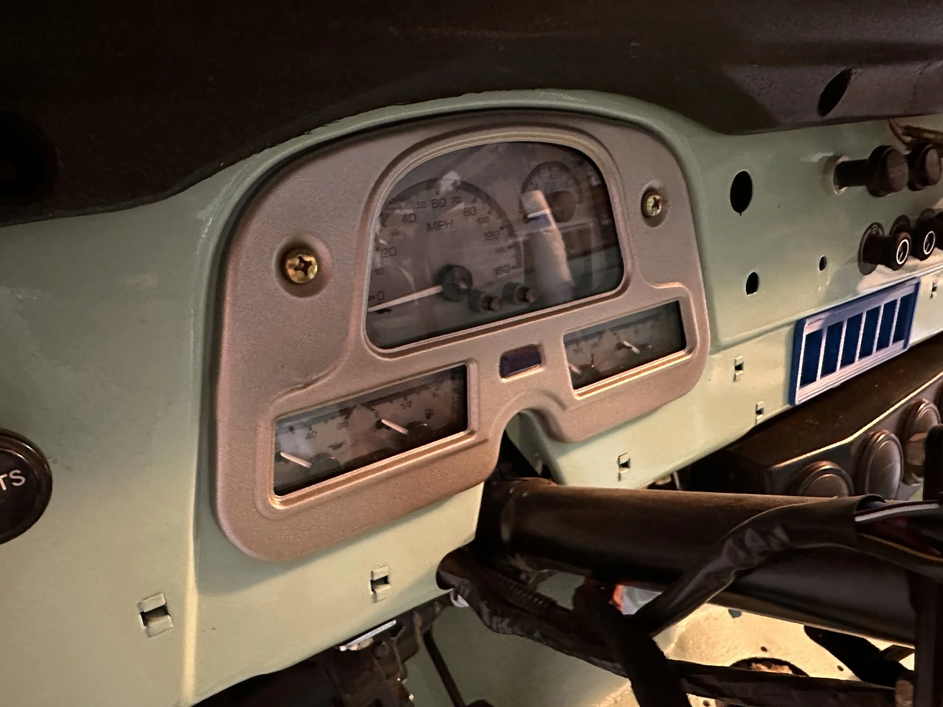

Shown previously but the Dakota Digital instrument cluster:
Tranny hump laid in place:
On our 197, the brake booster vacuum feeds off of a port on the intake manifold.
That goes to the air filter housing. Brake booster comes from the intake to provide vacuum.
That's right. I knew that at one point. That's why the J-hook hose is there.... Keep forgetting there will be a filter housing above the carb.

Been trying to sort out the hoses. My year (10/75) or maybe just my truck has some weird sh*t going on.
Example: rear hose from frame tube to axle fitting has a round hole in the shoulder for the hose head to clip to the bracket. Supposed to have a hex hole. Cruiser Matt has been helping me figure that out. He has replacement bracket that he is sending me as well as a clutch hose that has the round shoulder in the fitting to fit the bracket. We shall see which one works.
