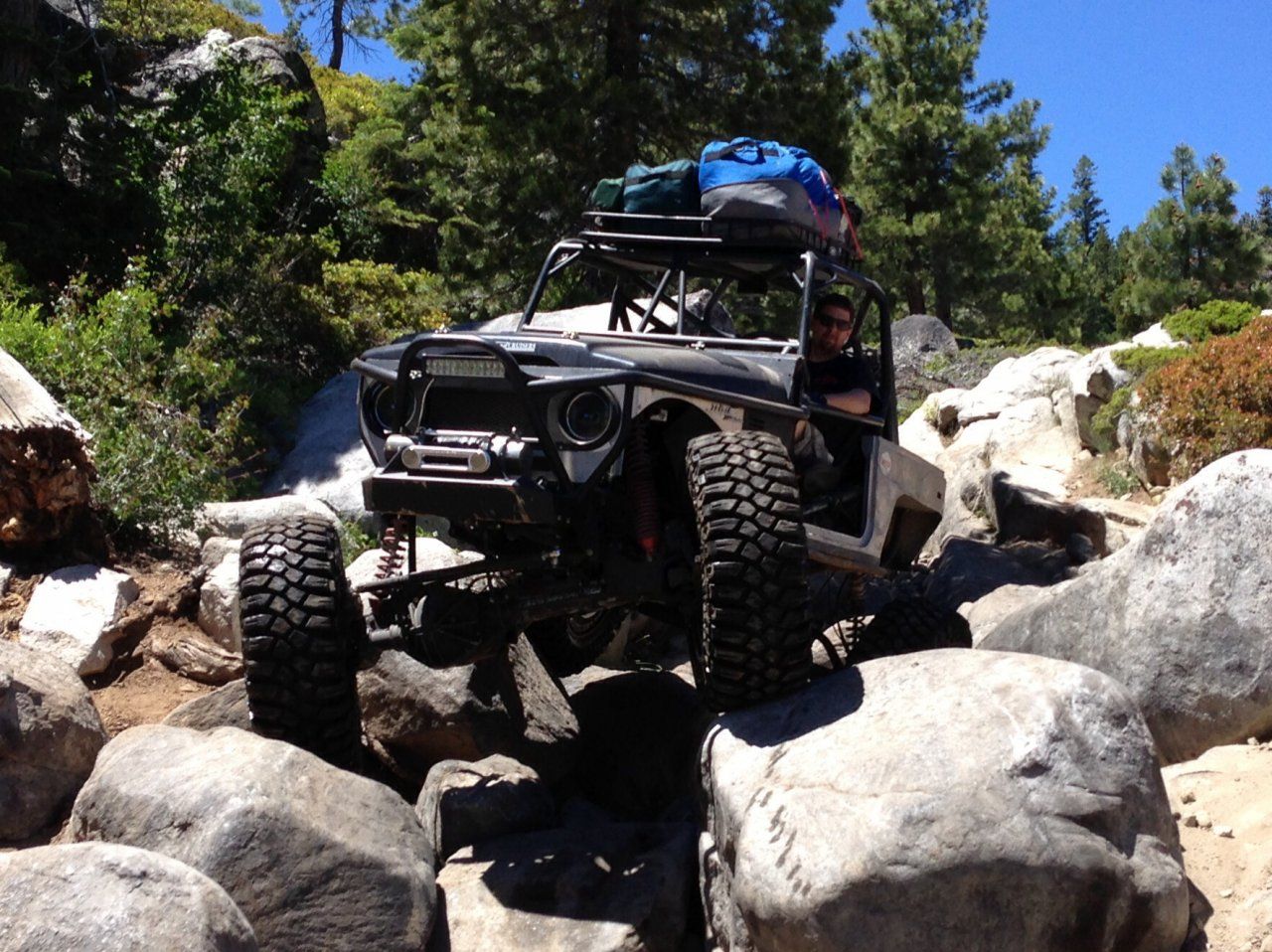

These are 2 of my cruisers. They both have sag ps boxes and they're both fun to drive, having their intended purpose.
Georg @ Valley Hybrids
