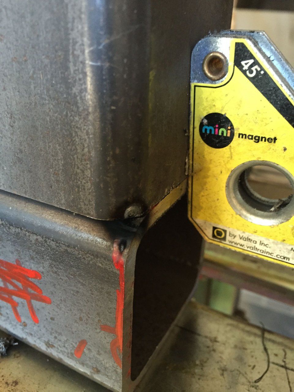

My quest to build a car body rotisserie continues. Welder is working again. I removed the bad relay and replaced it ($0.70), put the board back in, and got gas and spark to the MIG tip!! :smokin: (actually, this was a :banana: fix).
Pics for general interest (although it isn't very interesting if you are here for cruiser porn):
New Zettler relay. That little baby almost cost me $400. Amazing what you can do with a wiring diagram, a voltage/amp multimeter, and a little desire to be cheap!
Soldering genius :meh:
I can now WELD AGAIN BABY! (I did however let 800 lbs of expensive CO2/Argon gas leak out, so gotta hook up the new tank :redface:) And, I know that is not a weld! I just confirmed it had a spark. :flipoff2:
