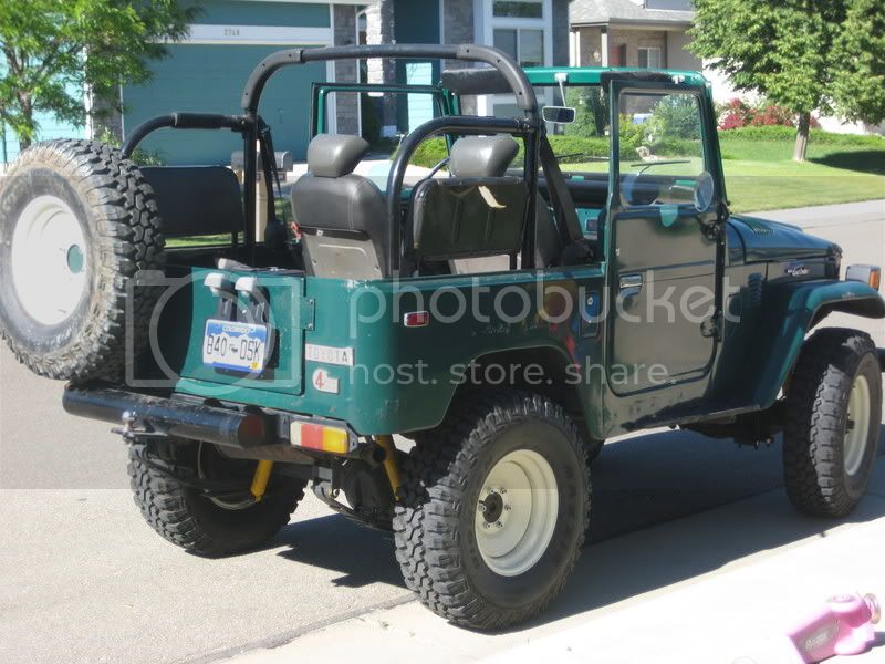

Looks like yours and mine both visited the same rear bumper fabricator. Or maybe it was a rare option in '76... ;)
Yes, and mine refuses to come off. A couple of nuts stuck on bolts in very unforgiving locations inside the frame rail. I've spent a little bit of time one day trying to get them off. It'll take some additional work - or a cutoff wheel. I need one person to hold the open end wrench in place, and one person to use the air tool.
Looks like the same JT outfitters bumper that is on the rear of my truck. If it is, it should bolt into the captured nuts for the original bumperettes/tow hitch mounts. The nuts on the inside if the rear cross members are all captured nuts, which won't budge. If they are stuck from the outside they are probably just super rust seized - but the bolts should back out from the outside of the frame rail.
Naw, mine are nice and spinny! If there were some in the captured nut, I removed those bolts a long time ago.
