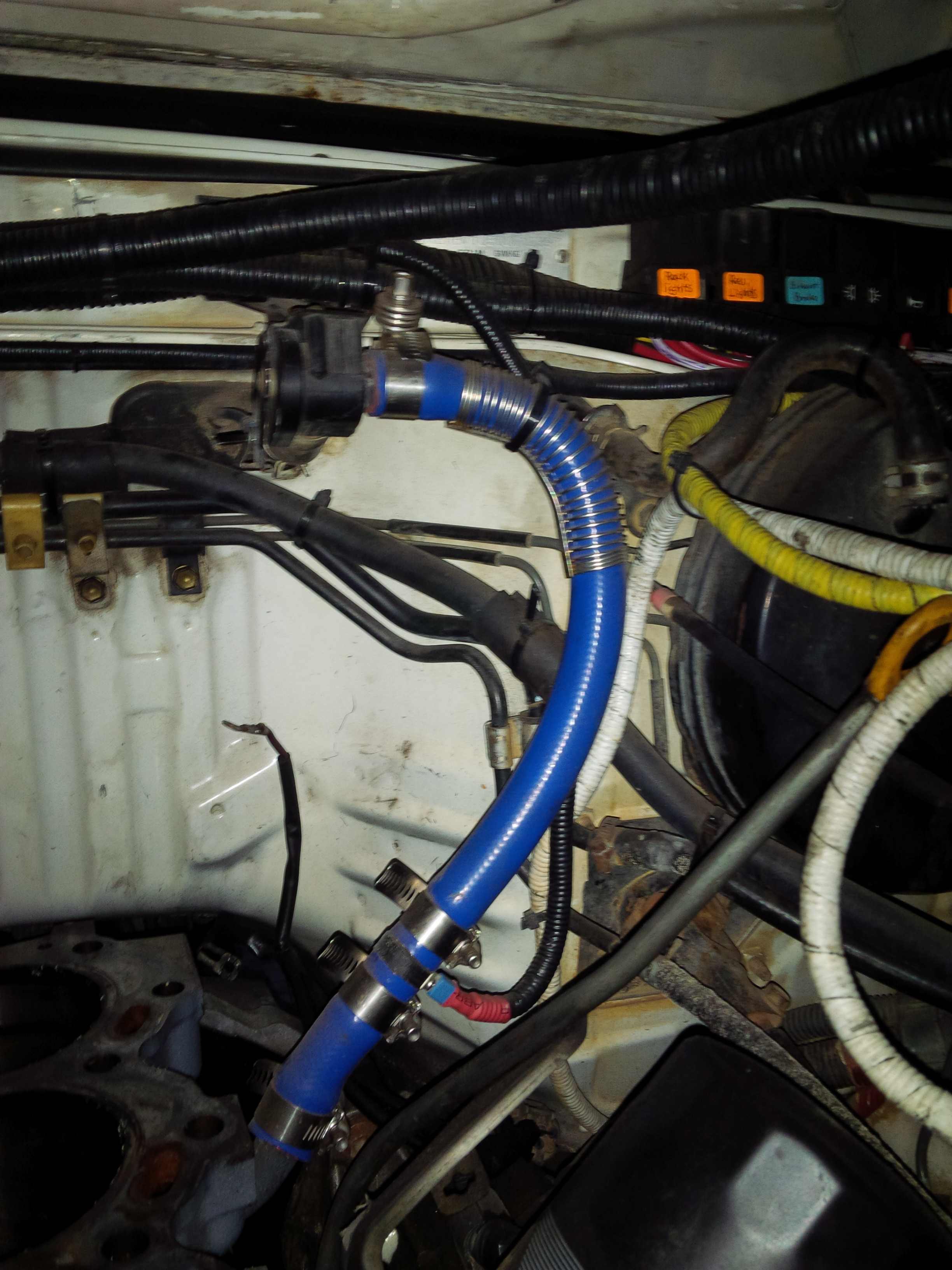

I also need to change the position of my engine saver sensor, it was going off all the time this weekend and driving me crazy... or the alternative is to workout how to get air bubbles of out the cooling system, which is the ultimate problem.
anyone got any ideas?
the radiator is full on every inspection, but at random moments (although usually when not under load), the heater hose (with the valve) gets air bubbles passing through it causing my no water sensor to scream like a baby, and its not always remedied by putting the heater control to hot (opening the valve). you'd never know without this sensor installed. it seems like after a while bubbles consolidate in the heater (highest part) and the water level eventually falls in that pipe to below the sensor... here's a picture i think i posted earlier of where it is installed, i could move it down an inch but i doubt that will make much difference. I might try moving it into the hose on the other side.
It warns him if he has a catastrophic coolant leak. As long as it is contacting coolant, all is OK. When it is not, the alarm goes off.
Not Toyota related, but I was delivering a big Class A diesel pusher about 8 years ago that developed a major coolant leak and without such a sensor, I would have melted down a CAT C9 diesel. The coolant temp never went up since there was no coolant contacting the temp probe. I got a warning light then the engine auto shut down 30 seconds later.
I am considering a sensor and alarm for my 74 since it does have a rear heater and it is conceivable it could develop a coolant leak under the body that would not be obvious ....
Yeah I had a catastrophic coolant leak on this vehicle, as I described a few pages ago. Just as elkaholic, mentioned, no warning from the water temperature sensor whatsoever, just a huge F'ing bang in the middle of nowhere. After that experience this sensor is 'necessary' for me to reduce my paranoia and stress.
Usually you put them in the bottom radiator hose, but I opted for the heater hose size as I'll be running a lot of that to the rear of the vehicle in the future and I didn't want to wait until the entire system emptied to hear the alarm, but I may regret that if air in the upper section is impossible to eliminate.
The ones I have seen on heavy equipment have either been in the top radiator hose or in a fitting on the thermostat housing. They give a warning fairly quickly when the coolant level drops .....

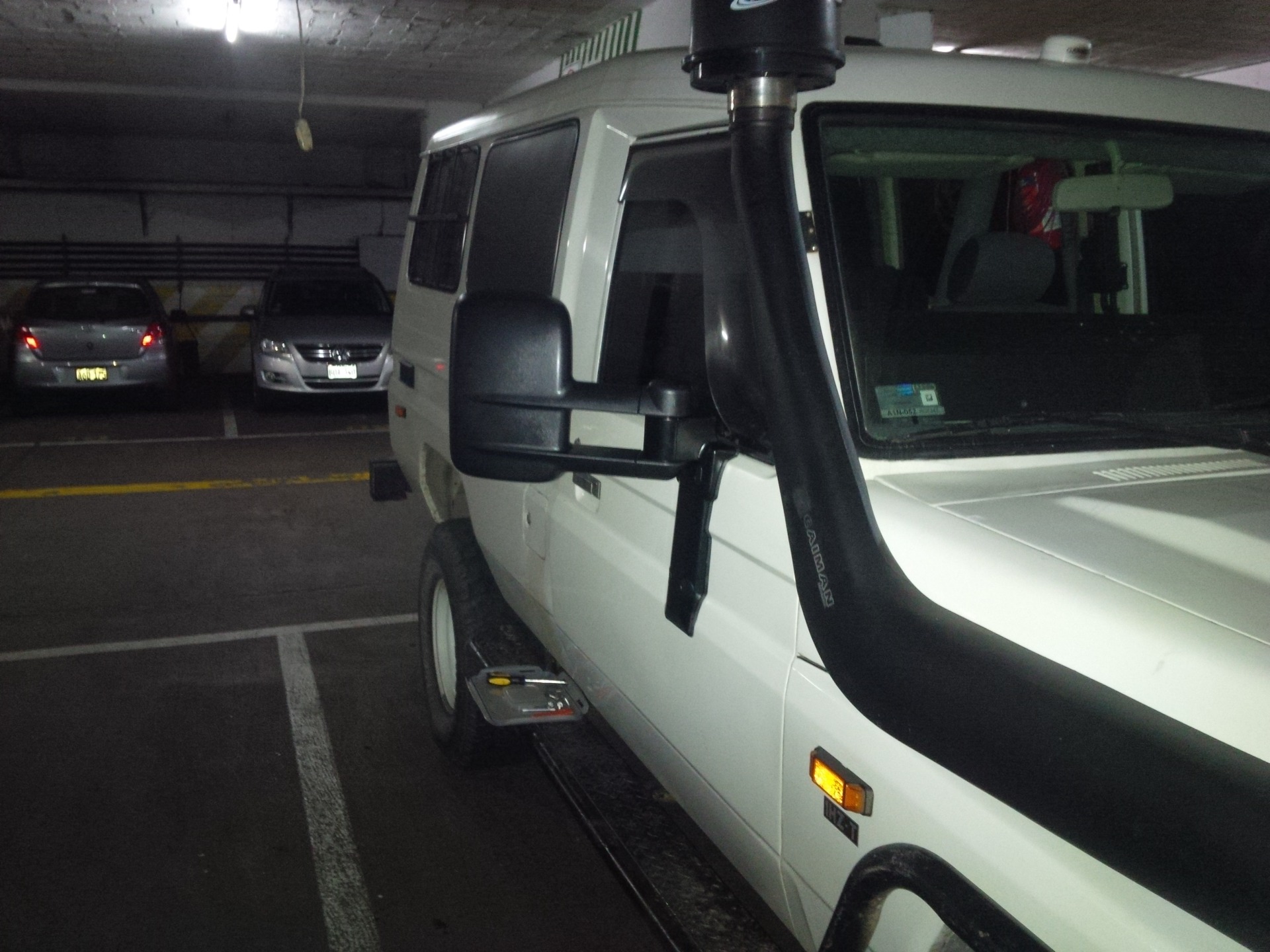

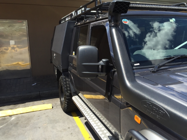

I got around to fitting my mirrors today, but couldn't do the electrics as I realized i'll need to remove the doors to drill the holes for the cables in the door/body.

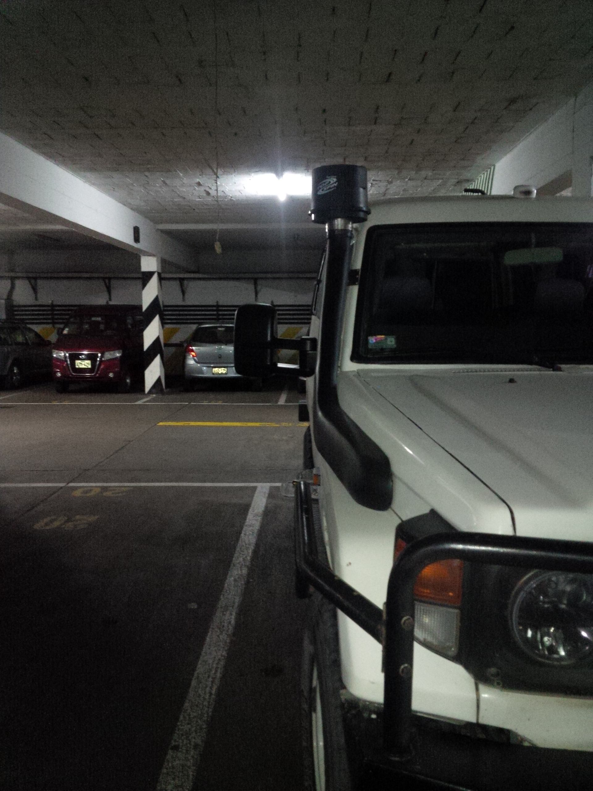

Wanting a solution to my blindspots after blanking out the windows, and wanting to replace my factory mirrors that can't hold themselves in place, I had originally bought these 'clearview' towing mirrors for their larger size and second blindspot mirror, also thinking i would remove the extra 100mm that they stick out by, just as this fellow on LCOOL did.
But before taking to them with a hacksaw i wanted to at least use them as designed for a little while, but after a drive around the block I can definitely say I'll be cutting them down ASAP, just too wide for traffic in crazy Lima, or anywhere really.
However I'm a little disappointed about the complete lack of any convex on the main mirror. my vision out of the main mirror is now much narrower than before, and I'm yet to determine if i have actually improved or worsened my vision overall. Having them further from your eyes exacerbates the lack of convex issue, so hopefully cutting them down will make a little difference.
another thing i noticed was they don't seal well at the top despite being molded for the 70's door, there's nothing putting pressure on the rubber from behind in the middle. I imagine water may pool there as well. When i cut them down i might fill in the top with some expansive foam or something similar so the rubber has some pressure on it.
so the jury is still out as to whether this has been a waste of money or not... but they are certainly many more times more sturdy than the factory mirrors.

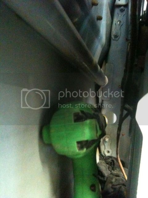

while on the subject of wires through the door and q vent windows,

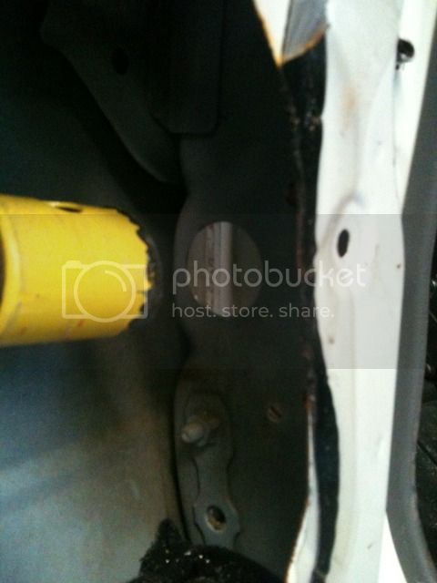

I installed all the oem toyota electric windows, locks etc in my 79 series and didnt have to take the door of for cable access, you can fit a drill and holesaw in the door when you remove the door card and also drill inside the cab kick panels to get out to the door make sure you remove all the swarf and have a vacuum going while drilling.
As for the q vent glass i removed mine and installed full glass and had the same issue at 110kph with wind pushing the glass out of the runner when they wound up especiallty annoying with auto up and not watching the glass., i noticed on the vdj 79 gxl with full glass they have little guides in the window runner so i bought two of them and clipped them in the channel wind problem solved.
do you have a photo of where you drilled? I might have been able to drill the inside of the door, but my rollcage is preventing me from doing that, and removing the doors is easier than removing that section of rollcage.
i can get a pic no problems tomoz

That hole size was to suit the oem electrical rubber glands if your just running for mirror wire you can most likely just use a drill bit for a hole
