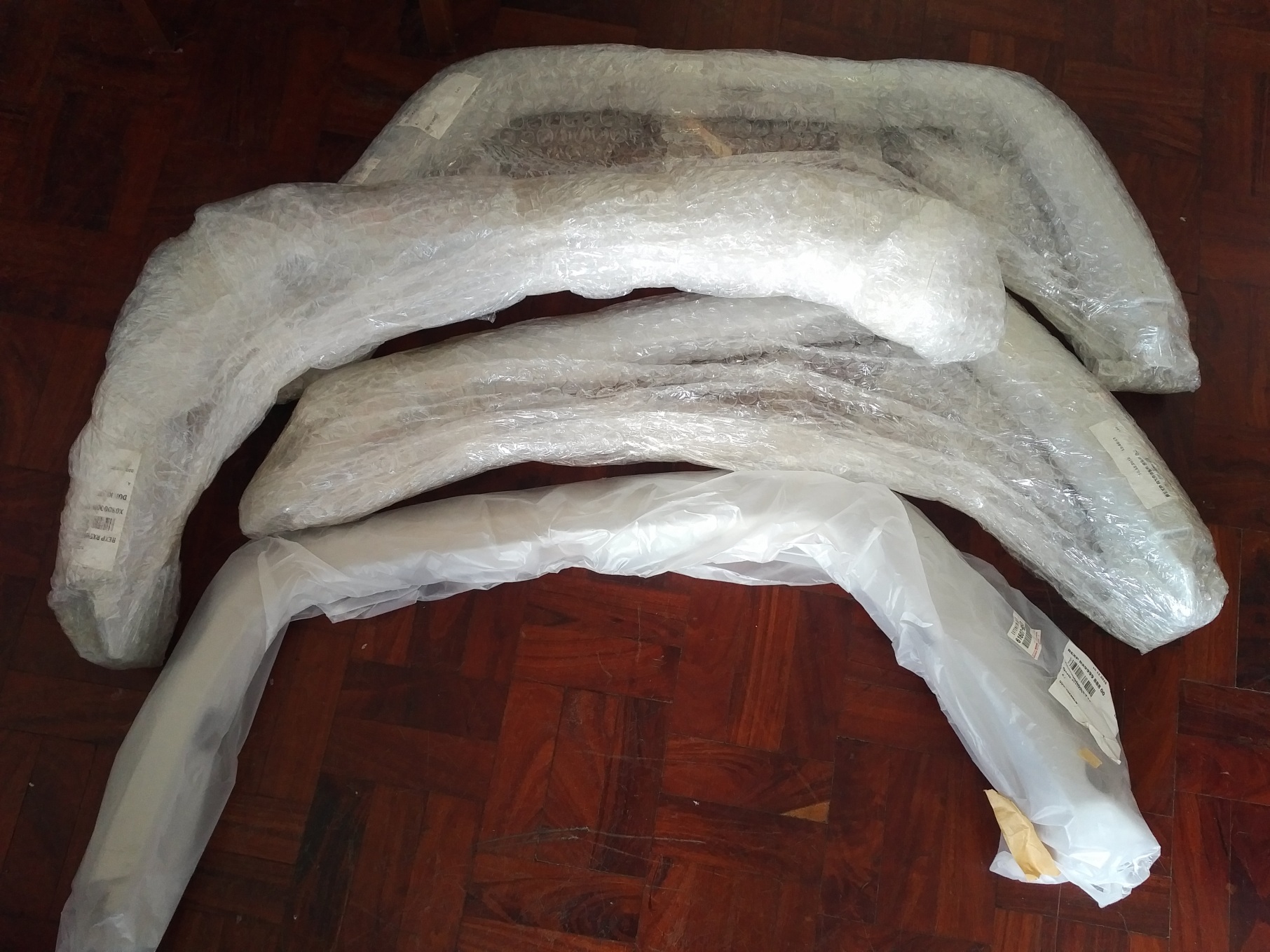

got my OEM fender parts the other day, a small amount of missing parts, but just in time to be able to at least mock them up to be able to start the new bumper and sidebars.

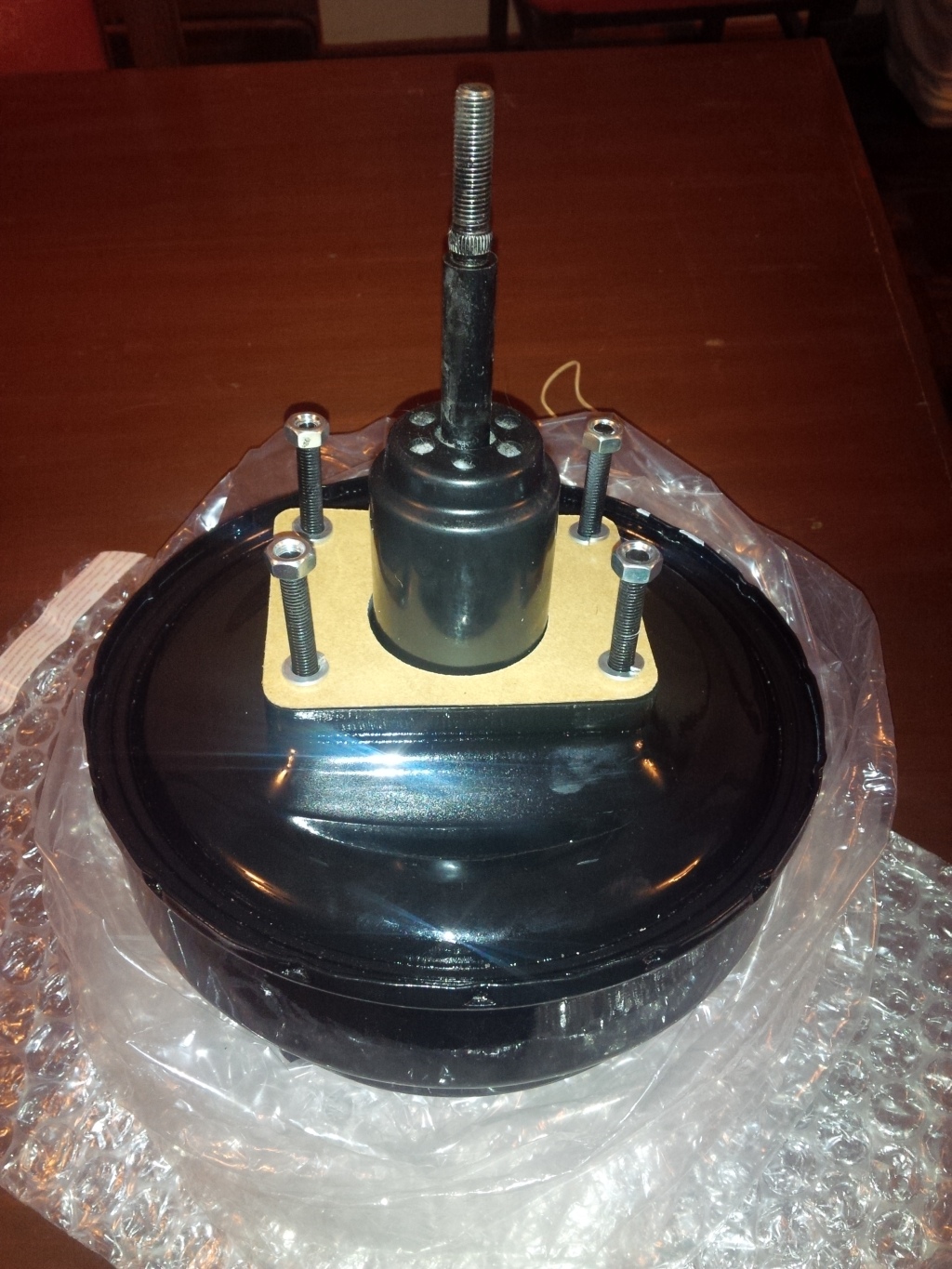

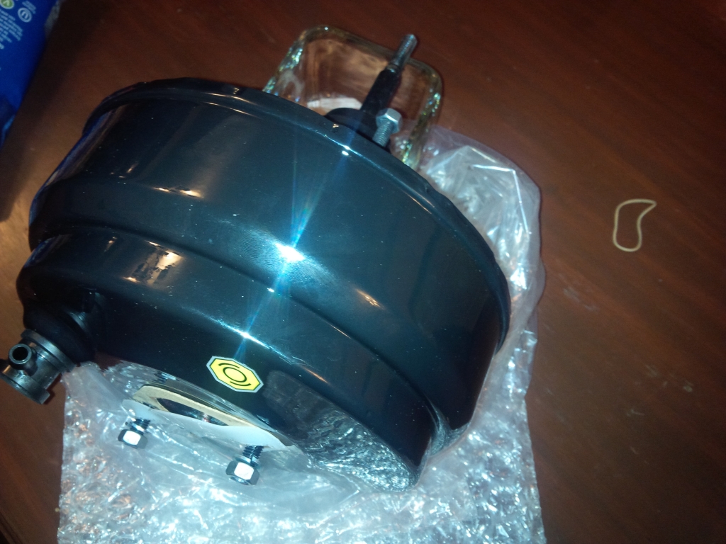

anyway, with not much getting installed i thought i'd show something at least, here's my double diaphragm brake booster from Mako in Australia that arrived days before we travelled there last year (big delays). I can't say much about it so far until its installed and tested, but they usually have you ship them your booster, they modify it and ship it back. I didn't want to do that obviously, so i had them source one locally and they shipped it out, but because Peru, like many countries, prohibit the import of secondhand parts (so they don't become a trash can for developed countries), I had to get them to go to some lengths to make the modified second hand booster pass as a new part. I was very happy with what they did in the end, as i had been let down (and had parts confiscated) by other aussie sellers previously who had promised to clean up second hand parts and hadn't. hopefully the brake lines still fit as they promised. i hope to get it on a brake testing machine before i put this in so i can measure the difference.

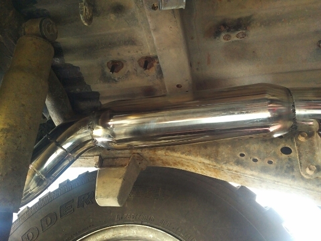

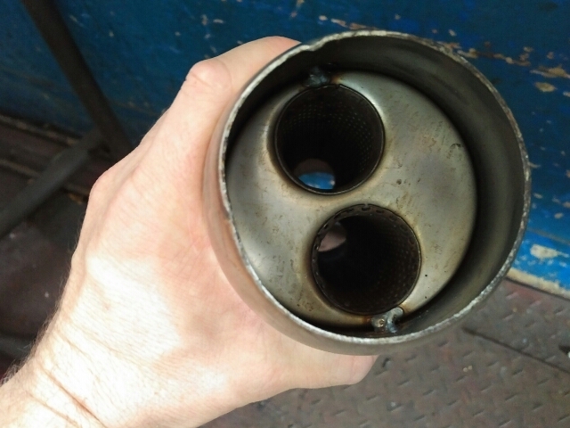

Anyway, as to not get off on the wrong foot with new neighbours, I made some time to add the second hot dog to the exhaust, this time with much more reduction than the first one. makes a massive difference in sound reduction, especially the turbo whistle... I have accepted a slight reduction in power, it's noticeable but only just, so I don't think I will need to open her up completely again.

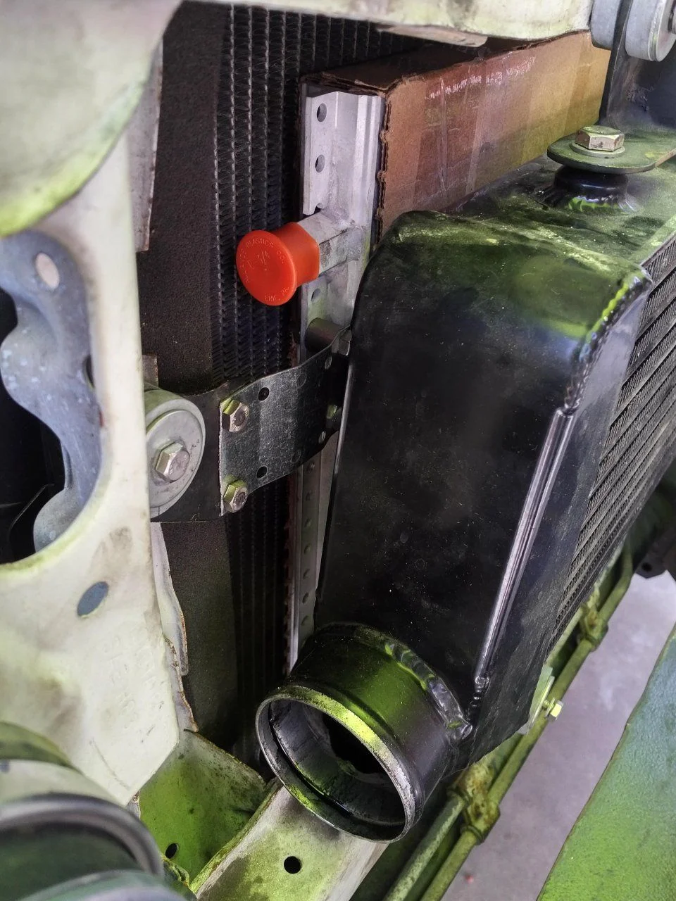

Hey all... question for any cooling experts.
Any ideas on how much of a gap i should leave between radiator - condensor - intercooler?
I can see possible merit for both arguments, as close as possible (less turbulence) and as far apart as possible (more airflow?), but I've yet to decide or hear from an expert which is more valid.
When I previously installed it was setup for as much gap as possible, but as you'll have read my head crack became apparent before i could get any decent amount of miles on it to test. I'm adding a bigger aircon condensor this time (last one was a bit too thin i think), so i have the chance to doo it better.
I also suspect that with big gaps the air might skip the intercooler due to greater resistance and favor the edges of the radiator where resistance will be least, especially if the gaps create turbulence, but I'm guessing really and have no experience myself with this.
Any ideas? I have a maximum of 1 1/2" of space to distribute between both gaps, less if i want.
I was also thinking of leaving an even maximum space and putting a thin layer of foam around the edge of the condensor to reduce turbulence and maximise the flow through the area that passes through all three of them. Not sure if that is common.
I guess a good clue for spacing would be to see what the OEM installations of front mounts with AC are like, but i have nothing like that to compare to right now.
