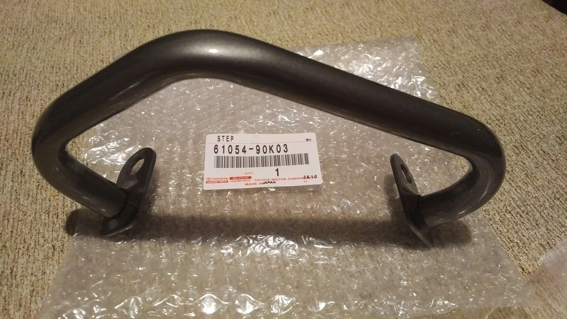

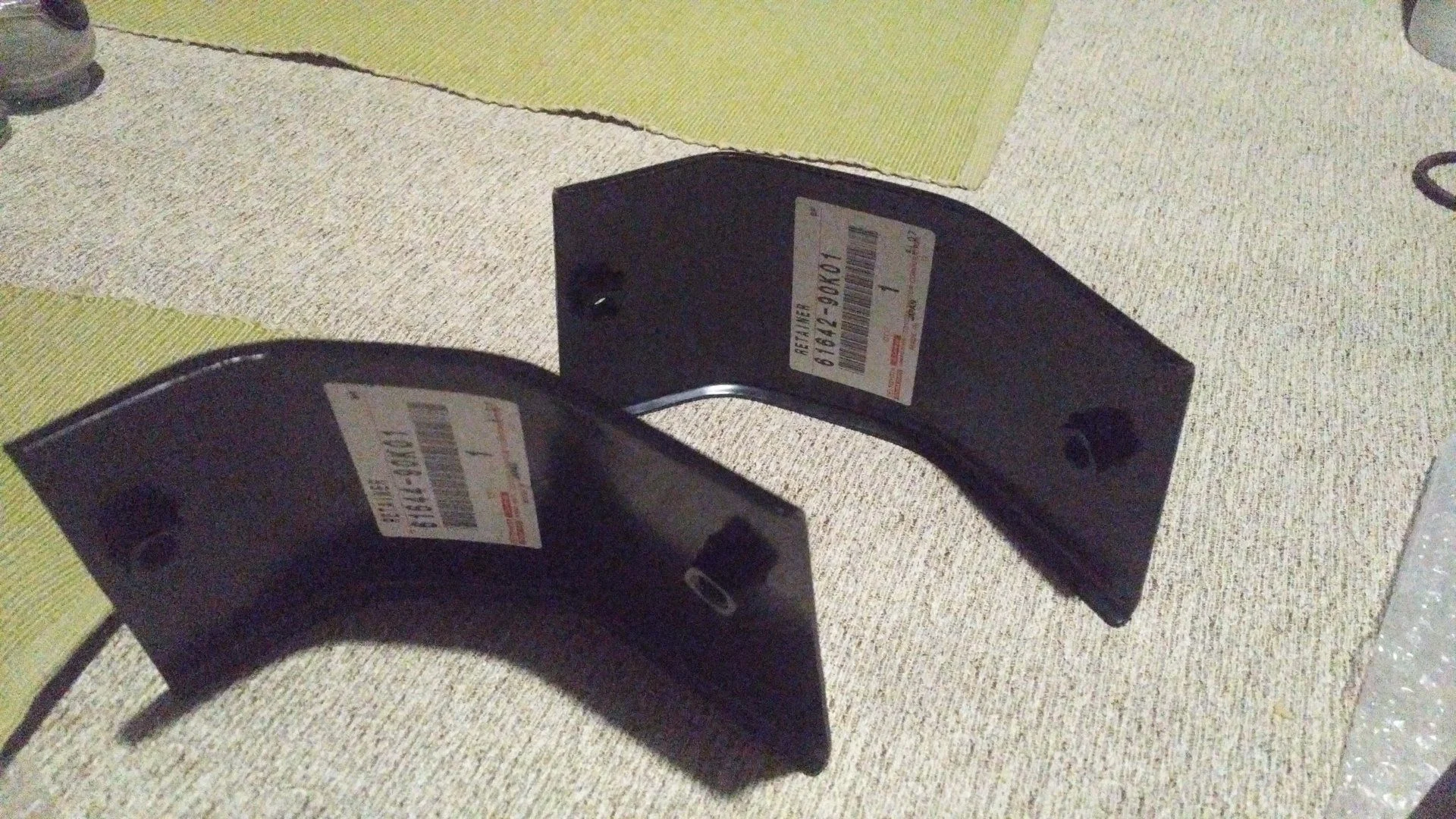

These turned up recently. Factory foot steps for the rear left pillar. Still waiting on one of the steps, but apart from installing these the plan will be to fab up similar steps for the rear right pillar and two on each side to keep the factory look going.

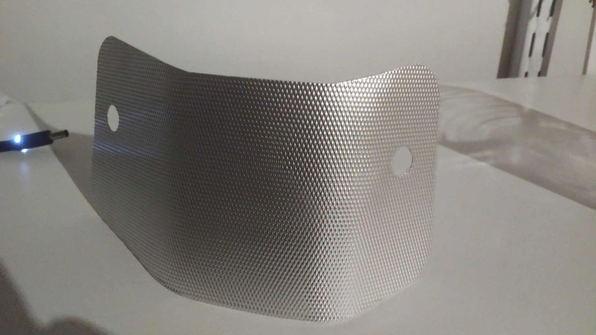

Not sure if I'll install this thin aluminium shoe toe paint protector, as I would want to paint it and I'm not sure if I could source the same material so they all look the same. Had to order them to see what they were
Hey mate, once i got the holes right and could bolt them on, i just used automotive adhesive/ sealant on the retainers, which also ensures they seal. I think it was Sika 227, anything like that will work.Hi Damo,
Curious on how you installed the retainers? 61644-90K01 and 61642-90K01
Did you weld them on the body or just bolt them on?
I'm not sure how the factory did it.
Not sure what you mean. The retainer is thick sheet. It goes inside the pillar body panel and the step is bolted to it. Its pretty solid being on the pillar.Are the brackets welded to the piller from the factory? If they are, then the steps will fail because the weight is only on two points and a thin sheet metal in between.

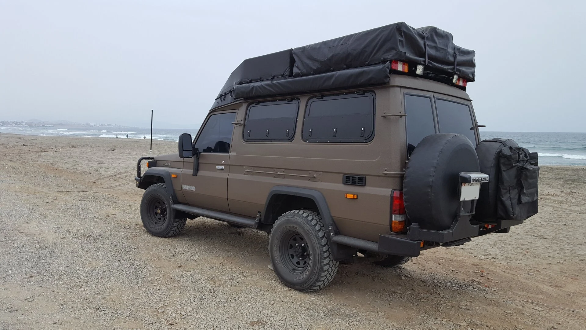

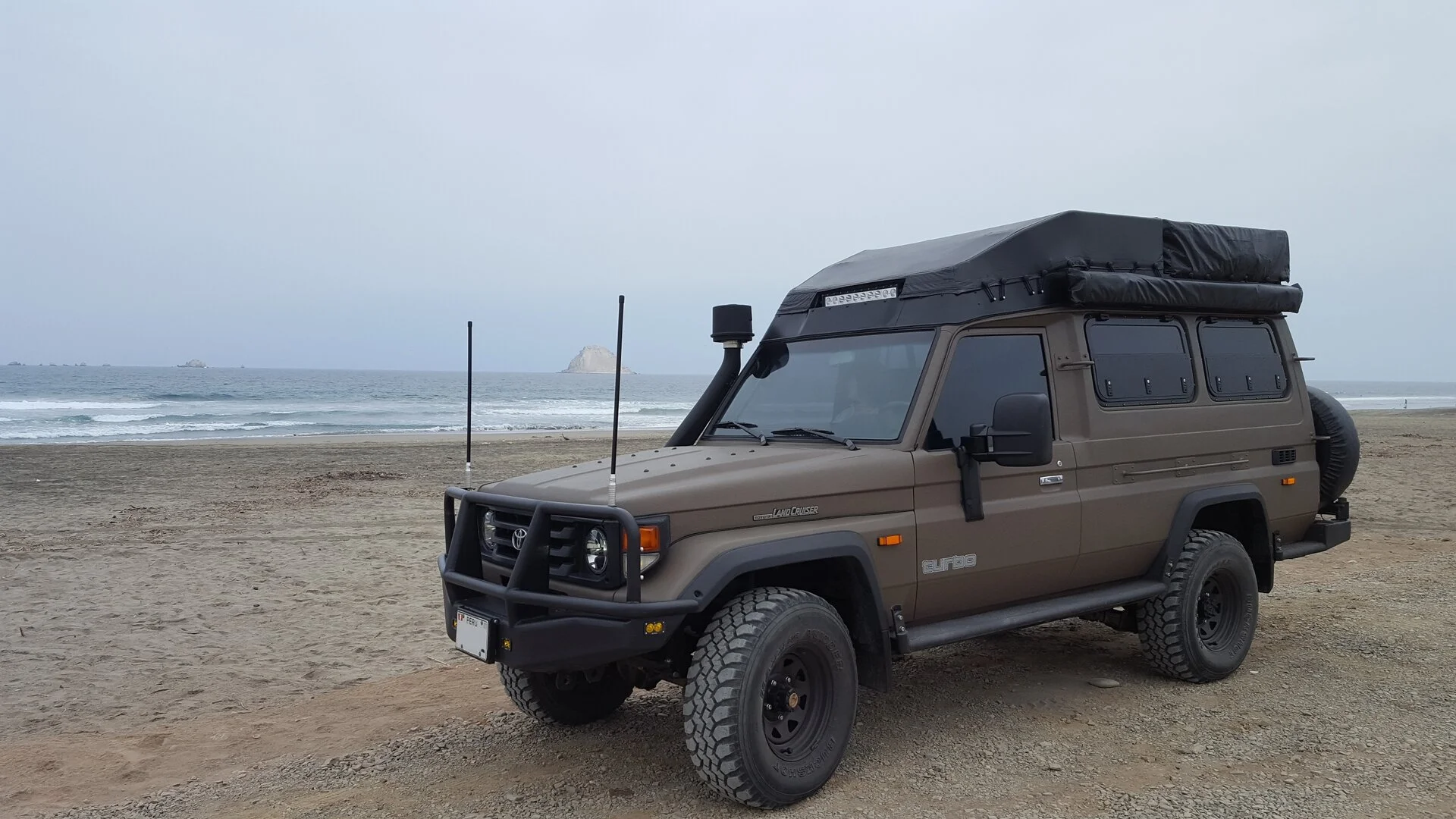

1 water, 1 shorepowerI see that you have 4 tank ports , 2 for fuel , and 2 for water ?
my attempt at streamlining the water/dust proof roof rack storage to keep the fuel down as much as possible on the highwayWOW , looks like a pop up roof , but it isn't !
