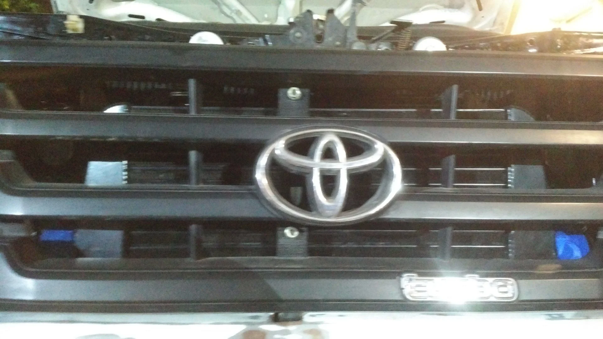

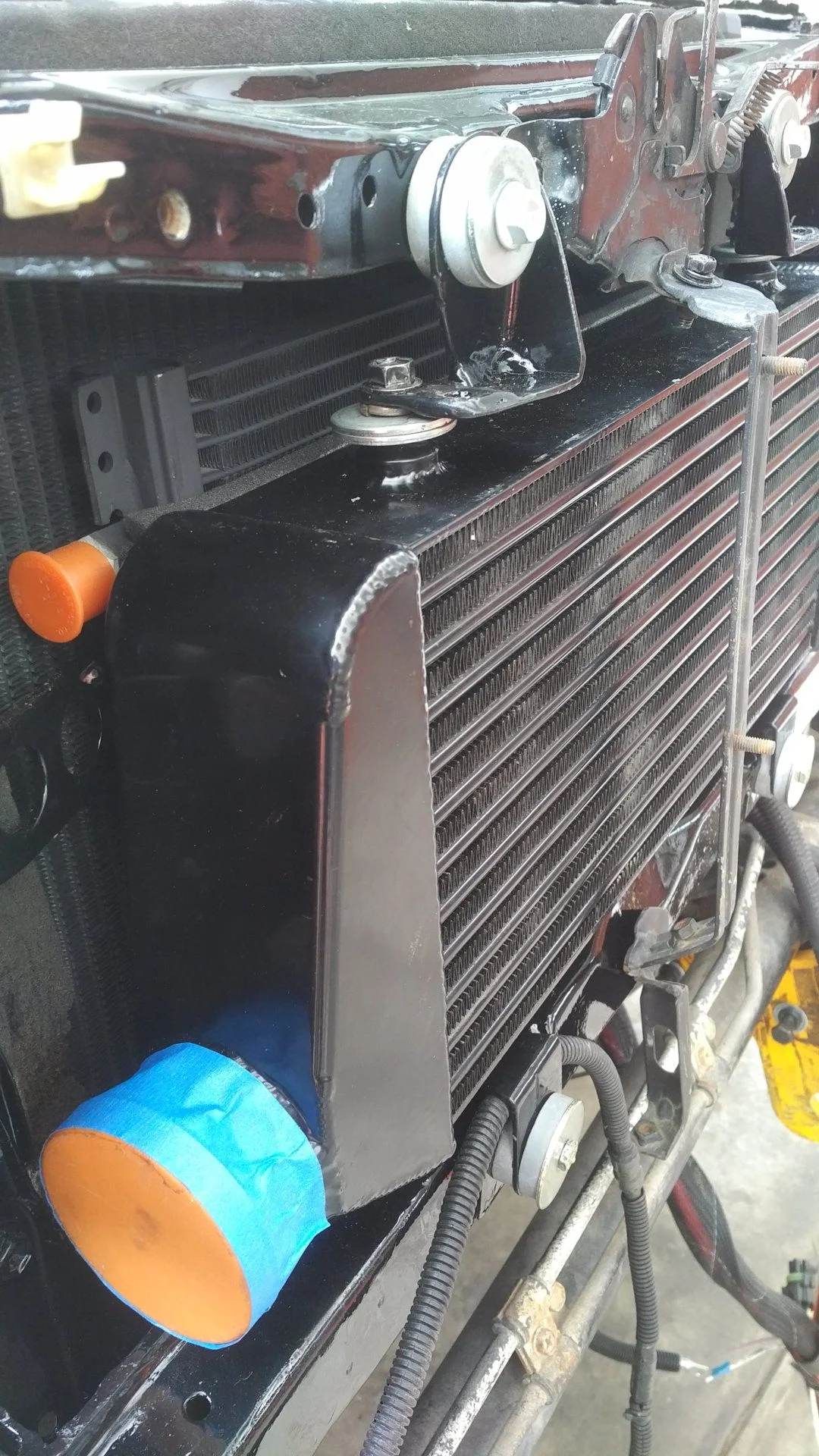

Being a bit slack with the thread... but things are still crawling along.
Perfected the mounting and finally fitted my latest (third) aftermarket AC condenser and FMIC, painted everything black as well so none of the white is visible through the grille or gaps in front. Just have to paint the big washers.
Still have room for a fan should the need ever arise, but I hope that will never be necessary
I had a turbo diesel with a large front mount I/C, we installed a pusher fan in front of it for slow off-roading. It worked excellent.
Cheers
thanks, good to know... I thought i'd seen some super low profile ones, but I've never really looked into it. So i don't have room after all it seems
You probably don’t need it.
The truck I put it in was a rock crawler so lots of very slow off-roading.
Cheers
