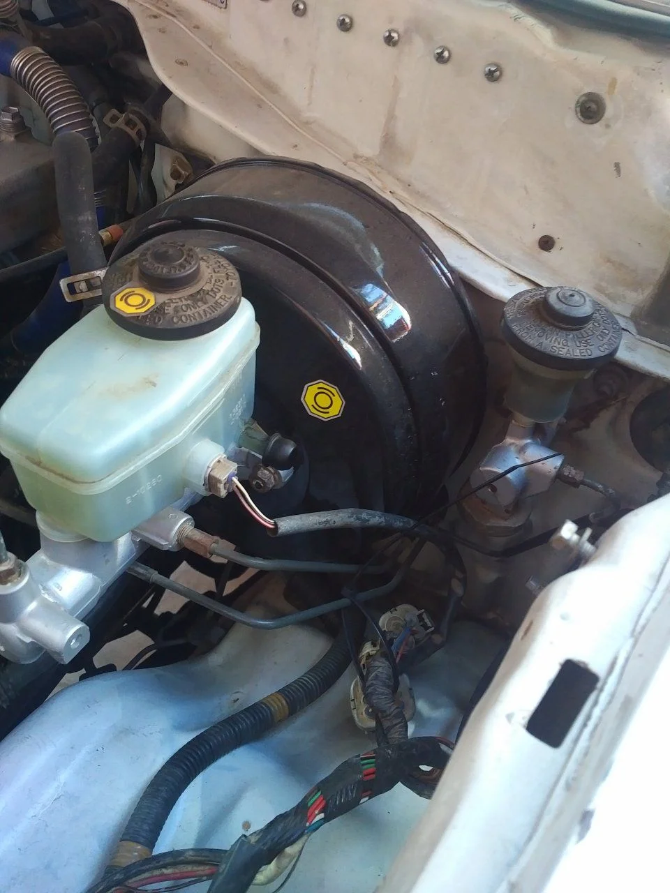

Today decided tot attack the brake booster, so i removed all the clutter in the vicinity.

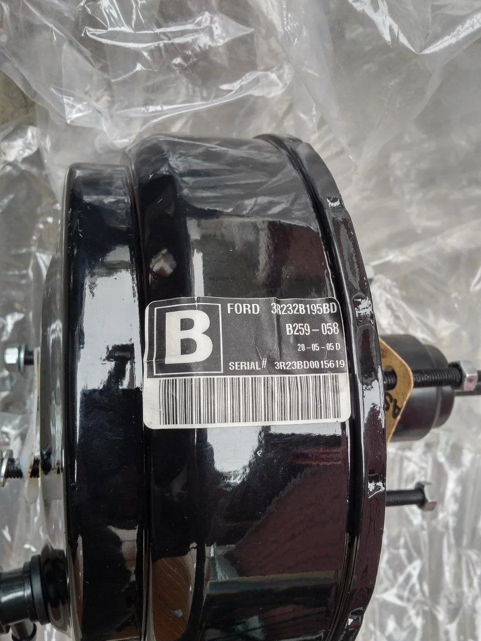

I just thought I should snap a photo for posterity, the guys at Mako really took my petition seriously to make this manipulated second hand part look like a new one (to pass customs). Really appreciative of what they did to get it to me at no extra cost.

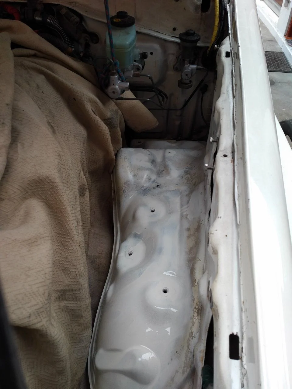

started cleaning up a few minor surface rust patches around the booster mount and decided to take to the whole side and cure the surface rust under the battery from battery spillage by the PO

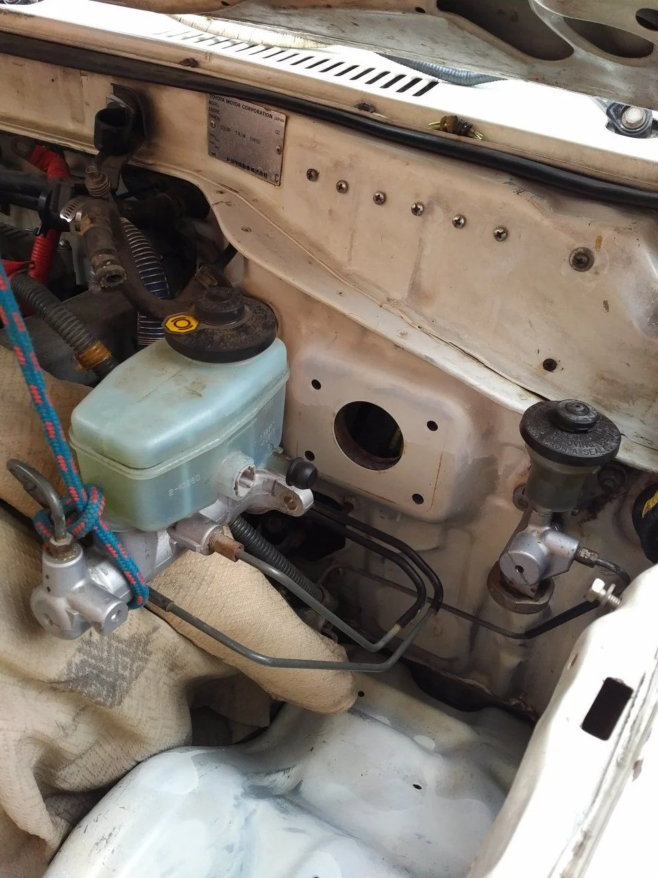

waiting for paint to dry, so will install tomorrow. dead easy to remove, just have to loosen off the brake lines as far as you can so you have the movement to take out the booster.

I miss something here .. that's a Ford brake booster which it's a bolt on replacement for ours ? ( 70 series booster ? )
the ford sticker was just a trick to get it past customs, its illegal to import used or refurbished car parts in Peru, so i had them paint it and put some makeup on it to pass as a new part
I'm not actually sure what type of booster it was originally. Usually mako take your existing single diaphragm booster and do surgery on it to turn it into a double diaphragm, or possibly just adapt the mounting bolts on an existing double diaphagm that will fit the master cylinder, such that it then bolts straight on again. Me being in Peru and them in Australia made delivering my booster difficult, so i told them what i had and they made me one up, presumably from a used part.

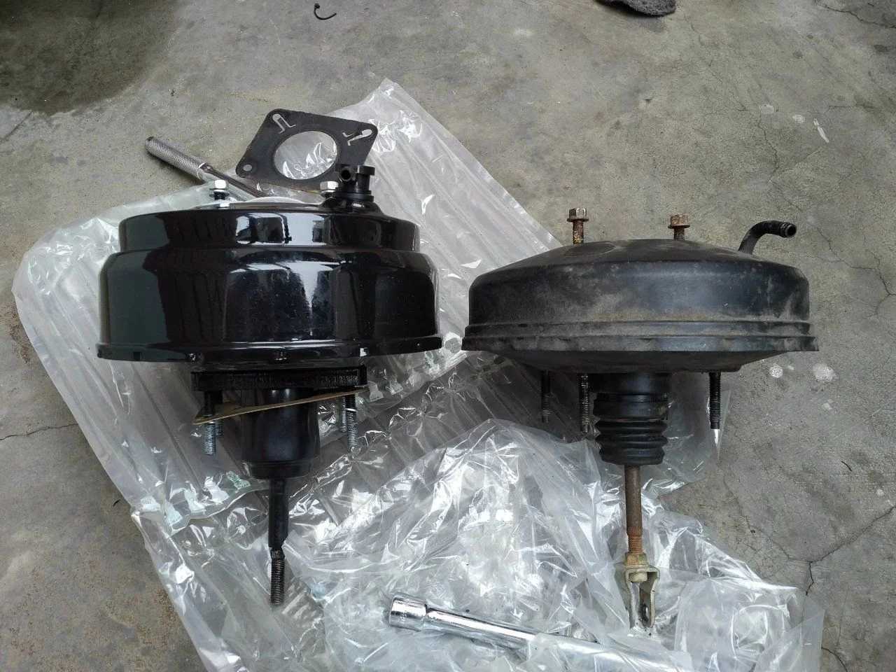

What i discovered today is that the 4 rear bolts didn't line up correctly, and i had to drill out the M8 holes to 12mm to accomodate the slightly different bolt pattern... wasn't happy about that, but its now snug at least.
Hard to know if this is a Toyota booster converted to double diaphragm with part of a PBR booster, or if this unit is just a PBR double diaphragm booster from some other model and they put an adapter plate on the back to roughly match my mounting point, very roughly it seems or they misjudged what i had. I thought I was getting the former, but give the mounts had to be modified I'm not sure, but will find out soon.
Either way PBR is an australia performance brake company, so it should be alright... was going to fit it today, but waiting for paint to dry again after drilling the bigger holes

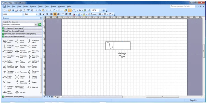

My dilemna is what software i should use to record it, as i want to end up with something similar to the factory EWDs for reference when I'm diagnosing/repairing years from now and have forgotten or am under the influence. I currently use excel for circuit planning, but that doesn't help me physically locate anything once it's installed. So far I have downloaded PC|Schematic and EDraw Max, the former looks awesome and might be able to manage the free licence with limitations, but it is a proper electrical engineers tool so I'm not sure whether I have time or the resolve to learn it essentially for a single job, although after a play with both, seems like learning it will be quicker in the long run. Some will say I am crazy, but it will become a mobile home and I literally have hundreds of additional fuses in the system.
I have the install side partly covered, i now have rolls of 15 wire colours in 14AWG and six colours in 10 & 12AWG, and bought a ton of 2, 3, 4, 6, 8 and 12 pin deutsch plugs. Labeling relays and fuse boxes will be easy, but not sure if i will bother labelling the wires if I'm using individually coloured wires, deutsch plugs on everything and diagram software to record it all.

AutoCAD is a good choice. So is Microsoft Visio. The latter is pretty much drag-and-drop, no steep learning curve; with some tweaking you can end up with an FSM-like drawing.

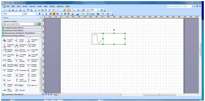

Thanks Juan, i have and use visio for org charts, yeah a bit too basic and time-consuming for my complex system, but I'll look into AutoCad, as that's something I've always been exposed to but never used, always just got by viewing withva dwg viewer, and i was thinking about exploring it a bit for my drone mapping work.
But can you tell me if it does more than just 'draw' electrical symbols and lines? For example, in the first one i mentioned, if you insert a relay, the symbol has a properties box where you identify the power source, device etc, from a list of those you have already inserted, so the lines are created and adjusted automatically... That's the sort of assistance I'm looking for, as it honestly daunts me when I look at just how many circuits i have, I mean my auxiliary loom will be larger the factory loom, and the factory loom is already ten A3 diagram pages in the EWD, so i think if i had to manually draw i wouldn't do it and would just label the cables and hope my memory outlasts the vehicle!
Hello,
Yes, Visio is rather simple when compared to AutoCAD. Yet you can drag and drop a symbol and then double click on it. A small text box opens. You can then enter details.
This example uses a relay.
After you drag and drop you get this:
Then you double click on the shape and a textbox opens. The zoom is a bit exaggerated to see it.
Then you type, for instance, Voltage and Type.
The font size is some 6 points by default. You must select the text and change it to 12 points or more to make it readable.
Right click the shape and you can change more details.

so i put the new double diaphragm brake booster in.... OH MY GOD. I think you may have heard this comment form others that have done this to 70's, but all i can say is the same... what an incredible difference. she stops on a dime, and i can lock up the big wheels. probably now the best mod I've done. you gotta wonder why they didn't put those 80 boosters in the 70s when they could have.
she sticks out quite a bit further, both from the extra booster size and the large spacer mine came with at the back of the unit against the firewall, but still have clearance on all the brake lines without needing any modification whatsoever, and will be nicer for running cables back there, previously i had to run cables over the top as there wasn't room behind for extra looms.
