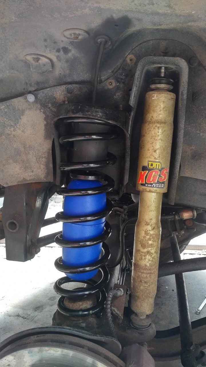

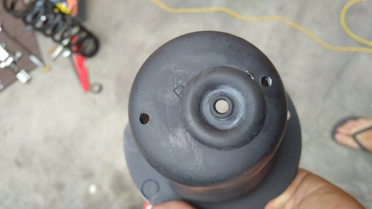

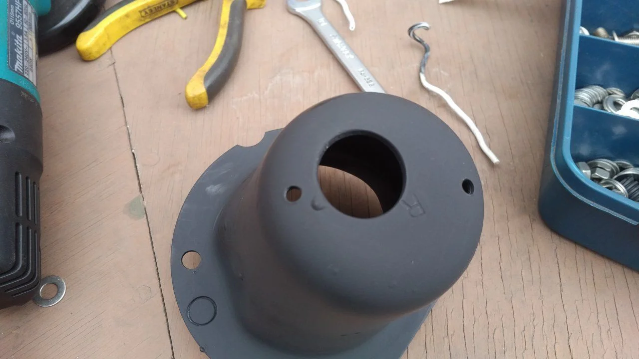

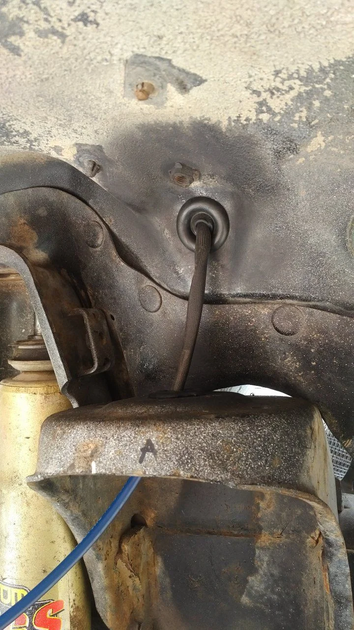

Front coil airbag install.

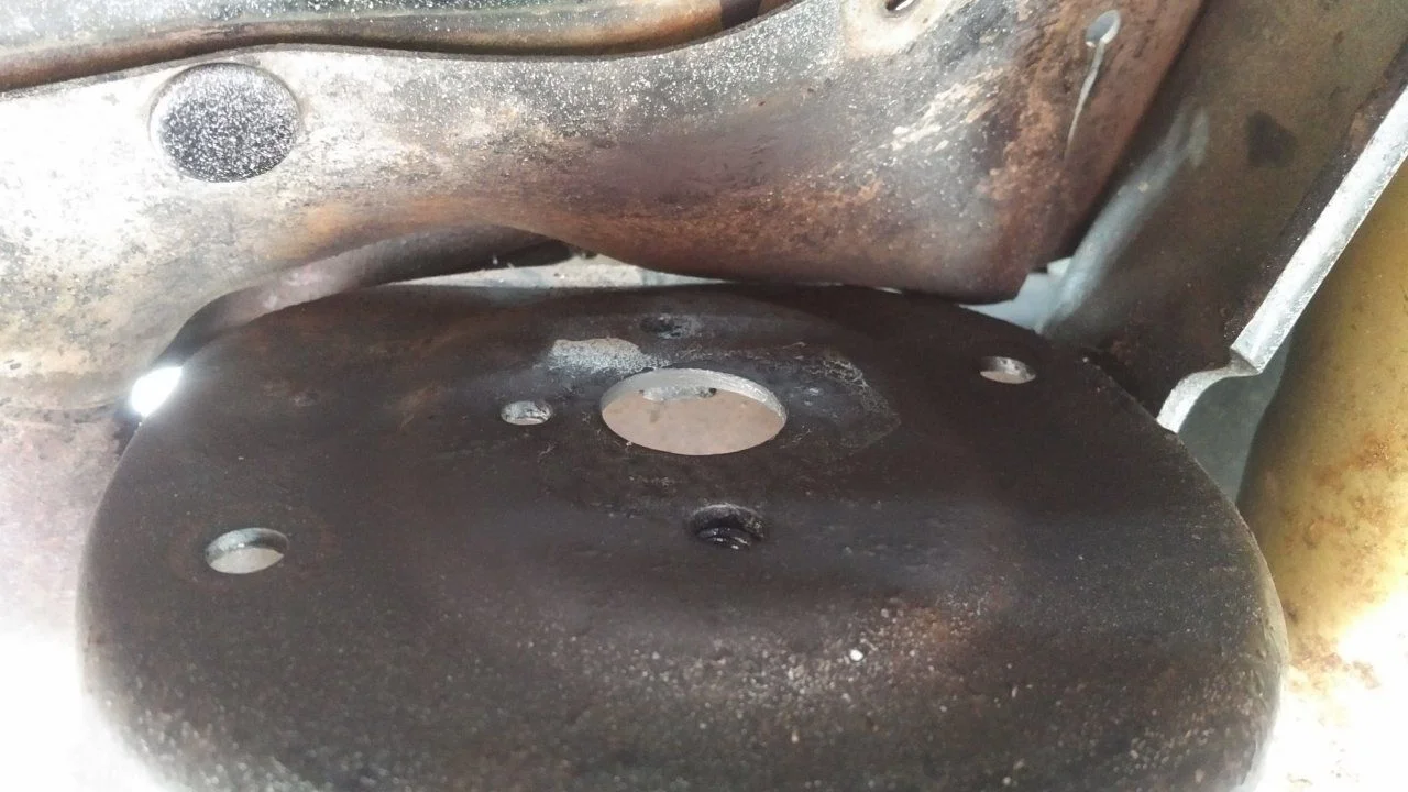

Pretty simple, cut a few 1" holes
One in the skirt
One in the spring support
And one in the cone

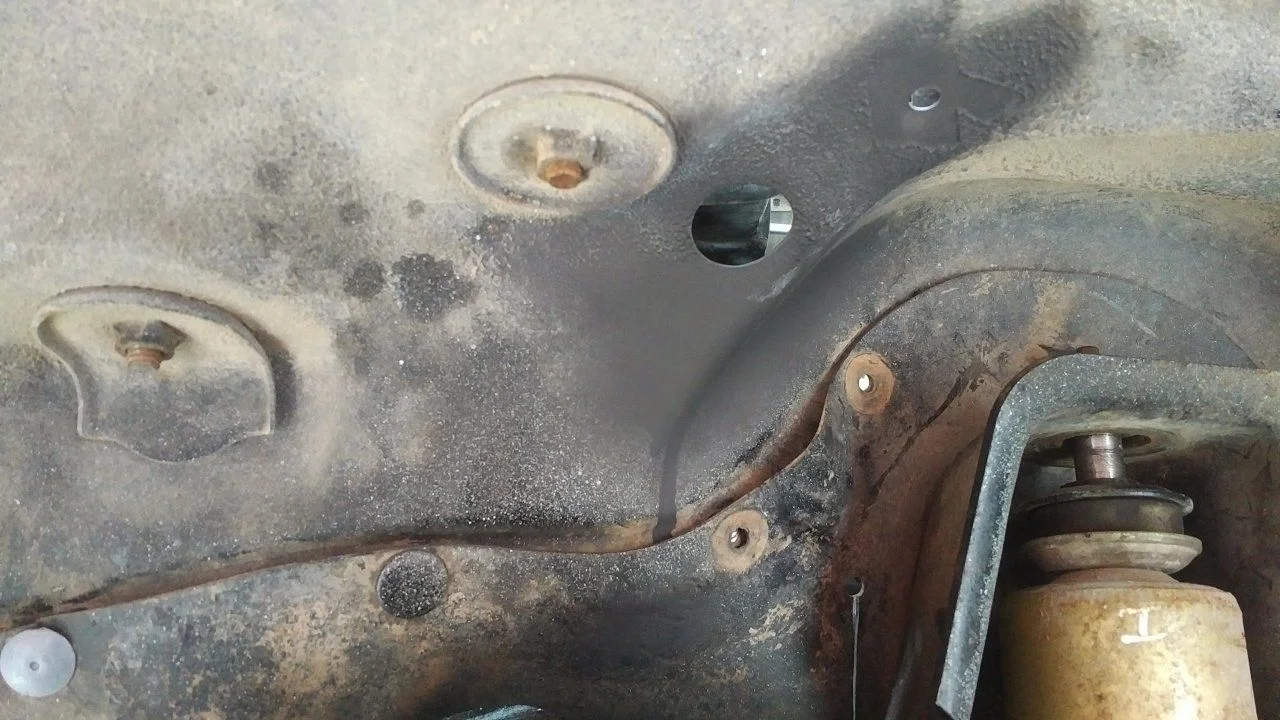

The original cup and rubber are offset, and held in place with a bolt as the cone base also isn't perfectly aligned with the bottom spring mount, but I'm assuming (hoping) the airbag will always rest in the same offset position and not cut the airline. I wasn't comfortable with that at first, and did a lot of pondering, but I added the large grommets and am hoping for the best. The supplier later said it will hold its position so I guess it will be fine.
Grommets in place
Installed before lowering the body

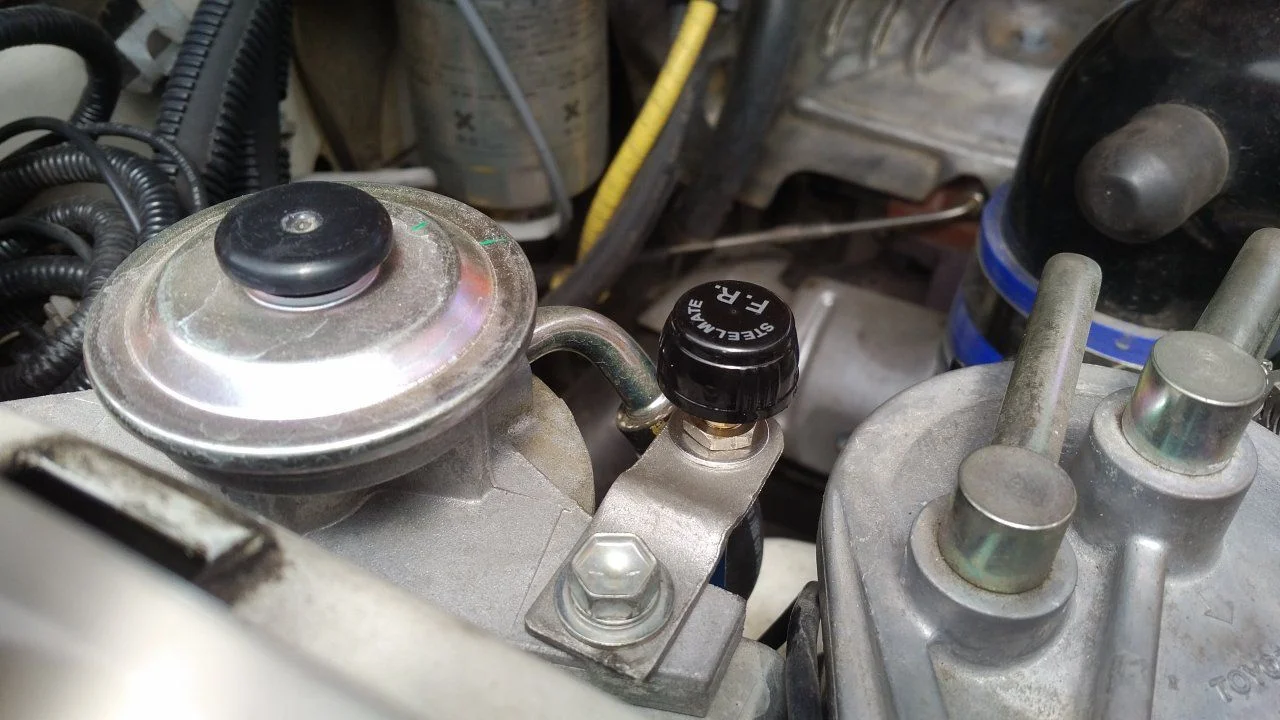

Opted for four separate and simple filler valves, simple and reliable and as short as possible

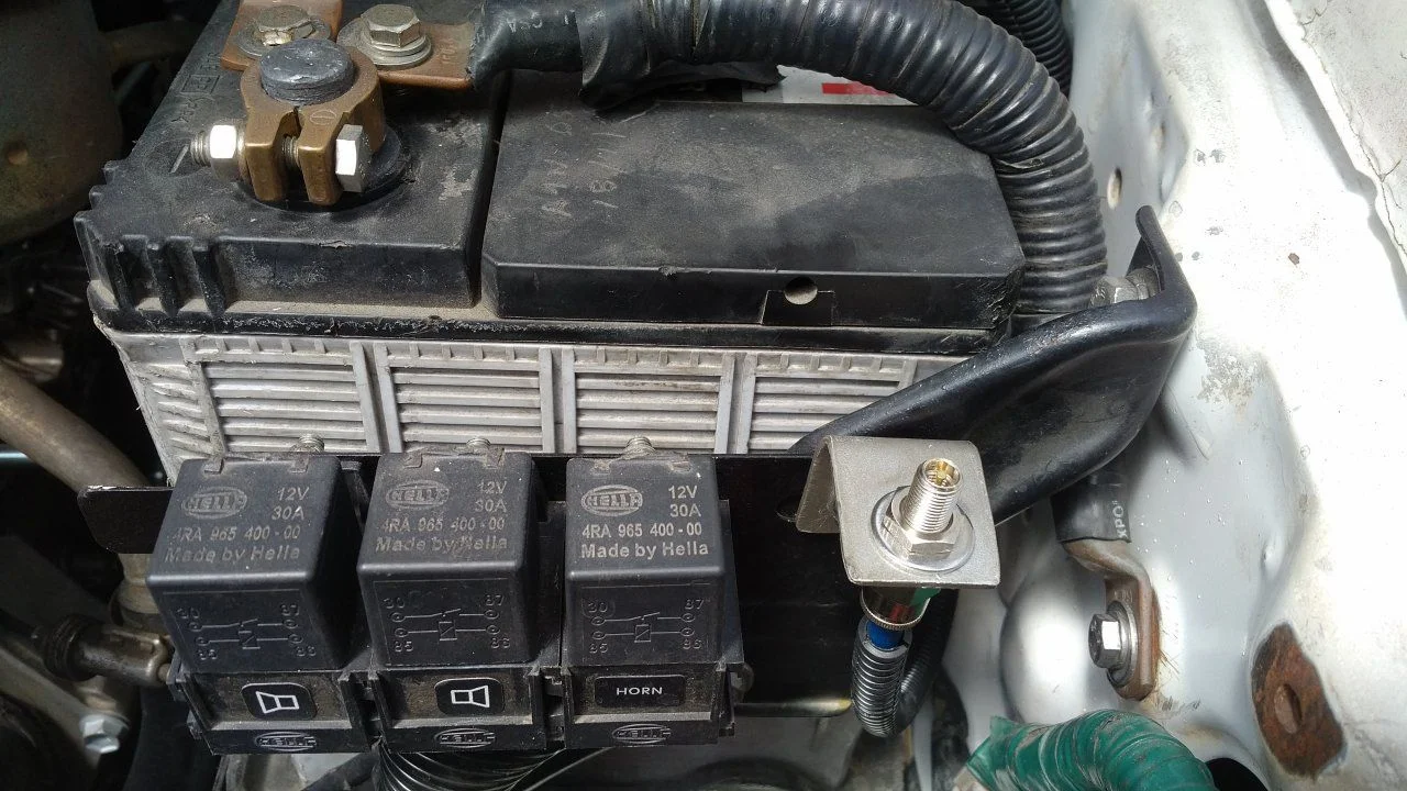

One near battery
On the right side found a spot between prefilter and first filter. I'm using a simple wireless tyre pressure monitoring system on each valve to keep an eye on the pressure in case a line gets cut.
I really don't like the blue colour, no colour options unfortunately, but thanks to the cone the airbag sits below the wheel height and isn't visible usually... I would paint them black (like my Tonka truck yellow springs) but apart from wearing off and looking worse, you never know if a chemical coating would degrade the material, so blue it is
Just waiting for a bit of free time later this week to install the rear bags

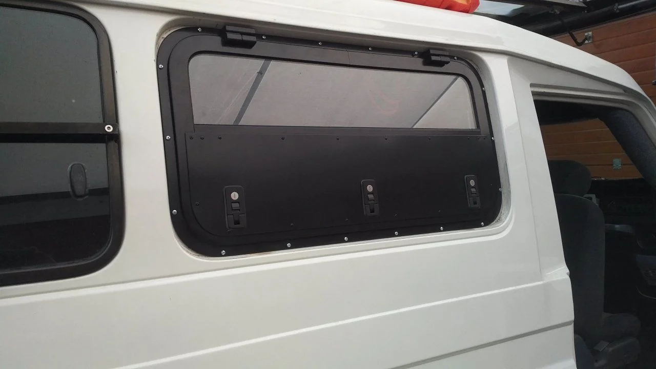

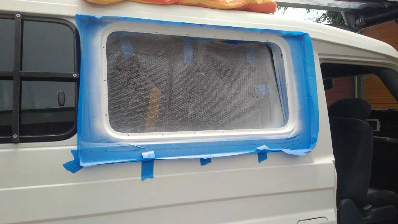

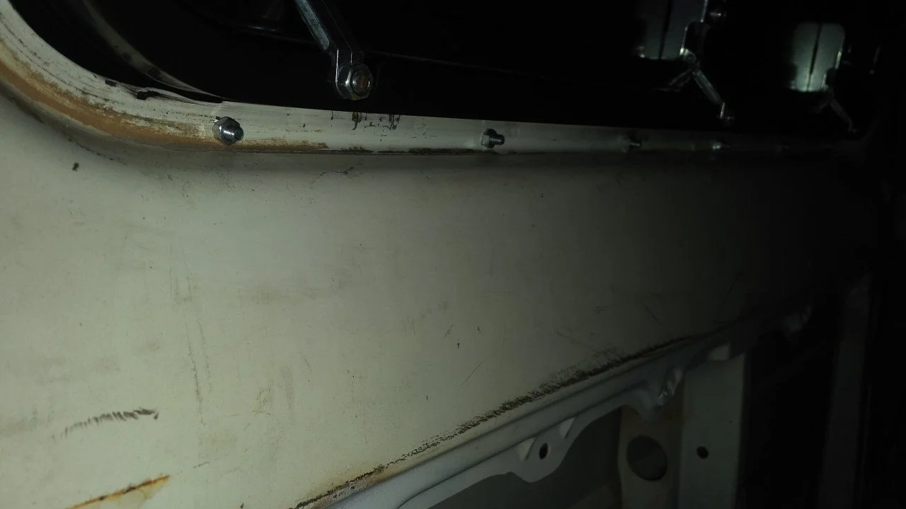

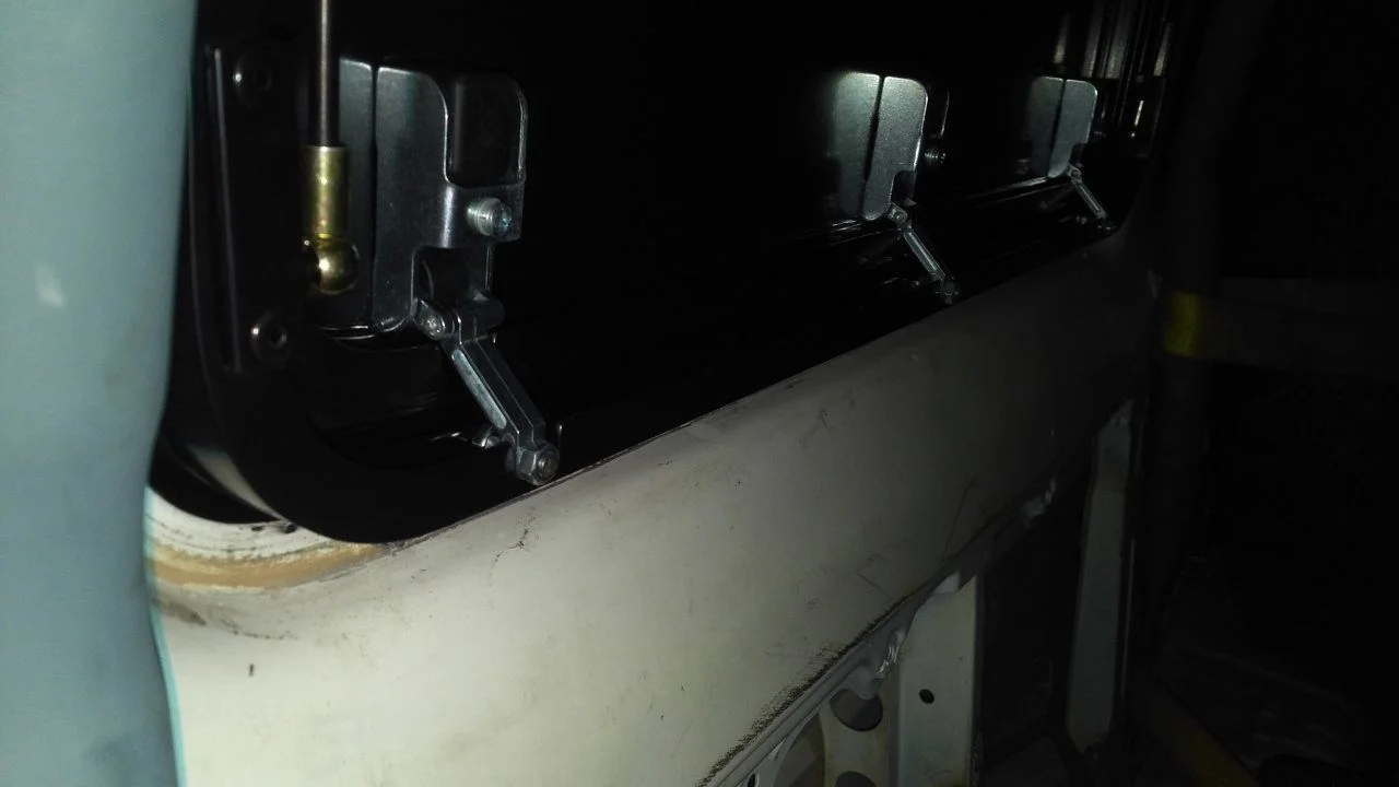

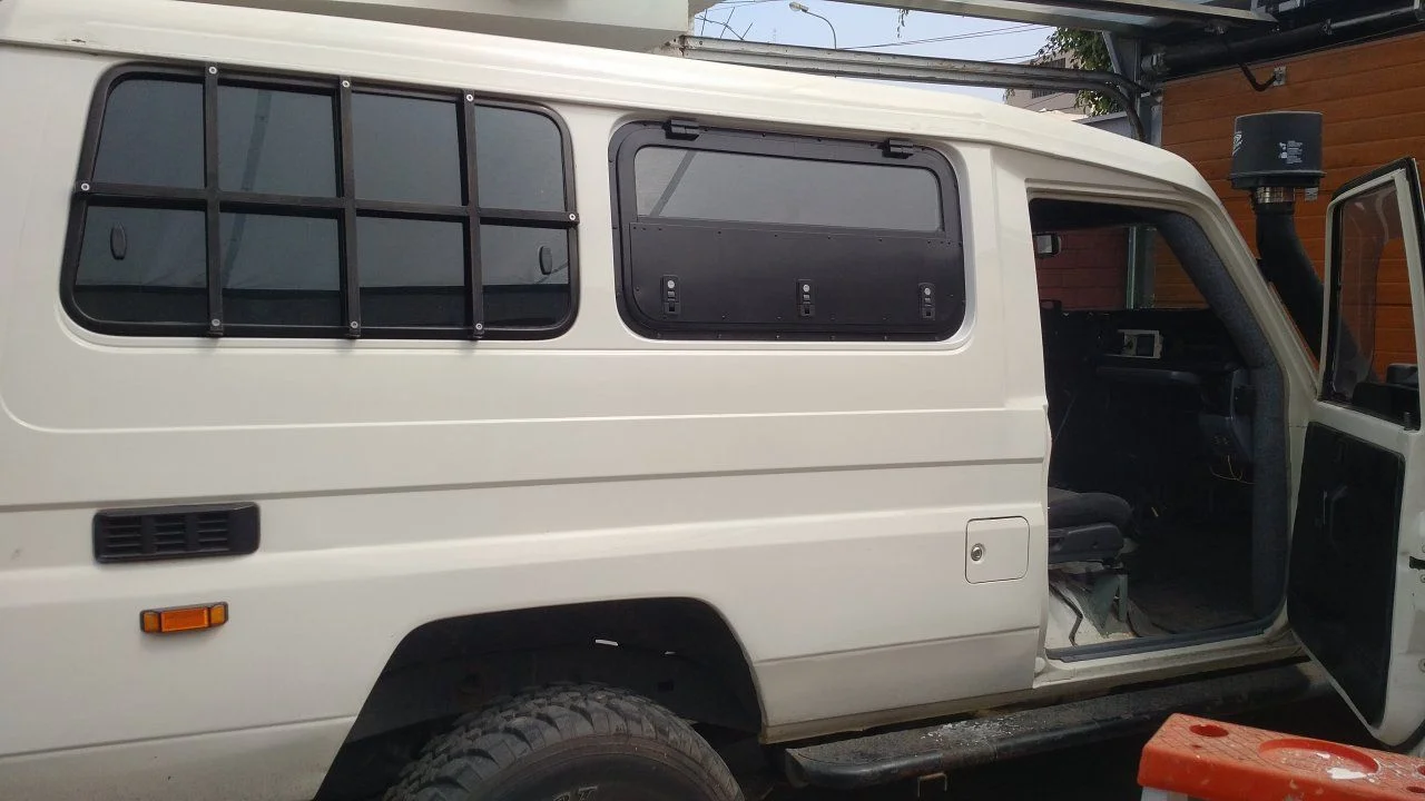

One measured up and ready to fit. As I'm going to strip and paint later on, I'm removing all the goo and I'll just install them with foam backing for now... three more to go. I'm thinking a bit of black liquid electrical tape over the screws will be in order.
Also, just a bit of advice for anyone considering these... its chau to the interior trim around the windows, not possible to fit it either beforehand or afterwards. It makes no difference to me as my interior is getting the carpeted camper finish which will cover the bolt holes and I'll have furniture right up to the intruding frame, but I can imagine their not for anyone wanting a classic stock or even just a neat finish... these photos isn't the finished product, was just checking the alignment of the bolt holes, but you can see how much they intrude inside and how the tight fit cancels out the possibility of using trim.
The other thing to consider if installing the gullwings is that you might need to cut and polish or paint the recess that has never seen the light of day since the factory, especially if it's been resprayed. Just as they intrude in the interior, they are no longer flush with the body. These were designed for tradesman, not purists.
One down, three to go
Should mention that they are custom, normally have full glass and only 2 horizontal latches. The normal ones do look a lot better I think, but that wasn't in my criteria
