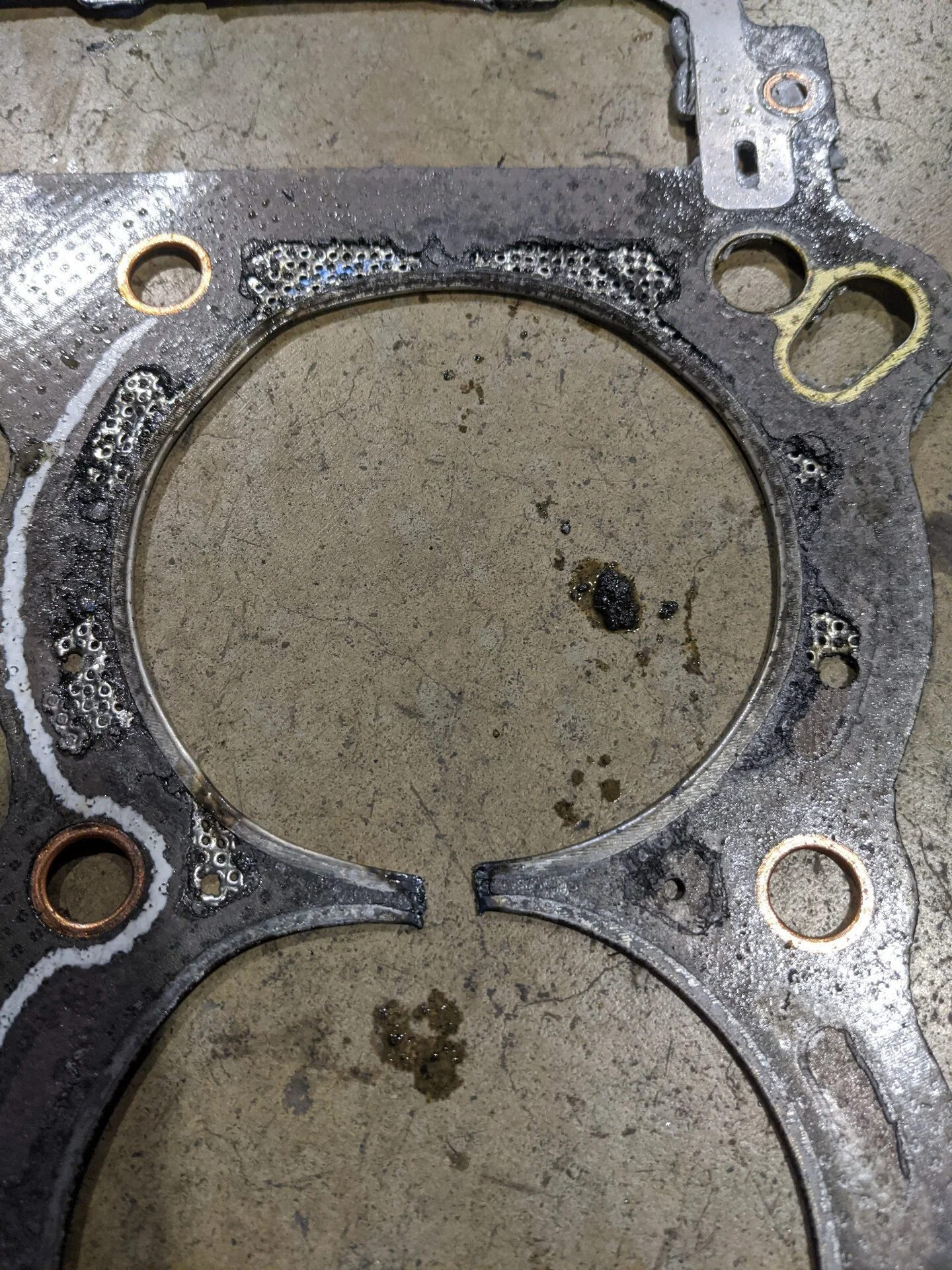

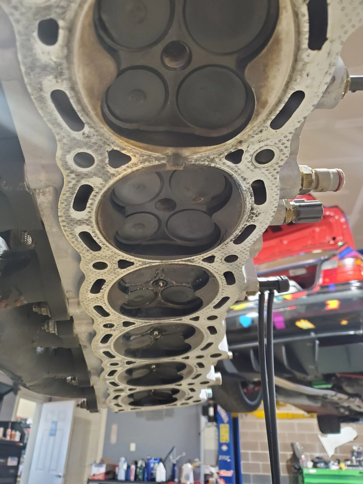

It murdered a headgasket walking up to ~13psi of boost on the dyno, so that's all you get for now. Multi-layer steel Cometic going in tomorrow...

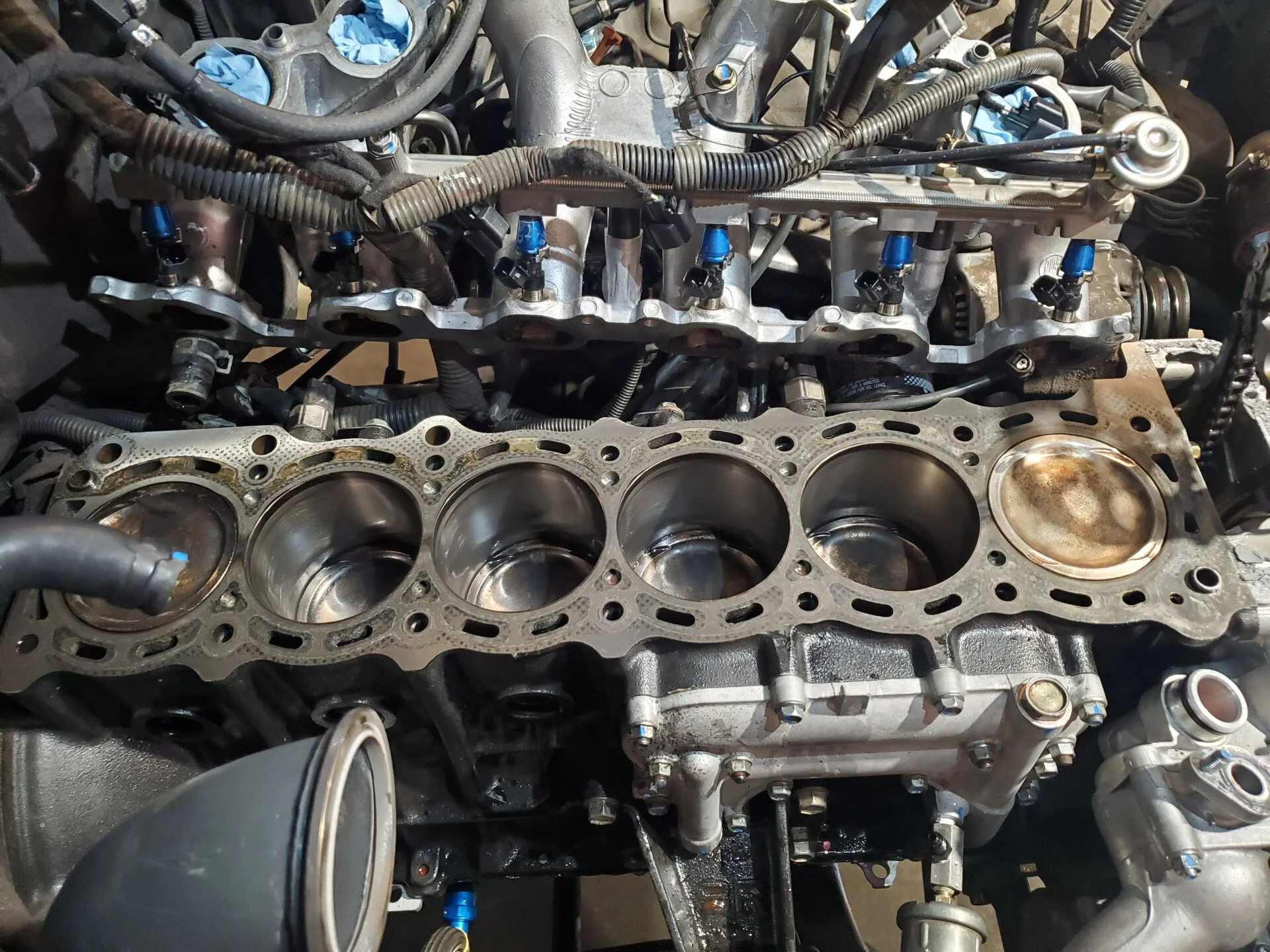

The block pic looks like you nuked 1 to 2 AND 4 to 5 to 6?!?
1-2 was gone; fully gapped. 5-6 was going. 4 thought it might be fun someday...
pics like that make me glad i preemptively got rid of my HG before the turbo.
