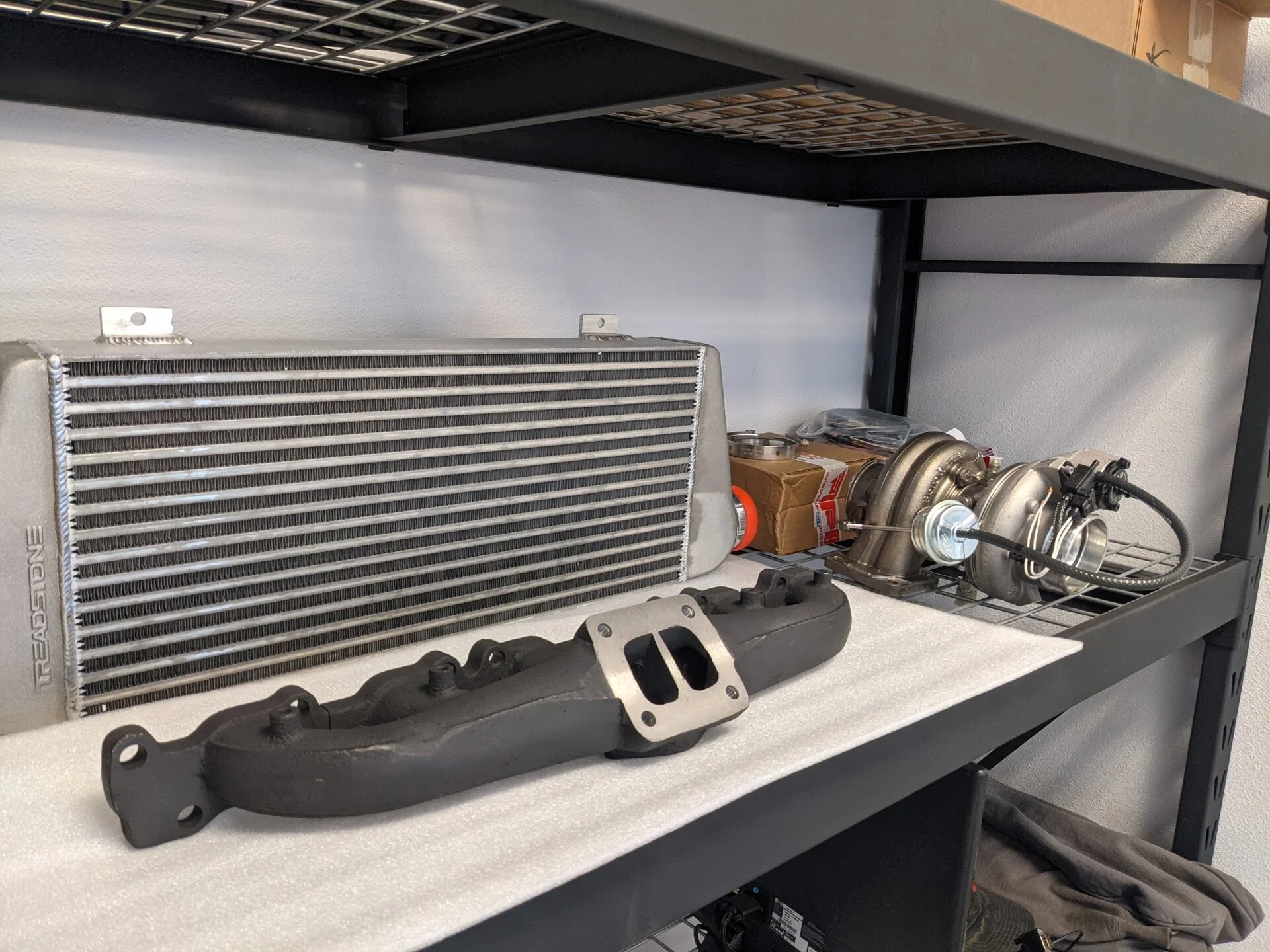

Early test run @ 6-8psi...
Close to 300hp @ wheels.
Fuel pressure is resolved, so we're increasing boost at higher RPM (maybe 12psi).
What are the specifics on the manifold?
Sorry you will sell.
I don't have the exhaust part #; but it's a 6:1 dumping direct to turbo, versus the factory 6:2:1 split header. Intake is OEM.
