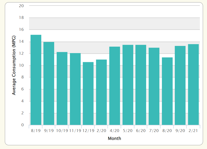

Here is a graph showing mpg with a supercharger. Average 12-13mpg. Some of the lows you see are from towing.
I was running 33" tires with upgraded front and rear bumpers and a subtank.
