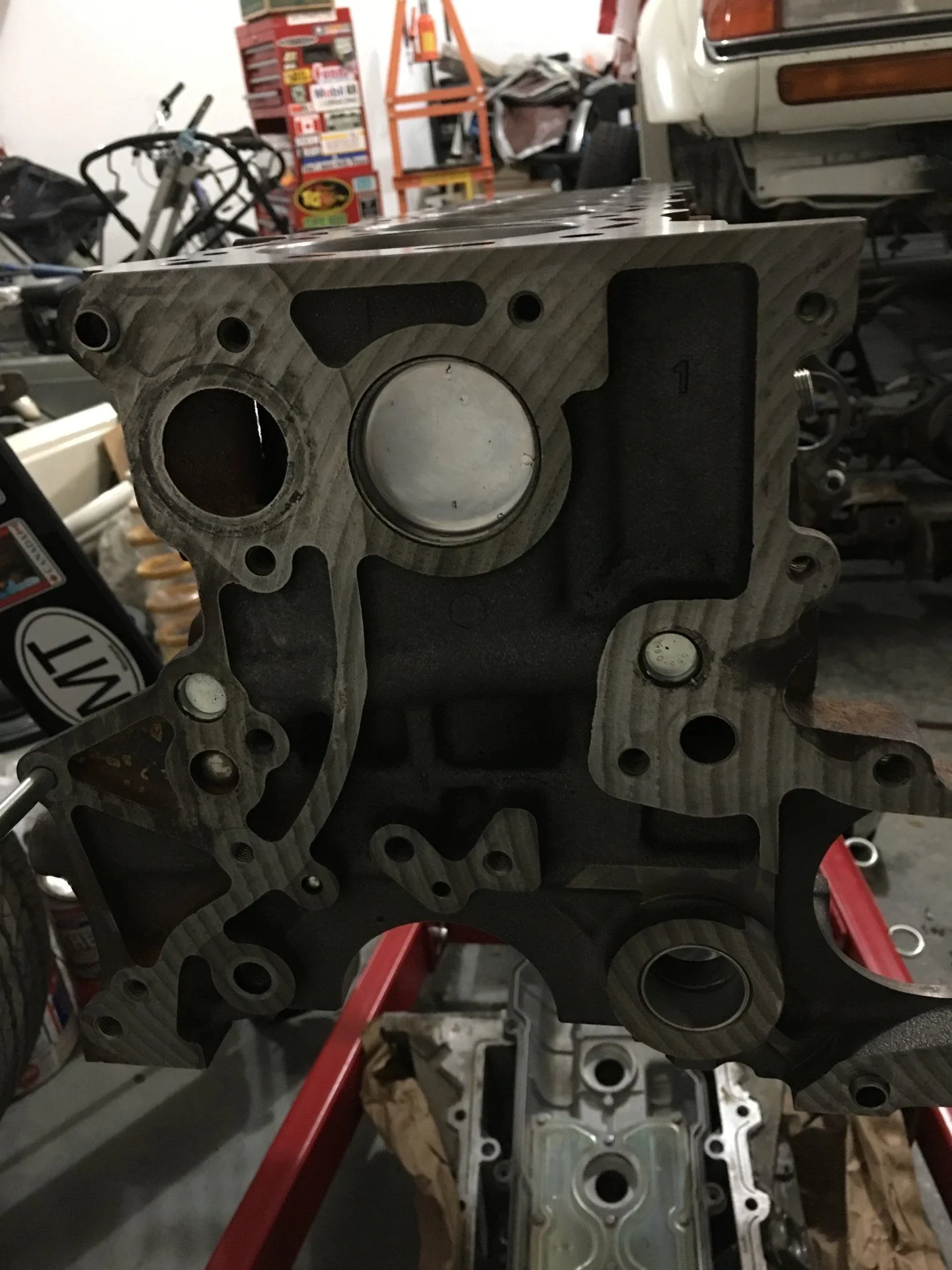

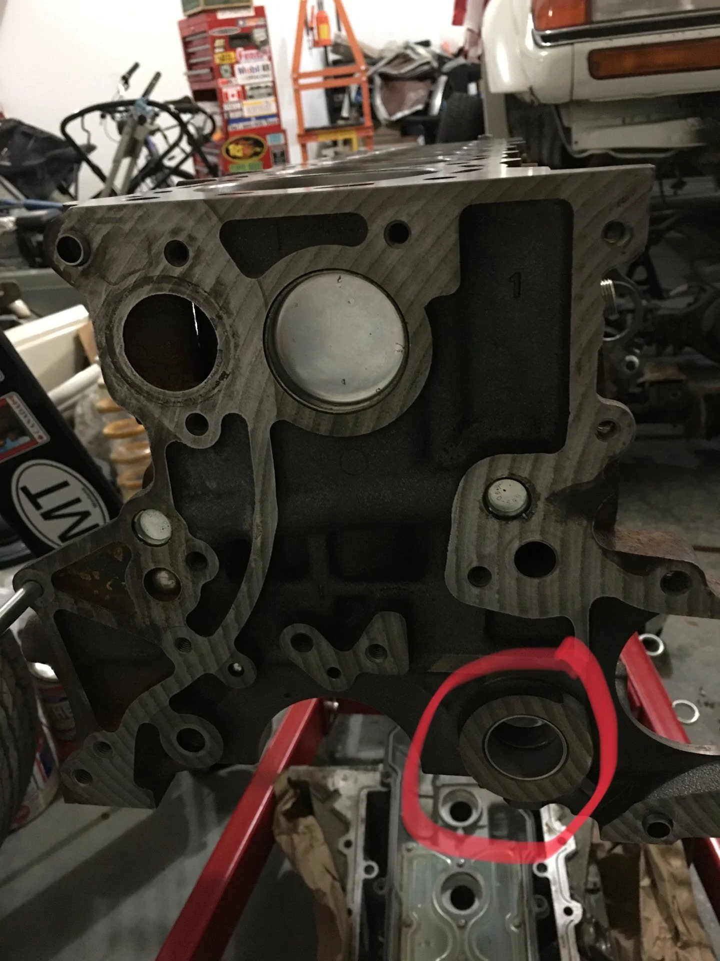

/////::Cliff note:: -- what's the beef with hot tanked blocks as it applies to the brass bushing?/////
So there are a few methods for cleaning IRON blocks. Aluminum is a different animal altogether since heating it would cause it to anneal and chemicals could etch it.
For IRON blocks you have the caustic chemical bath/agitator, acid hot tank and the oven. The oven is what we used because it reduced the chemicals used and then the wash time and rust after. Hot tanking, which we also did before we got an oven, was the typical method for cleaning out blocks and iron heads because it worked awesome. The problem with hot tanking is it destroys the brass oil pump bushing. The oven isn't ideal for the bushing either because of the heat it's cooked at softens the brass.
The problem is the shop needs to know this ahead of time or else they may accidentally cook or hot tank the block with the bushing inside. If this happens you CAN get another from Toyota, but good news, it comes with a free short block.

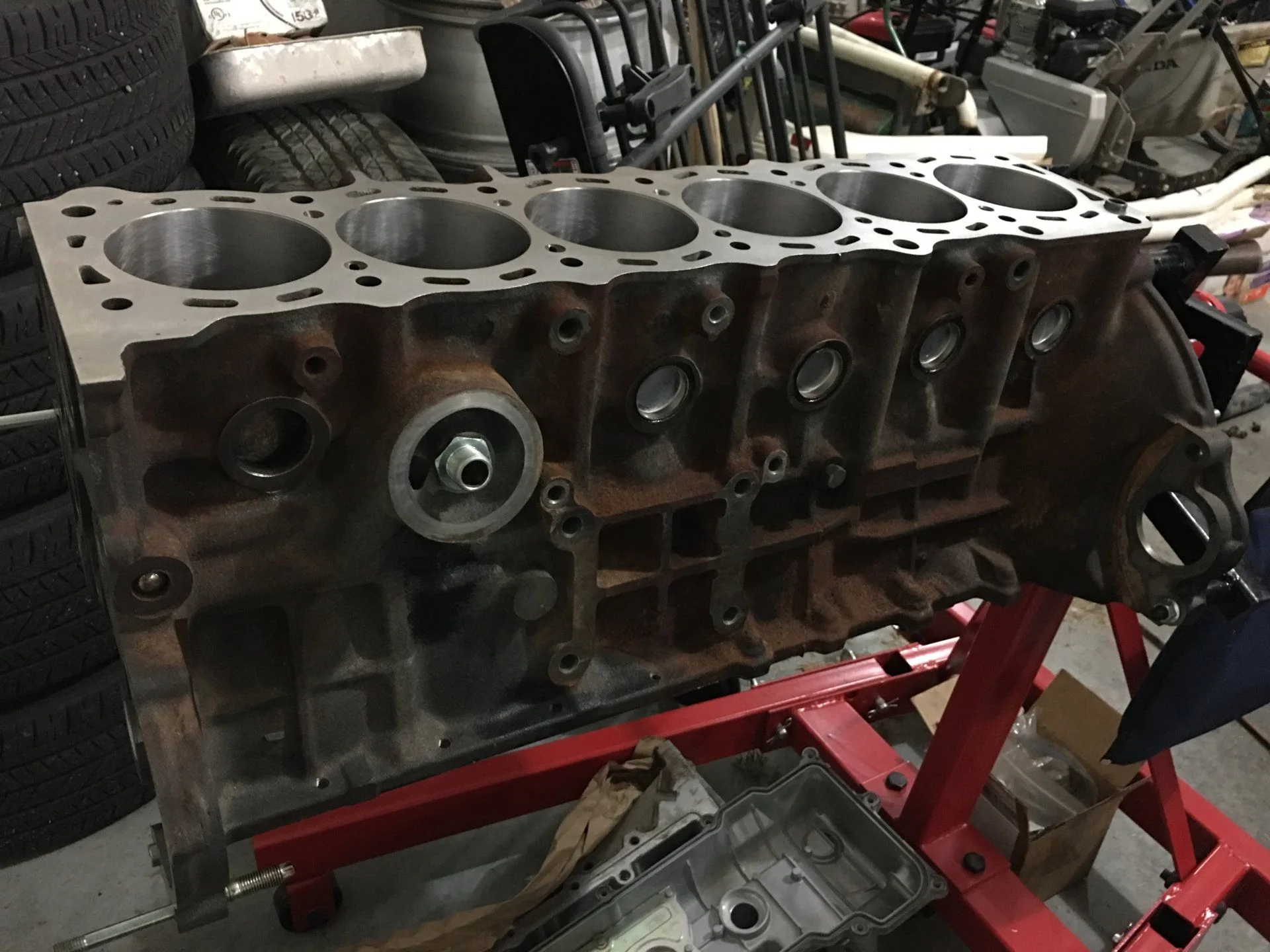

I've never seen those over the years at the machine shop. Their bread and butter is Subaru aluminum heads. He explained the dishwasher as a non caustic cleaner. My block has already been through it and it didn't do anything to the brass bushing. This is the final clean with the oil galleys being brushed.
Yeah that's for aluminum. It won't hurt the bushing.

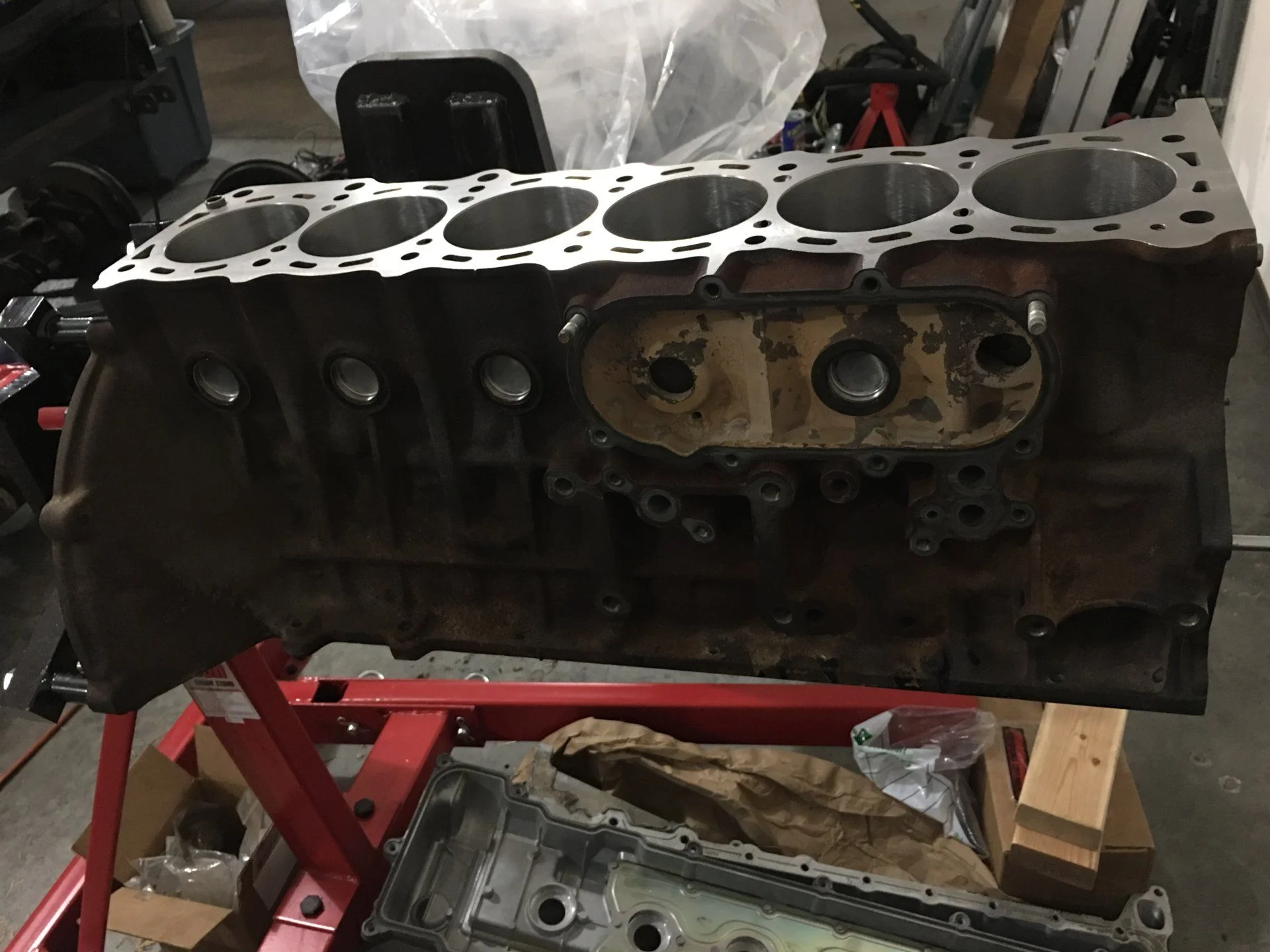

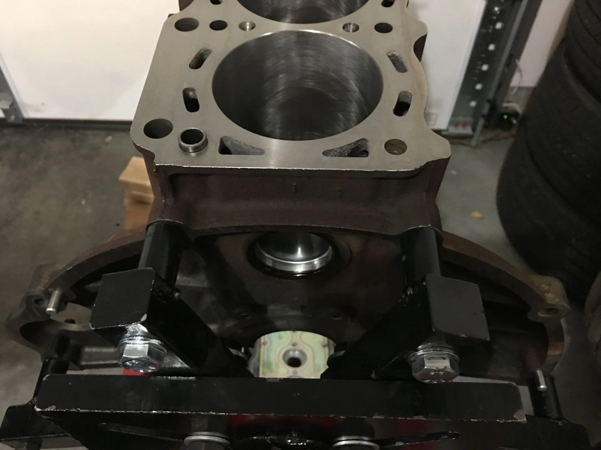

I just realized that I never posted that the block was finished in September and is on my stand.

It’s in spec and fine according to the machine shop. It wasn’t cleaned with any caustic cleaners.
