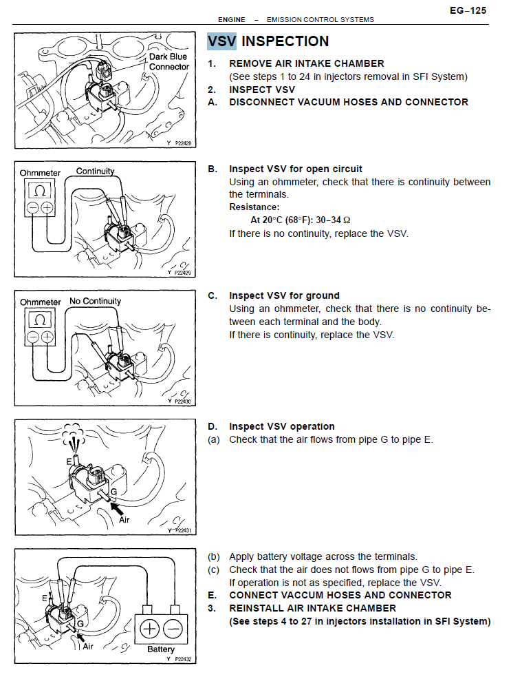

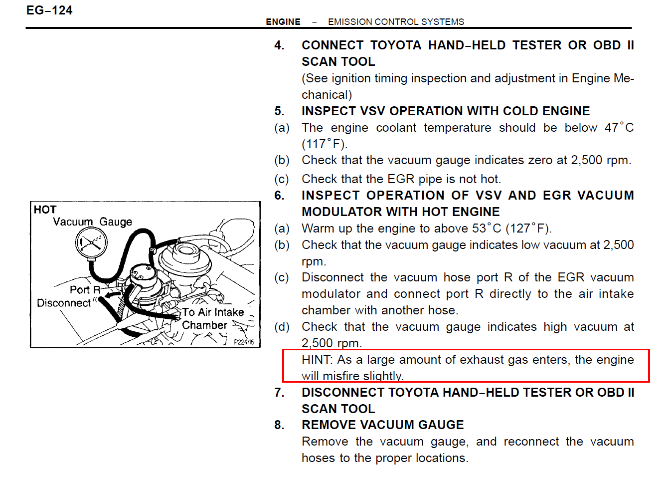

Finally, you mentioned that you think there might be a VSV fault (I assume you mean the emissions VSV, there's more than one). What makes you think that? FWIW:
Here's another VSV (for fuel pressure)
There's also one for the EVAP, but I doubt that's causing your misfire/rough idling.

Yes, the VSV from the intake manifold "fuel valve" to the fuel regulator. I took some extra vacuum line and ran directly from the manifold to the fuel regulator. It ran a little more smoothly but still had slight misfire.
My EGR system has been deleted so there won't be the exhaust gas issue. Also there are and have been no EGR related codes. I had a shop the specializes in Landcruisers do the engine rebuild and EGR delete.

View attachment 3453047if I can get to it I'll check this too.
