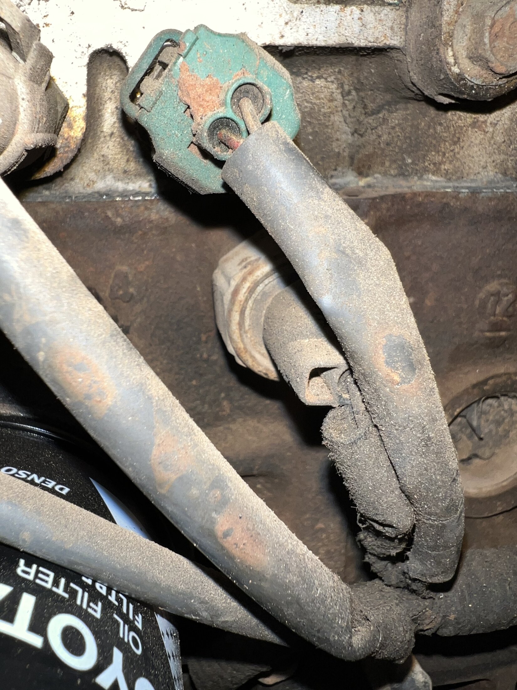

Has the coolant temperature sensor fix held up? I have been chasing something similar in my new to me 1995 FZJ80 (1FZFE). Identical clicking noise as your video, and more importantly inconsistent firing upon startup.
I went and inspected the sensor on my truck and noticed that the connector clip was cracked. Barely applied pressure with fingers and the connector came off and retaining clip portion disintegrated.
I reconnected it (pushed it back on, knowing it is now not properly attached) and for giggles turned the key to ACC and plugged in my scan gauge. The coolant temperature on the scan gauge was showing over 90 F, even tho the truck had not been driven today and last started about 8 hrs ago just to move in the driveway. Ambient is about 70 F today.
Obviously I need a new connector, but curious if this fix for you has held up with the sensor replacement. After reading some more in the FSM, and seeing the false high coolant temperature reading on the scan gauge leads me to believe this sensor is telling the ECU the engine is hot (or hotter than it truly is), and the VSV is working as it should to send exhaust/ more fuel to avoid vapor locking, resulting in my stumbling initial firing. Sounds a lot like it is being flooded on its first fire which would explain this.
