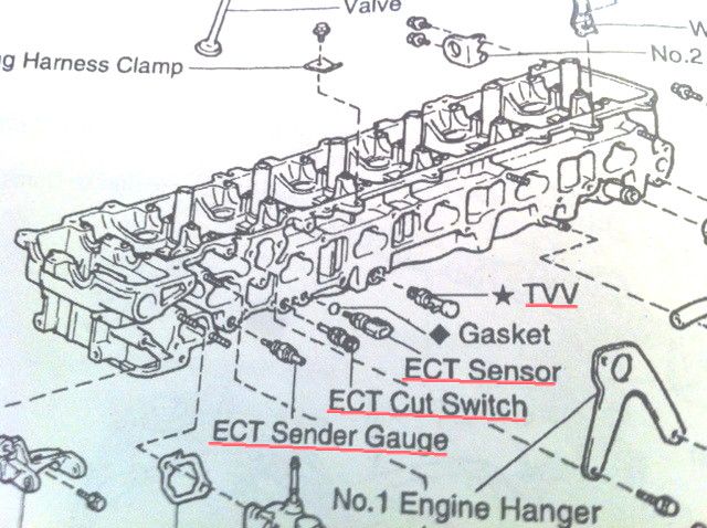

I am stuck trying to figure out what all the sensors are on the block and head. I have a guy rebuilding the engine for me and I want to replace all the sensors but I have no idea what they are or what they are called. Any help for this noob would be greatly appreciated!

I have ans FSM for the 96 but I don't know what to search for. And yes I have looked. So, yeah, I wanted to ask those smarter than me.
Temperature senders and knock sensors on that side.
Oil pressure sensors on the other side.
You need to look these up on a toyToy parts site (McGeorge or partsouq) and check the cost of these items, then let us know if your going to just get new ones.

thank you BILT4ME. Ouch those knock sensor are pricey ($150 ea). I got another one as the ECT relay ($6). But I am still wondering about 3 more. One looks completely gone the other for a vacuum line maybe? And the third, no idea.

You were right. I needed a little more patience with the FSM. The ones I am looking for are ECT sender Gauge, ECT Cut Switch, ECT Sensor and TVV what ever that is.

If the temp gauges were working when you pulled it out then leave them. I would replace the TVV (thermal vacuum valve) and all the vaccuum lines under the intake. I would also replace the VSVs under the intake because they are not easy to get to later. Every thing else is easy to get to in the vehicle.
I got it with the engine apart. Missing all of those sensors. Ive been searching since yesterday but no luck. By any chance you know these part numbers?
