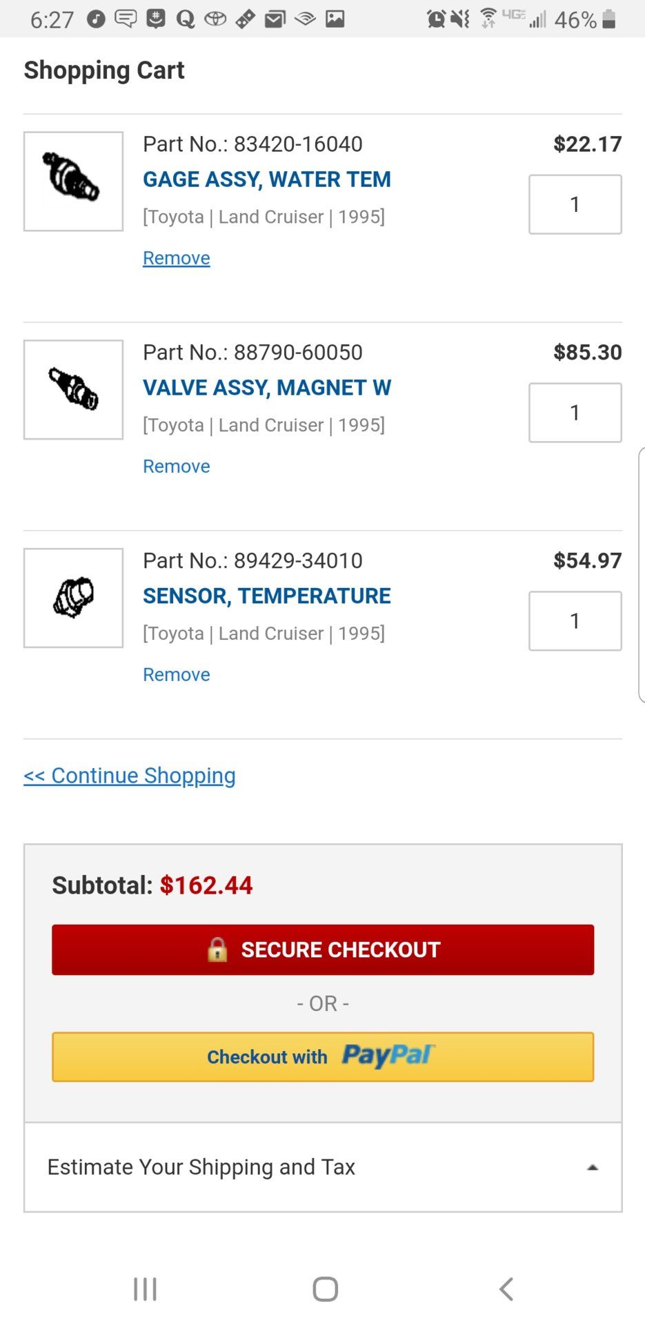

This is what I have
Just make sure they are for your year model as mine is a 94. Everything except the O2s should've the same. . I order everything from toyotapartsdeal.com you should be able to fi6the temp sensors

Our part numbers are the same except for the ECT sensor, mine is 89422-35010 vs yours is 89429-34010. I checked both for compatibility to my truck which is a 97 and double checked with my vin. Both sensors are compatible with mine. So now the question is, are they interchangeable or they are on 2 different locations and both are needed?

Looks like 89422-35010 is the correct one. Basing off otramm's video, it looks very similar. Looking closely at the diagrams, 89429-34010 seems to be a temp sensor in the transmission. Please correct me if I am wrong. Thanks.

I looked again. you are correct. I was confusing it with the temp gauge sensor found here.
