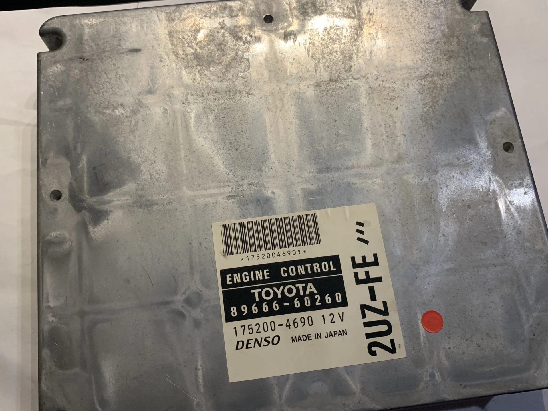

Thanks, I'm going to keep digging as there is a lot of information on this issue but hard to pinpoint. I purchased a TechStream from online which should be here next week with the replacement ECU to replace the main computer in hopes that will help.
I've asked mechanics around my area but all are hesitate to look at it, however my friend whom has his own shop is coming up from PA to look at it. I've upload a video of my truck and will add it to my 1st post.

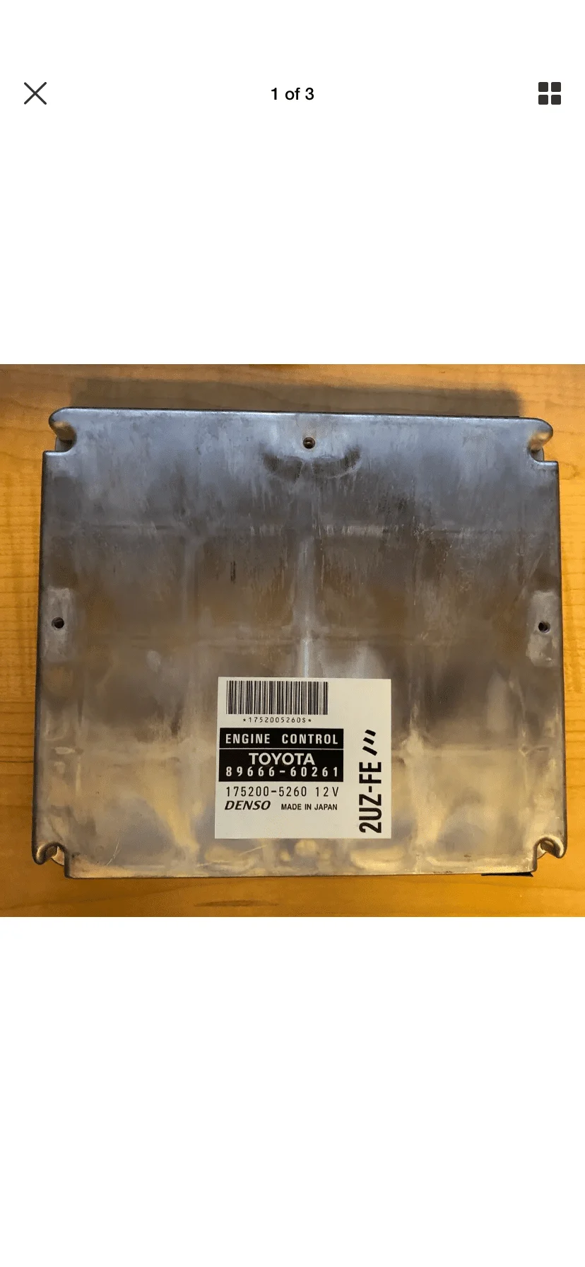

Did you buy a new ecu? Used?
Good morning,
Mauser, I’ve purchased one from an eBay seller called “ToyoMech”, the price was within my budget. The one I have had the RedDot.
The ECU should be here next week so I will keep everyone updated if this resolves my issue.
Thanks
Good morning,
Thanks
Shoot. If I had seen this sooner I could have helped to make sure it was the ecu before you bought one. I have used ecus and will loan them out.
Also, did the new ecu come with a key or is it virginized? If not it will have to either be reset or have your key written to it.
Darn, I wished I would have known and thought if I had a loaner to confirm that I have a bad ECU since nothing on the motherboard appears to be blown nor fried.
The new/used ECU I purchased does not have anything with it. I was hoping I could throw it in, put my key in the ignition for 30minutes and then come out to see if she will fire up.
This is new to me so I’m not sure of the true process for replacing an ECU.
Thanks
Sorry to be the bearer of the bad news, but without resetting the immobilizer or programming keys to it your used ecu won't work. I can help you though. If you are able to or know someone that can replace the chip I will send you a chip to virginize your ecu, or you could swap the chip from your old one to the new one.
If you need any help let me know. I am always happy to help another Cruiser bro out.
I was afraid that you would say that. It's hard to find a person that would be willing to touch/solder chips a car ECU in Baltimore MD. I guess my next option would be to find a locksmith that is familiar with resetting the immobilizer?
Yes, there are some locksmiths that will do Toyota ecus, but a lot of them will tell you it cant be done. You can call around to local places and you may get lucky. Probably wont be cheap. If you can't find someone, or if they want your first born to do it let me know. If you pay shipping both ways and are able to be without your truck for about a week I will do it for you and just ask that you make a donation to a local charity that helps out U.S. military vets.

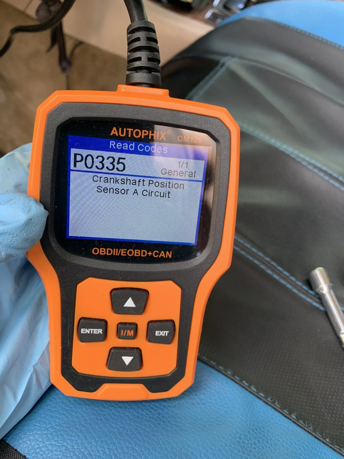

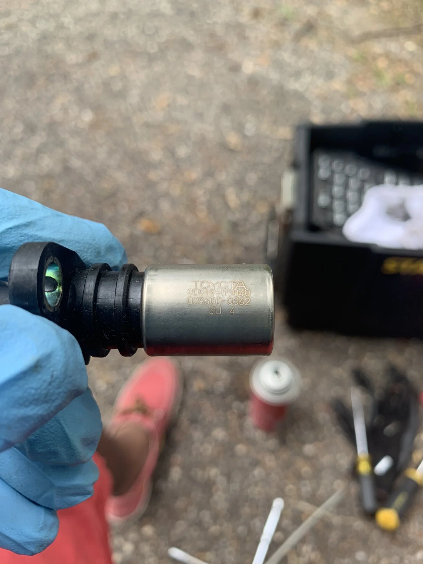

I’m going to take another stab. I just got this code and am going to replace the crank shaft position sensor again. The one I put in before was from a totaled Sequoia from the JunkYard.
It’s a pain in the rear to get the wire connector off from the bottom.
