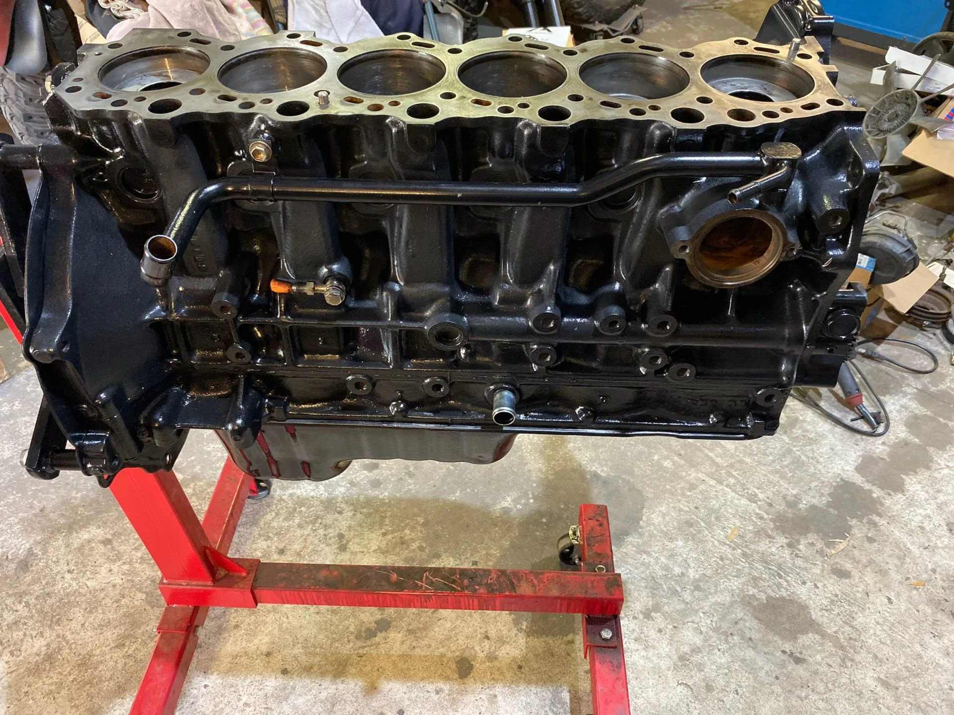

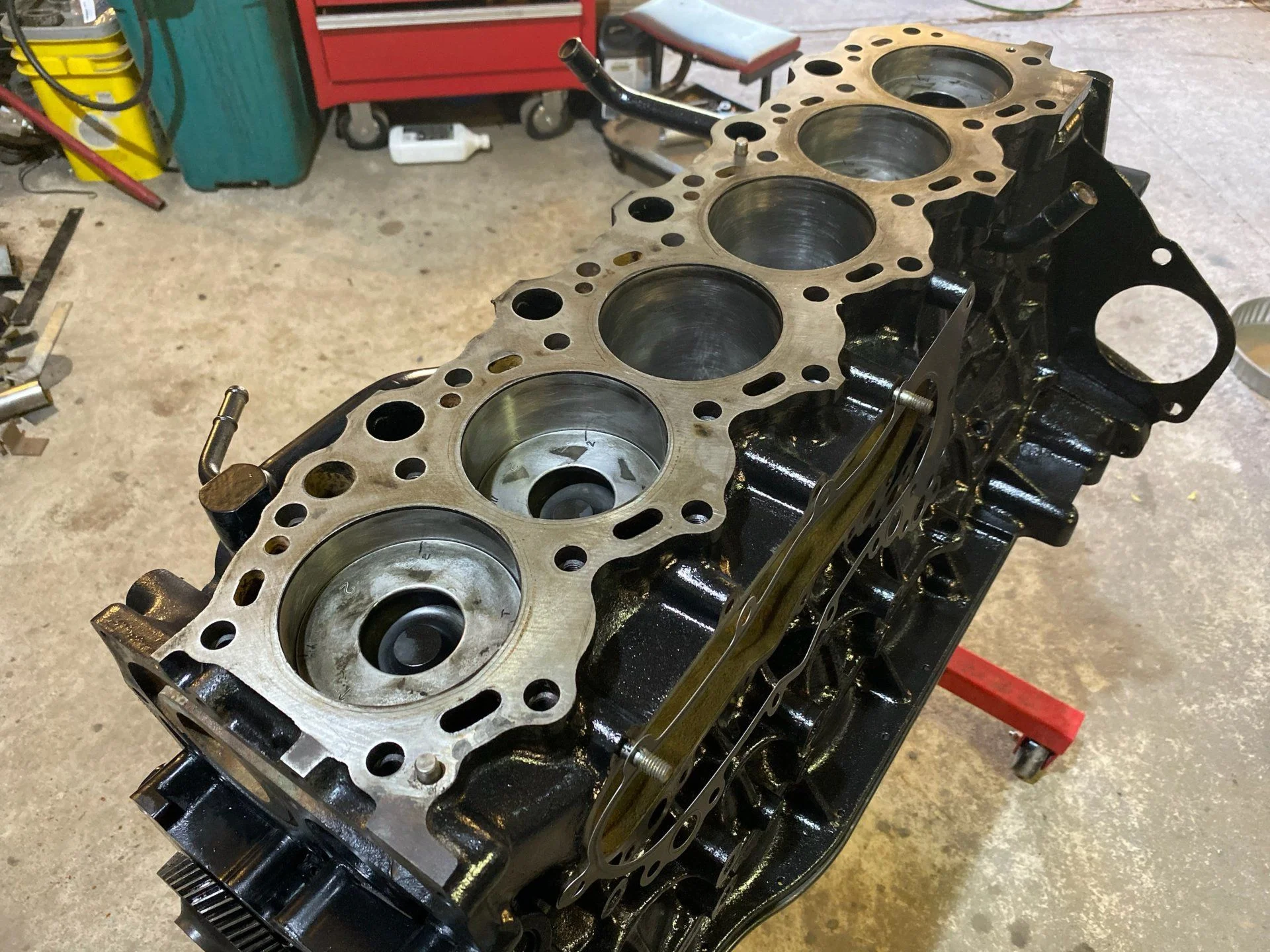

Okay. I promise we are about to have an update with some good photos and progress updates. The engine has been completely torn down for a complete rebuild. We have been slowed due to a delay with a couple of key gaskets. Those have now arrived and things are moving right along again. The injector pump is back from the rebuild and the injectors have been modified to handle the added boost. We are going to run the Winks turbo initially but may consider some different options after some test runs.

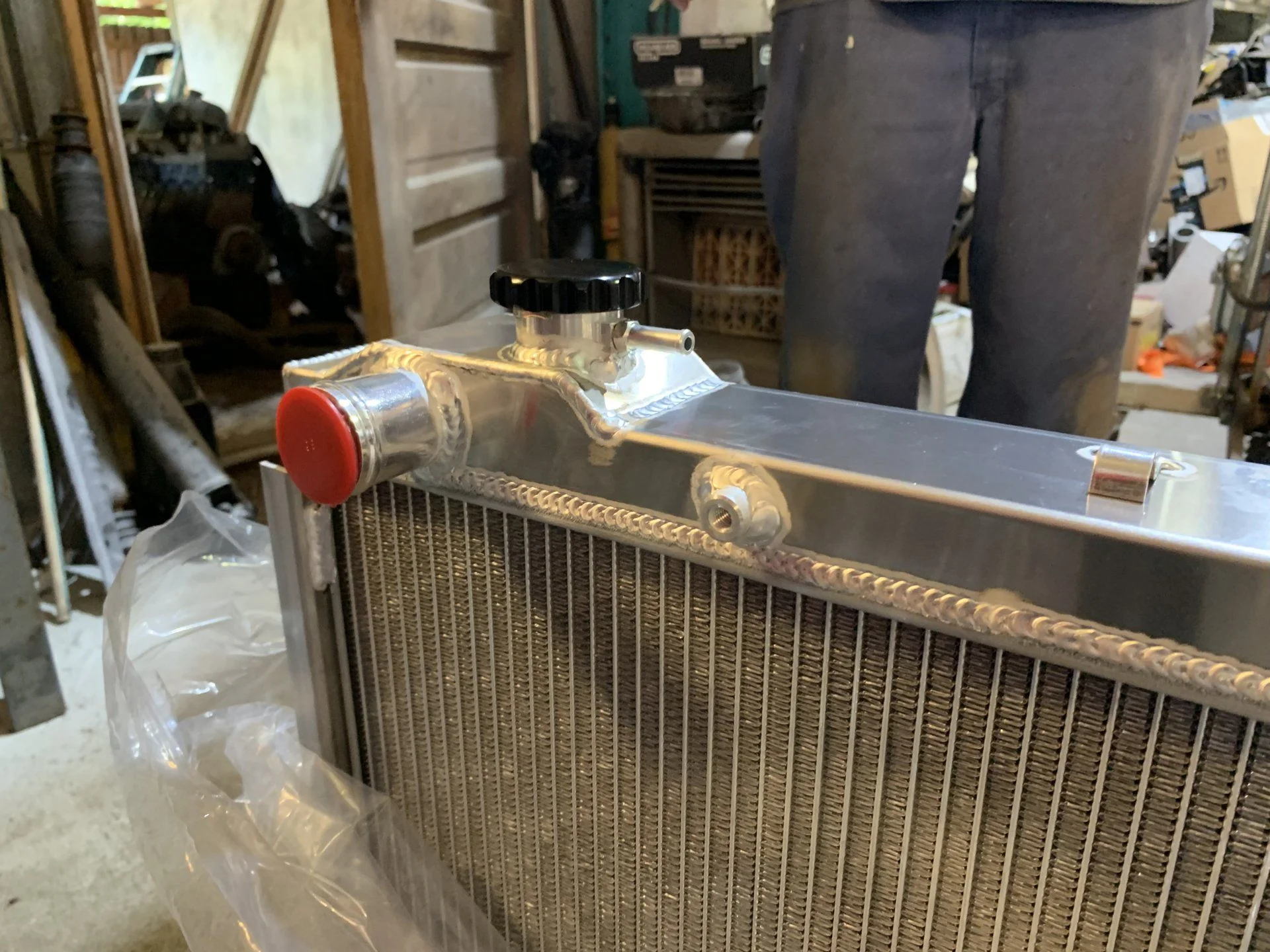

New custom HD radiator showed up today.
Beautiful. I may have missed it, where did you source the radiator?

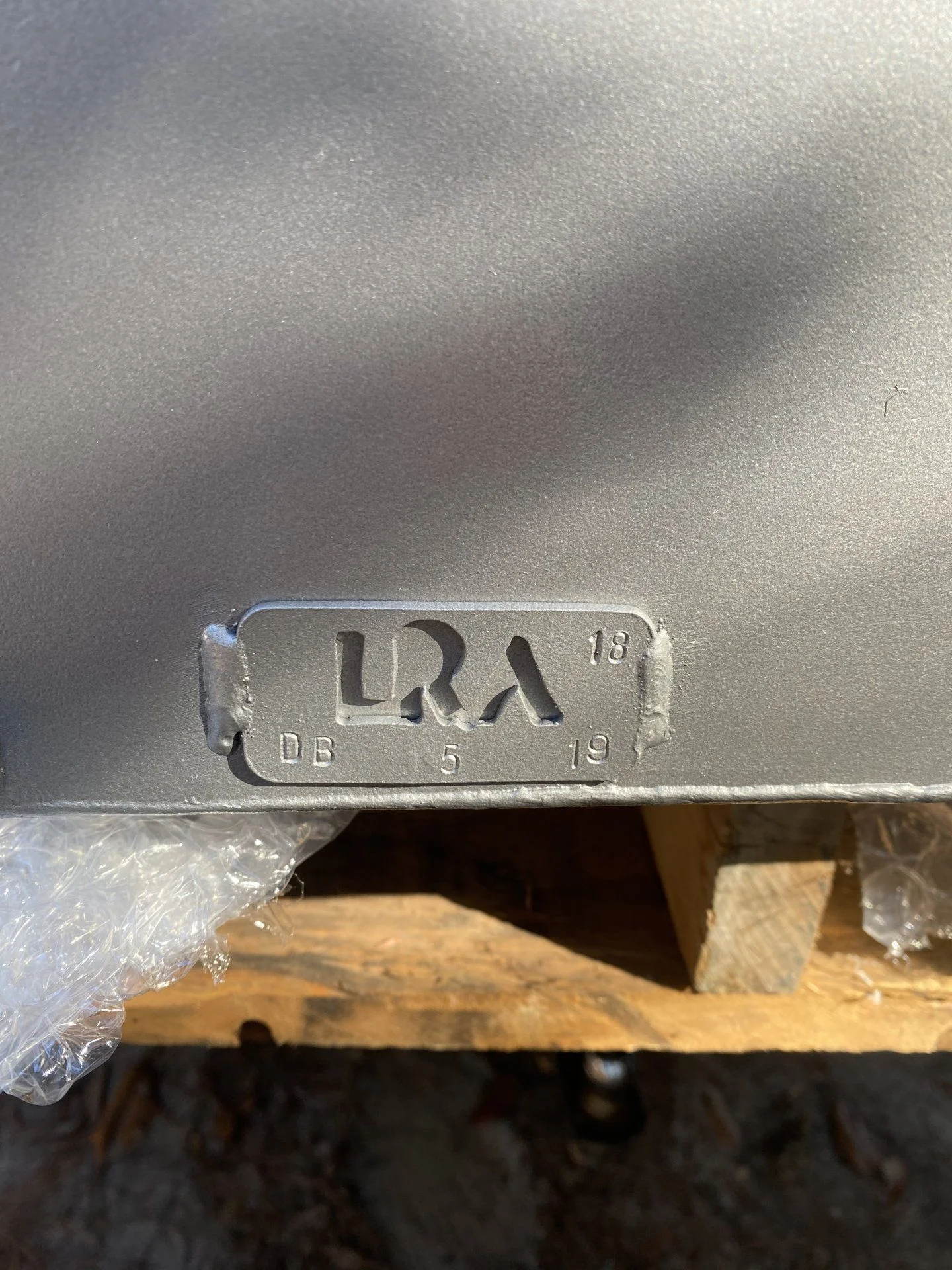

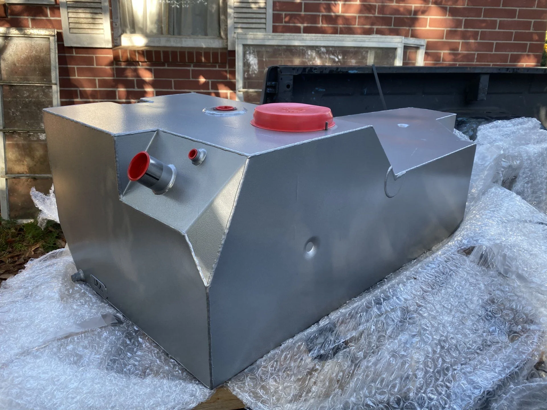

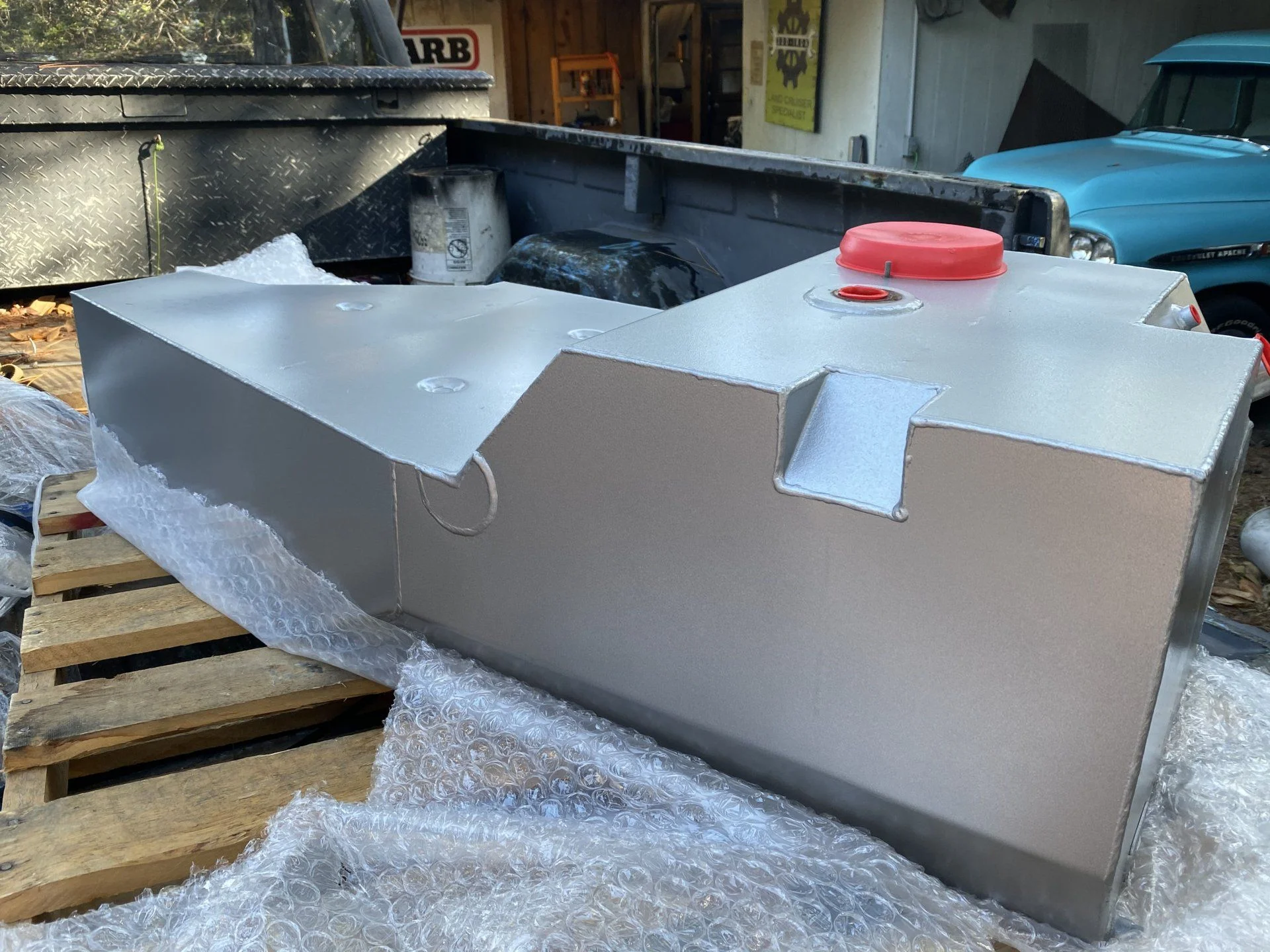

A little more progress. The LRA main tank replacement showed up this morning! Pretty sweet setup at 140 litres or around 37 gallons. This was the last real component that we were waiting on to get started. The bottom end rebuild (bearings, rings, etc.) was completed tonight and everything was reassembled. I’ll have some pics shortly once the paint is dry.
Is he going to start producing some things for the 1hdt, I know he’s creating quite the reputation. I think there’s a market stateside
Well...he is sort of a one man band. He does fabricate some items. I know he has had some of these radiators made for other people. And he has done numerous intercooler installs on HDJ81’s. Just depends on what you want.
The prize is always an intercooler stateside, didnt realize he was a one stop shop. Makes all the work he puts out even more impressive

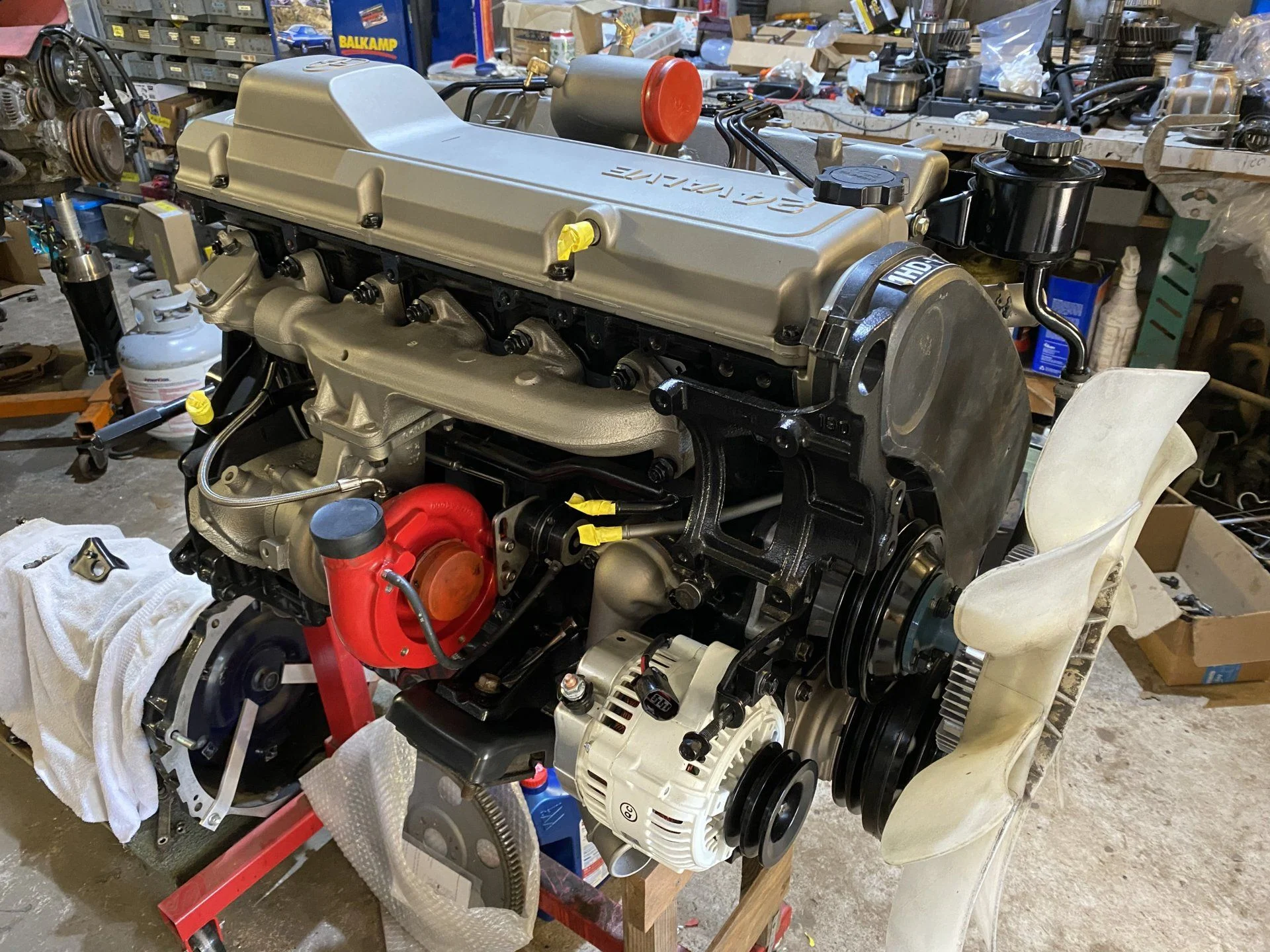

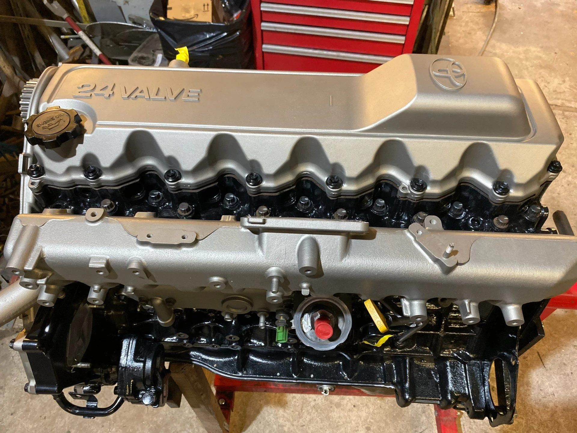

Here is motor as of last week....it’s starting to look really nice.

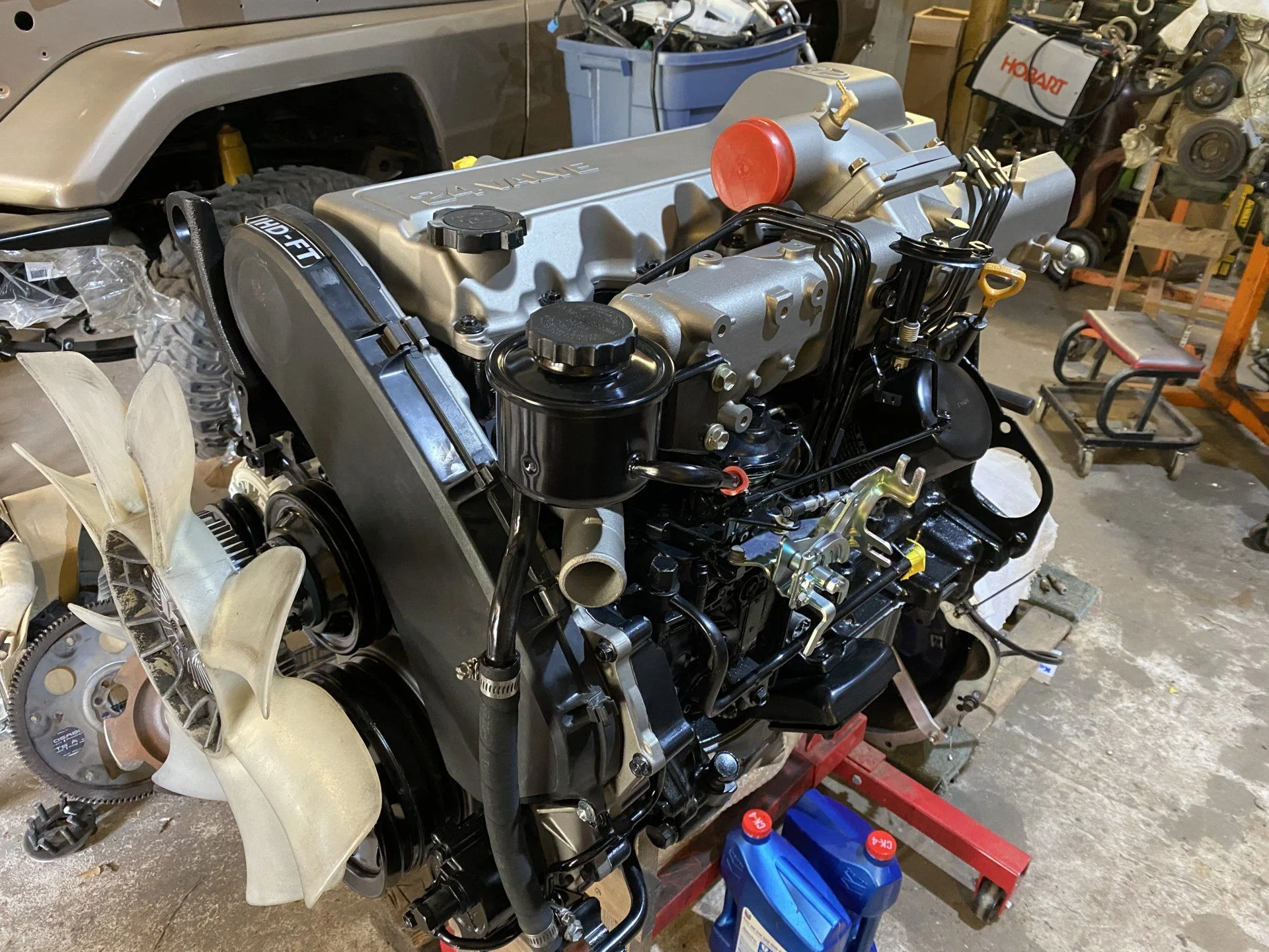

Okay. I think...hope....we are about ready for some updates. I was by the shop last week and the engine was pretty much ready to go. The transfer case was rebuilt and now has a sweet low range reduction kit from @cruiseroutfit. I am told the engine/transmission/transfer case will be sitting in the truck this evening. Fingers crossed.
