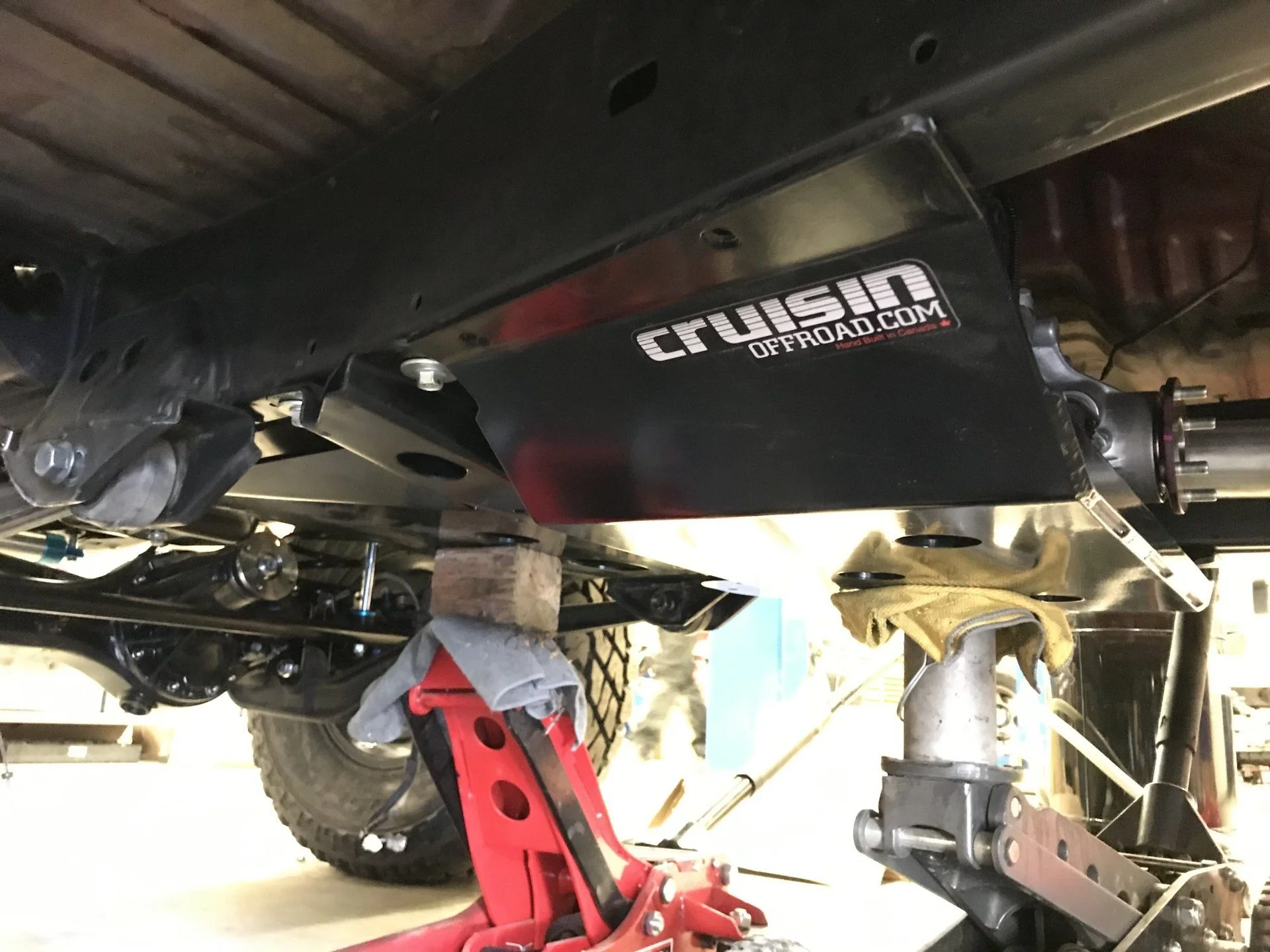

Belly skids test fitted. We have to modify these a little bit. Remember we moved the trans crossmember forward and the trans is also shorter being an H152 vs the 442 that was in it and the 343 before that.

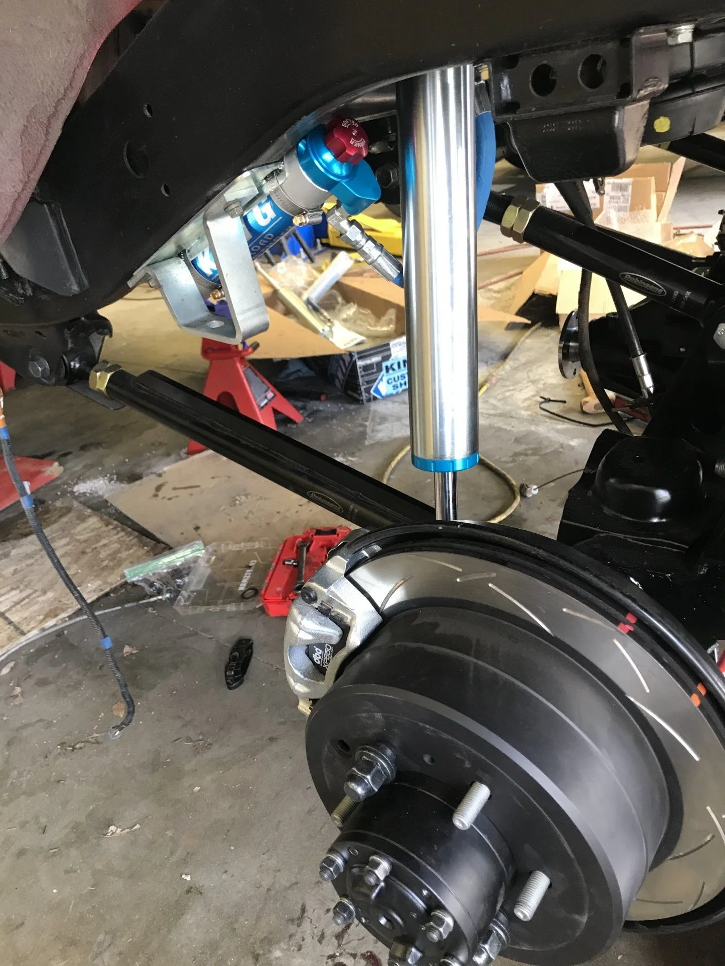

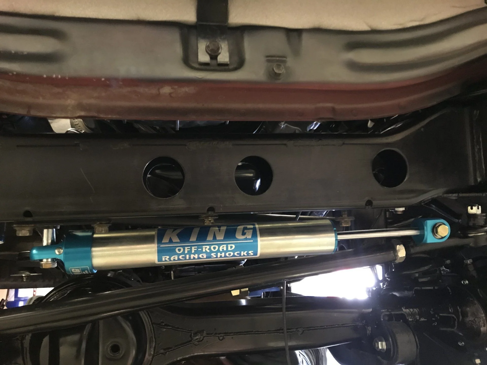

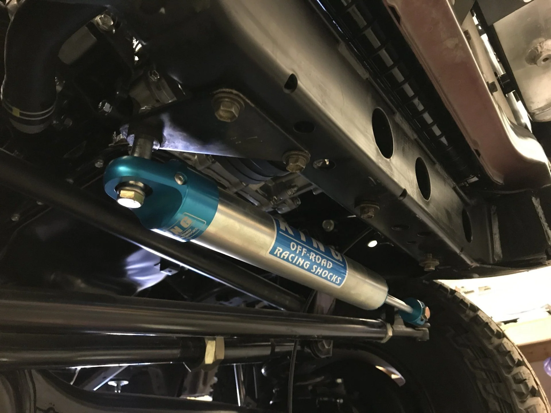

King steering damper installed.

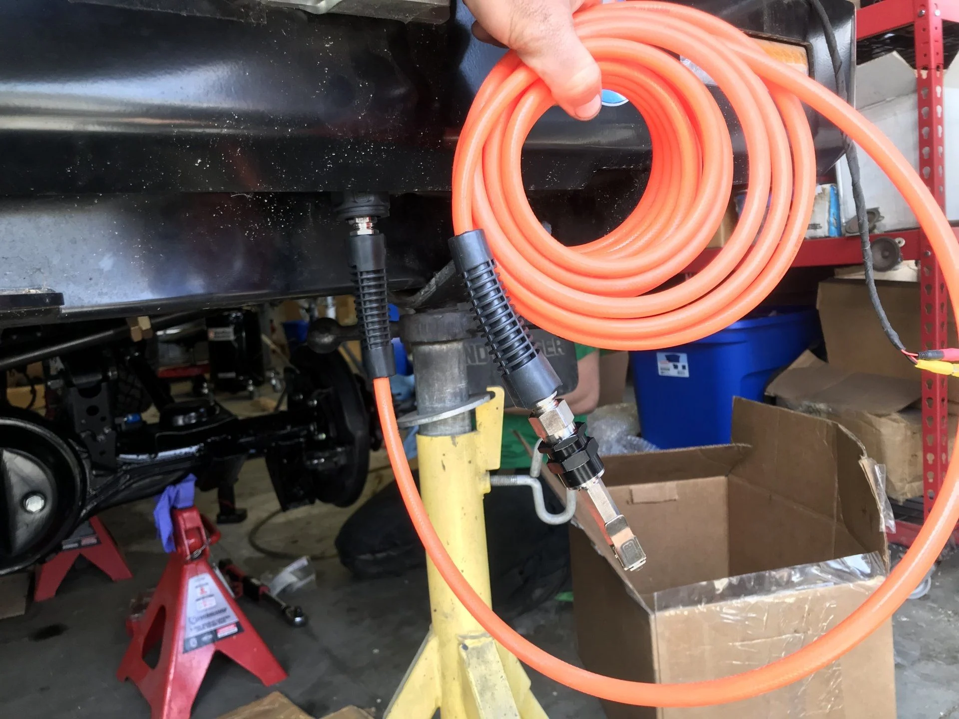

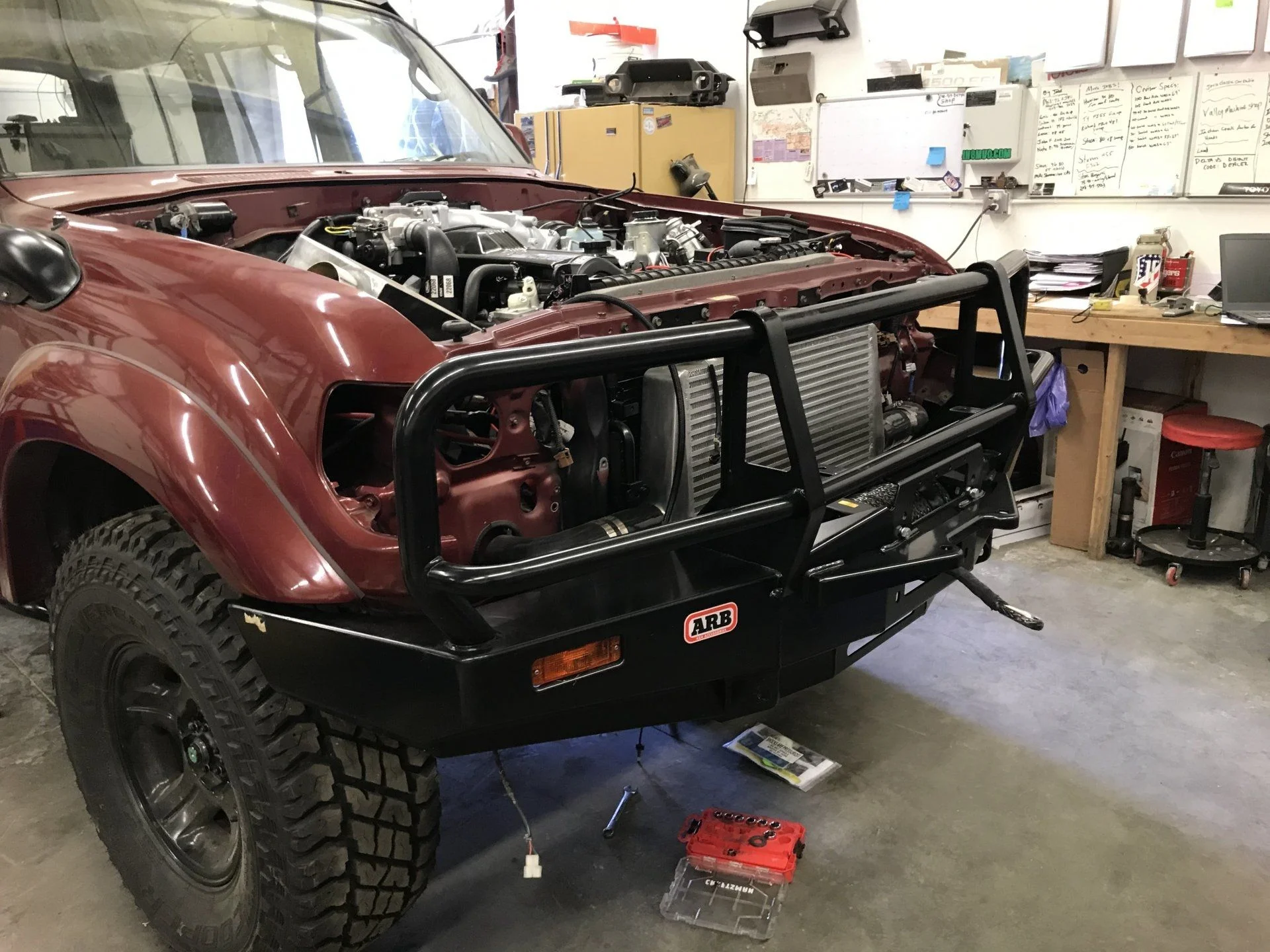

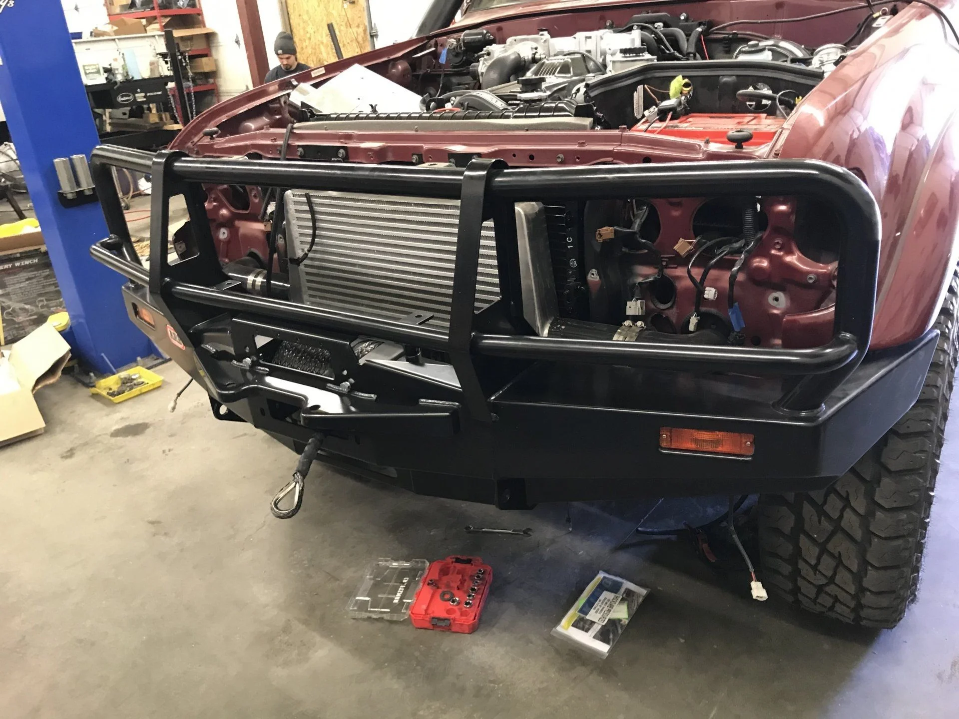

ARB bar test fitted. We have an air port to fit to it along with the Rigid light bar.

ComeUp winch is being changed out.

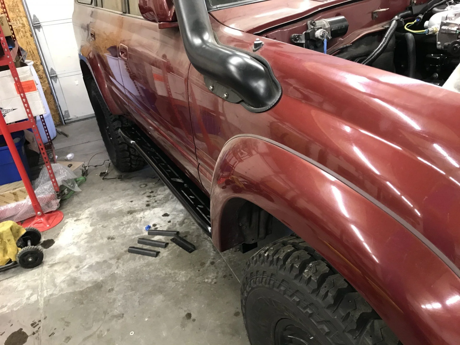

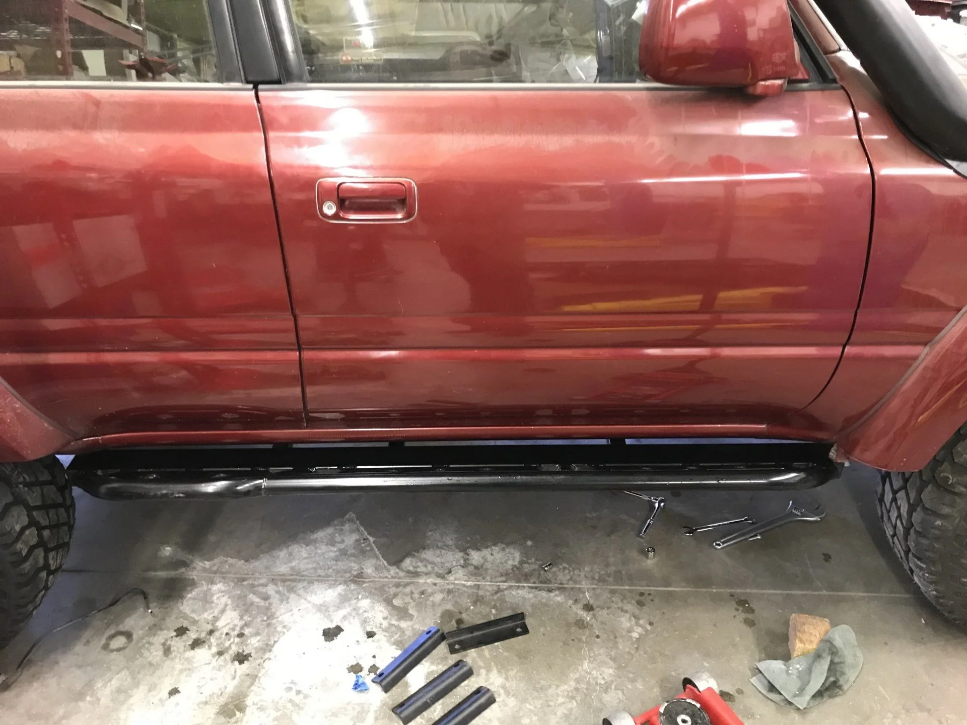

Test fitted sliders, some of the legs are going to need some mods and fabbing. Right now just the LHS front leg due to moving trans crossmember forward.

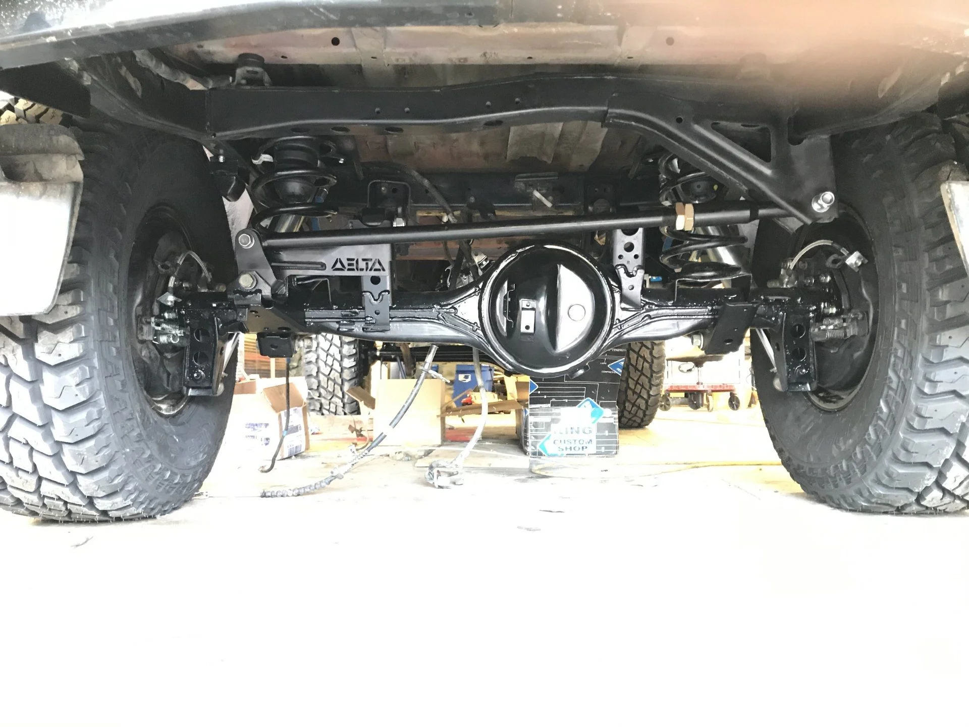

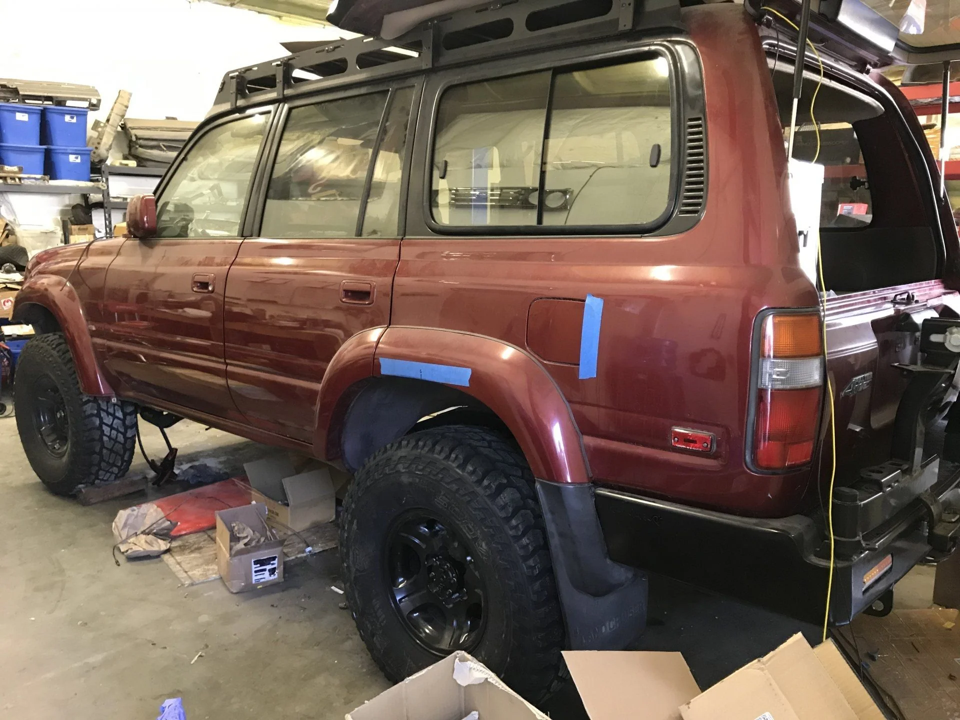

Tom Woods drivelines are also coming. Since we got the 3rds in and put it back down on the wheels and now that it has some weight, we could get flange to flange measurements and order them up. We had drivelines from when the Cruiser showed up but they are way off on the measurements now that things have changed.

And the winch. I ordered that 12.5 Comeup thinking it would fit no problem. And it does fit but not great and doesn’t mount up so well. @SNLC was going to fab up some mounts but I decided we would just get a Warn M12000 as that should bolt up with no mods.
At this point I just want to finish the truck. The sliders were not going to really work anyway. I had Jason build them thinking the exhaust would be routed inside the frame rails but we are going to run a Beaudesert exhaust and it goes outside and back inside. We all kind of knew the oil pan was going to be trial and error. That’s resolved now and the list grows shorter. Hopefully the center shifter console will be complete soon. We have a high end 3D printer doing some work on that now and I have elevated expectations. I figure it should be nice based on (1) the cost and (2) their other work product.
