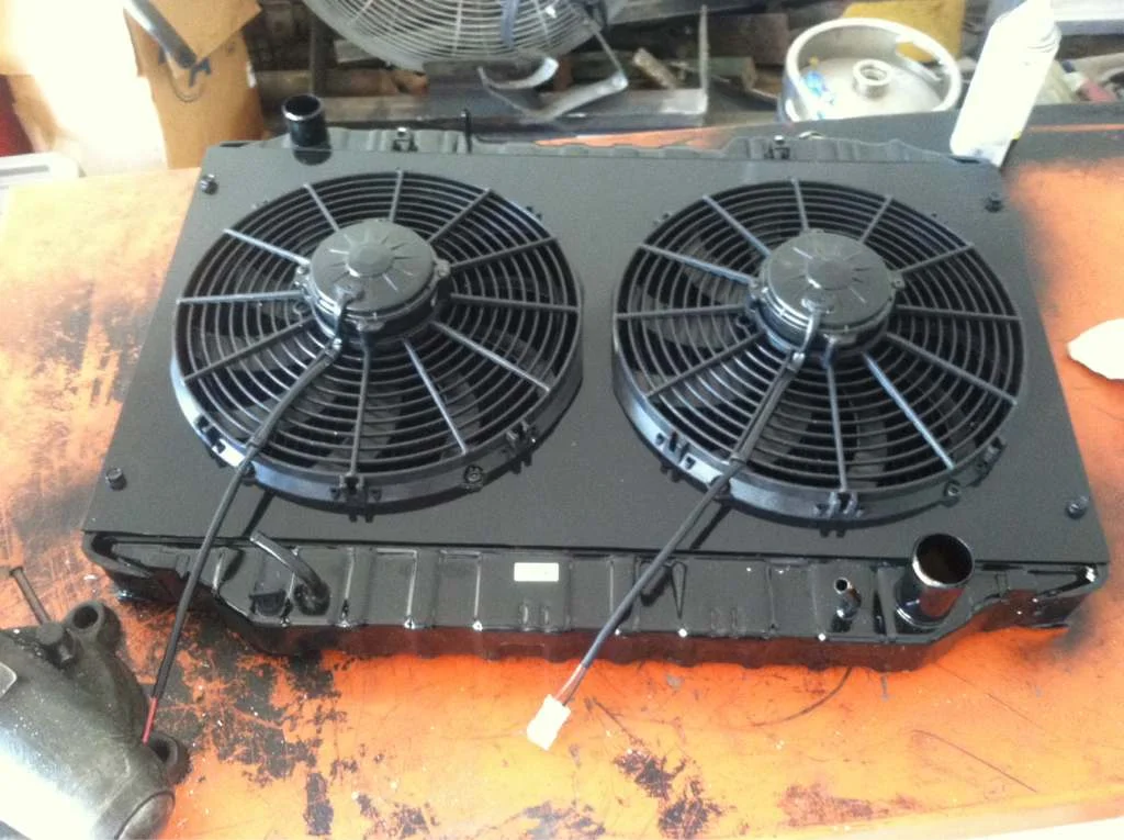

Well decided not to use the RD radiator setup and just use a stock copper radiator with dual 13" Spal fans. Waiting on new isolators and hardware and I will wrap this swap up!

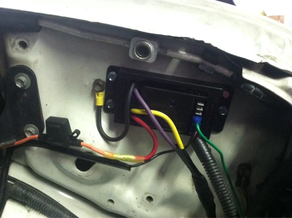

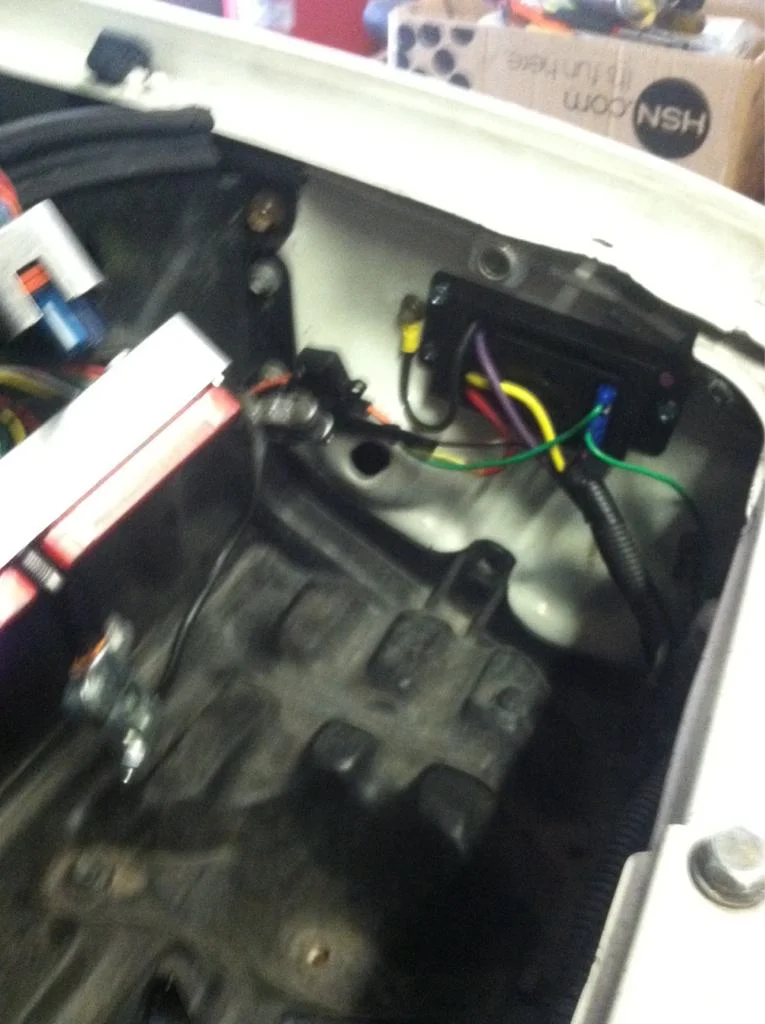

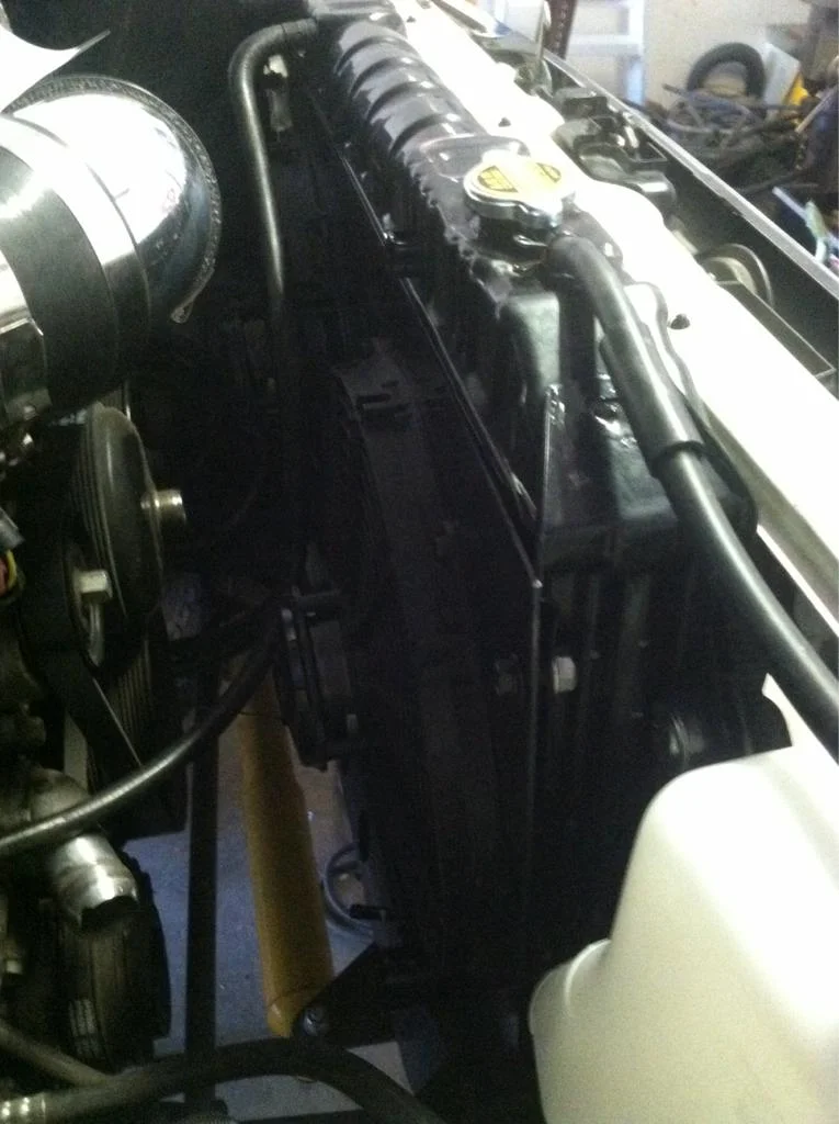

radiator/fan assembly installed with new isolators and hardware. To control the fans we are using a variable speed fan controller from Flexlite. Pretty sweet setup it adjusts fan speed from 60-100% depending in set temp. Also it has an ac option to kick the fans on if the car hasn't reached operating fan temps. For h20 crossings a manual override off toggle was added well.
