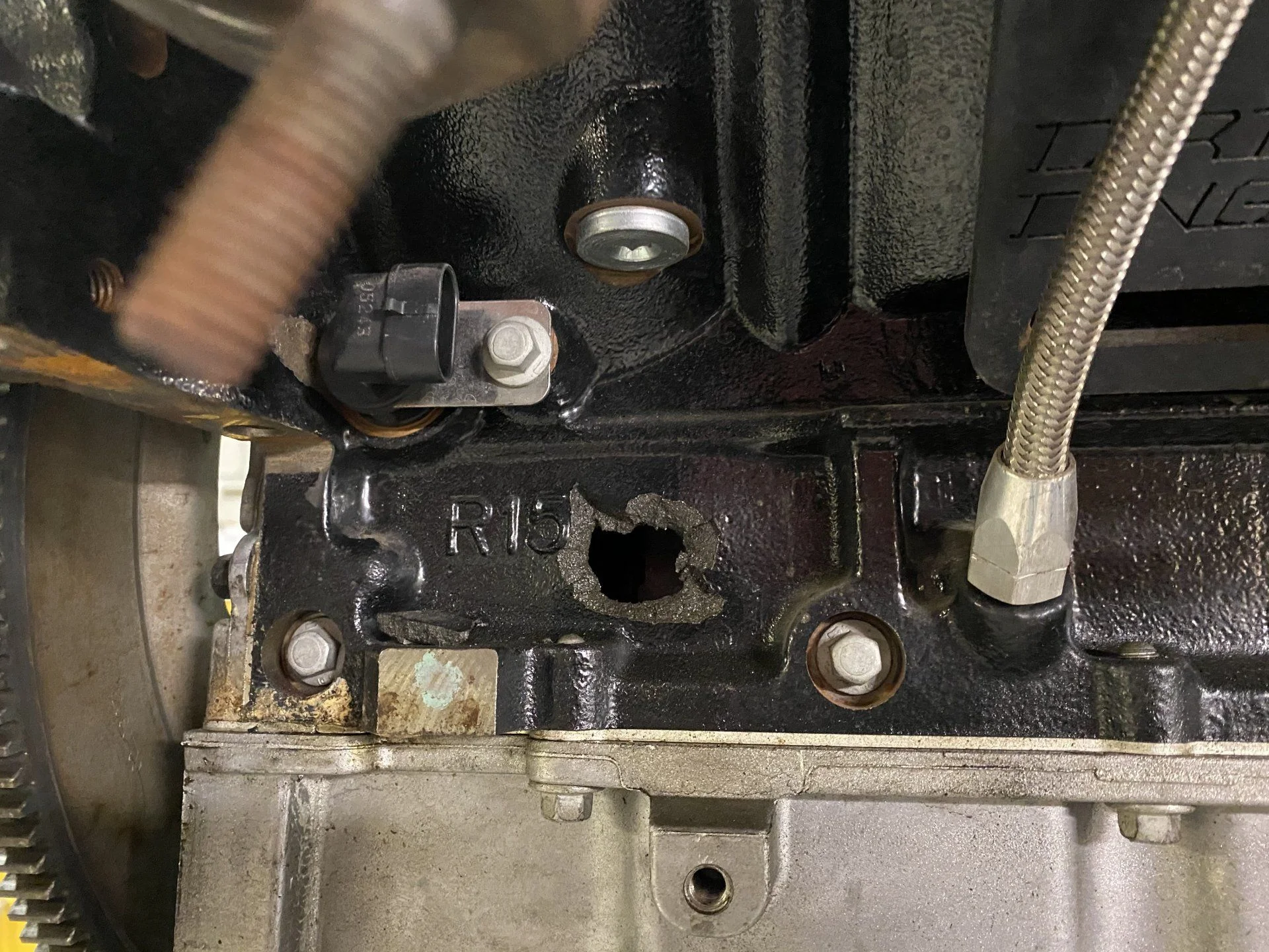

That is an impressive hole in the block.
I was hoping to put some miles on the truck before I blew the motor. Guess that was asking for too much.
The way I look at it... at least it was an obvious failure. No annoying ticking sound or languishing issue that came and went. Just BOOM! Game over. Next...
Do you think some JBWeld would do the trick to fix her up? LOL...
As long as you embed some fiberglass drywall joint tape in the JB Weld repair ... sounds like a solid idea to me!
Personally I'd strip the block, blast the whole thing, coat in clear lacquer, order a glass top and make it in to a coffee table. Looks like a great conversation piece. Seen it done with a blown Ferrari engine and everyone always wanted to ask questions. Of course, then you'd have to relive the moment forever. :confused:
