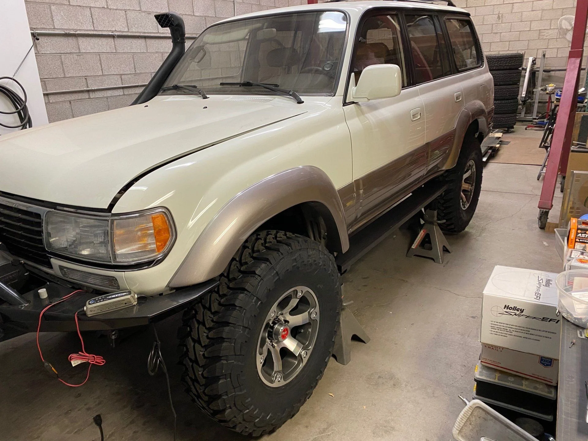

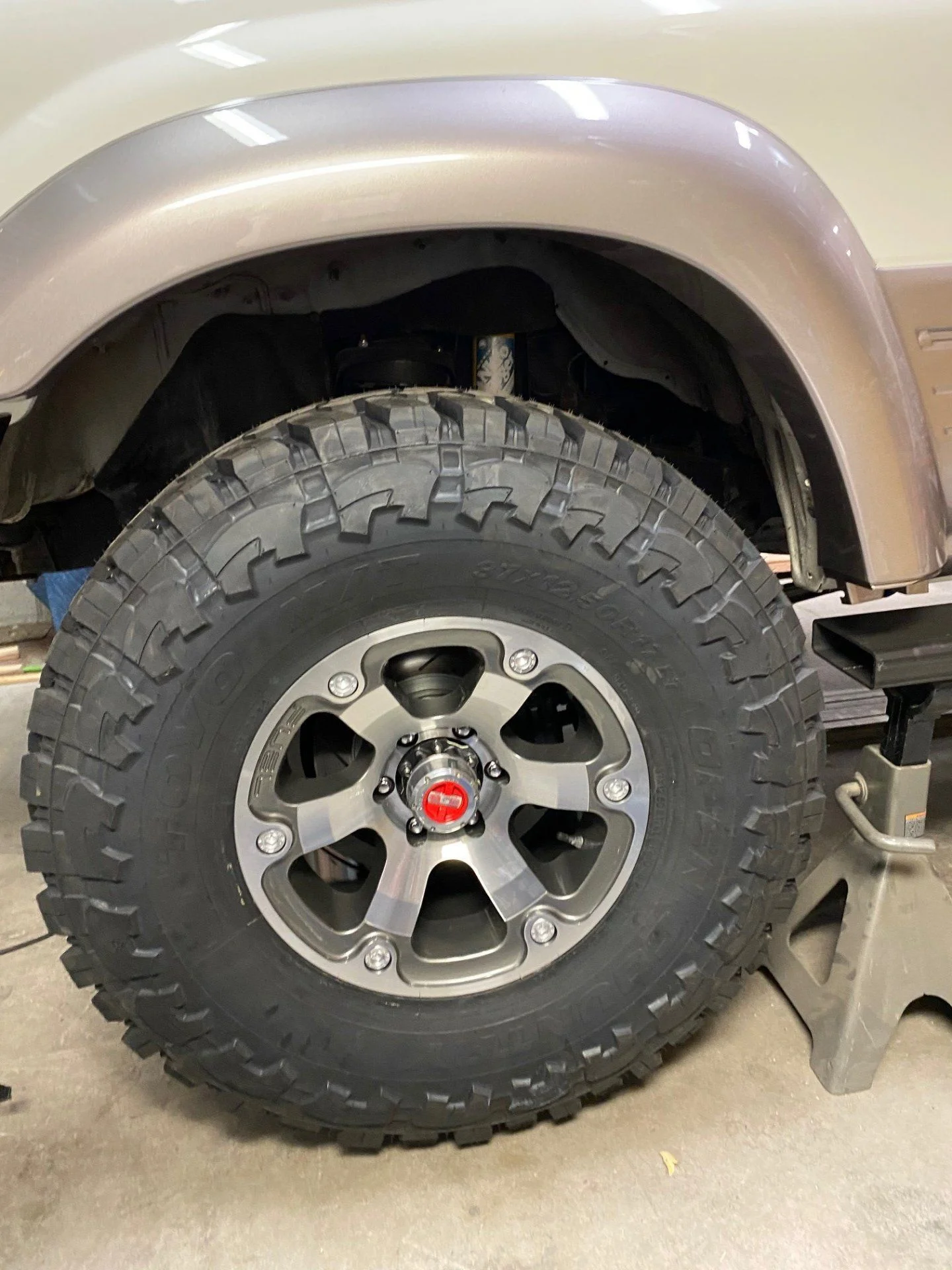

Wheels are back and 37" Toyo's are mounted. They look awesome! Something is up with the balancing though. Huge amount of weights on the wheels, some on opposite sides of one another. Going to have them force balanced to see if the wheel shop's balancer wasn't handling the big meat correctly.

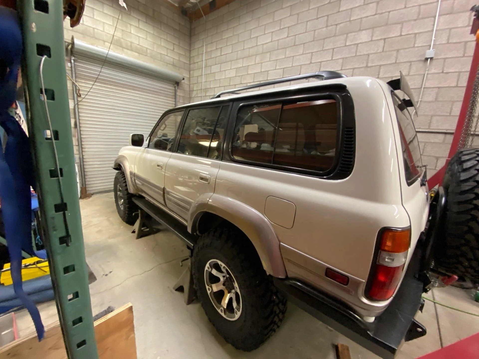

Vehicle is still on jack-stands as I am mocking up some step sliders. Those should be wrapped up in a week or two. Thinking about champagne powder coat with a black grip tape along the length.

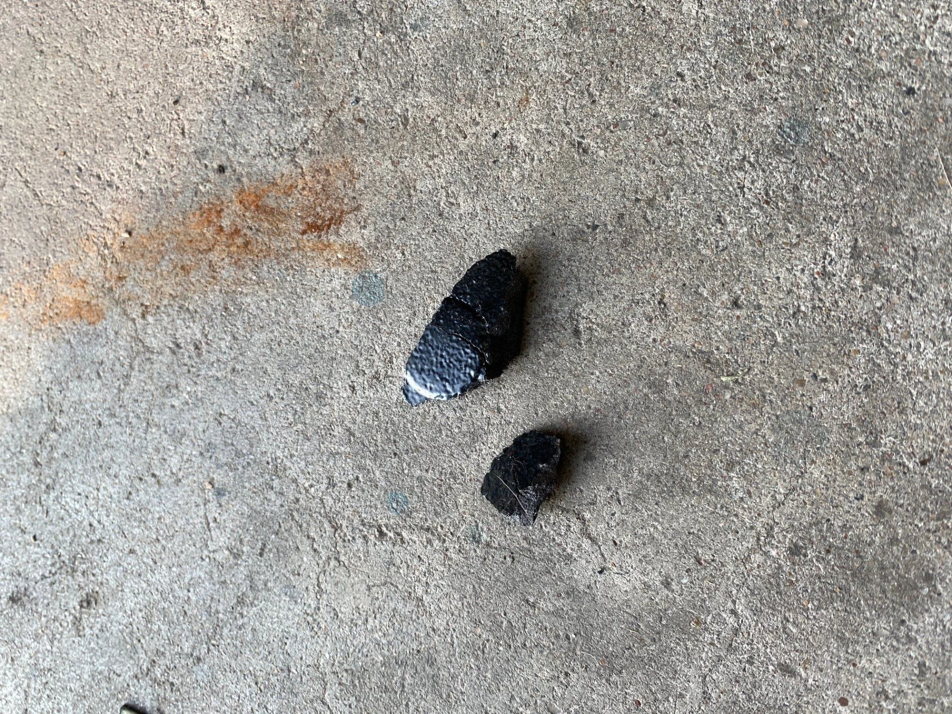

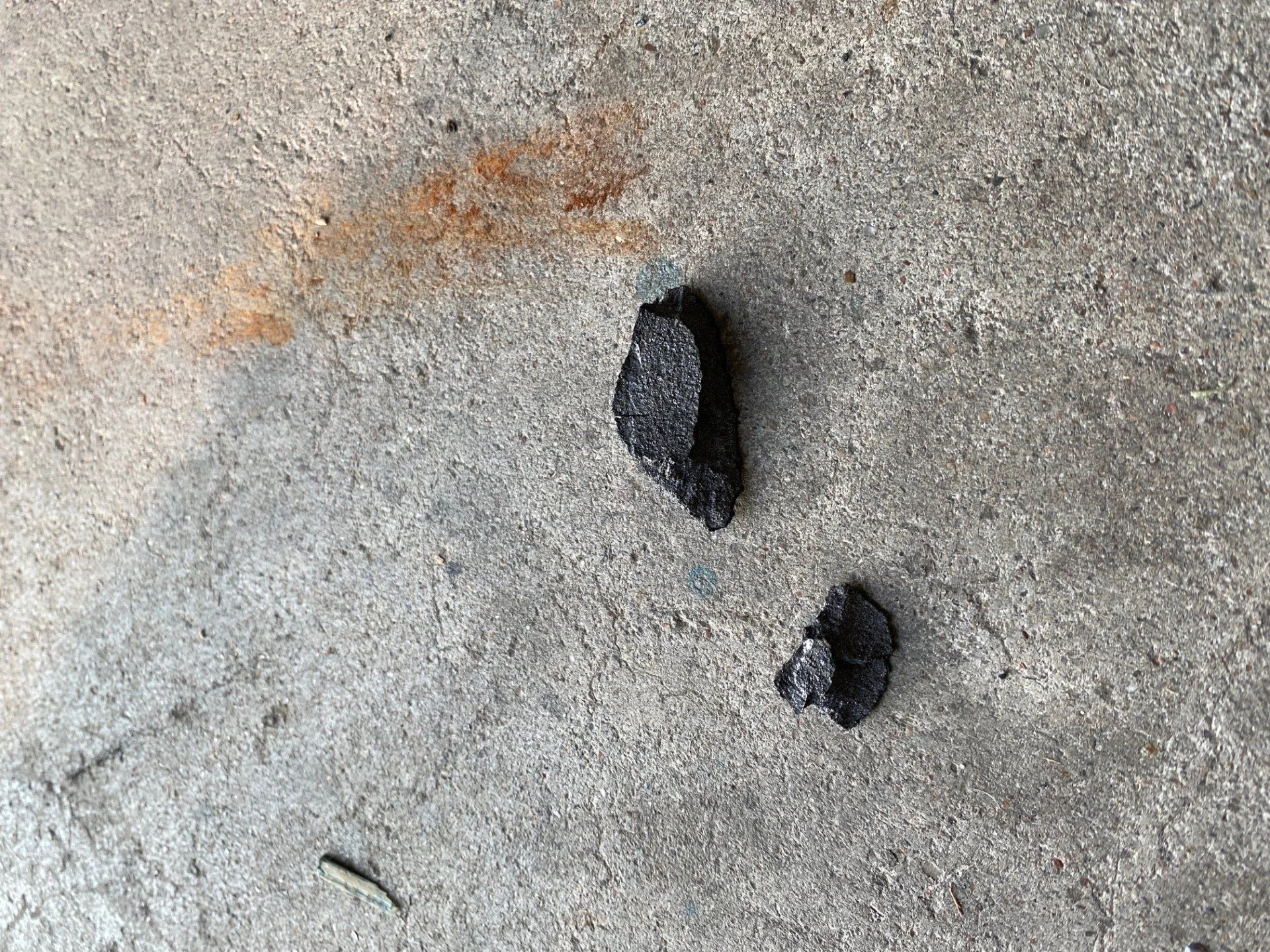

Very sad day yesterday. I dropped her down off of the jack-stands so I could unload something into the shop.
I started the engine and boom. She threw a rod through the side of the motor. We are assuming it hydro-locked on a leaky/stuck injector.
